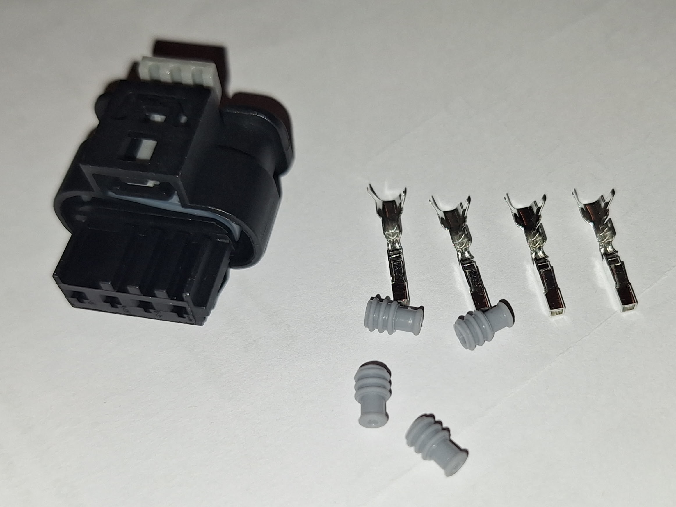

I am using the same ibooster from a yaris in my project. To get is to work in failsafe mode I needed to add 120 Ohm resistors to the CAN busses. And than power, ground and ignition.
Found the connector for the sensor on aliexpress
https://nl.aliexpress.com/item/1005004072725751.html
The connector is still on its way. So I am not a 100% that it will fitt.

Ah thanks for the hint. Were there any messages required to kick it into life, or simply the 120ohm termination?
I was lucky enough to receive the pedal position sensor connector (and it's mini-loom) with the iBooster when I bought it, but I've had to source the main connector and terminals/seals elsewhere.

After 3 weeks of delay my package finally arrived. I can confirm that the connector fits fine.
