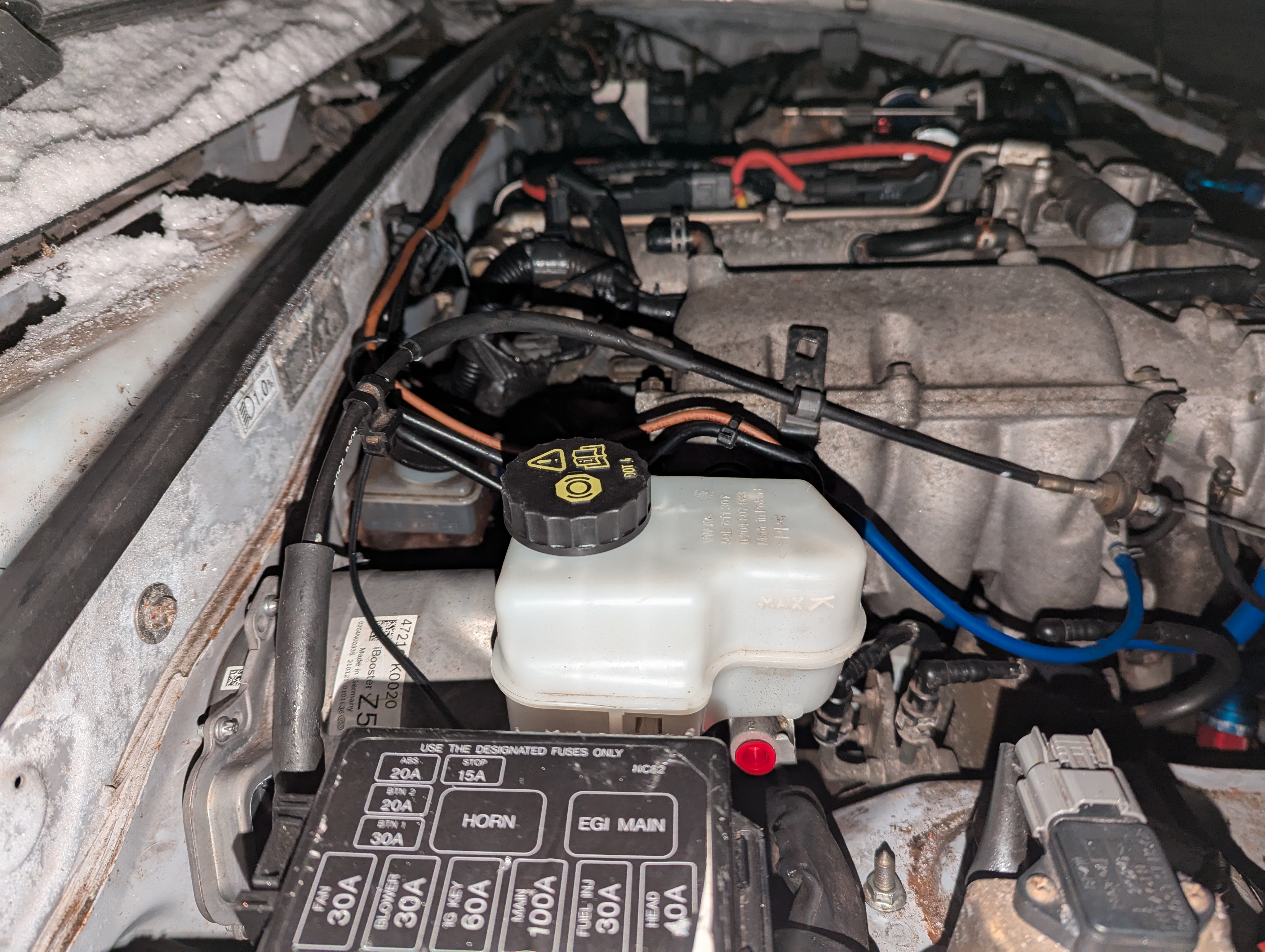

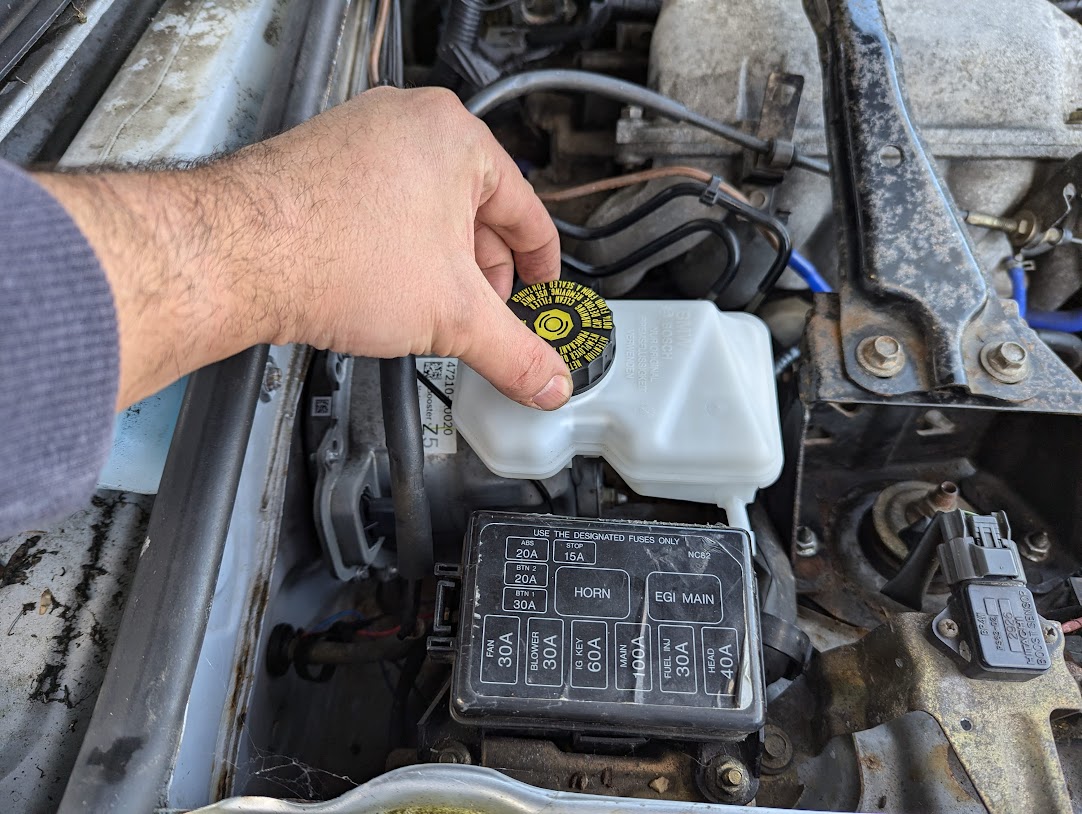

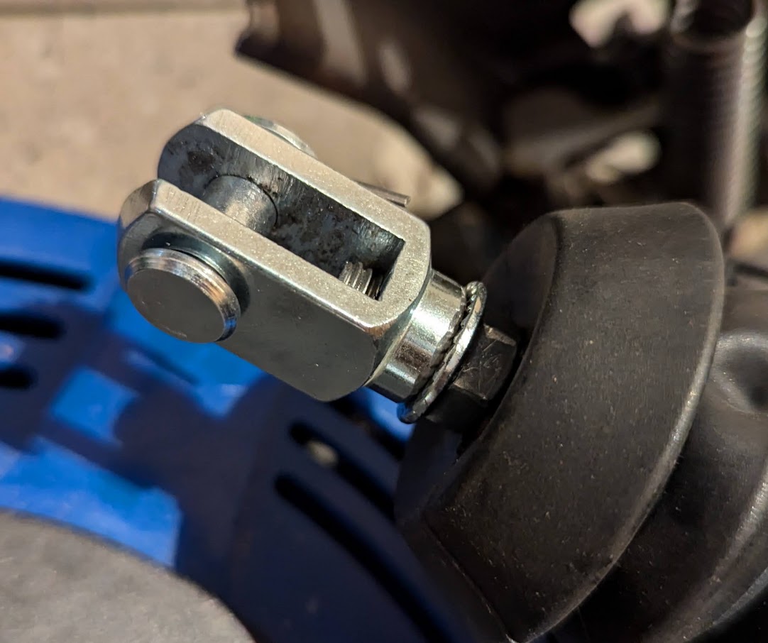

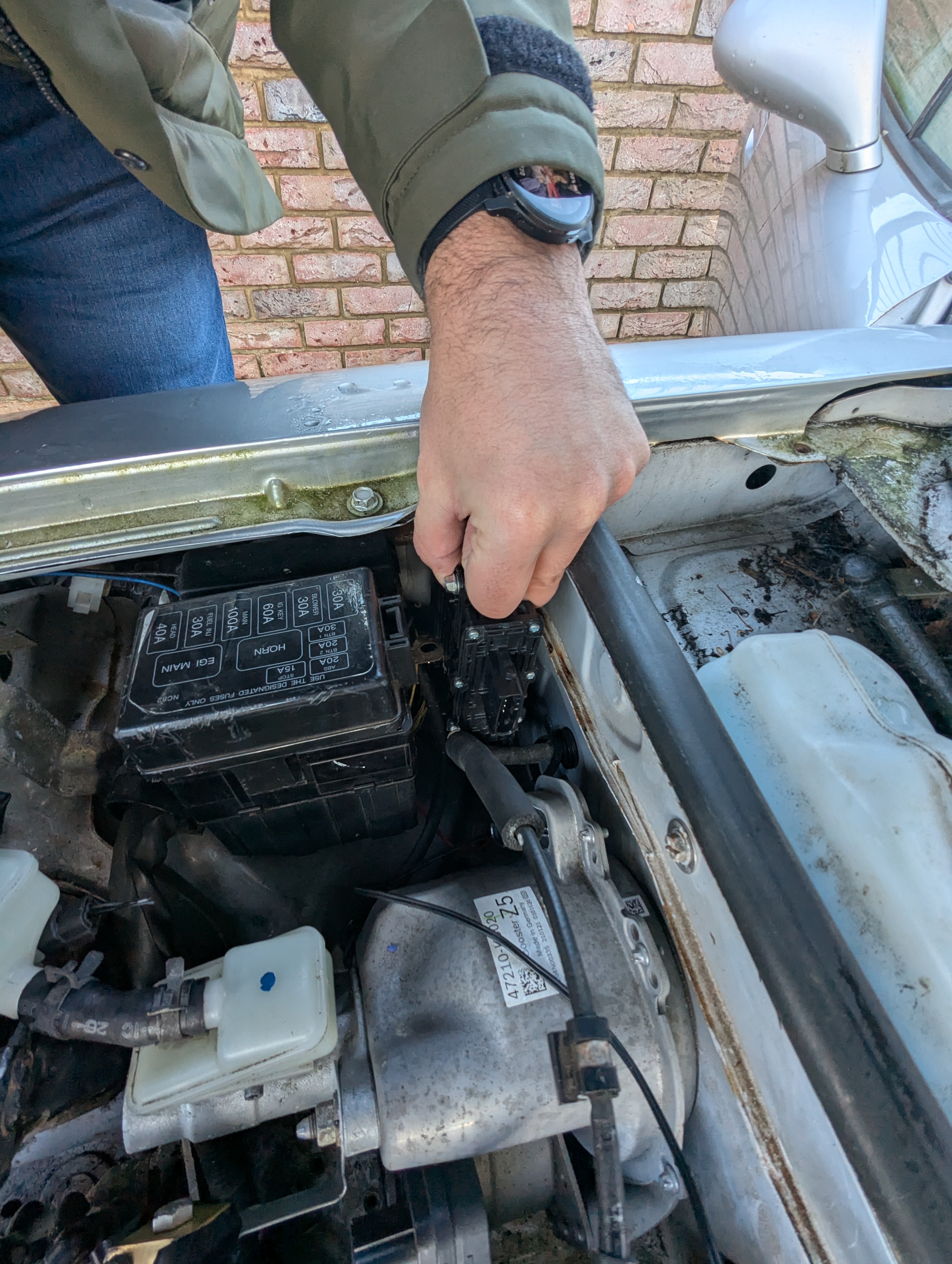

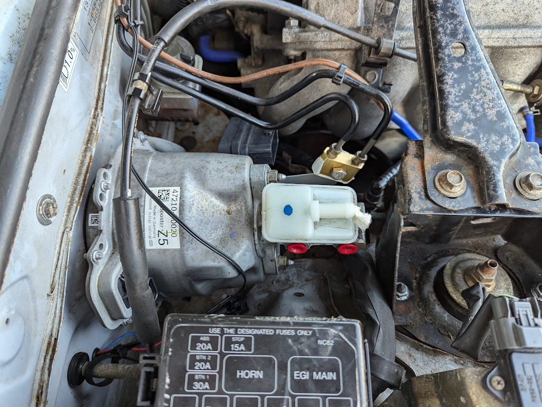

Installed with a temporary remote reservoir (Honda CRV), although unfortunately I can't use a remote reservoir as there is no obvious space to mount one properly. I had to grind a very small amount of flange off the bottom of the iBooster to allow it to fit without fouling the bodywork.
Also you can see the hardline joint, the brass thing next to the master cylinder with the two factory lines connected to its top. The factory joint doesn't quite work in this application, so this brass block is a brake line joint from a Subaru Forester.
Better view of a small bracket used to mount the joint in the hardlines.
The trimmed M8 clevis joint.
Possible reservoir from a Mini R56, but requires an adapter to change the mounting angle. I'm awaiting a mock 3D print to test fit, but of course this would need to be something like machined aluminium to be properly functional.

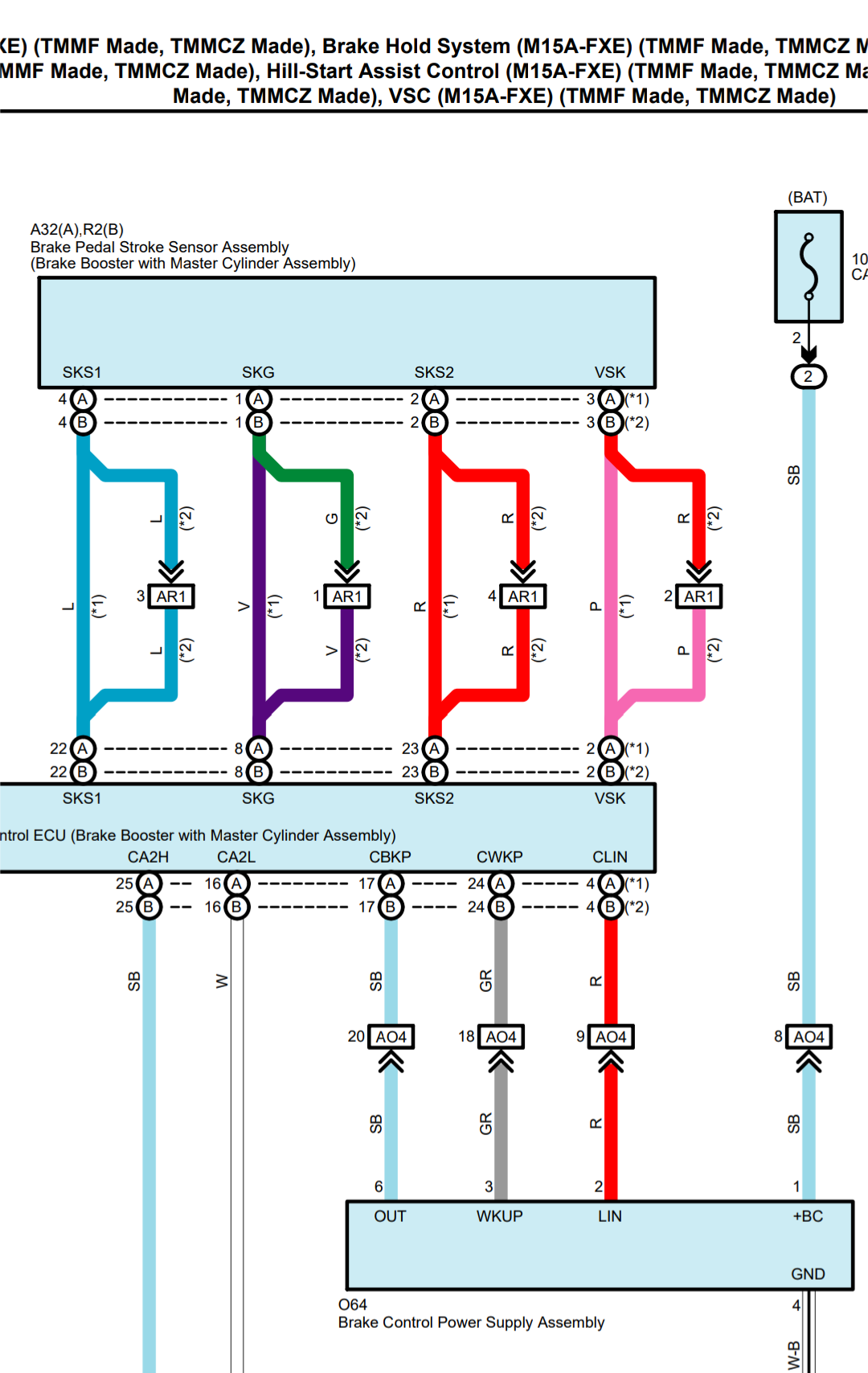

On the wiring, after some searching and an eventual defeat by paywall, I have purchased the wiring manuals for the Yaris MK4. They reveal that the wiring is not the same on the Yaris as it is in other iBooster Gen2 applications.
Interestingly, there is a "Brake Control Power Module" (89680-K0010) which appears to be an emergency back-up power source for the iBooster in the event of power failure in the vehicle. I have not seen this in other conversions, but at £35 off fleabay I thought it would be something worth having. Currently awaiting delivery for test-fitting. This module connects to pin 17 on the iBooster (usually an unused pin on the Gen2, according to other guides) along with a few others (see pinouts below).
There are also connections to the door-open vanity light switches and to the stop light circuitry. Since I will be keeping the stock MX5's brake wiring with its pedal switch, I will probably not make any use of this.
It's also worth noting (as others have elsewhere) that the pedal travel sensor connector pins on the Yaris iBooster are in reversed order compared to normal.
Yaris iBooster Gen2
Connector: 82824-K0100
Bosch "EuCon" 26p
01: +12V 40A fused permanent live
02: Pedal Travel Sensor (pin 3)
03: -
04: CLIN (to pin 2 on BCPM)
05: -
06: -
07: -
08: Pedal Travel Sensor (pin 1)
09: GND
10: CAN1 L
11: -
12: -
13: -
14: -
15: CTY (door courtesy light switch)
16: CAN2 L
17: CBKP (to pin 6 on BCPM)
18: CAN1 H
19: -
20: IGR switched, 5A fused, hot in run/start
21: STP (stop light circuit)
22: Pedal Travel Sensor (pin 4)
23: Pedal Travel Sensor (pin 2)
24: CWKP (to pin 3 on BCPM)
25: CAN2 H
26: -
Pedal Travel Sensor
Connector: 82824-K0120
TE MQS (4 pin)
01: iBooster pin 8
02: iBooster pin 23
03: iBooster pin 2
04: iBooster pin 22
Brake Control Power Module (89680-K0010) (BCPM)
Connector: 90980-12785
01: +12V 10A fused permanent live
02: LIN (iBooster pin 4)
03: WKUP (iBooster pin 24)
04: GND
05: -
06: OUT (iBooster pin 17)

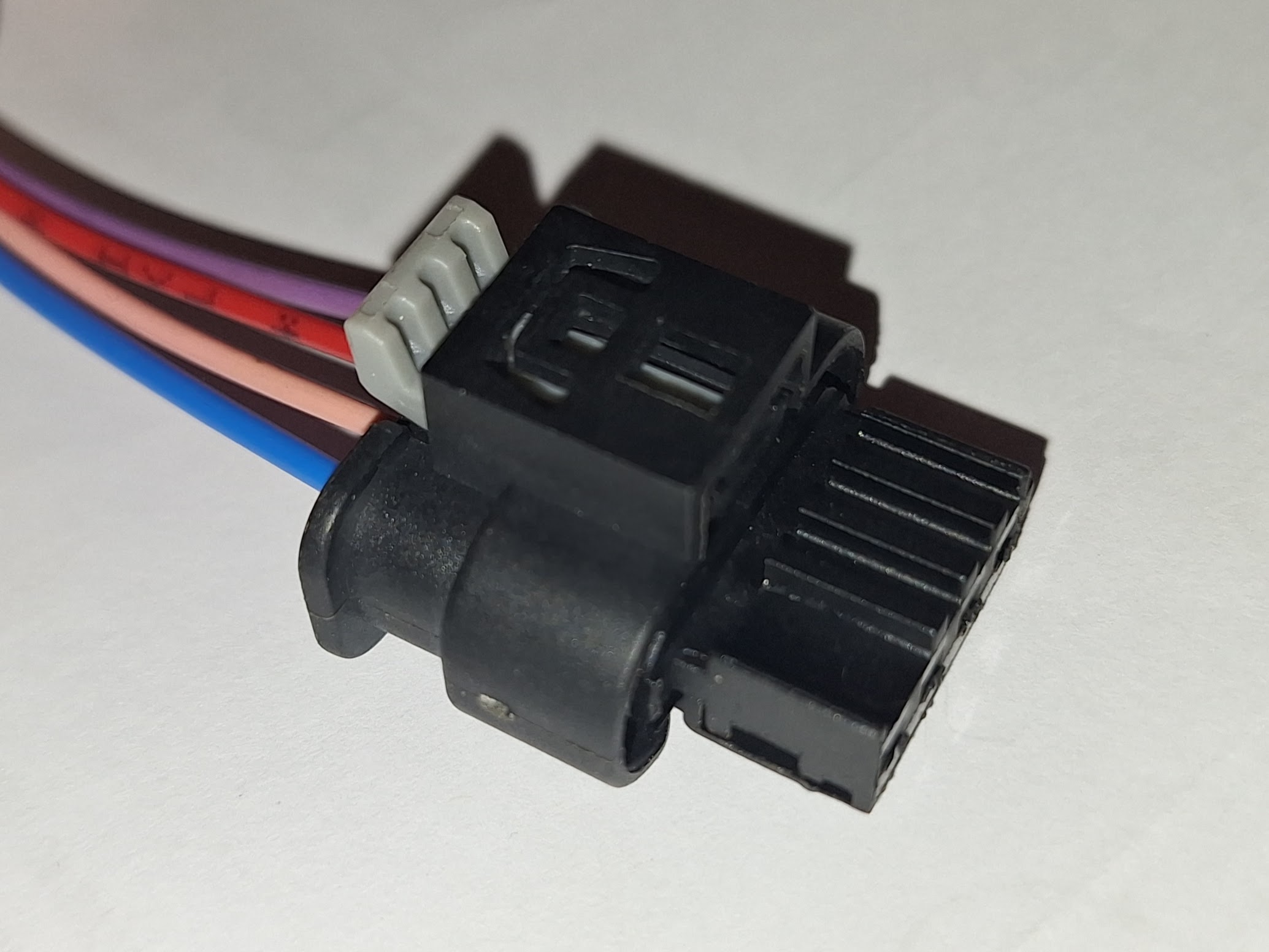

I am using the same ibooster from a yaris in my project. To get is to work in failsafe mode I needed to add 120 Ohm resistors to the CAN busses. And than power, ground and ignition.
Found the connector for the sensor on aliexpress
https://nl.aliexpress.com/item/1005004072725751.html
The connector is still on its way. So I am not a 100% that it will fitt.

Ah thanks for the hint. Were there any messages required to kick it into life, or simply the 120ohm termination?
I was lucky enough to receive the pedal position sensor connector (and it's mini-loom) with the iBooster when I bought it, but I've had to source the main connector and terminals/seals elsewhere.

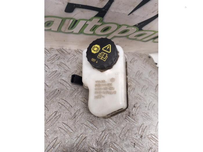

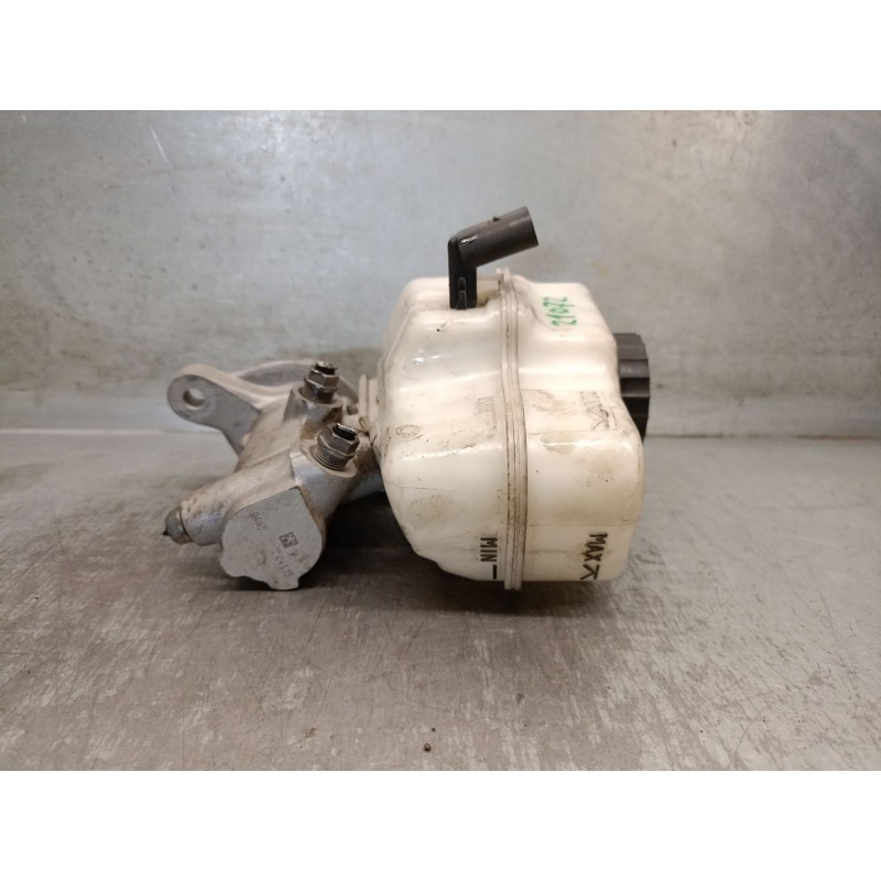

Update on the reservoir - after further browsing and googling, I've found that the reservoir from a VW Golf Mk7 or Passat B8 (LHD version) not only matches the clocking of the Yaris master cylinder, but fits the package space I have and has the fluid level sensor on the convenient side of the reservoir. The part number is 5QE611301.
All I need to do is find one... Since I live in the UK I need to search overseas for this reservoir. I've got leads on a couple but the postage is more than the cost of the item itself. :/ Will have to pull some strings with my EU-based colleagues at work.

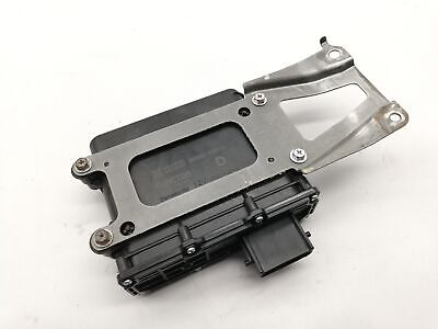

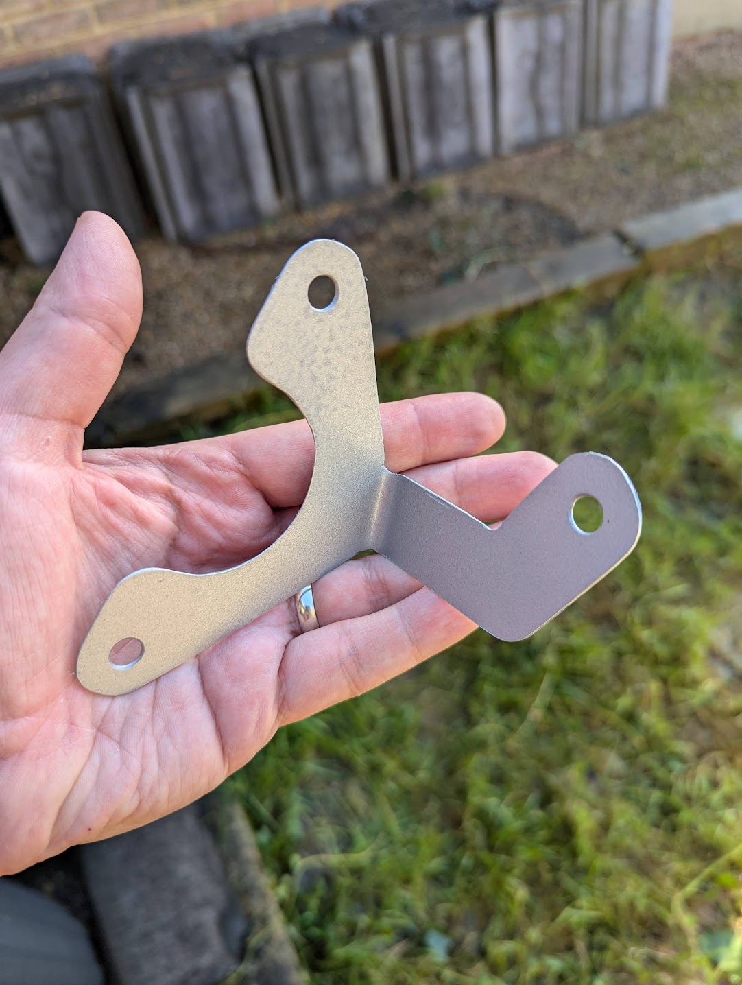

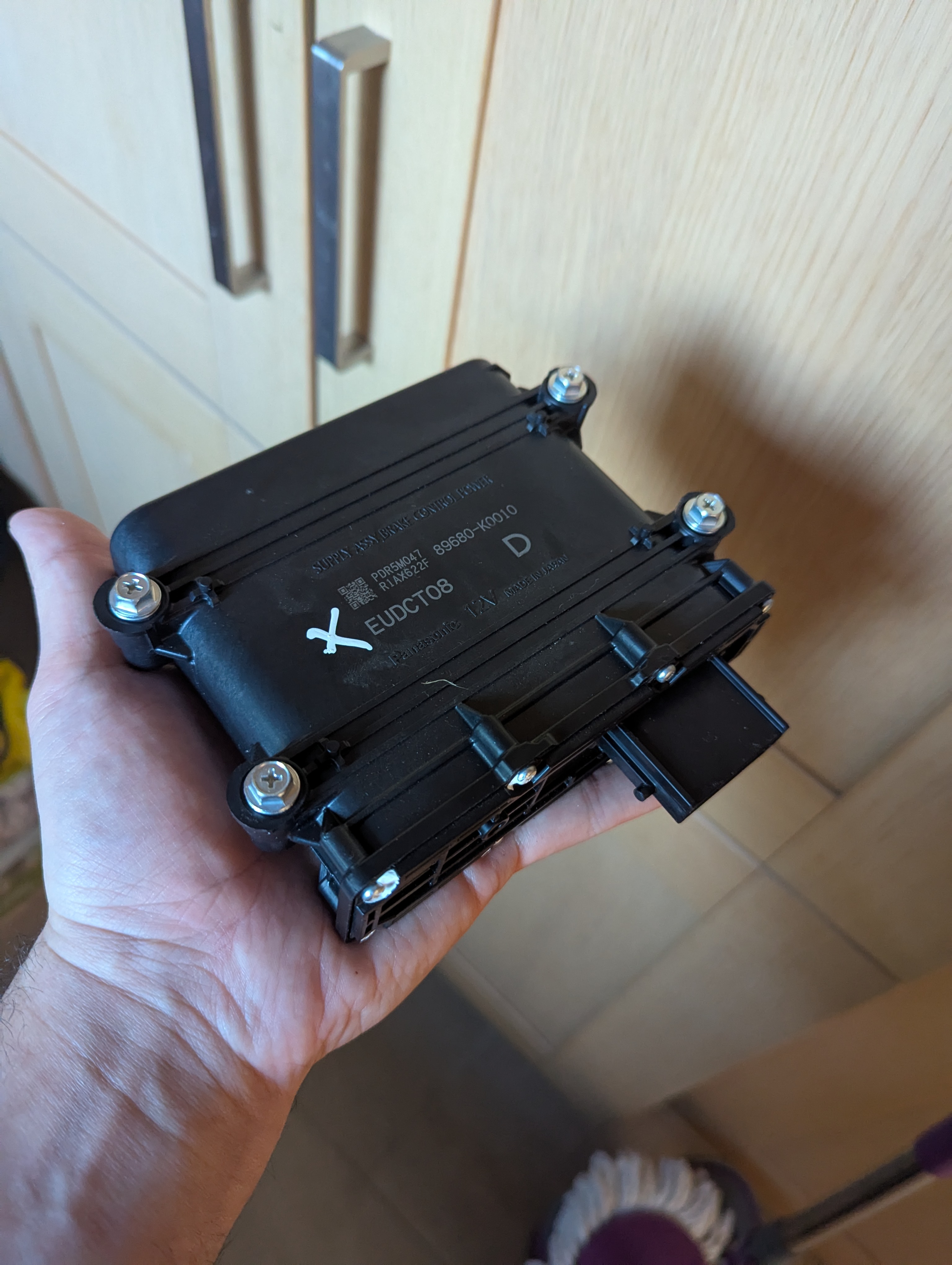

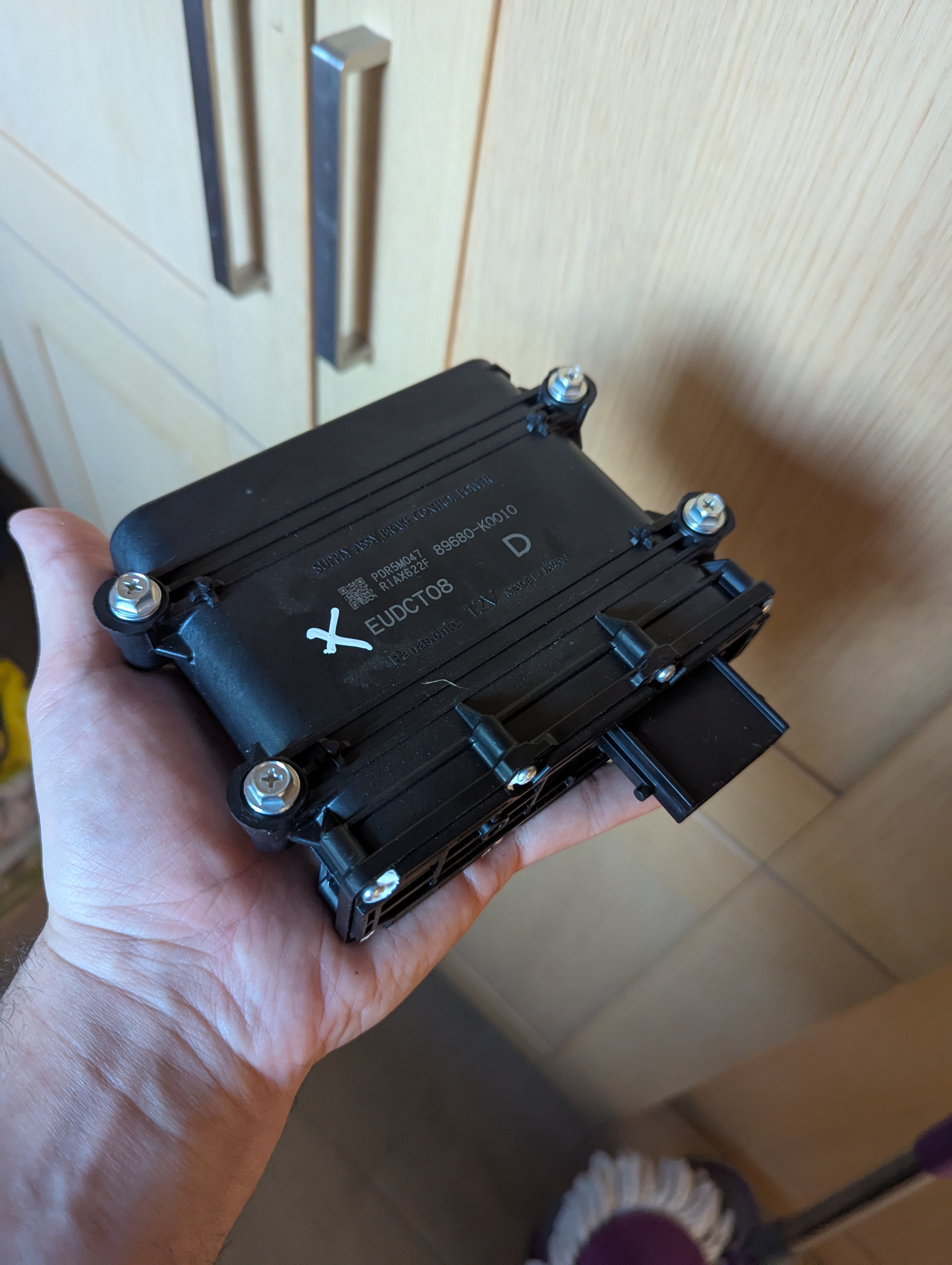

I have received the Brake Control Power Module :D cute little thing that it is.
It's roughly 14 x 12 x 5 centimeters.
I've found a convenient place it, right next to the iBooster, tucked under the wing;
There are three less-than-perfect-but-probably-okay existing mounting points nearby, all on the main fusebox bracketry. I'm drafting up a cardboard template for the mounting plate as we speak.

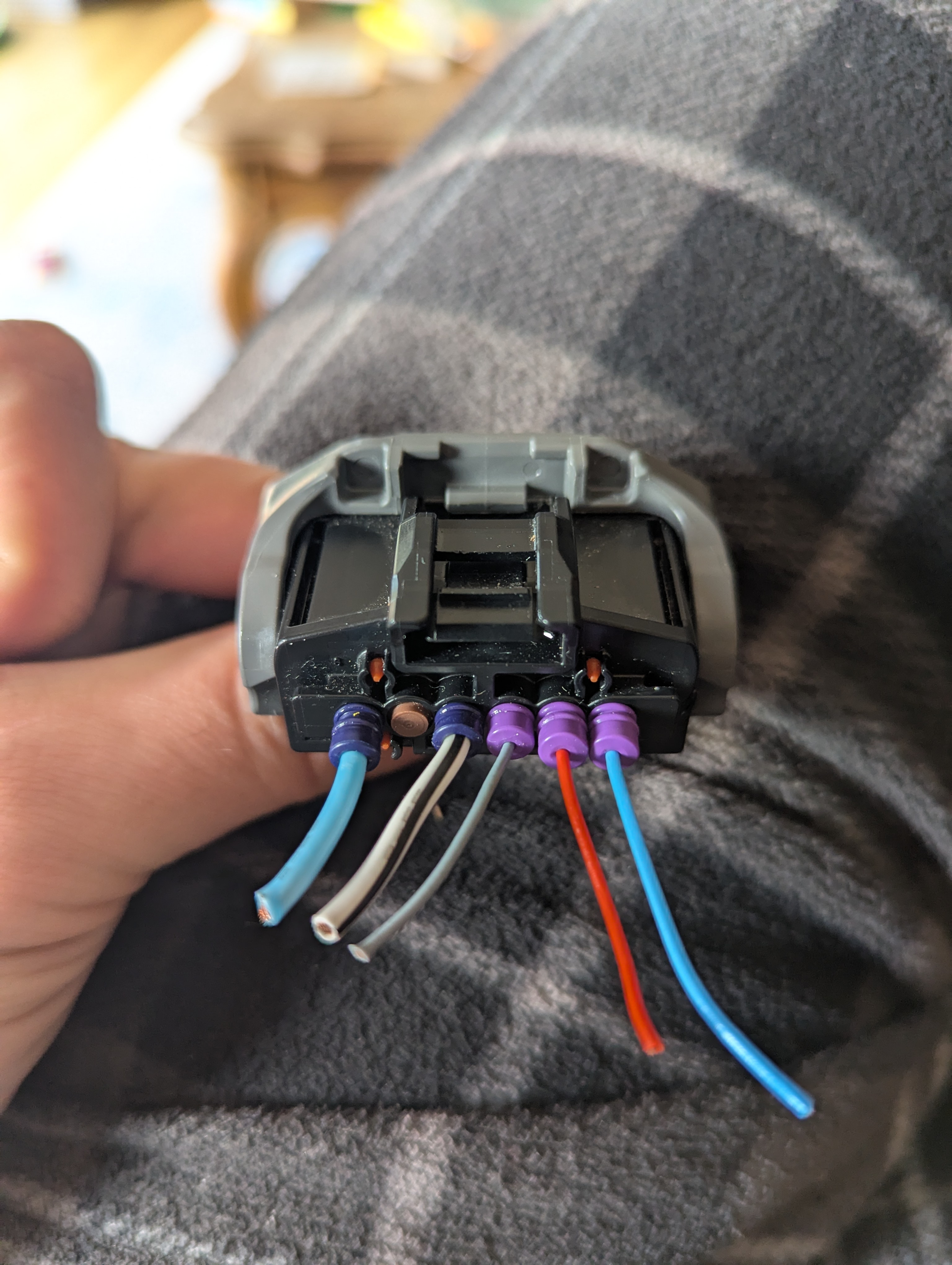

I was careful to order one with the connector, here it is with pins half-way removed;
The connector is as follows;
Terminals;
Sumitomo TS sealed series
8100-0461 (0.5-1.25mm²) (3off)
8100-0462 (2mm² max) (2off)
Pinouts;
04: GND
05: -
I've bought new terminals and am just waiting for some new wiring to come through the post :)

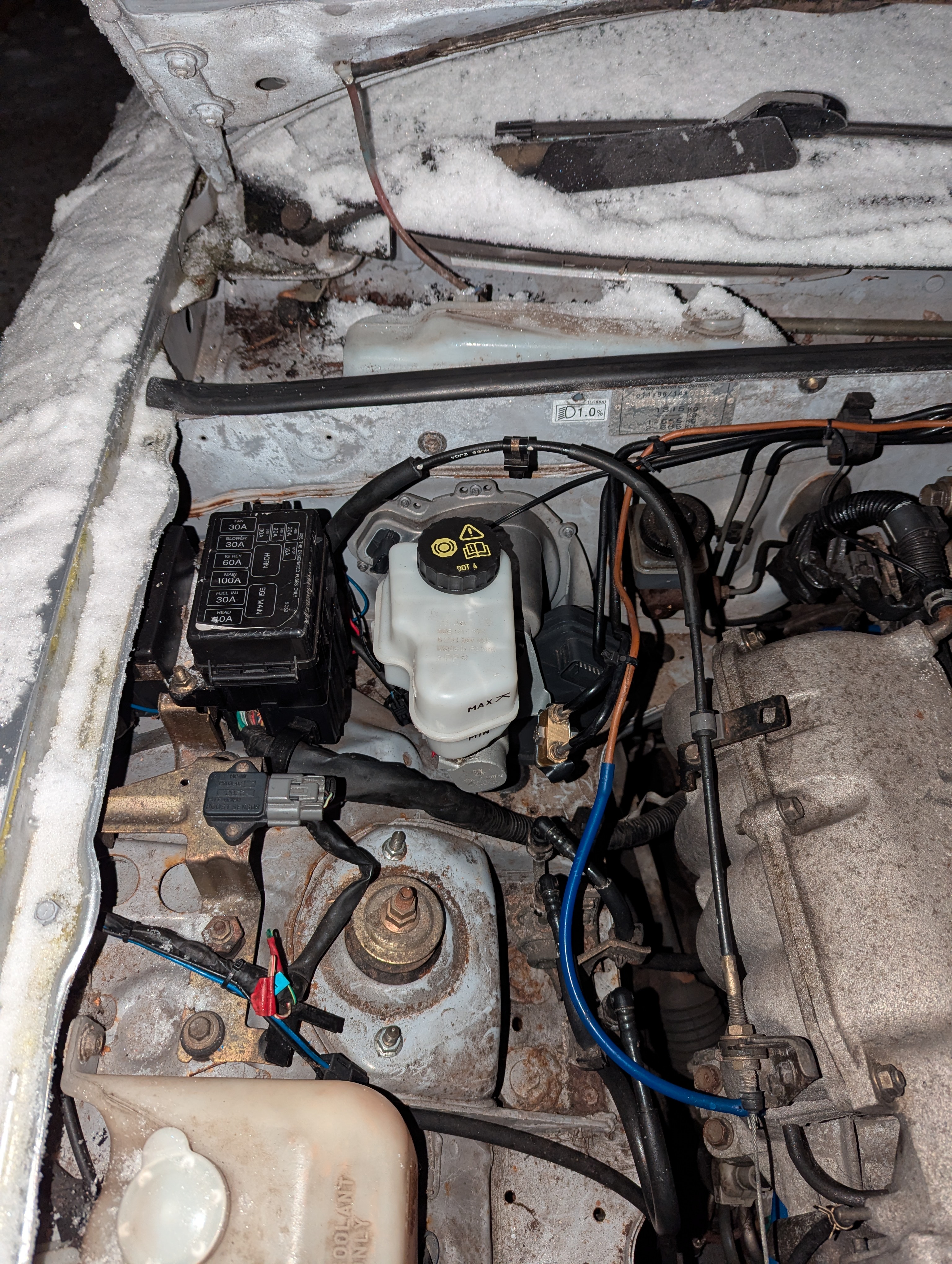

A small amount of "exciting news";
I ended up buying a whole iBooster/master cylinder from Lithuania for ~£110 just for the reservoir :? At least I've got it now, and it fits like a glove in the car :D . I can also sell off the iBooster and reservoir-less master cylinder on the bay to make the money back.
As you can see, progress on the car has been nil since we've been snowed in. Tonight I worked up the bravery to break the ice to open the door in order to open the bonnet.
Also received the new wires today to make up the iBooster mini-loom. Just need to wait for the snow to melt a bit so I can get into my shed and retrieve my crimpers :lol:
I've also got as far as I can with the cardboard template for the power module bracket. I'm hoping it'll warm up a bit tomorrow so I can go out and draft it up in the car.

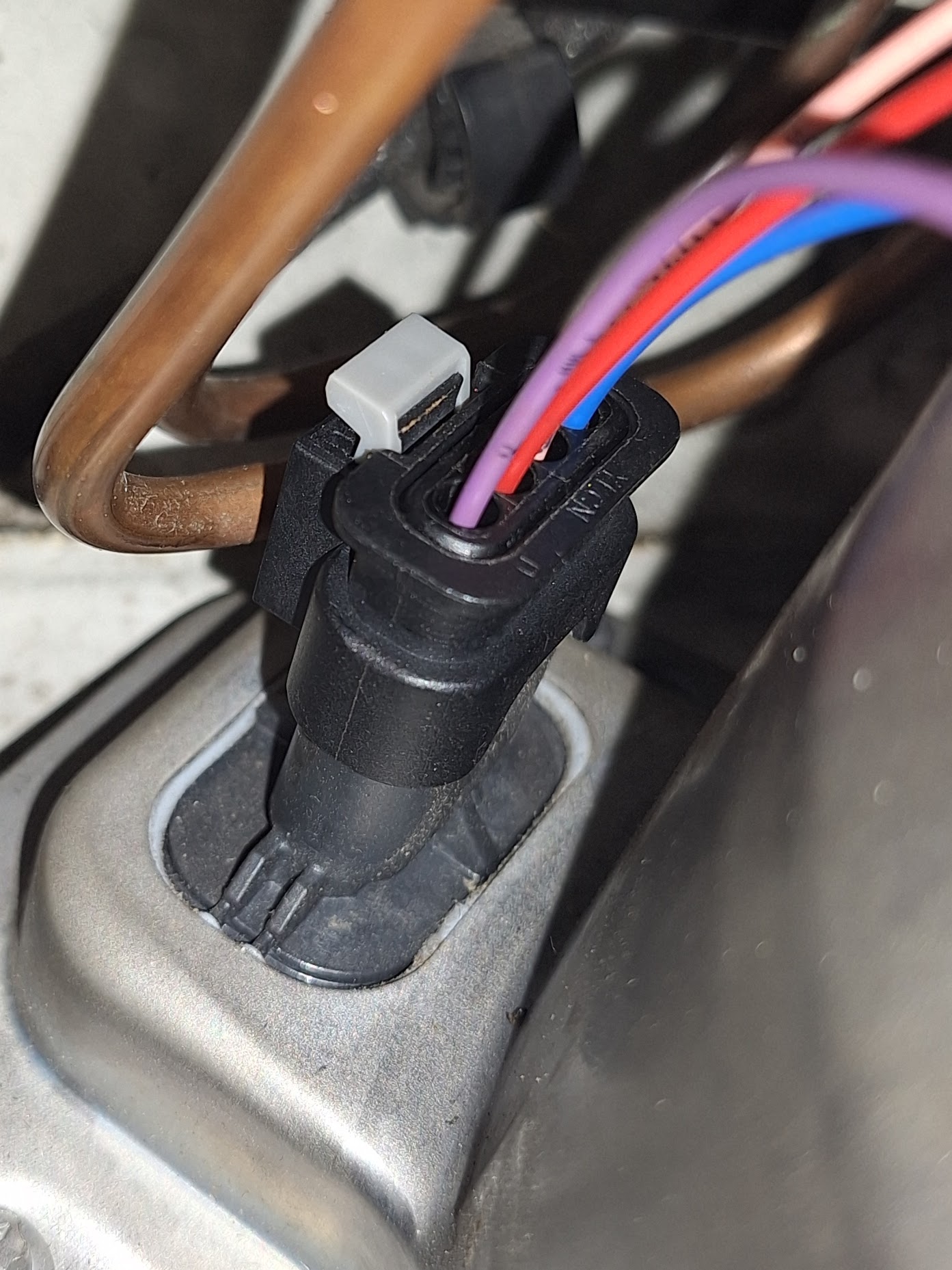

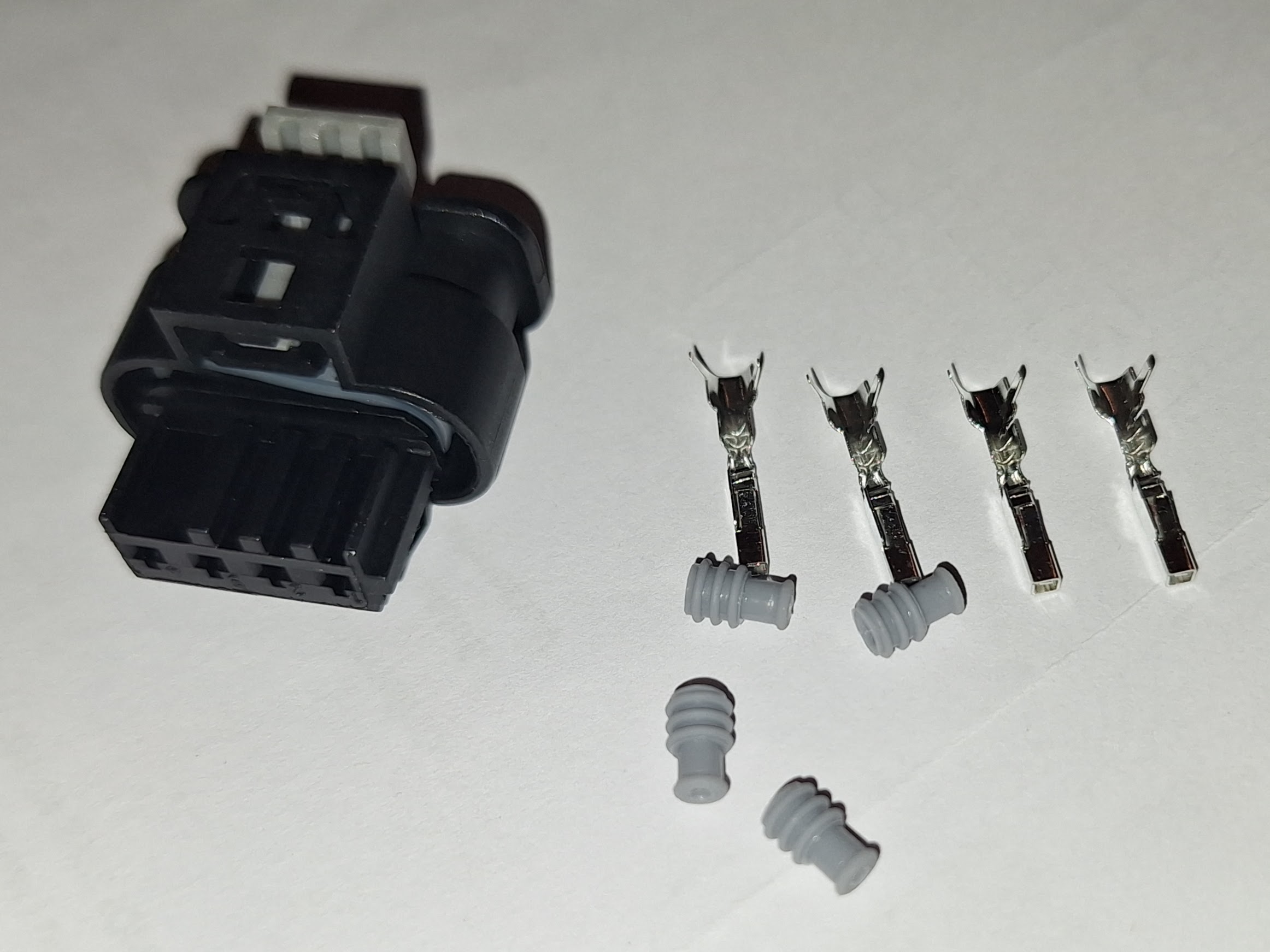

manny wrote: Sat Dec 28, 2024 7:05 pm The connector is still on its way. So I am not a 100% that it will fitt.
After 3 weeks of delay my package finally arrived. I can confirm that the connector fits fine.
parts
parts
wired connector
wired connector
on booster
on booster

Yeah, I also just ordered an adapter for my pressure bleeder- so I can do it alone, I don't always have a second person to help...
Thanks for your heads up!
manny wrote: Mon Apr 28, 2025 6:21 pm I got an adapter to put air pressure in to the brake fluid reservoir.
Put 0,5 to 1 bar of pressure in the reservoir. And than one by one open the bleed nippels.
Make sure you don't push all of the fluid out of the reservoir. If you do, you can start all over again. :?
No does not matter. Even if you do it the old fashion way.

so just as of today I got the Yaris iBooster up and running in my MX-5.
ATM I am not entirely happy with the brake feel. The brake is stiff for a splitt second, then starts to go down to breaking point - I thought there should be more generic feel to the pedal. The breaking itself is sensational, I can get the NON-ABS car to lockup in a breeze... What bugs me is the artifical break feel.

Miata25 wrote: Fri May 09, 2025 1:17 pm Hi,
Greets
Sven
Are you running the additional BCPM?
In answer to Manny and maybe alluding to this issue, I have looked again at the wiring diagrams. I did wire my loom according to the Yaris diagrams, but didn't think too much into it, but the LINbus appears to be only between the iBooster and BCPM. Having connected them, I guess the required messages on LIN are satisfied, maybe this is a factor in why I'm not seeing the same issue in artificial pedal feel?
