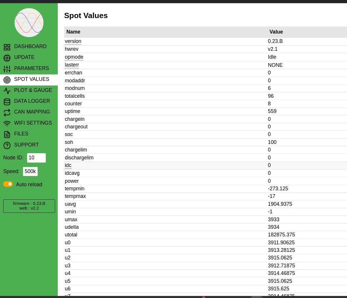

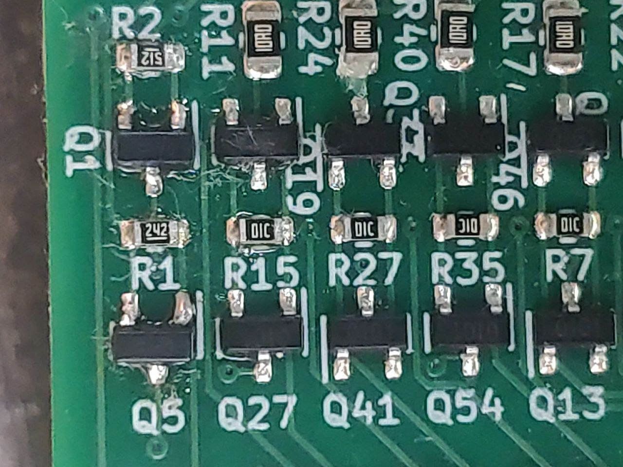

Before I start desoldering and replacing parts:
I rearenged the boards in order of what they are displaying.
measurement with nothing plugge in.
On node 10,11,12,13,14 - Q5=2.3K, Q1,Q44 and Q52 = 5K and all the rest are 10K
On Node 15 few of them are different.
- Node 10 and 11 work fine and displaying cells voltages accurate. OPMODE = Idle (node10) and Run (node11)

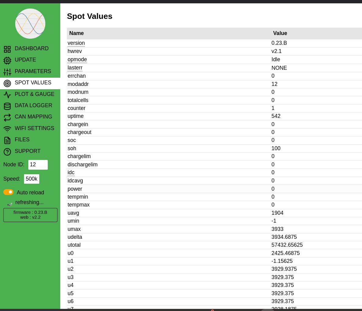

- Node 12 opmode = Idle and displaying first 2 voltages inacurate. (Q1 and Q5?)

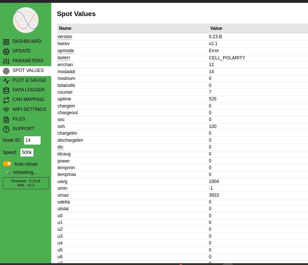

- Node 13 and 14 no voltages and opmode = error; lasterr = CELL_POLARITY no voltages displayed.

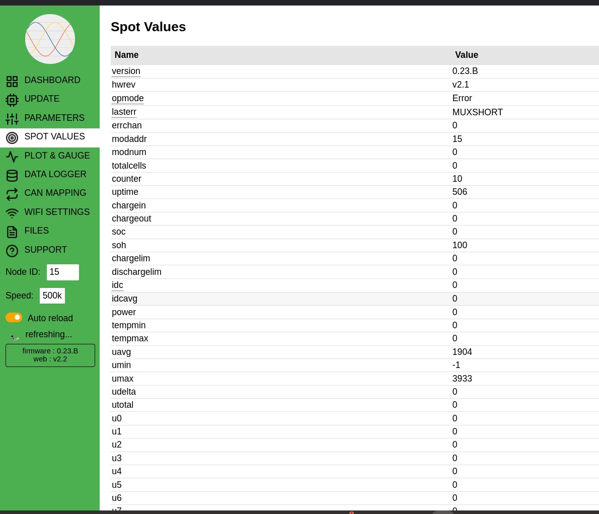

- Node 15 opmode = error; laserr = MUXSHORT
** withouth the battey cables plugged in all 6 red LEDs blink fast.
with the battey cables plugged in node 10,11,12 blink fast and node 13,14,15 blink slow.
- On which node should I replace Q1 and Q5 -?

Yes, Node 12 should be repairable by replacing Q1 and Q5. Node 13 and 14 have also blown PFETs which you can detect with diode mode. Also the 10 Ohm resistors tend to go as a result. Node 15 might even have a failed ADC or something.
Lets see how many you can repair and I'll send you some free replacements for the rest. They are newer revision with more protection.

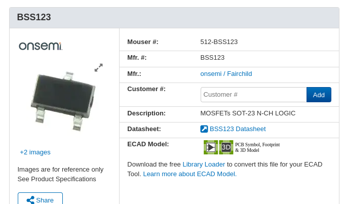

I replaced Q1 and Q5 on node12 but have the same results.
I ordered from mouser.com and it says in the description that isa BSS123 but that does not show on the part. not sure if that can be a problem.
Posts: 6969
Has thanked: 455 times
Been thanked: 1771 times
Re: Flying ADC 16 channel BMS 96S test
Yes small SMD parts only have some code as there's no space for a full label

So, if you want to tell me how to measure or what to measure, I can do it. other that that I am stuck.

Did you read this? viewtopic.php?p=78587#p78587
Here is a quote but I think it is better if you read the roughly 8 posts down from the link
u1 if off because of the missing FET, but there also seems a broken PFET messing with the other values. When I fixed your modules previously I went over all FETs with a diode test mode. They should read 0.5V or so from Drain to Source. Any more or less means it is broken and needs replacement.
It is hard to tell from the values alone which FETs are affected because a broken one skews the other channels as well
If you order anyway go for the specified BSS123 (N) and PJM10H01PSA (P)
EDIT: some pictures:
This is a good MOSFET. Red probe on the single pin, black probe on the lower left one (or upper right for the mirrored FETs). Diode test mode
This is a shorted one.
Sometimes you will find some that do not conduct at all, they are also broken. And also measure the resistance of the 10 Ohm resistors directly behind the cell connector

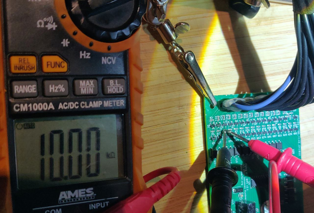

R1,R10 = 2.3k and R2,R33 = 5K; The rest of them are 10K.
Q1 and Q5 that I just changed are showing 0v all others are showing 0.5v
I can swap them one more time, but are the R1 and R2 values correct?
Posts: 6969
Proton wrote: Mon Mar 03, 2025 9:19 pm R1,R10 = 2.3k and R2,R33 = 5K; The rest of them are 10K.
No, not these. To the left of the FETs
Proton wrote: Mon Mar 03, 2025 9:19 pm Q1 and Q5 that I just changed are showing 0v all others are showing 0.5v
They a NFET, I was targeting the PFETs, i.e. all others. For N you need to swap probe polarity. Although 0 would mean blown in either direction...

I measuered again Q1 and Q5 with the negative on the middle/single pin and they both show 0.5V.
johu wrote: Mon Mar 03, 2025 10:35 pm No, not these. To the left of the FETs
Which left? what is their name. R11 --> R20 are all 10k
All Qs are 0.5V except that I had to measure Q1 and Q5 in reverse polarity to show 0.5v

Proton wrote: Mon Mar 03, 2025 11:29 pm Which left? what is their name. R11 --> R20 are all 10k
Left on my pictures. But yes R11, R24, R40 (the numbering is wild). Sure they are 10k? Should be 10 Ohms without k
With all that checked you still get bad readings? Which board are you working on?
Can you check if R9 is 1k or 100 Ohm? If 1k replace with 100 Ohm

R33, R2 = 5K, R1 = 2.3k, R15 - R25 = 10k,
R11 - R20 = 10k Ohm, R39 = 10 Ohm.
Most of the small ones are 10 kOhm and the big ones are 10 Ohm.

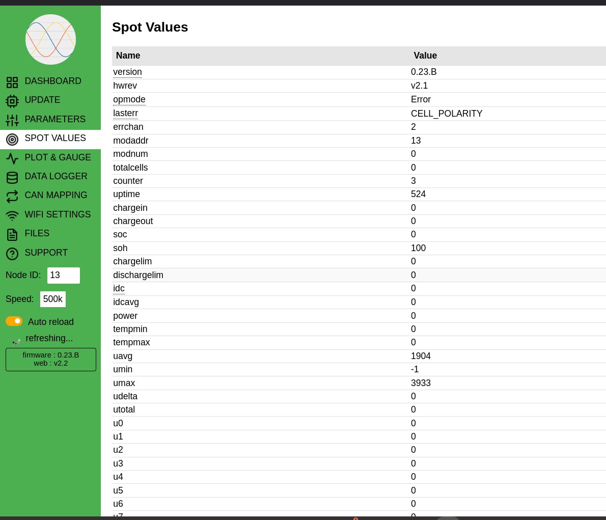

updated 4 boards to 0.23B, board number 2 on the chain was flashing slow, all cells were show 0 on spot value tab.
went to parameter, enable was off....aahh turned it on...i heard like popping on the bms board. those weird values appeared on the web
went ahead and updated the last 2 boards. the showed 0 also, i turned enable on on board number 6 in the string, same popping sounds and the same weird values.
i did unplugged all cells from the boards before updating.
bms-params-march12-023B.json
(766 Bytes) Downloaded 898 times

Today I tested this version on my 32S LFP test pack and v2.0 hardware where it worked flawlessly (on the desk I just test with a 16-cell "simulator" that also indicates mux issues with increased current draw). The ones that blew up were also the ones with wrong min/max? Which components did blow up? Which error did it detect prior to popping?
Also when the board reports an error you better be careful, especially on "MUXSHORT".

Yes MUXSHORT means random transistors are conducting and may drain cells. I would expect that the board must have also been quite warm.
