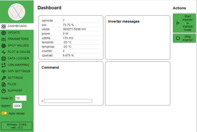

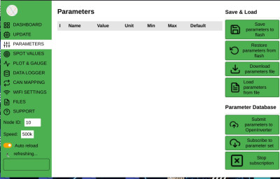

I'm using new web UI for BMS... it's great...
Added some quick code to display BMS info on dashboard if response is not from the inverter but from BMS.

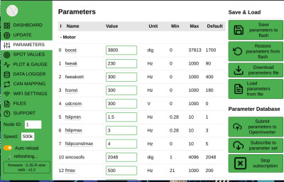

And here is my parameters file ...

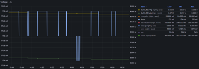

Current delta is about 175 mV. I think it dropped from the 210 mV initially because of the charging cells and various SOC accross series.
I collect all CAN data into the influxdb so I can browse history easier...
Here is values in the last six hours.
There is constant voltage drop visible in the chart... that is because of the constant load of about 80 mA for powering supporting hardware.

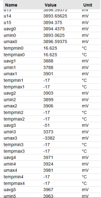

As mentioned in the main BMS topic, I've update firmware to 0.20.B and connected one NTC sensor to the first BMS board and Temp1.
Working great and showing what I think is correct temperature - around 16 Celsius degrees.
On first two boards I've managed to upload firmware using web UI and can, but on the last four it just didn't work, always stopped on the third packet from web. I think it's something with an EPS32 because I need to restart it to continue browsing web UI.
I took ST-Link again and updated all without any problems.

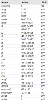

But after restarting boards, board 4 started to report incorrect values, here is readings from master board and board #4 What could be a reason for that? I do have +12V and enable pins connected together if that matters.
Re: Flying ADC 16 channel BMS 96S test
Last night, I checked the modules’ temperature by hand after powering them off (but still leaving them connected to the battery box).
Module #4 was hot - I would say: similar to what happened with module #2 back in September, which had a shorted MOSFET. I’ve now disconnected all modules from the battery.
@johu, I reviewed earlier posts and saw you reported fixing Module #4 in October, but I suspect that might have actually referred to module #5, since I only sent you #2, #3, and #5.
Any suggestions on how to proceed with #4?
Thank you!
Thank you!

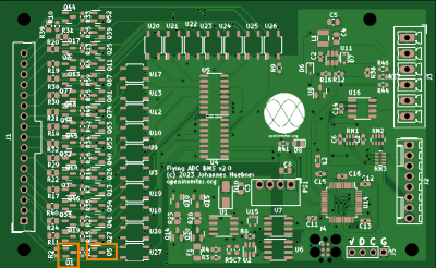

Yes that is another mux failure. Did you have the battery connected while updating via SWD? Maybe some pins randomly toggled while flashing. I think I have to add pull-down resistors to the respective pins.
Remove Q1 and Q5 and see what that does. If you then get readings from the other channels replace Q1 and 5 with new FETs (any 100V N-FET)
Yes, these two.
When updating firmware via CAN the processor actively pulls low the control gates. But when updating over SWD they are configured as inputs and can float away.

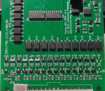

I managed to desolder Q1 and Q5 myself using a hot air gun - new skill unlocked!
After reconnecting the BMS to the battery, I’m still seeing problems:
Not all channels are functioning correctly. I don't know whether this is due to the missing components or if other parts are also damaged.
Since none of the local stores has 100V N-FETs, I’ll order them online and it should be here in few days.
u1 if off because of the missing FET, but there also seems a broken PFET messing with the other values. When I fixed your modules previously I went over all FETs with a diode test mode. They should read 0.5V or so from Drain to Source. Any more or less means it is broken and needs replacement.

I ran a diode test on the FETs. Most measured about 0.585 V, but I got a “beep” on four of them
- Q39
- Q11
- Q87
- Q81 At the moment, JLC is the only source that has these parts in stock. If there are no other suggestions, I’ll go ahead and order replacements from them.
- Q39
- Q11
- Q87

I've received the P- and N-channel MOSFETs and replaced all six components from my previous messages.
After the first attempt, I got these readings:
I expected u0 to be correct but found that Q5’s source pin wasn’t making contact with the pad below it. After fixing that and verifying all MOSFET connections on all three pins, everything checked out.
The only questionable MOSFET is Q44—it measures 0.5V drain-to-source, but drain-to-gate shows nothing, whereas other MOSFETs measure around 2.5V.
After reconnecting to the battery, u0 and u1 improved, but the last seven series still appear bad:
To investigate further, I measured the resistors, and several are far off from their expected 10Ω values:
All other resistors measured correctly. Since most bad resistors are tied to the cell voltage pin trace, that likely explains the incorrect readings for u5–u8. Not sure how R23 will affect things, though.
I'm open to any other suggestions for testing. Otherwise, I’ll order replacements and swap them out.
u0 1.15625
u1 0
u2 3894.46875
u3 3895.03125
u4 3894.46875
u5 3866.25
u6 3903.25
u7 3886.21875
u8 3902.6875
u9 3835.71875
u10 -177.34375
u11 403.46875
u12 -3.5
u13 0
u14 0
u15 0
u0 3887.6875
u1 3885.1875
u2 3885.65625
u3 3886.21875
u4 3886.21875
u5 3845.125
u6 3904.4375
u7 3879.78125
u8 3894.46875
u9 3673.03125
u10 -1934.59375
u11 4465.90625
u12 -13.5
u13 0
u14 0
u15 0
R22 56Ω
R29 25Ω
R32 30Ω
R18 16Ω
R21 413Ω
R30 59kΩ
R38 700kΩ
R19 -
R20 -
R39 220kΩ
R31 -
R23 1.3MΩ

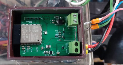

Not sure what am I doing wrong.
I connected the CANH and CANL from the inverter in parallel with the wires coming from the BMS.
on Node 1 I am getting the info from the inverter fine, but I cannot get any info from the BMS-es. on node 10 to 15 I am not getting the red banner on top that show you are not connected to anything, so that means that I am connected to the BMS?
Is node 10 the default start for the BMS?
There are red light blinking ion each BMS.
Yes 10 is correct. Can you turn off auto refresh, enter node 10 then refresh the page?
