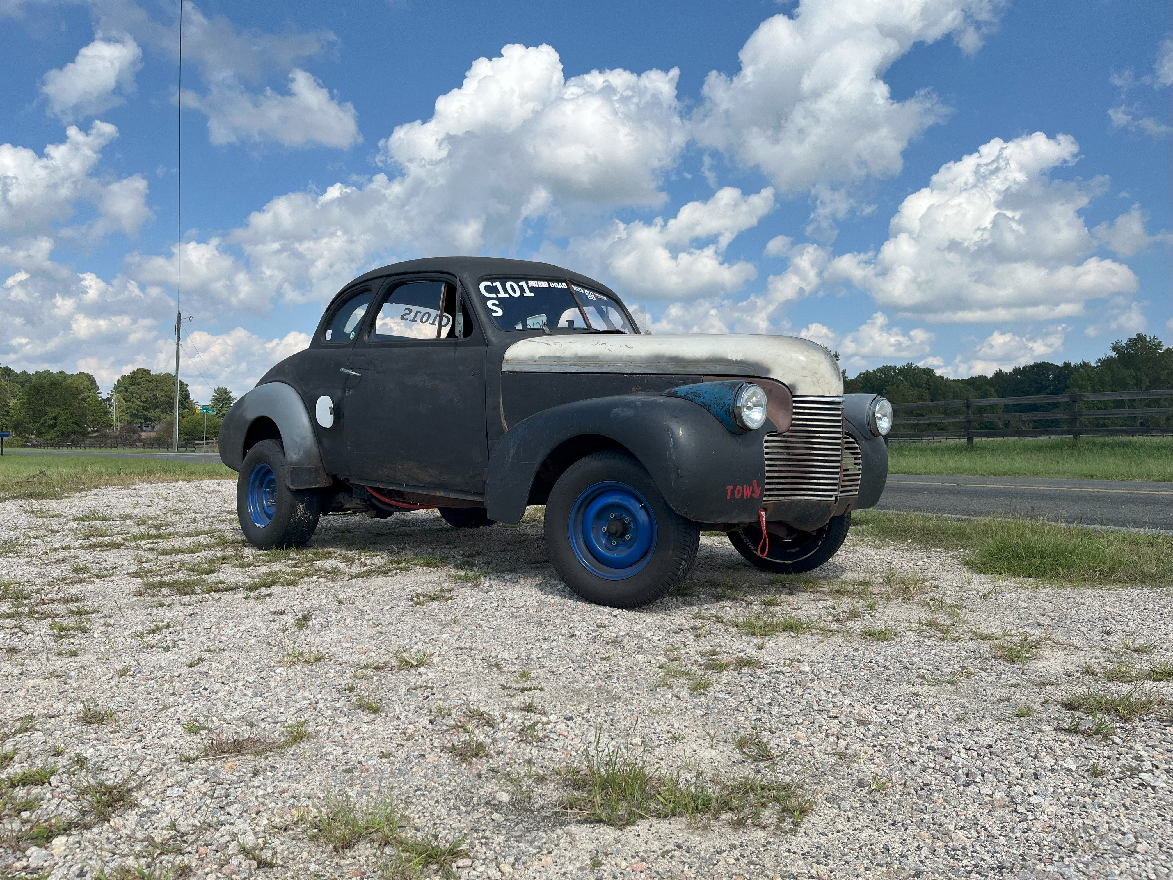

In the scramble to make it to Drag Week, I didn't post much, but now that the event is over, here's the update:
I did get the Bolt charger and DC-DC working, though not exactly how I wanted. I had to cut bait, and just use a PWM generator that I manually adjusted to run the charger. The DC-DC was setup how I wanted, but I discovered an issue; the DC-DC keeps running sometimes when the PWM is removed, so at times it kept the car powered when I tried to shut it off, as an alternator can sometimes do. I've still got to work on that.
I got CCS fully wired and talking to the station, but my board was not providing current requests fast enough for FOCCCI to be happy. I believe I found the issue in my code, but haven't been able to update it (the Arduino IDE on my personal laptop was acting up, and my work laptop was at home). I think the slower pace of the Voltage message coming in was disrupting the current request going out.
The car and it's patched together inverter did great! No major breakdowns (only a rough road shaking some body panels loose), slightly higher efficiency than last year, and good runs each day. I don't know if the terrain, my driving, the dc-dc, tire pressure, tune, or something else led to the higher efficiency, but it did seem closer to 360Wh/mile rather than 400Wh/mile. I need to do more logging to make sure I have that right before saying the range is actually longer.
In terms of performance, I did have two runs trigger the gate driver desat shut down, but 7 runs go cleanly. It does seem that a long burnout reduces the likelihood of a shutdown (maybe from heating the motor?). Best run of the week was an 11.75 @ 114. Some more info on the event is in the thread here: viewtopic.php?p=75187#p75187
Moving forward, I want to get CCS running, get the OBC running automatically, and fix the DC-DC shutdown issue. Plus a few general repairs/upgrades like trunk and window seals. Then its just more tuning and suspension tuning to get the car quicker. I do think low 11s are possible, and maybe even 10s, though that may require a full Sport inverter.

First, I addressed an intermittent issue with my DC-DC subverting the emergency disconnect. This has only been an issue with the Bolt DC-DC, because it will continue operating when the PWM drops out and apparently, when the 12V battery drops out too. I had originally wired my emergency shutdown, which I also just generally use to shut everything off, with a 12V contactor that was controlled by the dash and rear emergency switches, and then my HV safety contactor received 12V power when the 12V contactor was on. This worked fine, except with the DC-DC continuing to operate, it kept supplying 12V to the safety contactor. I also think there may have been a slight wiring issue in the control of the DC-DC's contactor which was preventing it from dropping either. Regardless, I solved the issue by placing the HV safety contactor in parallel with the 12V contactor, so both are only able to get power when the emergency switches are in the correct position. Should have been this way from the start, but its fixed now.
While I was messing around with this wiring, I finally added the now NHRA required full car 12V fuse which had been sitting on the workbench for 6 months. (every circuit is individually fused, but they want one master one now too).
I also did a bit of tweaking on the CCS curve, and I think I'm pretty happy with where it is. Only tested on one charger, but should get more next weekend.
On the way home from testing the CCS curve, I also stopped to get groceries, and given the suspension of the 40, I'm pretty sure the eggs I bought are now pre-scrambled (but at least none broke). But I love the confused look on people's faces when this rolling junkyard quietly pulls into the parking lot, and I get out like it's completely normal.
I'm considering going to Sick at the Rock next weekend for some racing, but still TBD.
