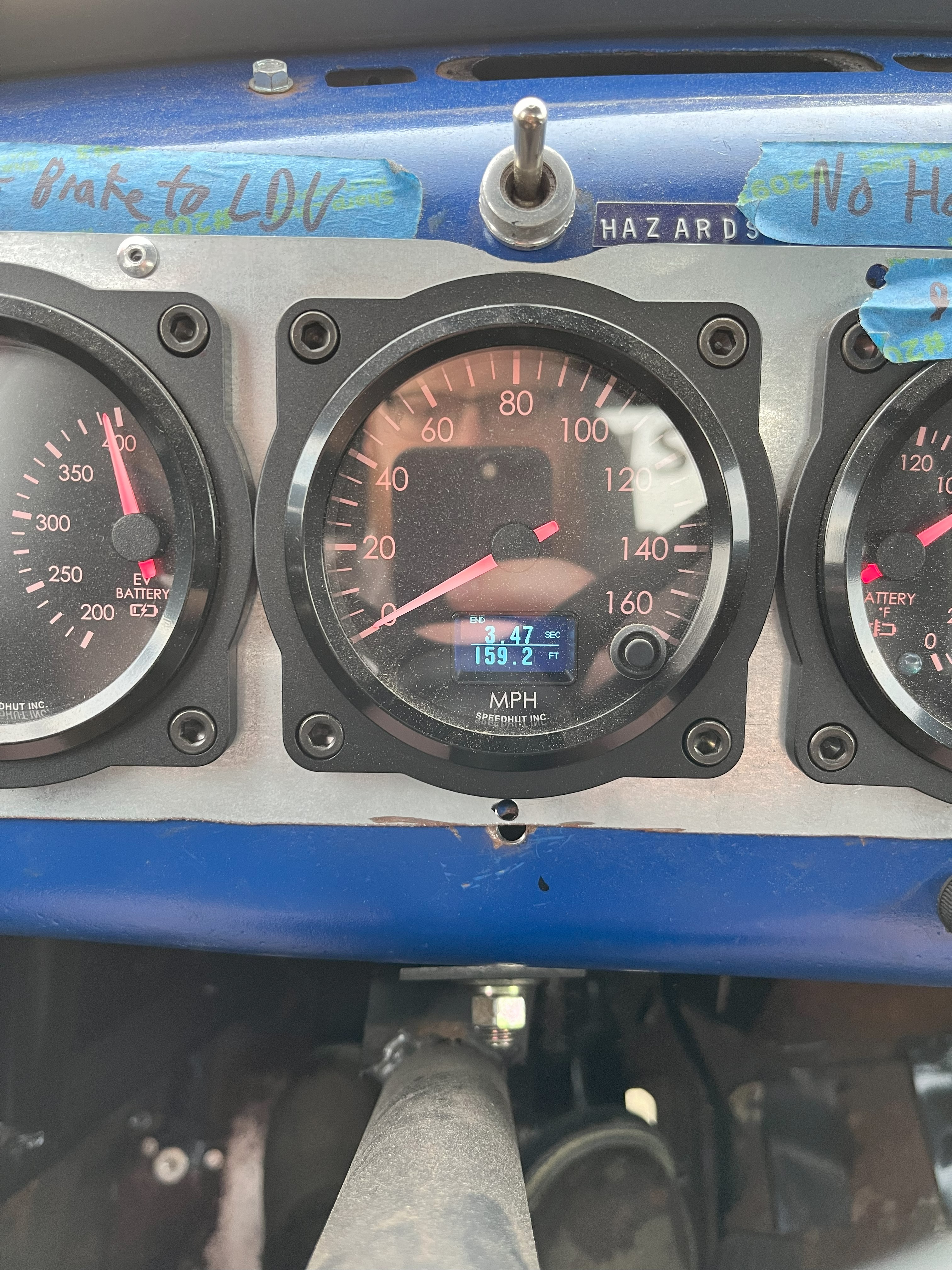

The car and it's patched together inverter did great! No major breakdowns (only a rough road shaking some body panels loose), slightly higher efficiency than last year, and good runs each day. I don't know if the terrain, my driving, the dc-dc, tire pressure, tune, or something else led to the higher efficiency, but it did seem closer to 360Wh/mile rather than 400Wh/mile. I need to do more logging to make sure I have that right before saying the range is actually longer.
In terms of performance, I did have two runs trigger the gate driver desat shut down, but 7 runs go cleanly. It does seem that a long burnout reduces the likelihood of a shutdown (maybe from heating the motor?). Best run of the week was an 11.75 @ 114. Some more info on the event is in the thread here: viewtopic.php?p=75187#p75187
Moving forward, I want to get CCS running, get the OBC running automatically, and fix the DC-DC shutdown issue. Plus a few general repairs/upgrades like trunk and window seals. Then its just more tuning and suspension tuning to get the car quicker. I do think low 11s are possible, and maybe even 10s, though that may require a full Sport inverter.

I spent all afternoon and evening on Saturday playing with the '40. This included charging testing, efficiency testing, acceleration testing, and simple cruising.
First, I tested my new CCS charge curve. I'm fairly happy with it, but it ramps down a bit too aggressively so I sat at 25kW and 8kW for a long time on a 100kW charger. But doing a stepped ramp worked better than a linear one, and reporting SOC in 10% intervals seemed to make the station a bit happier.
Then, I did an efficiency test. From the charger I was using to test, there's a good stretch of road that is very similar to the routes we get sent on for Drag Week (4 lane divided with stoplights every couple miles) that ends in a small downtown area about 13 miles away. So I drove there, got lunch, and drove back to the same charger, and charged to full again. In total: 27.3 miles consumed 10.235 kWh, meaning 2.67 mi/kWh or 375 Wh/mi. Assuming that the pack retains the energy capacity it had the last time I did a zero to 100% charge of 28kWh, that means a max range of 74 mi. I'm saying it has a safe range of 65 mi, given that I really don't want to push the battery that low.
I went home for a bit to handle other things, and then took her back out. First stop: acceleration testing. I remembered that the GPS speedo I put in the car has a 0-60 timer built in. Well with the "street" tune in it, which is what ran 12.1 sec in the 1/4 all week at DW 2024, it pulled a 3.47sec 0-60. And did it twice in a row.
Then, I headed into downtown Raleigh to grab some dinner, BBQ with a Cheerwine (NC based cherry soda).
Then I did some cruising around downtown and over to one of my favorite parts of the city, Dorothea Dix Park, before heading home for the night.
