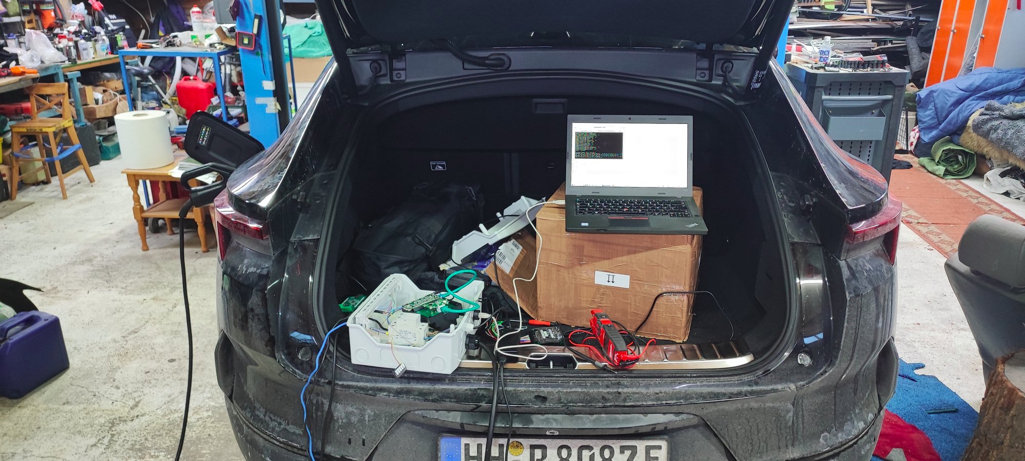

Using redbeet
Hi. I am new to pyPlc. Currently I am using redbeet pev and a DUT evse. I am struck at cable check stage. I will attach my log below.
https://github.com/Danuja004/pyPlc-logs/issues/1
- uhi22
- Posts: 1243
- Has thanked: 244 times
- Been thanked: 684 times
The log shows, that the EVSE responds the first cable check request with "pending", so it wants an other round, this is fine. The EV sends the second cable check request, and then the EVSE is dead. It does not even send a TCP ACK anymore.
This is a quite "hard" behavior (I would call it even "wrong"). In case of a failed cable check, the EVSE should at least send the related response code.
You should check what's going on inside the EVSE.

I did another test with the Audi Q4 (aka MEB) yesterday but again didn't get past cable check. It simply stops communicating
The PWM should now conform to the standard so I wonder does it also expect some voltage on the power pins during CableCheck?

- uhi22
- Posts: 1243
You could check this hypothesis by connecting the Q4 to a public charger with just CP, PP and PE, and measure the DC voltage on charger side to find out whether it ends in cablecheck or precharge or even reaches the currentdemand.
- Been thanked: 1913 times
Yeah but then how do I know? The chargers don't display the exact state they're in.
I hope next time Mr. Q4 has more time, then I can also try applying some voltage during CableCheck
Edit: Does CableCheck report any voltage via EXI? Doesn't look like it in the source but maybe I missed it

No, no voltage is reported in exi during cable check. Ask Mr Q4 to arrive with low SOC. Then precharge has something much below 400V, and cable check depending on charger has e.g. 450 or 500V.
Would be helpful to have an PLC sniffer ready but this is still on its long way.

Just for the record we got the Polestar 4 to close its contactors. We didn't draw any power though.
Uhi fixed a problem in OpenV2Gx https://github.com/uhi22/OpenV2Gx/commi ... d86a159a47
