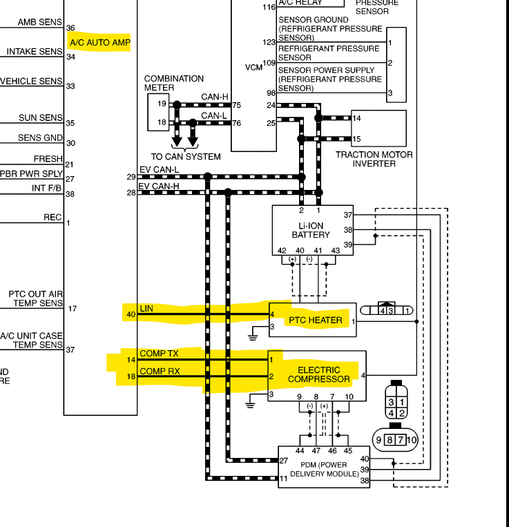

I've got a question for all on this thread. I noticed that the Nissan Leaf models without a heat pump do not have a direct LIN communication line to the compressor, but rather a "COMP_TX" and a "COMP_RX" to the compressor. These compressors are the Panasonic ones. It appears that the PTC Heater communicates directly, via LIN, to the A/C Auto Amp, which in turn communicates via two communication lines, one TX and one RX, to the compressor. So, it appears the A/C auto amp converts the LIN signal to a UART(?) signal that the compressor can understand. Does anyone know if the same LIN signals we've been discussing on this thread would work for the Panasonic Compressor? If so, how are these signals converted to the two-wire signal that the compressor understands? If not, any ideas?
CraziFuzzy
Posts: 1
Joined: Wed Apr 09, 2025 4:55 am
Re: Nissan Leaf A/C compressor 92600-3NF0A
Post by CraziFuzzy »
I'm not sure there's any sort of direct translation going on here. The AC Auto Amp, I think, is doing the actual climate control job (as well as other things), so it's simply controlling the heater and/or compressor as required/desired. I don't think there is any specific corrolation between the LIN commands previously posted and what the non-lin compressors 'speak.' This is likely a call for all new 'sniffing' to be done on those Tx/Rx lines.
I'm a new lurker here... actually not ready to do a full EV conversion - but am interested in using an EV AC compressor + battery pack for a different specific project (camper).

CraziFuzzy wrote: Wed Apr 09, 2025 5:04 am I'm not sure there's any sort of direct translation going on here. The AC Auto Amp, I think, is doing the actual climate control job (as well as other things), so it's simply controlling the heater and/or compressor as required/desired. I don't think there is any specific corrolation between the LIN commands previously posted and what the non-lin compressors 'speak.' This is likely a call for all new 'sniffing' to be done on those Tx/Rx lines.
I have a Nissan Leaf A/C compressor, model 92600-3NG0A, which has 4 low-voltage wires. Based on my setup and testing, I believe it's not a LIN-based compressor, but rather a UART-controlled version.
I've connected the wires as follows:
Black wire → GND
White wire → +12V
Blue wire → Compressor TX → Arduino RX (pin 19)
Yellow wire → Compressor RX → Arduino TX (pin 18)
I’ve also connected the high-voltage (HV) lines appropriately and used the following Arduino code to communicate with it. However, the compressor does not respond or operate.
Could you help identify what might be wrong with the setup or code? Any guidance would be appreciated.

I'm not sure how the UART ones work, wish I could help more with this. Perhaps CraziFuzzy can help, or someone else on this thread. I am also confused about whether or not there is LIN to UART translation for the UART compressors. CraziFuzzy thinks that there is new sniffing that must be done for these, and I believe this may be correct.
