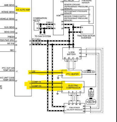

I looked into it and remembered some more information. Pin 5 is connected to the "SLP" (sleep, I believe) input on the LIN Transceiver. There are four inputs to the LIN transceiver: Rx, SLP, Tx, and GND. The Tx and Rx connect to the Rx and Tx, respectively, on the Arduino. I believe Tx on the arduino is PIN 18, which goes into the Rx on the LIN transceiver. I believe Pin 7 is the on/off switch, as you surmised. I don't remember what the SLP pin on the LIN transceiver does, but I read something about it a while back, and whatever it was made me decide to connect a +5V output from the Arduino to the SLP pin. Does anyone out there know?
I hope this helps, and sorry it's not more definite. Let me know if you have any more questions.

Yes, I think the purpose of the LIN transceiver is to convert the two-wire UART signal to a single-wire LIN signal. I got mine on Amazon. I think it was close to $20.DaveEV wrote: ↑Tue Mar 25, 2025 10:01 pm That's really helpful! I haven't hooked anything up, but it sounds like I'll need a LIN transceiver instead of straight to the compressor. That makes much more sense and I saw a couple models earlier in the chat
@maiks, I'm not sure about any of the compressors. I imagine the code supports both. If I remember, the two compressors that I have a use slightly different mounts to the motor and alignment of HV plug. I'll check the model numbers I have and test both.
Also, Some of the Leaf models use UART, some use LIN. I think the base models use UART. There is a great website with the manuals, I think I reference it somewhere above on the thread. The manuals cover both types of compressors.

That's really helpful. I didn't see the manual in this thread but I'll look elsewhere. I have the following models and will try to get both working. Nissan numbers are:
- 3NG0A: 4-wire (UART?) from 2014
- 5SA7B: 3-wire (LIN) from 2023

I've got a question for all on this thread. I noticed that the Nissan Leaf models without a heat pump do not have a direct LIN communication line to the compressor, but rather a "COMP_TX" and a "COMP_RX" to the compressor. These compressors are the Panasonic ones. It appears that the PTC Heater communicates directly, via LIN, to the A/C Auto Amp, which in turn communicates via two communication lines, one TX and one RX, to the compressor. So, it appears the A/C auto amp converts the LIN signal to a UART(?) signal that the compressor can understand. Does anyone know if the same LIN signals we've been discussing on this thread would work for the Panasonic Compressor? If so, how are these signals converted to the two-wire signal that the compressor understands? If not, any ideas?
CraziFuzzy
- Posts: 1
- Joined: Wed Apr 09, 2025 4:55 am
Re: Nissan Leaf A/C compressor 92600-3NF0A
I'm not sure there's any sort of direct translation going on here. The AC Auto Amp, I think, is doing the actual climate control job (as well as other things), so it's simply controlling the heater and/or compressor as required/desired. I don't think there is any specific corrolation between the LIN commands previously posted and what the non-lin compressors 'speak.' This is likely a call for all new 'sniffing' to be done on those Tx/Rx lines.
