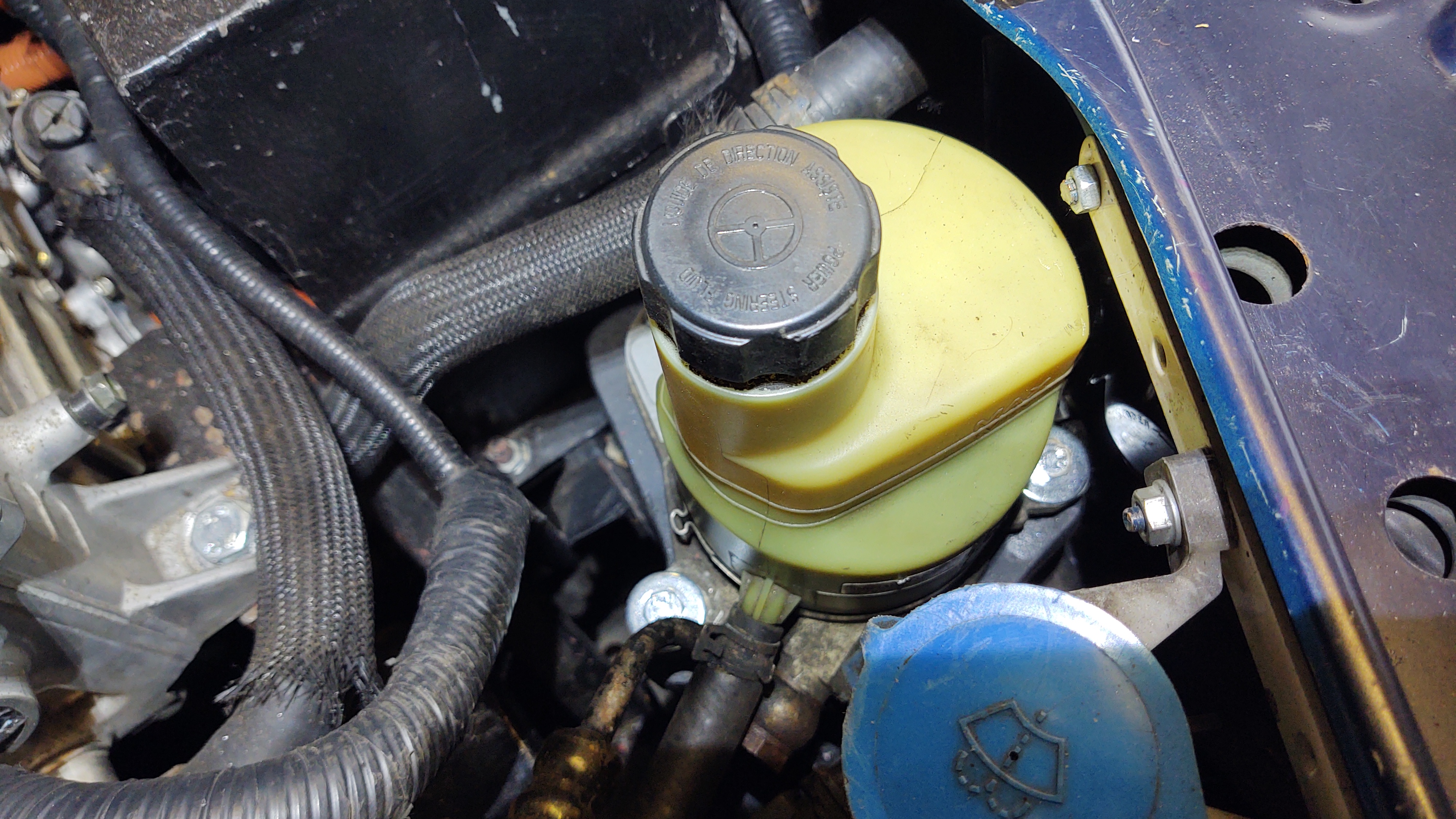

So this week I decided it was time to secure my power steering pump properly instead of just jamming it in with foam packing.
I never got a photo of it installed like this but this is the foam I was using. It worked surprisingly well for a couple thousand miles.
So I started by cutting a hydraulic pump shaped hole in a bit of 1.5mm steel then welded a lip onto it.
Before grinding my Fugly welds.
Then I welded on some angle supports.
Before final grind and paint
I then drilled and tapped holes to secure the pump and welded it into position. It is welded to my battery bracket, not to the car so no issue with DVLA
Nice and solid now.
I'm really pleased with how it turned out but I currently don't have any rubber mounts holding it. I just used M8 bolts and washers so I find it much louder then it was before. Hopefully with rubber bushings it will be a bit quieter but I need to figure out a way to make them as they didn't come with the pump.

The PAS pump is much quieter now with these, I think they're called bobbins but they make a big difference.
https://ebay.us/IgouJS
Not quite as quiet as the foam but not as bad as bolting in directly.
