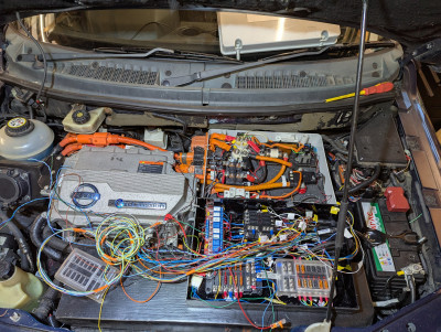

[Driving] Freelander EV With Gen1 Leaf electrics now using Zombieverter. [FINISHED]
Alibro
- Posts: 1111
- Location: Northern Ireland
- Has thanked: 504 times
- Been thanked: 322 times
This one will be a slow burner as I don't do anything quickly but hope to have a working EV in a year or so.
I have owned Freelanders for a few years and for some stupid reason I like them so when I decided to build an EV it kinda made sense.
I have an 04 Freelander which is in poor shape and pretty much worthless so I figured it would make a good test mule for the project. I can butcher it without worrying too much and once complete it will just be a matter of moving everything to a fresher car. At least that's the current theory.
I've already spent some time figuring out the CANbus signals and thankfully there aren't many to worry about as this thing is pretty old technology.

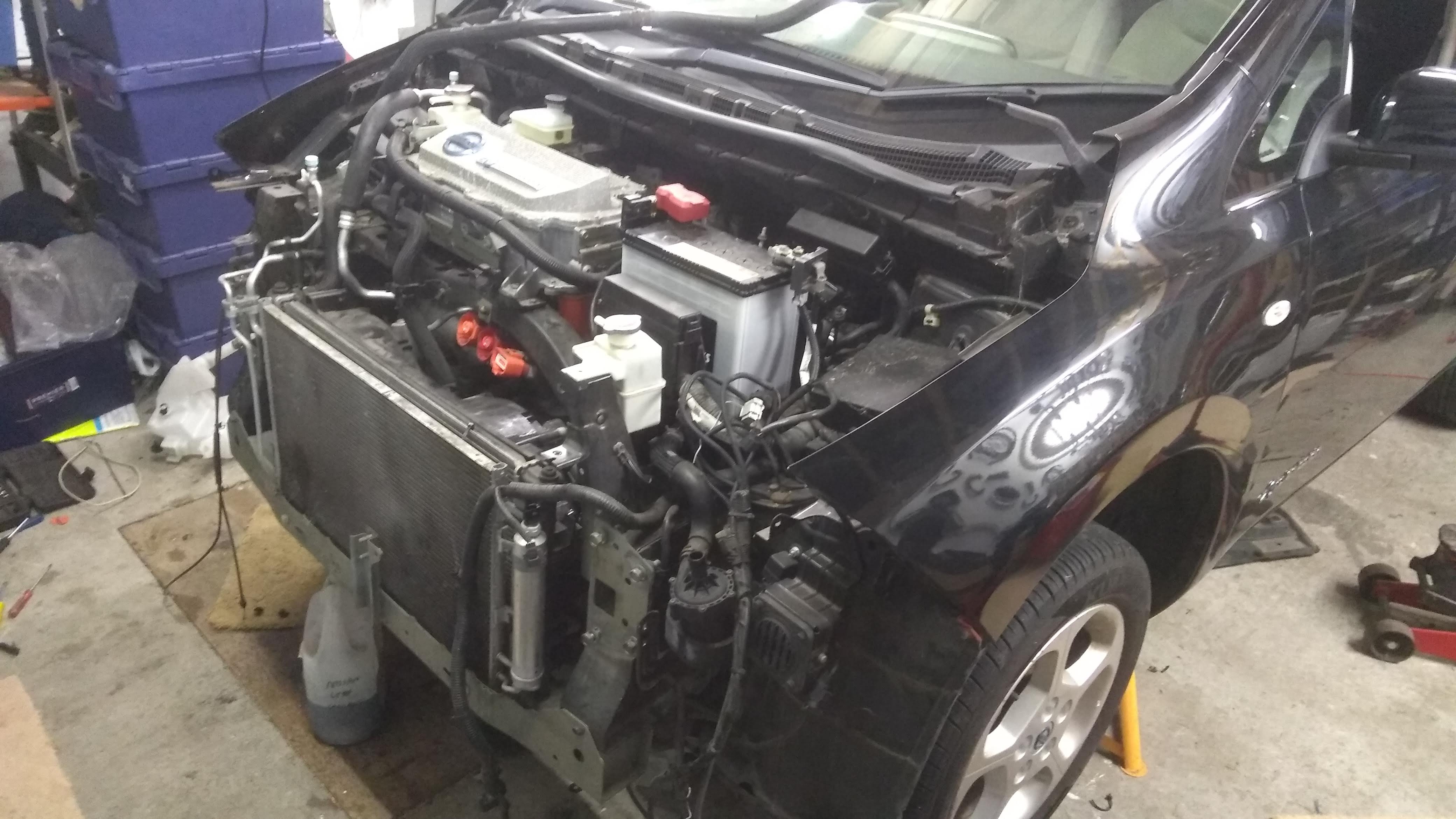

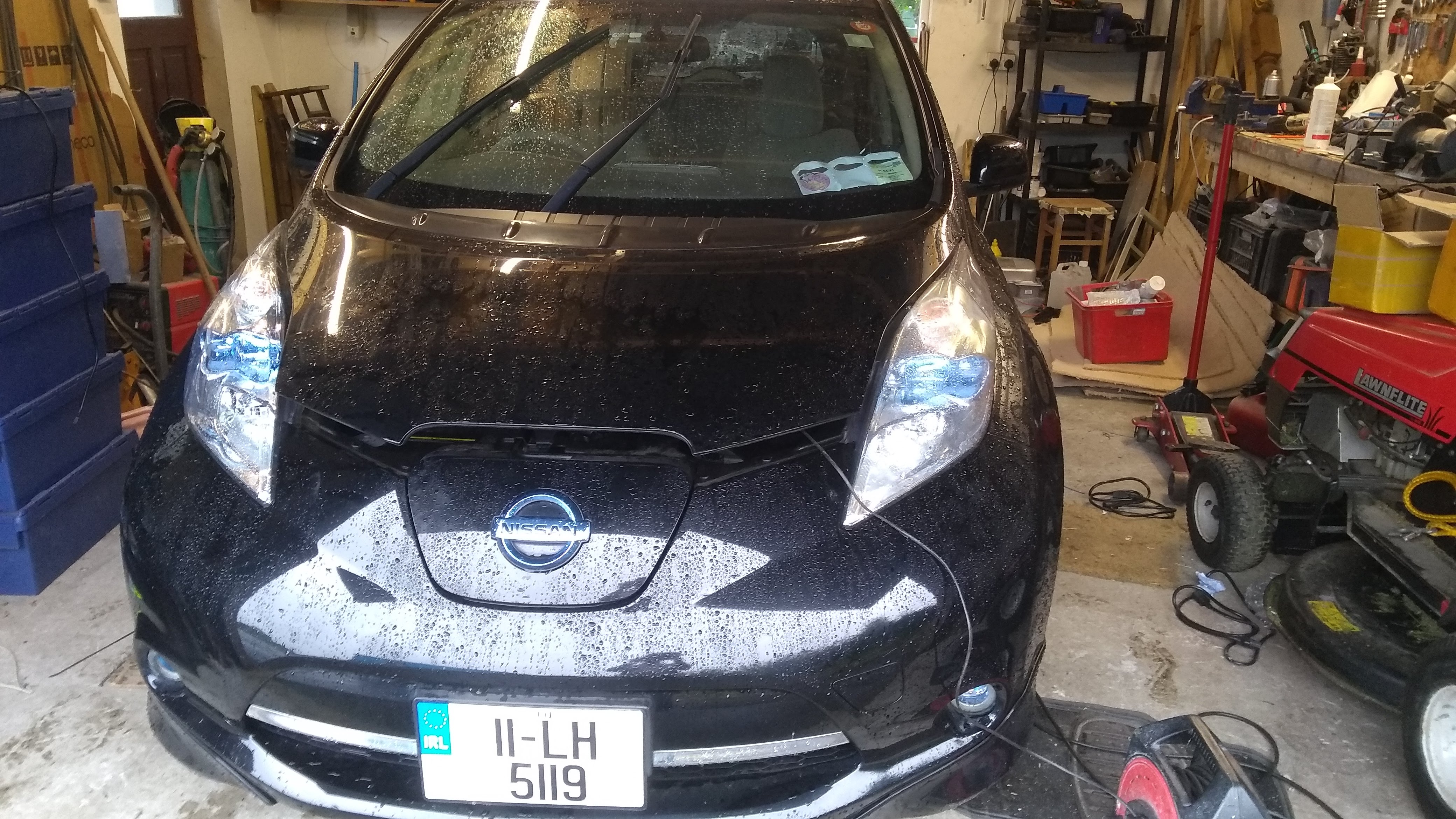

Thanks to Damien and Fiachra I was able to purchase a 2011 Nissan Leaf, complete apart from the battery. It was in great nick so I'm hoping to make most of the purchase price back from selling the parts.
This is the donor car. And this is it after a few hours stripping. Although I've spent many hours watching and reading about this kind of project I'm still uncertain how I'm going to get the Leaf motor running so if anyone has any input I'm happy to receive advice. I know Johannas has a ready made board and I'll probably end up going that way but I'm also stupid enough to think I might be able to do it myself so I might have a go before committing to anything. Once again any input from others who have been this way before gratefully received.

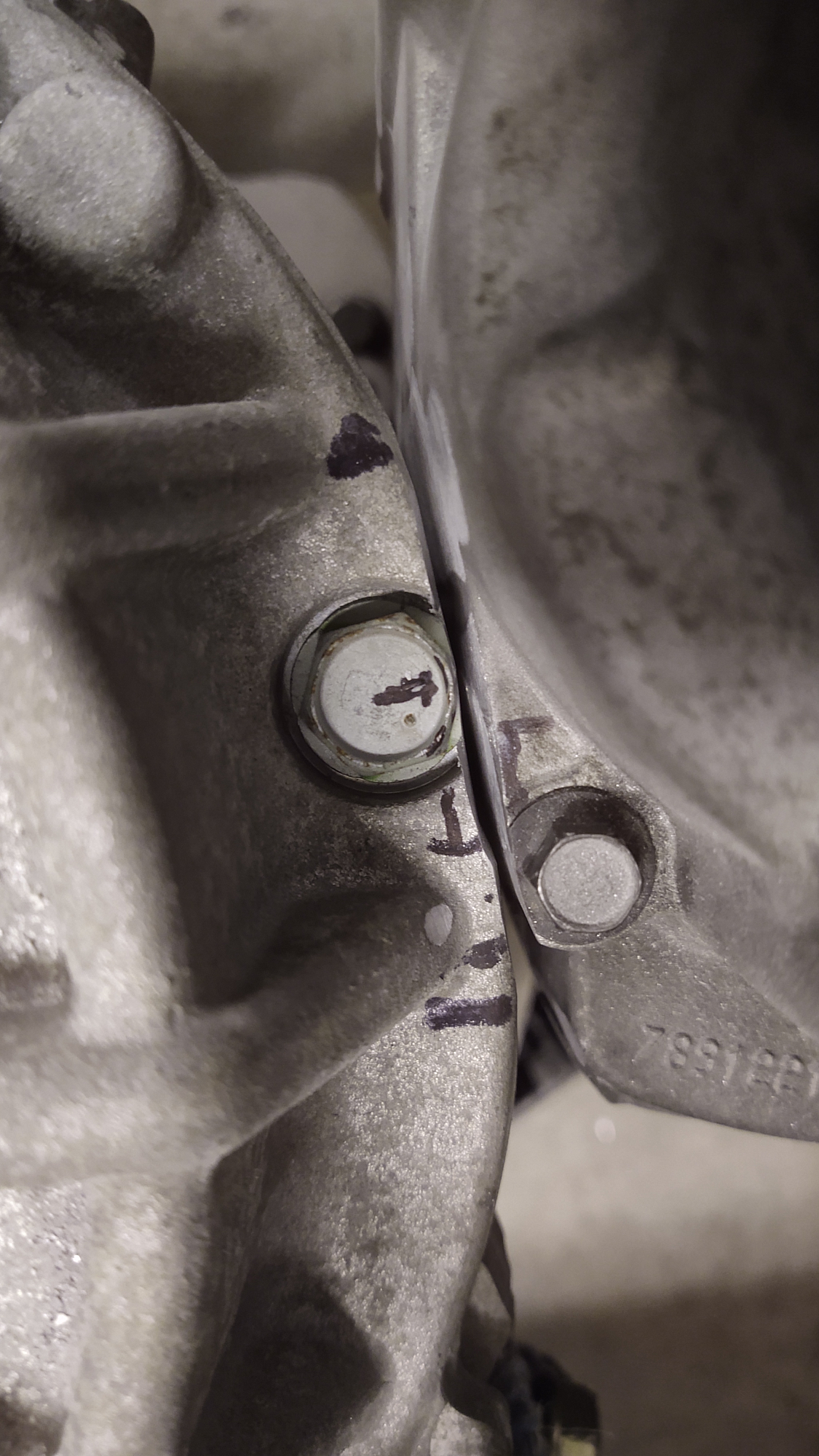

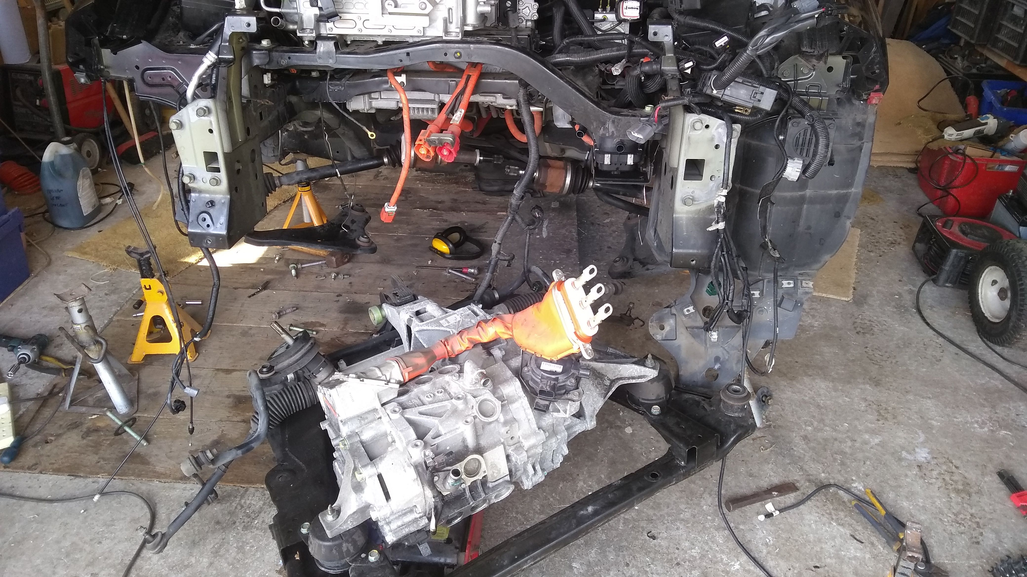

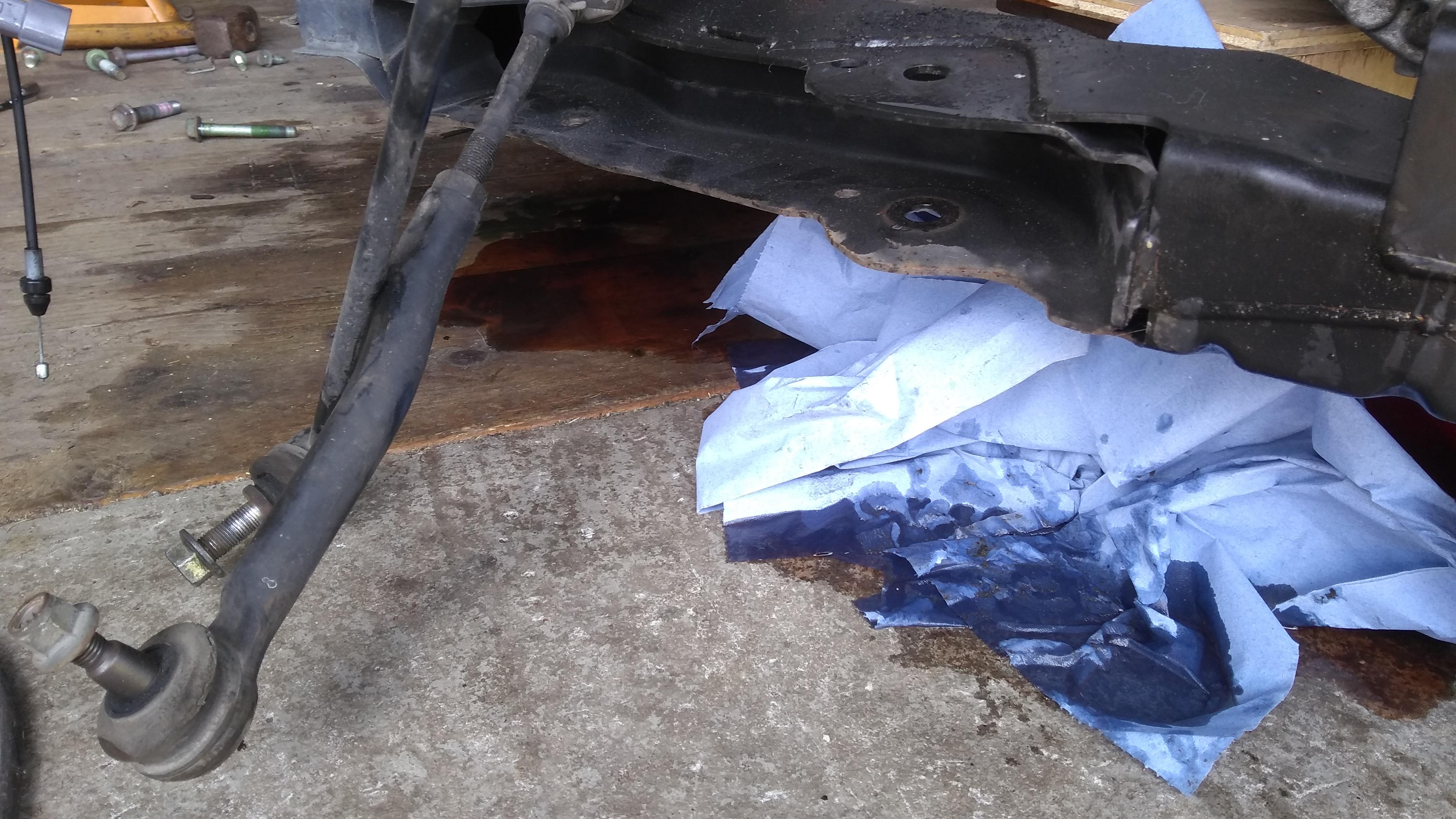

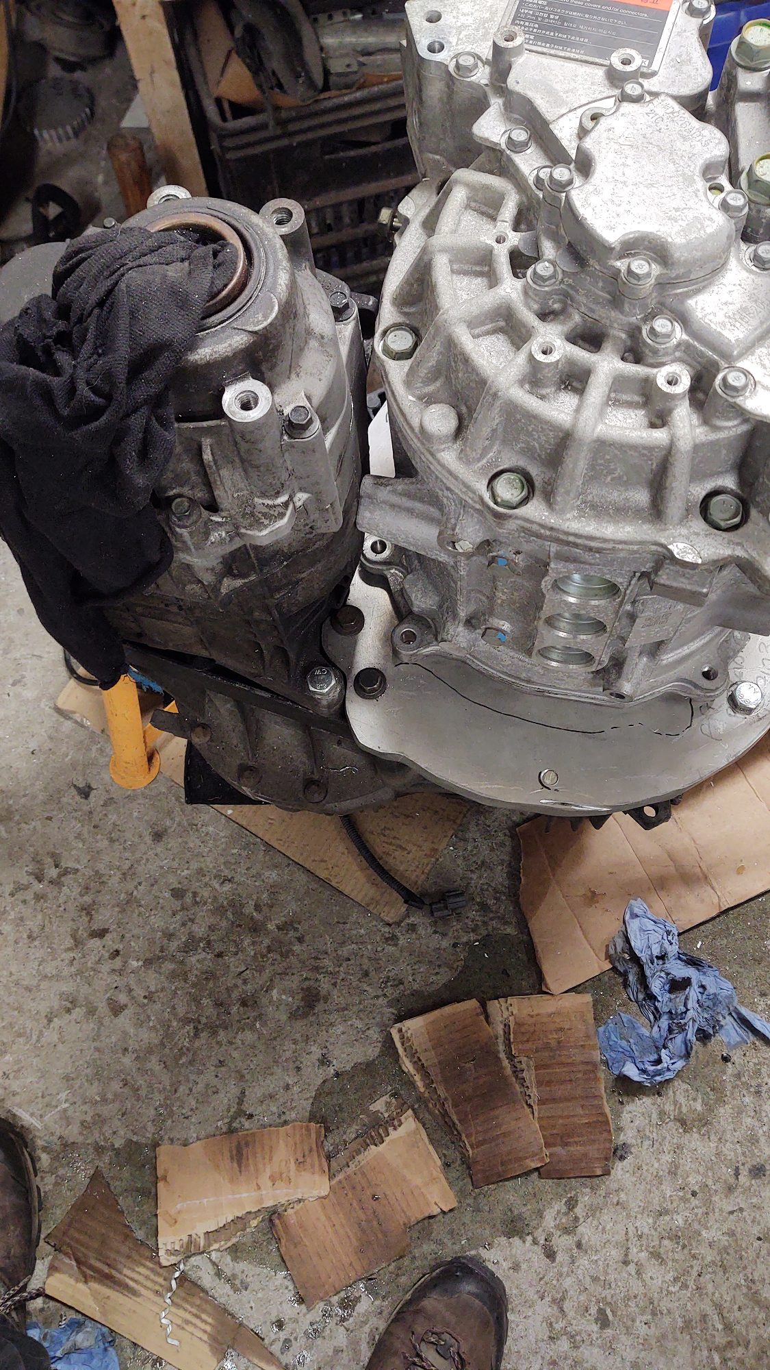

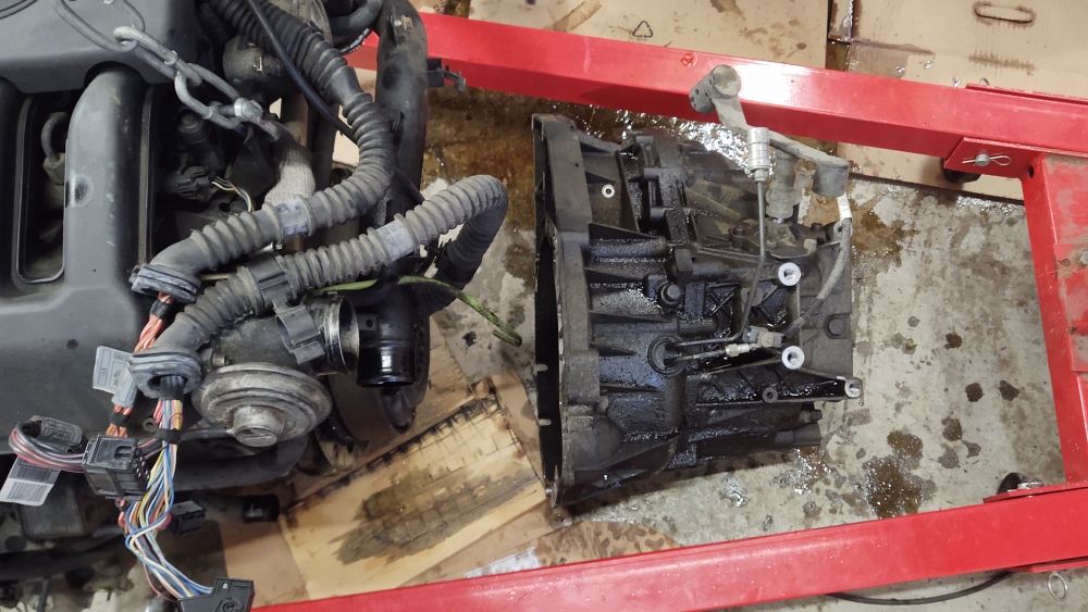

Got the motor and inverter seperated and out.
Then spilled half the transmission oil over the garage floor.
Ooops!
Ooops!

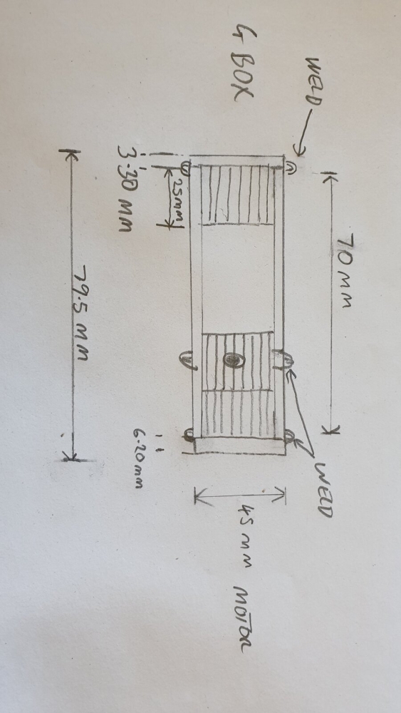

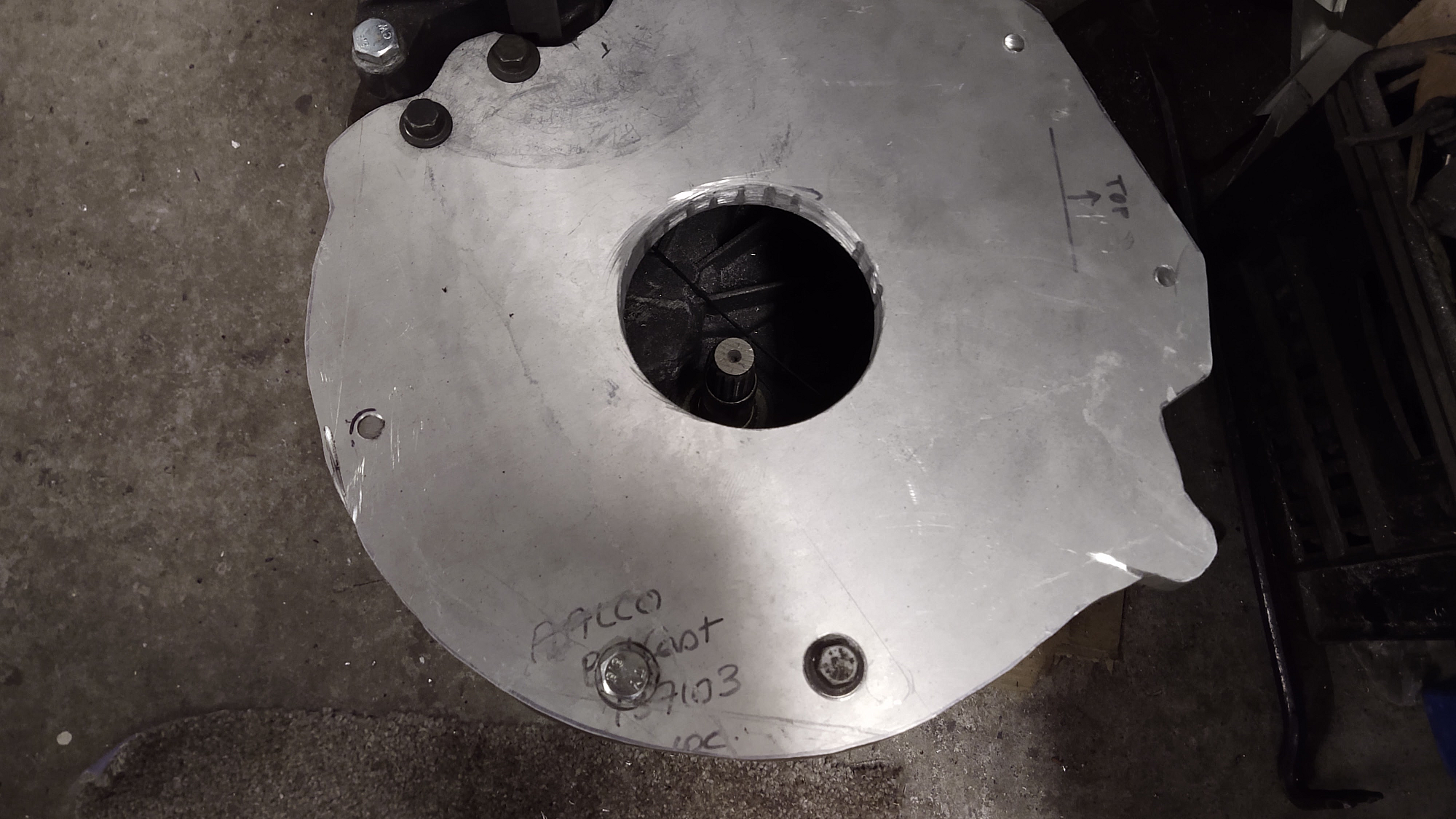

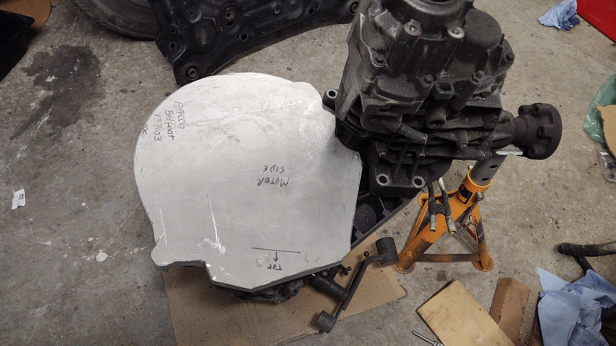

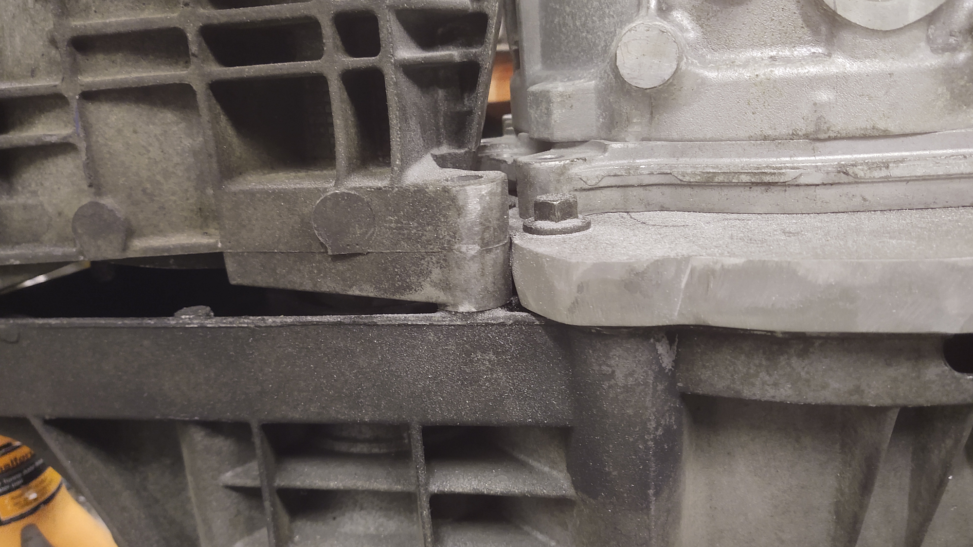

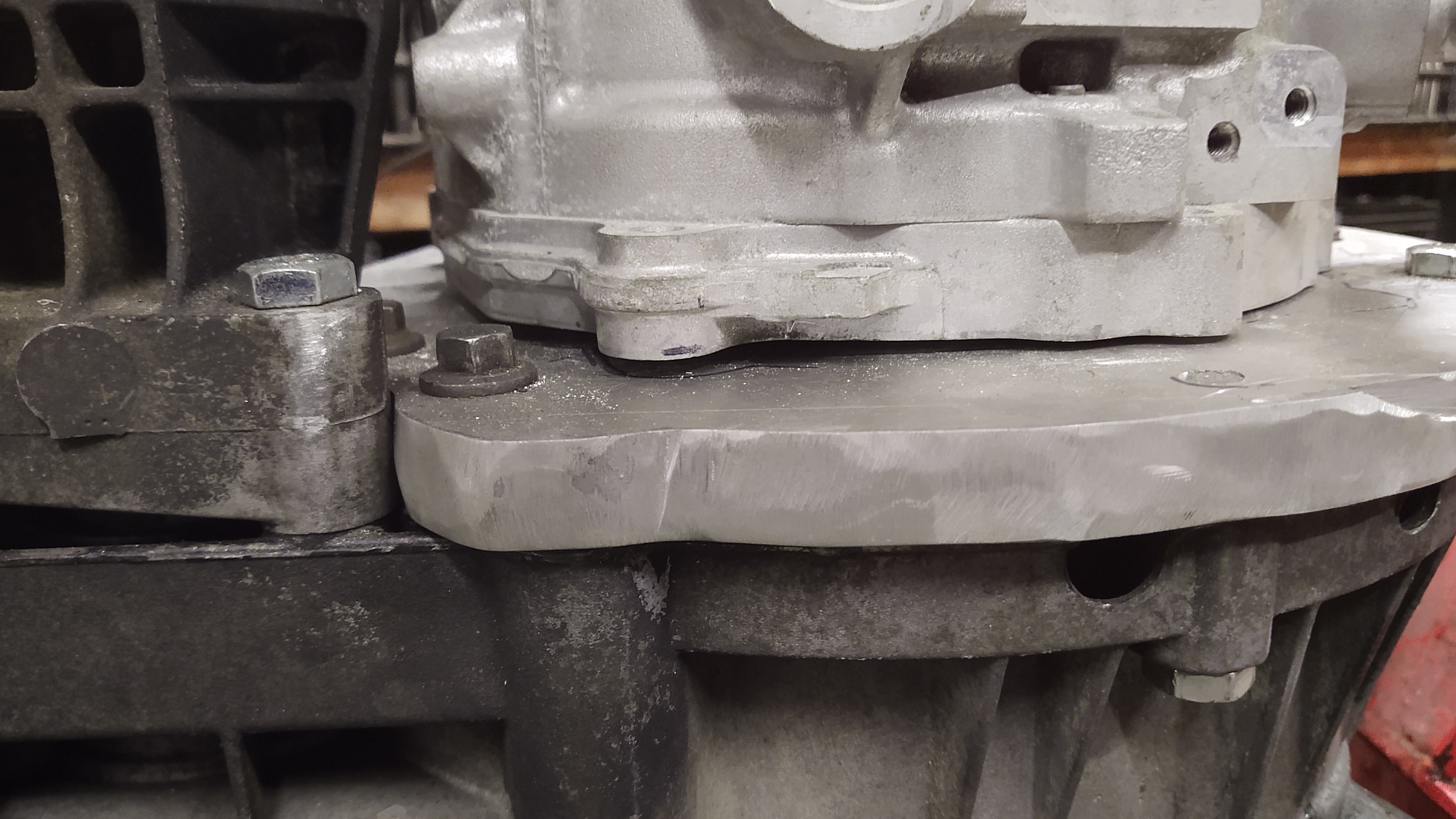

So the Leaf is now fully stripped of all things electric and hopefully I'll be able to sell off some of the body parts. It's not taking up too much room so I'll let it sit for now.
I said earlier that my priority was to get the motor spinning using Damiens VCU so of course I started at the clutch coupler.
I started a thread about it here
viewtopic.php?f=4&t=995&sid=988998c2450 ... 346a0c80de

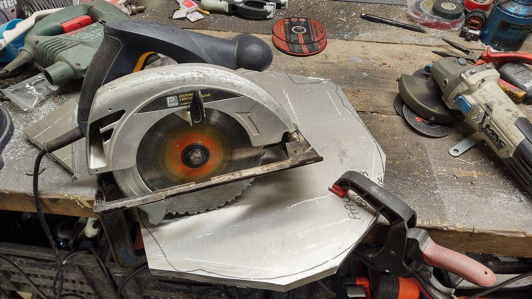

And made a video about the adapter plates.

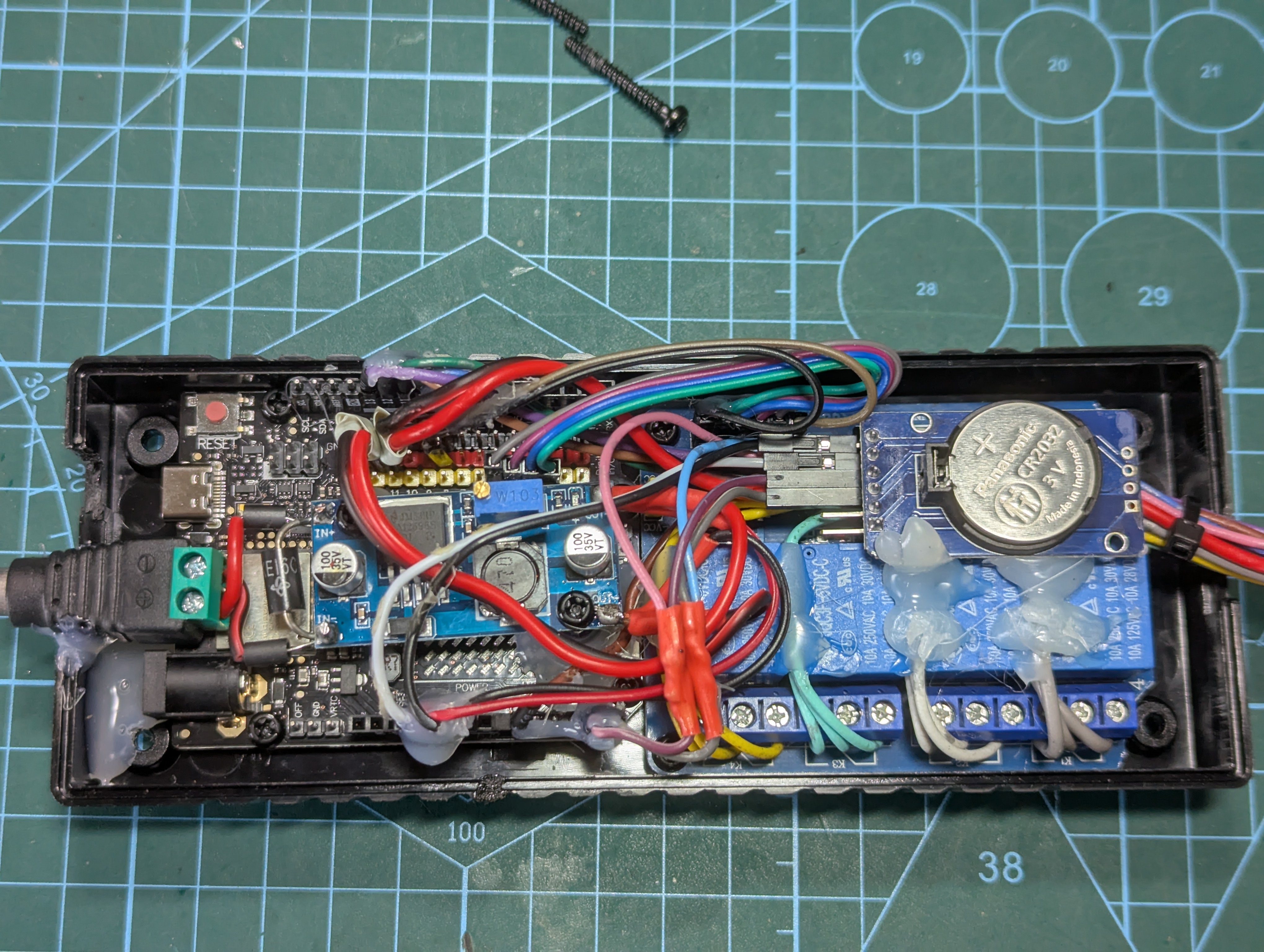

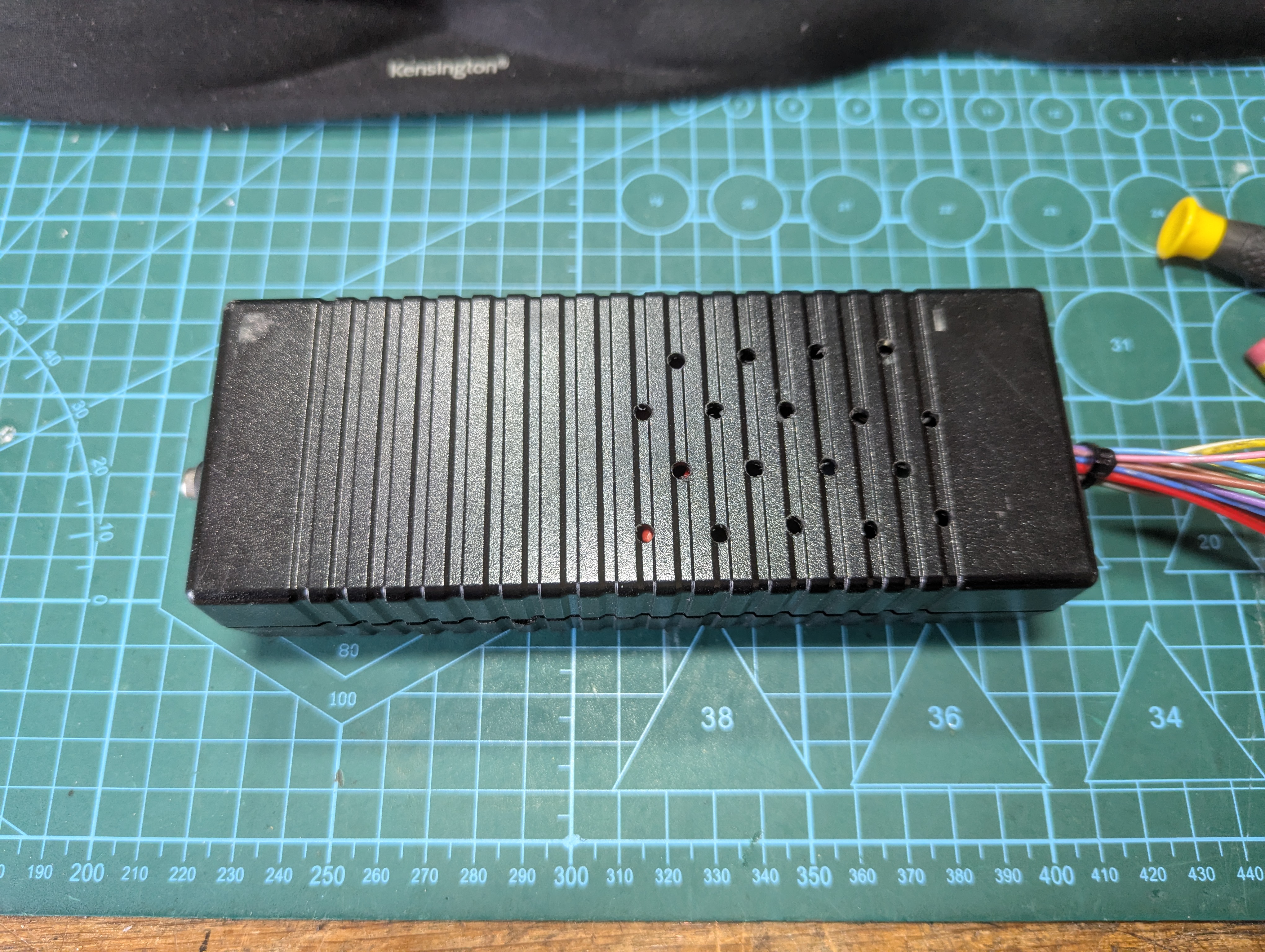

But now I've put it off long enough and I have the motor and inverter on the bench. I have to admit it is a bit daunting as I've never worked with such high voltages before. Although I've built several ebikes, this is at a waaaay different level. There doesn't seem to be much in the way of documentation for this either (yes I have the files from the github and the thread Damien started) or at least if there is I haven't found it so if there is a Wiki or such please reply with a link, but until then I'll post questions in the thread as they come up.
I've managed to solder the connectors to Damiens VCU but still waiting for the Molex plugs to fit it so haven't gone any further.

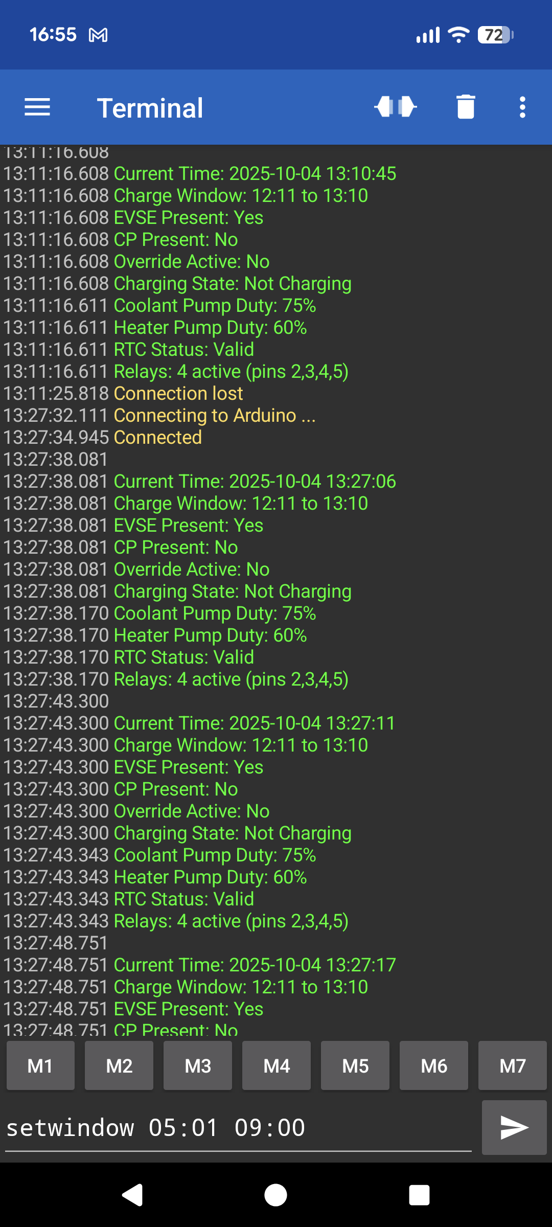

It's been a while since I updated this thread but that's because not much has happened. I've been doing little things every day or two but nothing much noteworthy until the last couple of days. If you have been watching the Leaf Gen1 Inverter Board thread I have been active there asking questions and getting some great answers so thanks guys. I also started a thread about suitable friction discs for Leaf motors and have found a few types that could make good candidates for use, but three things happened this week that will let me move on to the next stage.
Last weekend I met a great guy who had contacted me shortly after buying the Leaf. He wanted a headlight and the interior from the car but while talking to him by email it turned out he had a spare BMS for a Leaf, so we did a deal and swapped the headlight for the BMS + cables and he gave me 200 Euro for the interior. I think this means I have everything I need to get the charger and DC - DC converter working but will confirm that later.
Yesterday I waved bye bye to what's left of the Nissan Leaf I've been stripping for parts, it didn't come with a battery but I think I managed to get every other useful part from the car. I even got paid £300 and had it lifted for free.

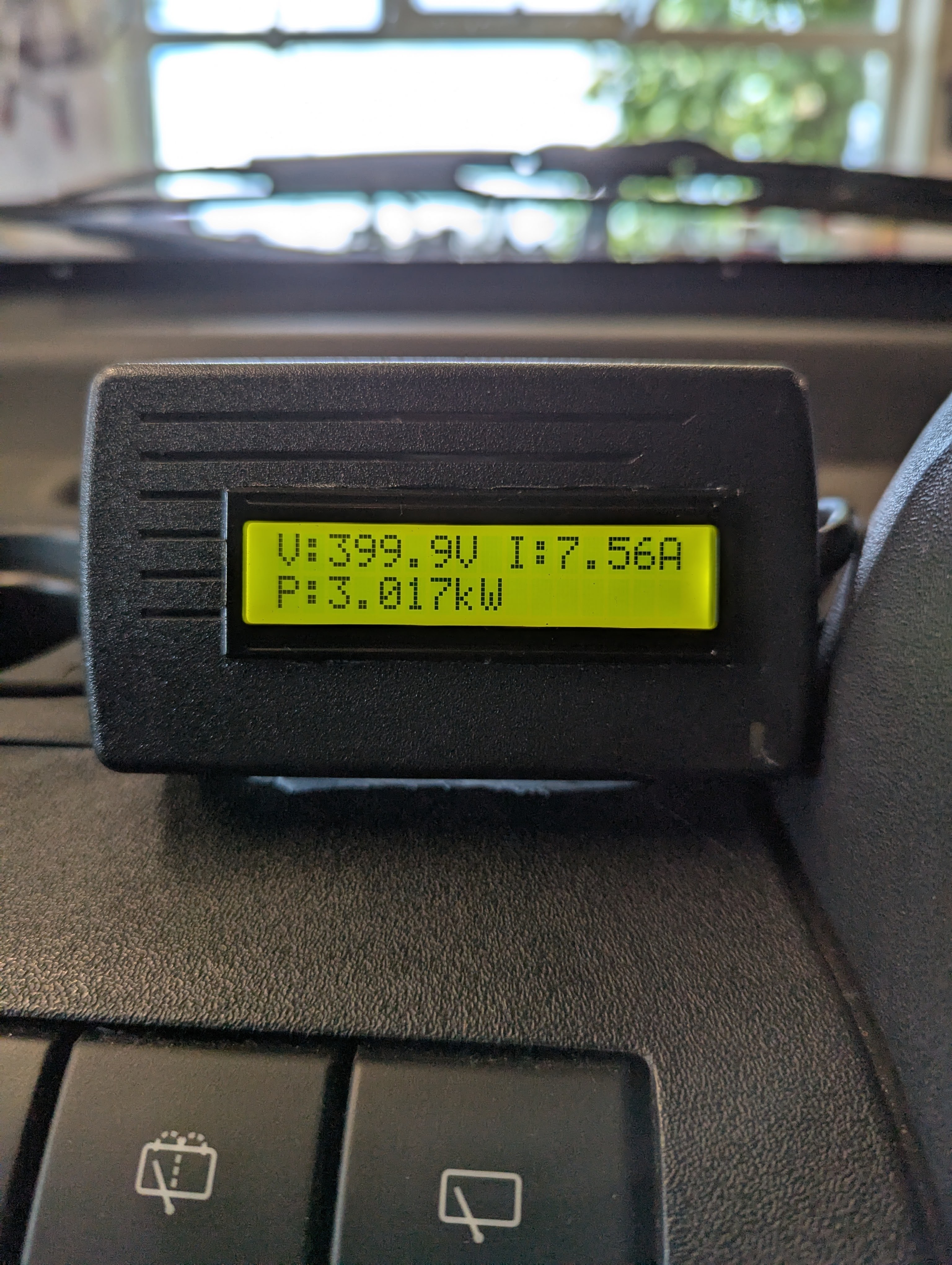

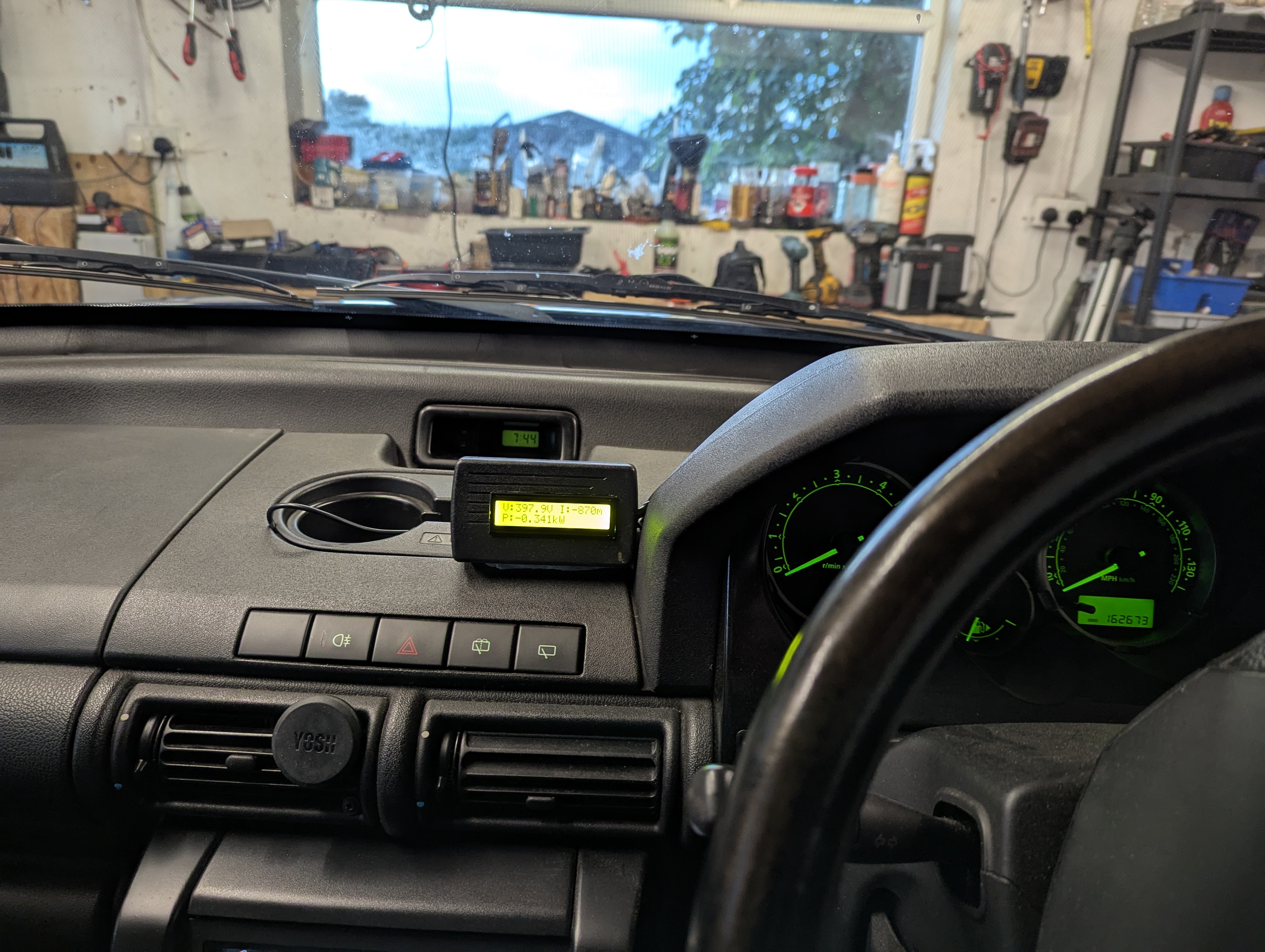

The last few days I've been trying to get my head around the EVBMW VCU and had a few issues calibrating the throttle but today I got it working.
It turns out the motor needs to feel a load or it just runs away so I refitted it to the Leaf transmission and I can now control it properly. I'll be making a video showing what I have done shortly.

The motor controller works in torque mode. If the throttle input demands more torque than the load on the motor, it will accelerate. With no load on the motor, you've only got bearing, seal and magnetic drag and the lowest torque output the controller can produce might be higher than the motor load. Result; the motor accelerates towards maximum rpm no matter how gentle small throttle input.

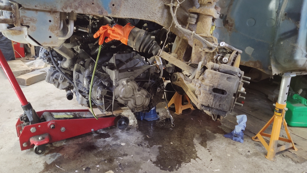

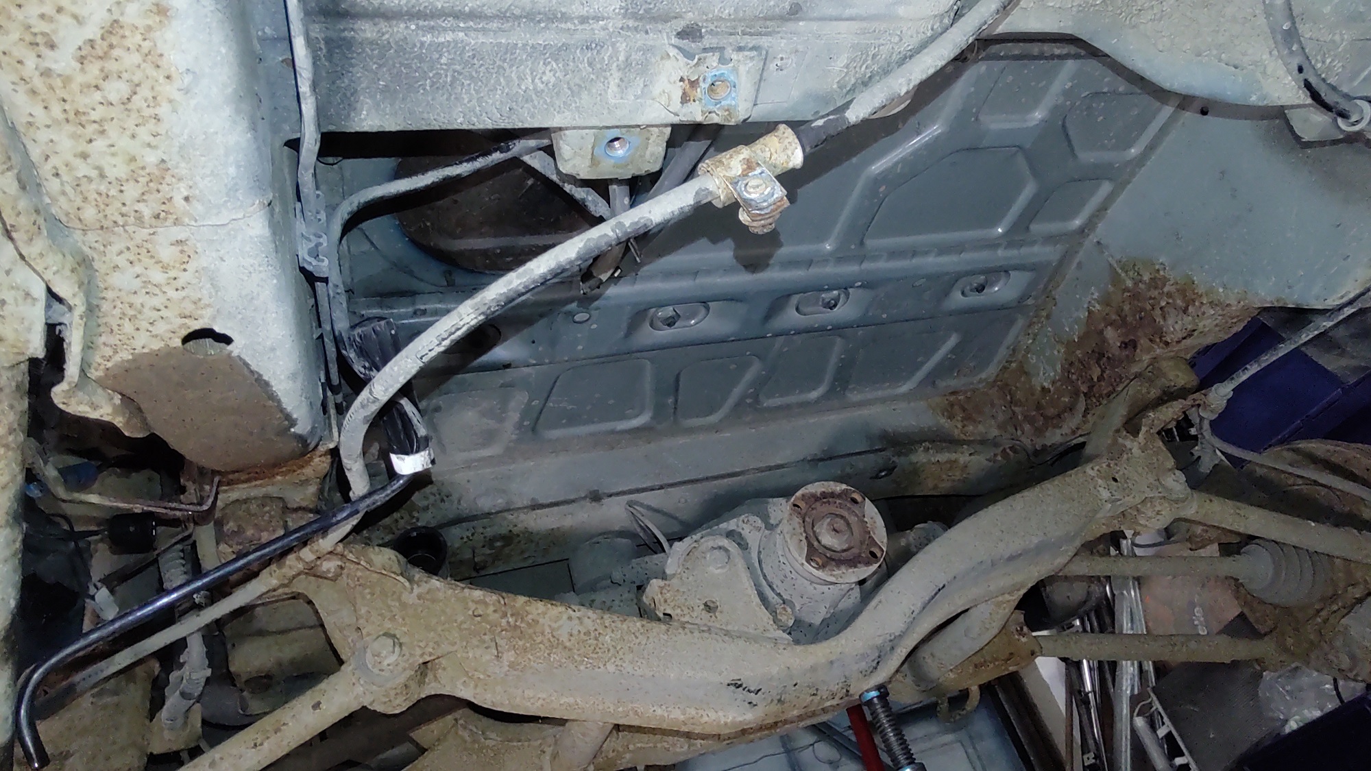

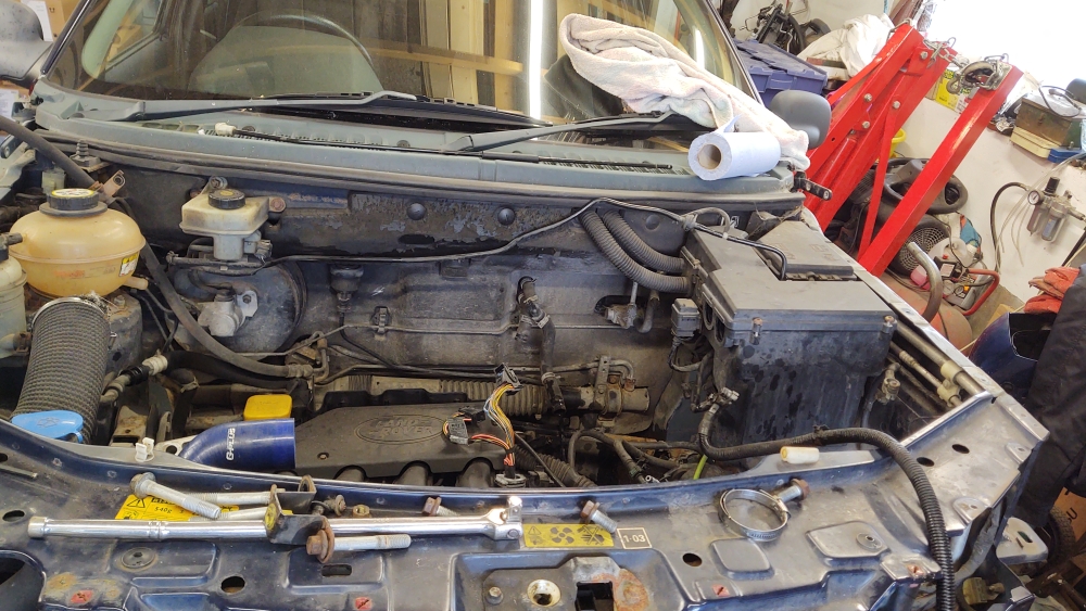

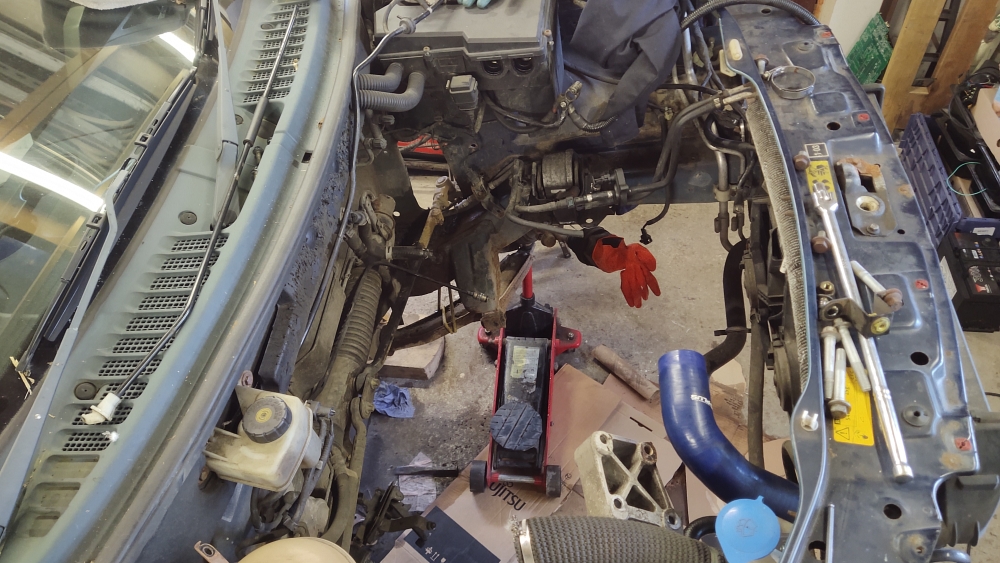

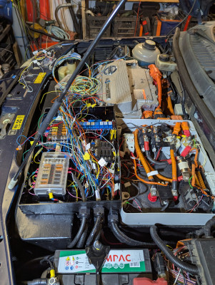

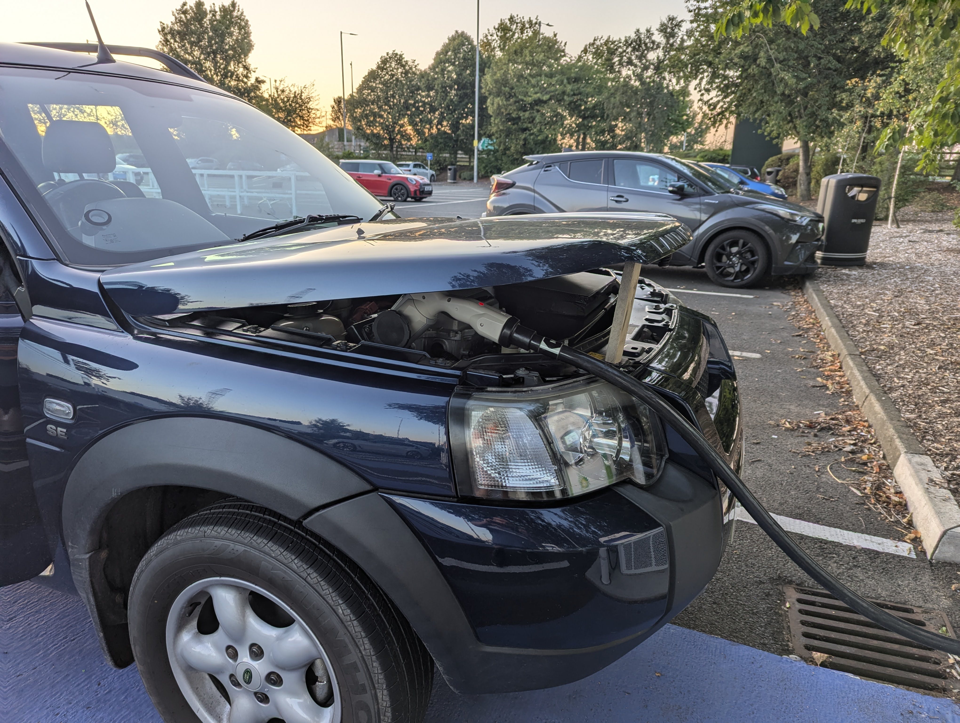

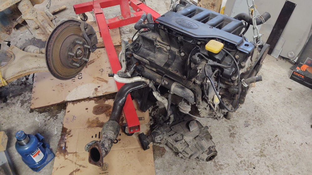

It's been a while since I updated so here goes.
I can't remember if I mentioned it before but I have a 2004 Landrover Freelander TD4 which is basically worthless as the paint is peeling off just about every panel. I'm planning to use this car basically as a test mule that I can make my mistakes on without worrying about it. (I'm not planning to make mistakes but for me they are inevitable.
This car may never even make it onto the road as it is so rough I would like to find a really nice clean Freelander with a duff engine then move the EV parts into it.
Here are a few pics of the Freelander de-icing
Engine dropping Engine sitting on the trolley jack shortly before falling off and spilling it's guts all over the garage floor. IRD (Intermediate Reduction Drive - the 4WD box) off Gearbox detached Empty engine bay.

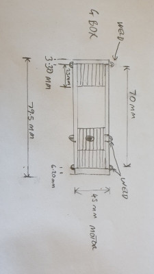

I have a mate turning the coupler for me so hopefully will have it in a week or so. We discussed how to make it using the two clutch discs I have that fit the motor.
This is the design we are going with. I'm not sure why it insists on being portrait but if you click it should be the right way up.
The plan is to Machine the Freelander disc with a flange to fit one end and the two other discs to fit the other. One will be fully inside the tube welded in place through holes in the coupler pipe. This will be the securing disc to stop backlash. The second will have a flange like the Freelander one and will be the main drive disc. Hopefully with this setup there will be minimal slack which should help prolong the life of the coupler.

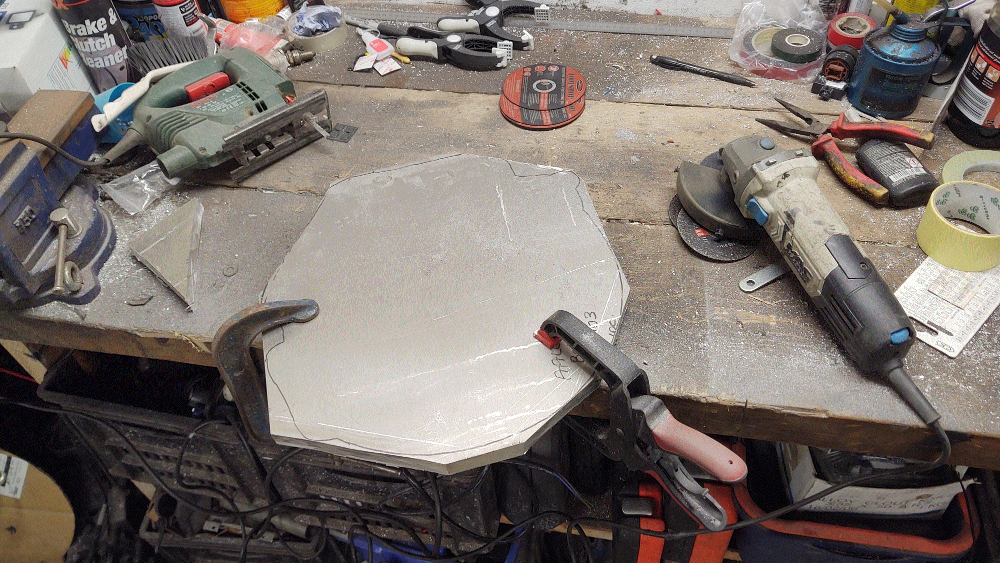

I decided on a Freelander as my first EV project as I have had a few and know them well. I'm aware of their many faults so should be able to sort issues as they arise. I also have a big support group in Landyzone https://www.landyzone.co.uk/forum/land- ... elander.9/ which is a great help.

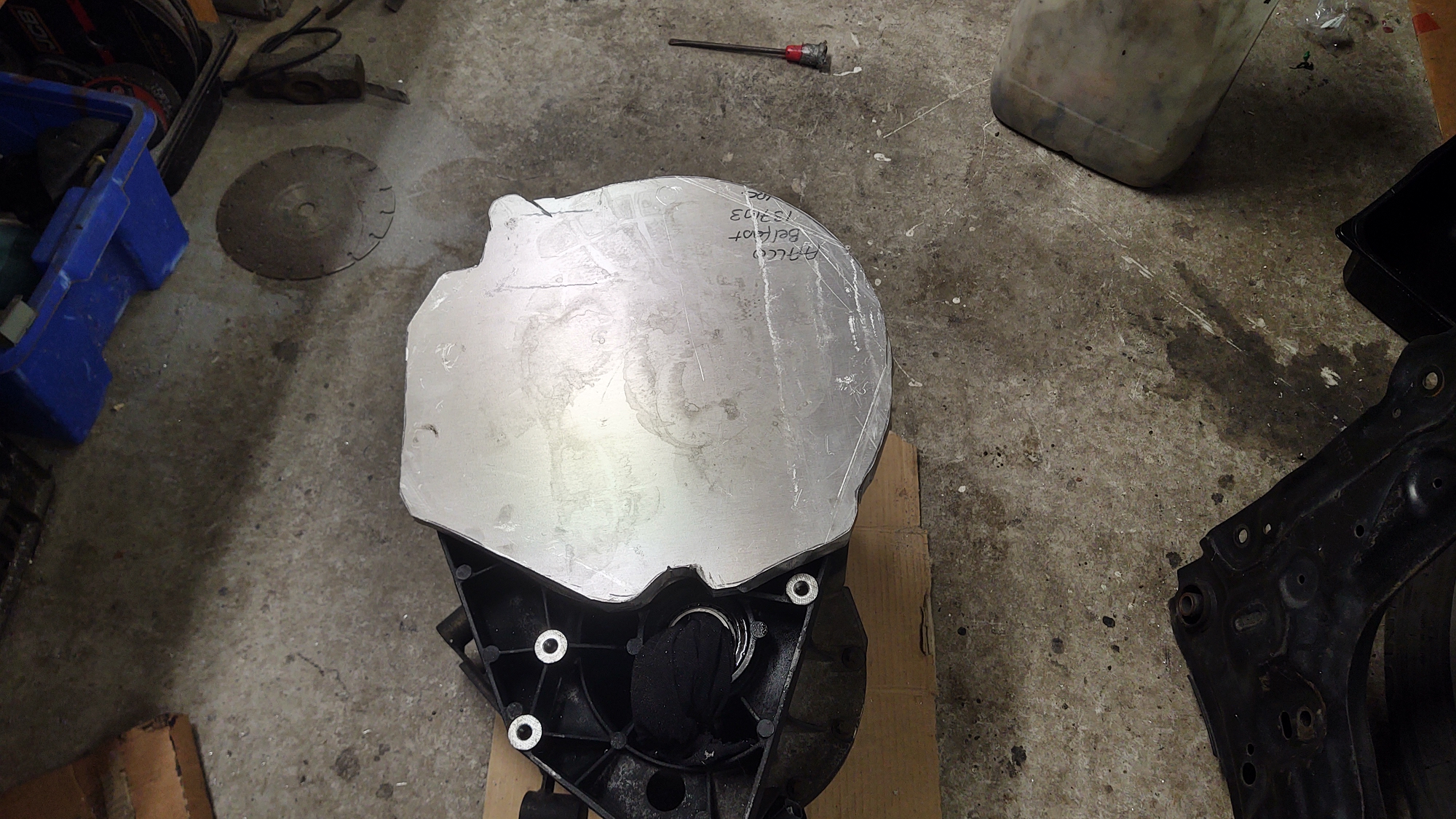

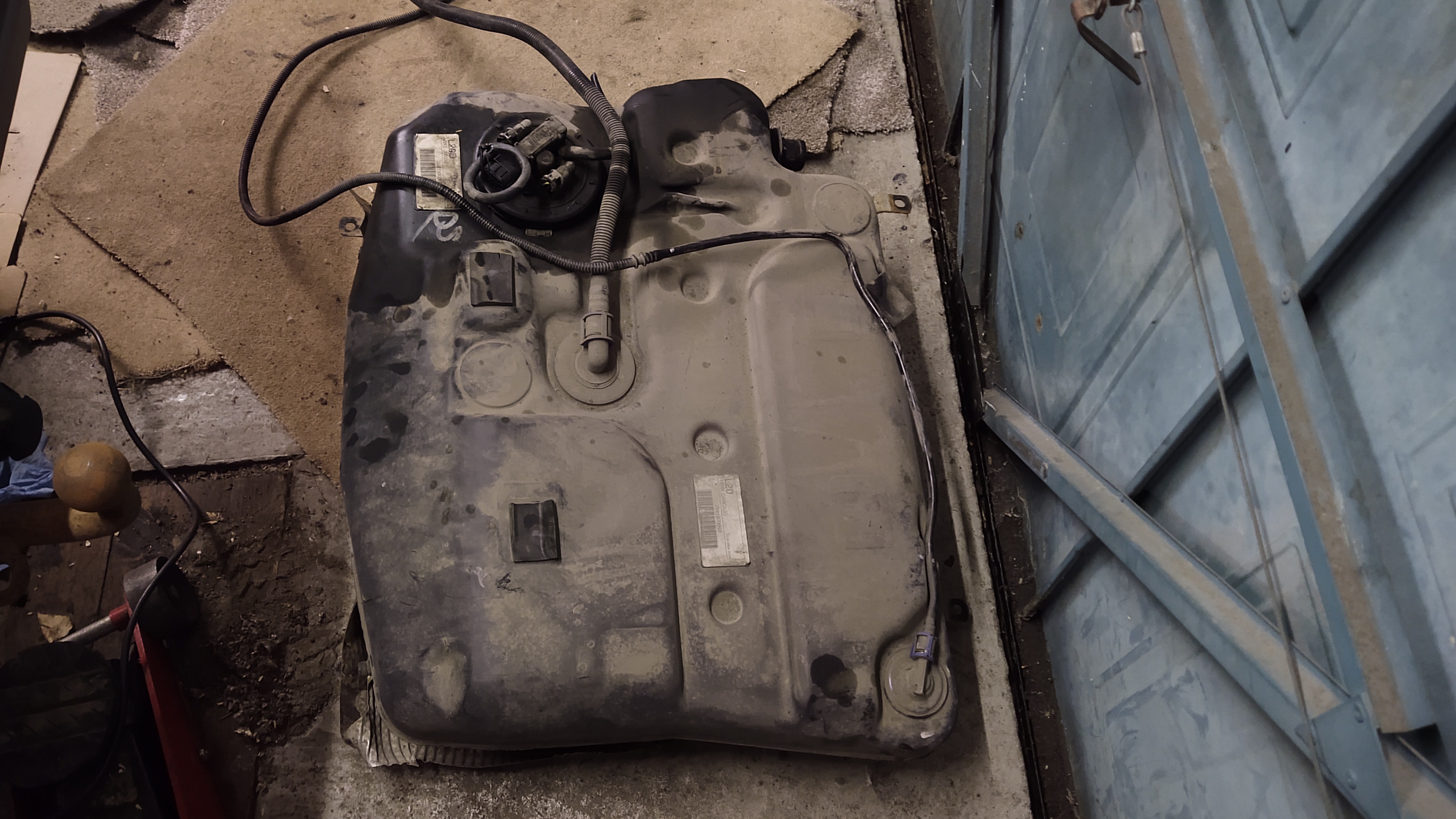

The fuel tank and associated pipework is now out. I bought a 1m x 0.5m x 20mm slab of Alloy from Aalco and started cutting the shape of the gearbox bellhousing. I used a circular saw with an Evolution cutting blade at first which worked well up until the hardened tips on blade started to fall off.
Then it was back to jigsaw and flap wheel. Then put it on the gearbox to check fitment Then fitted the IRD and made sure it still fitted. Then using a home made 'hole centre finder tool' to find the centre of threaded holes in the gearbox and drilled them.

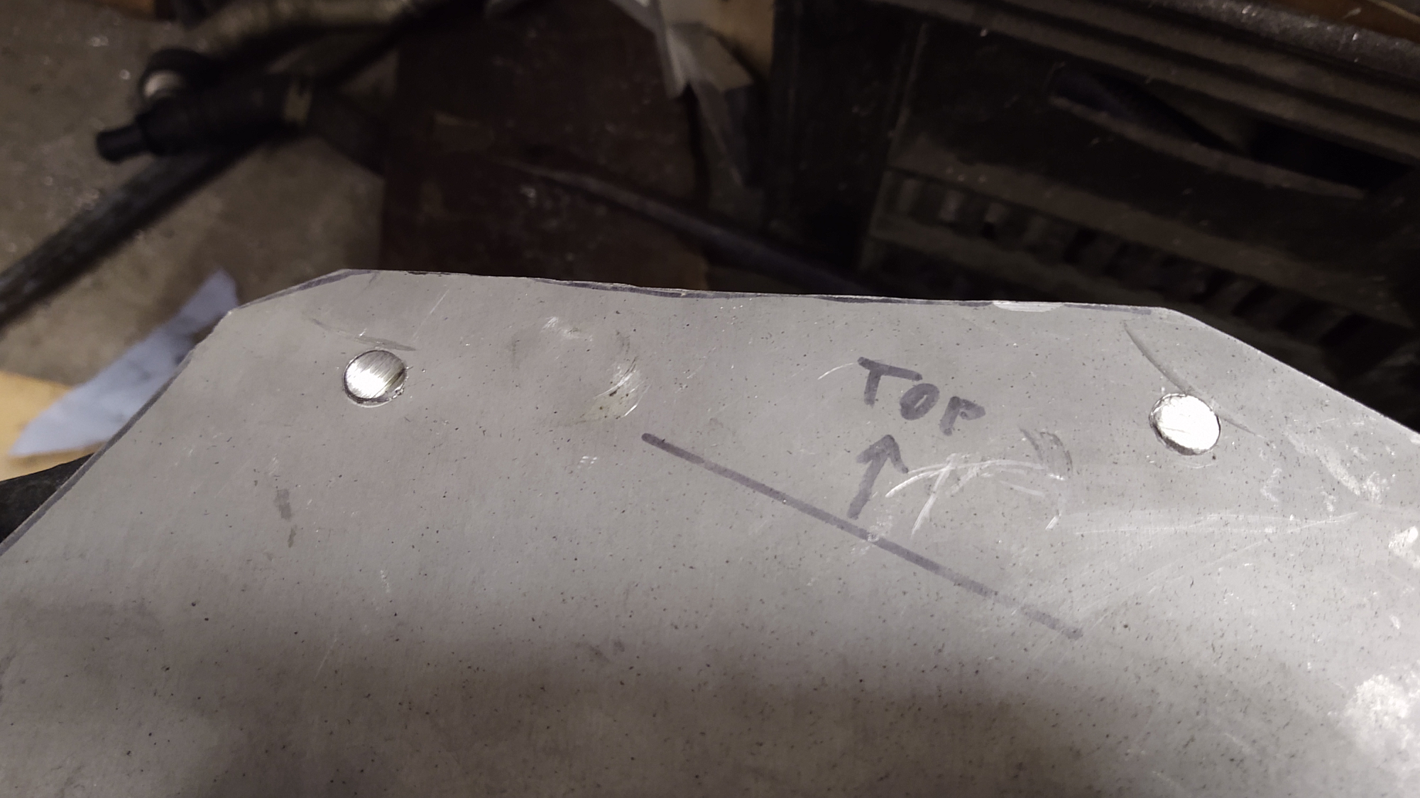

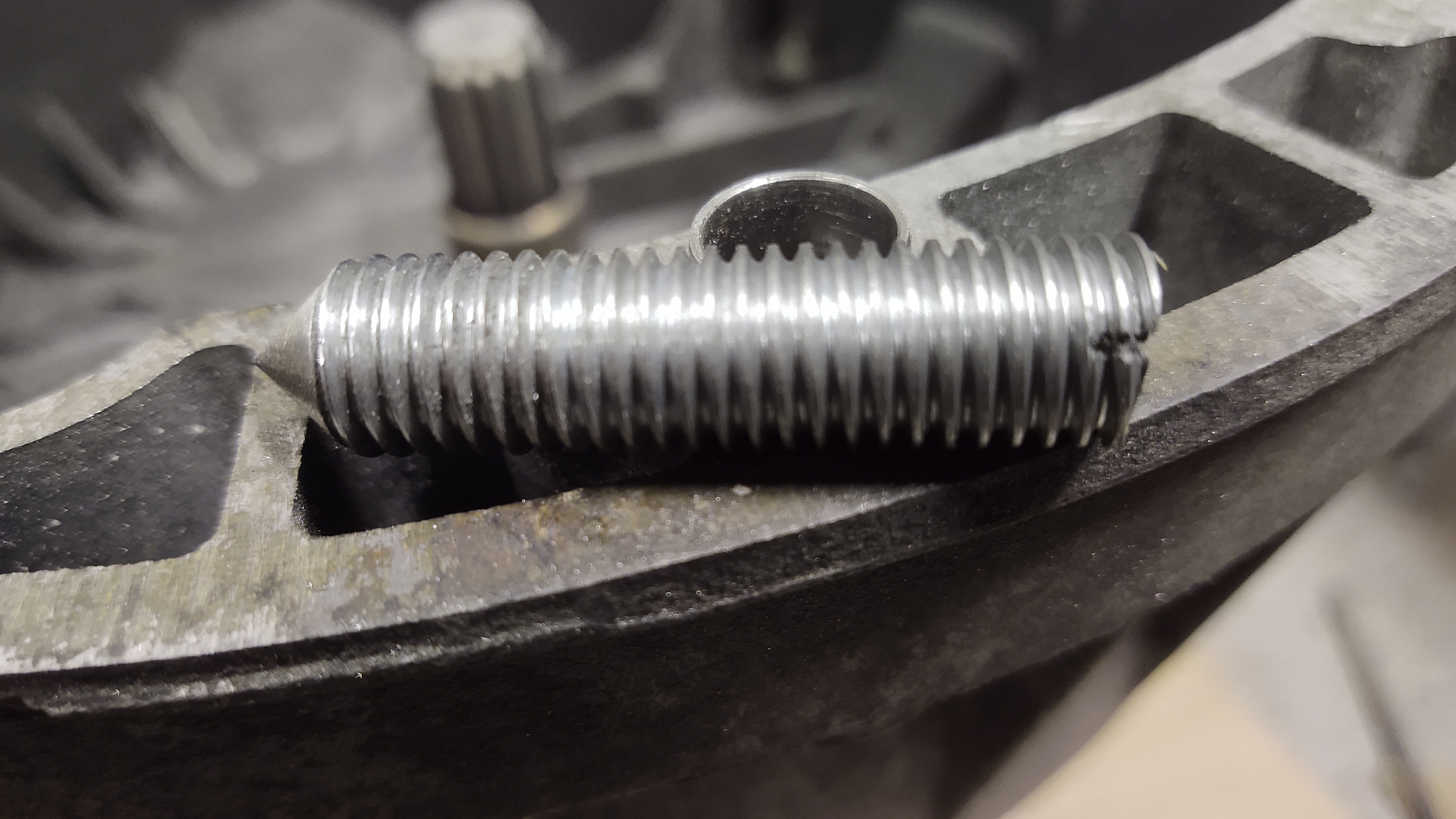

I put a piece of threaded bar in my pillar drill and used a grinder with a flap wheel to make the point, then cut off the part that had been held in the chuck and put a slot in the other end to help screw it in and out. Then I drilled and tapped the adapter plate for the unthreaded gearbox holes.

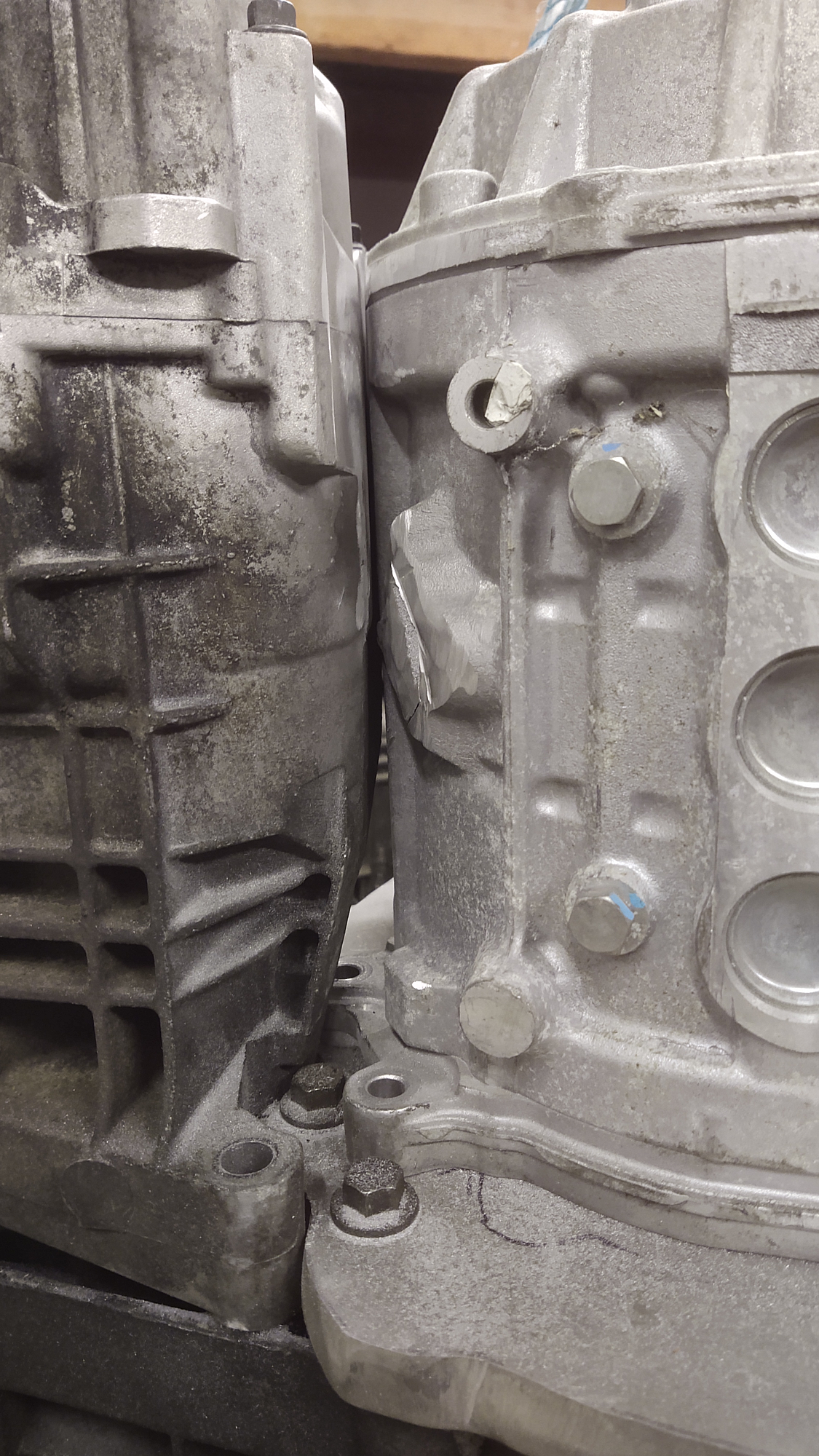

The adapter plate was now fitted with a hole big enough for the coupler.
I had been a bit concerned for quite a while wondering if the motor would foul the IRD so I made a temporary coupler from some pipe and test fitted the motor with the IRD bolted in.
As you can see it doesn't fit.
So after lots of grinder action cutting off a motor moubt and grinding down the sides they fit but are VERY tight.
I don't know how the Fourtrak transmission is laid out but you should check for a similar issue before going too far.

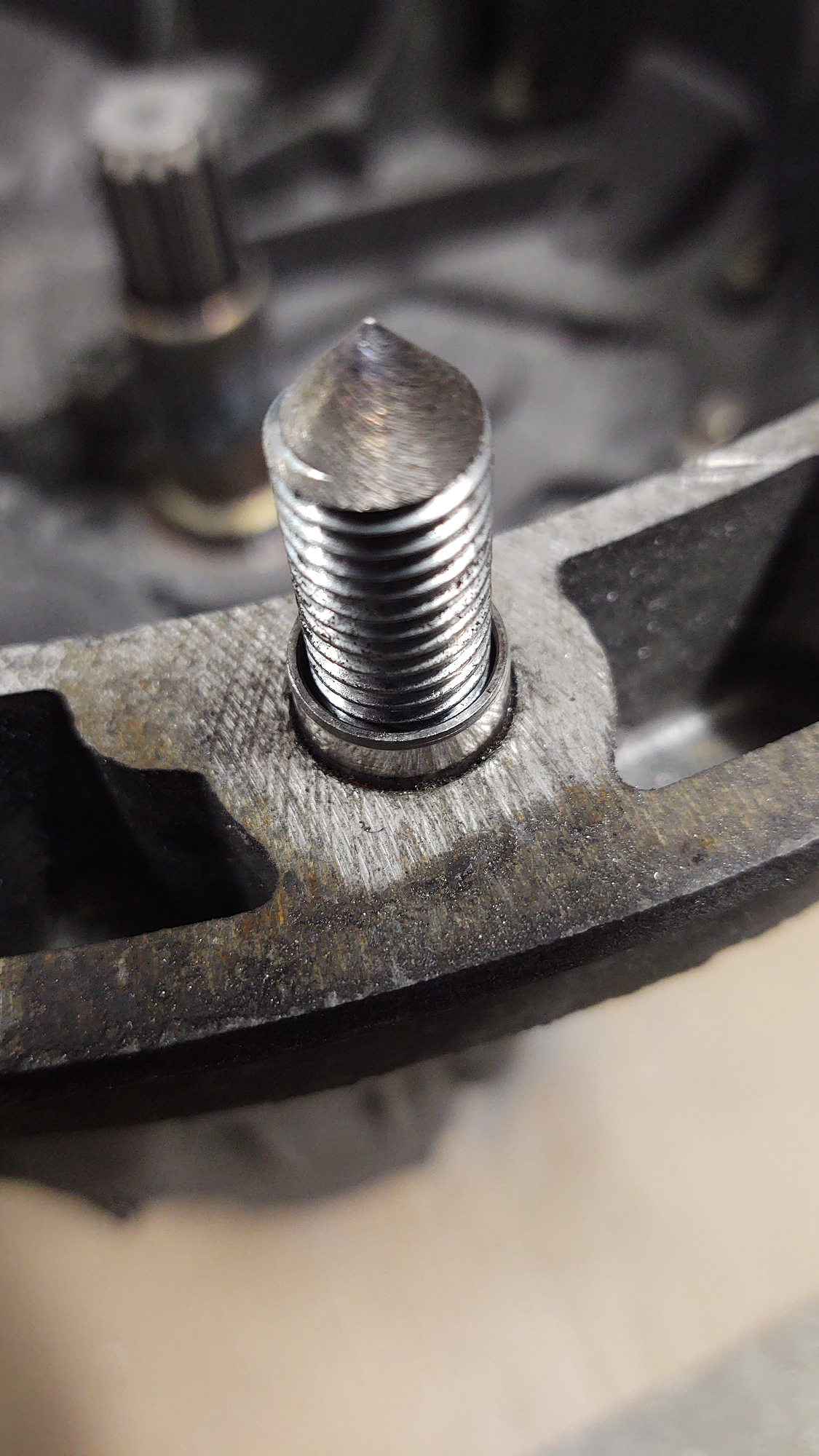

- SciroccoEV
- Posts: 370
- Location: Luton UK
- Been thanked: 16 times
Re: Freelander EV With Gen1 Leaf electrics and EVBMW VCU

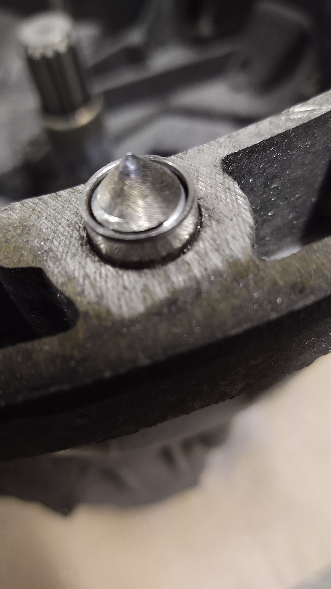

Nice work on the the home made transfer screw.
Ready made versions are not very expensive and are easier to use in blind holes;
https://www.arceurotrade.co.uk/Catalogu ... ed%20depth.
