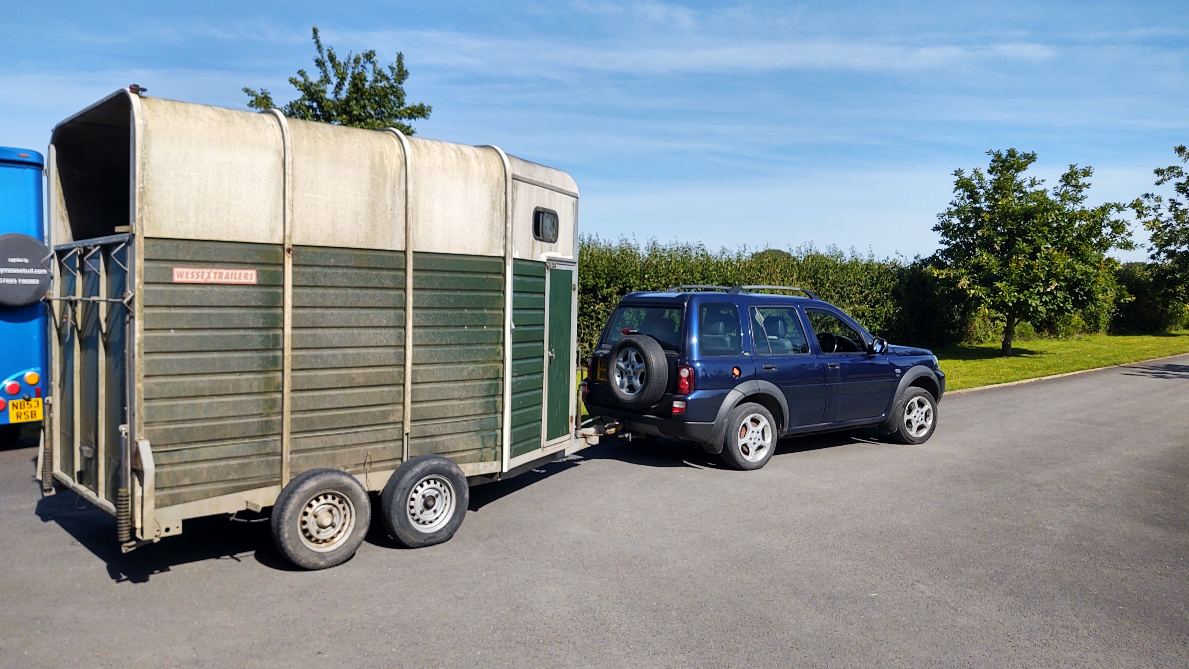

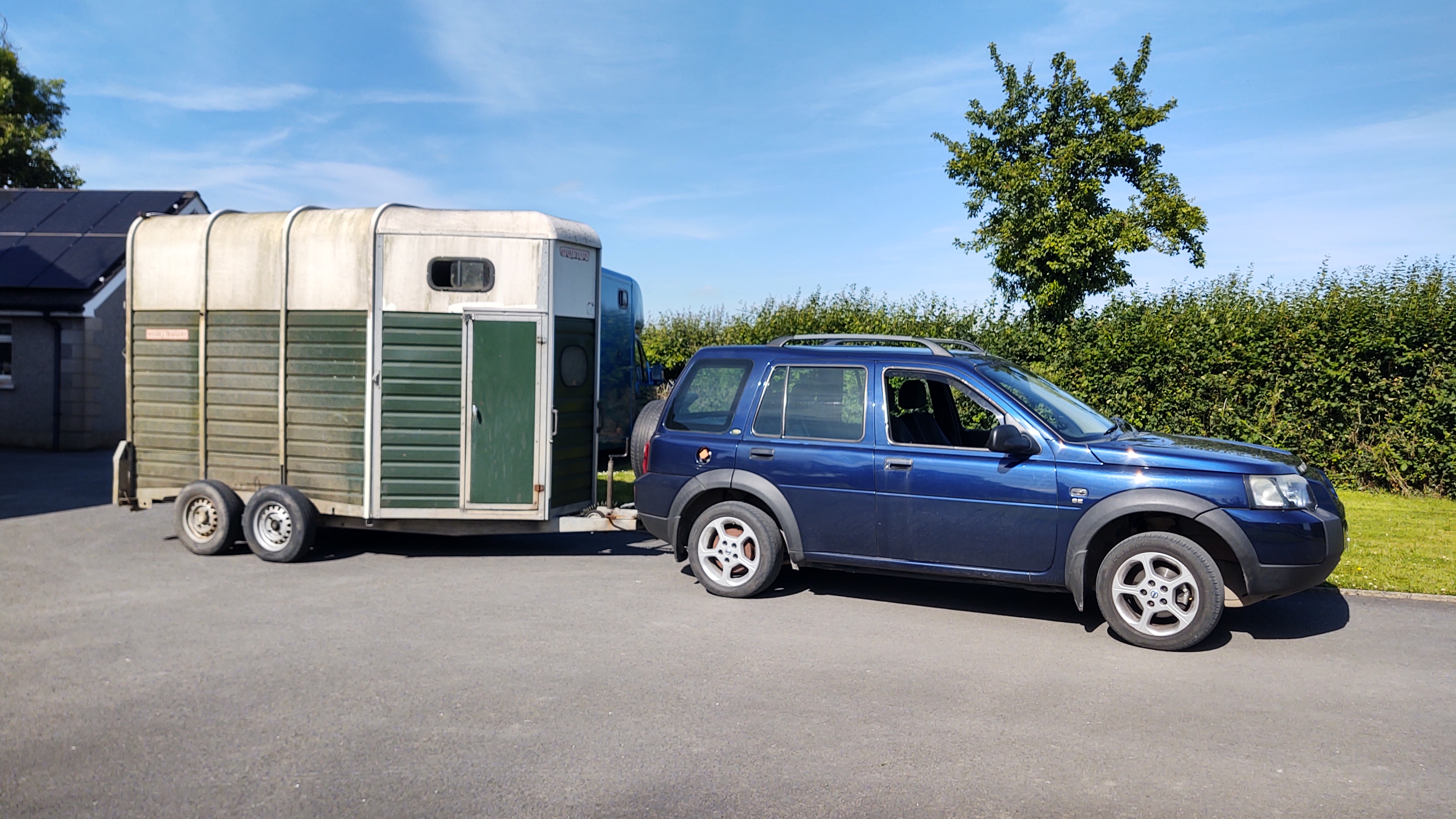

Used the car again for the sort of jobs I built it for.
Yesterday I drove to the airport to pick up my Mrs and daughter, and today I borrowed an old horse trailer and used it to bring home two large round bails of hay.
The trailer is stupidly heavy and the wifes Ford Kuga really struggles to tow it as it's clutch is on it's last legs and the engine hasn't much torque.
Normally in the Freelander I don't use first gear as it isn't necessary but when towing this trailer I use first to get moving and cross roads quickly. Pulling through slow traffic was a breeze however I don't like pulling up long fast hills with the constant high current load. Maybe I'm being silly but I was glad to get it back to it's owner.

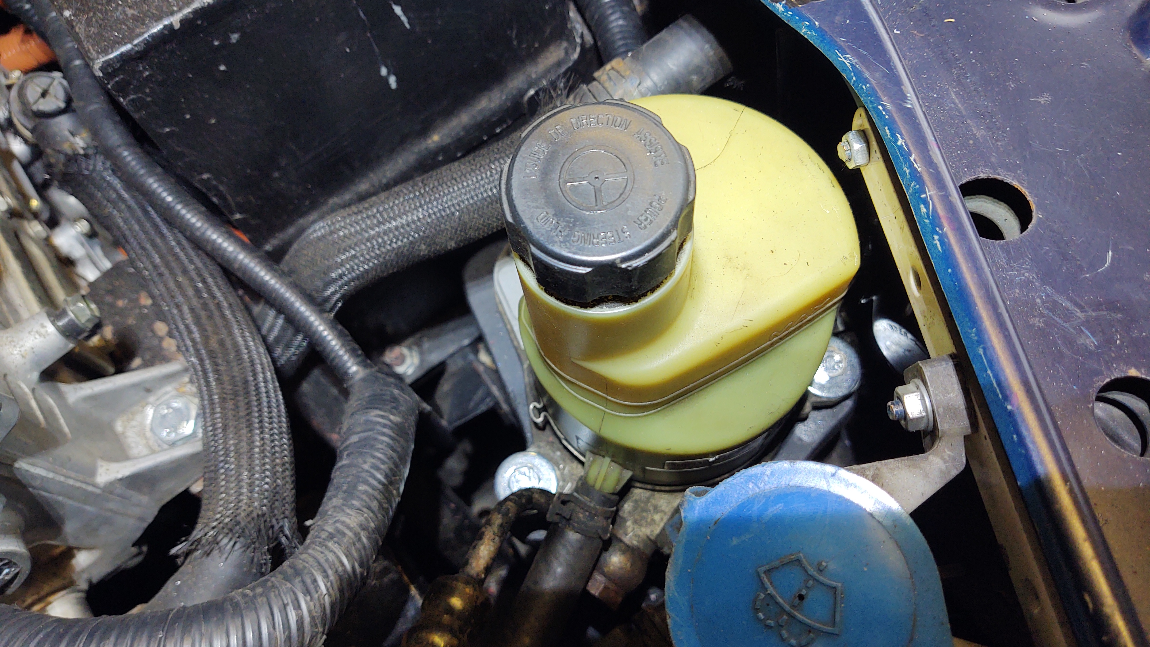

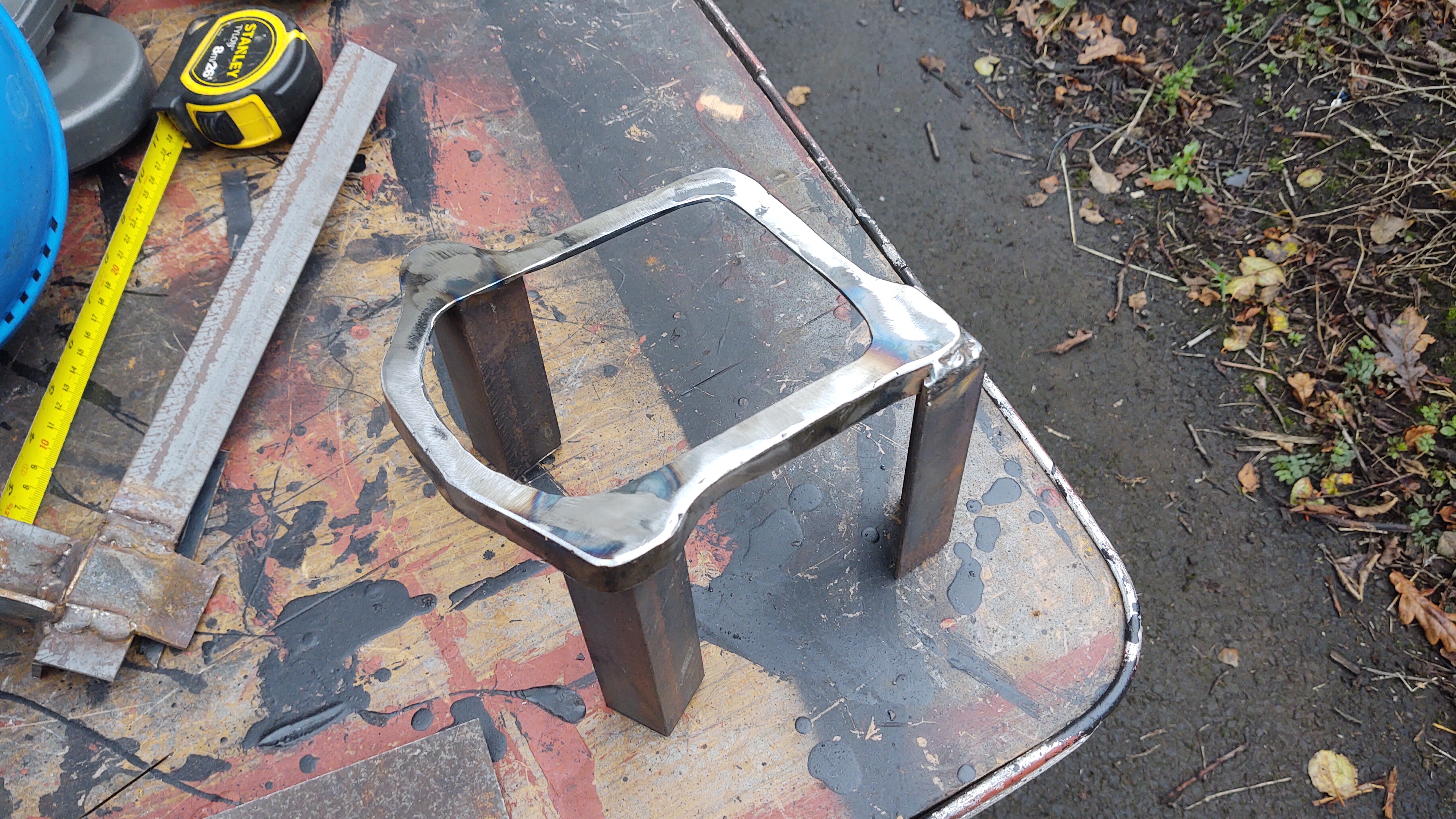

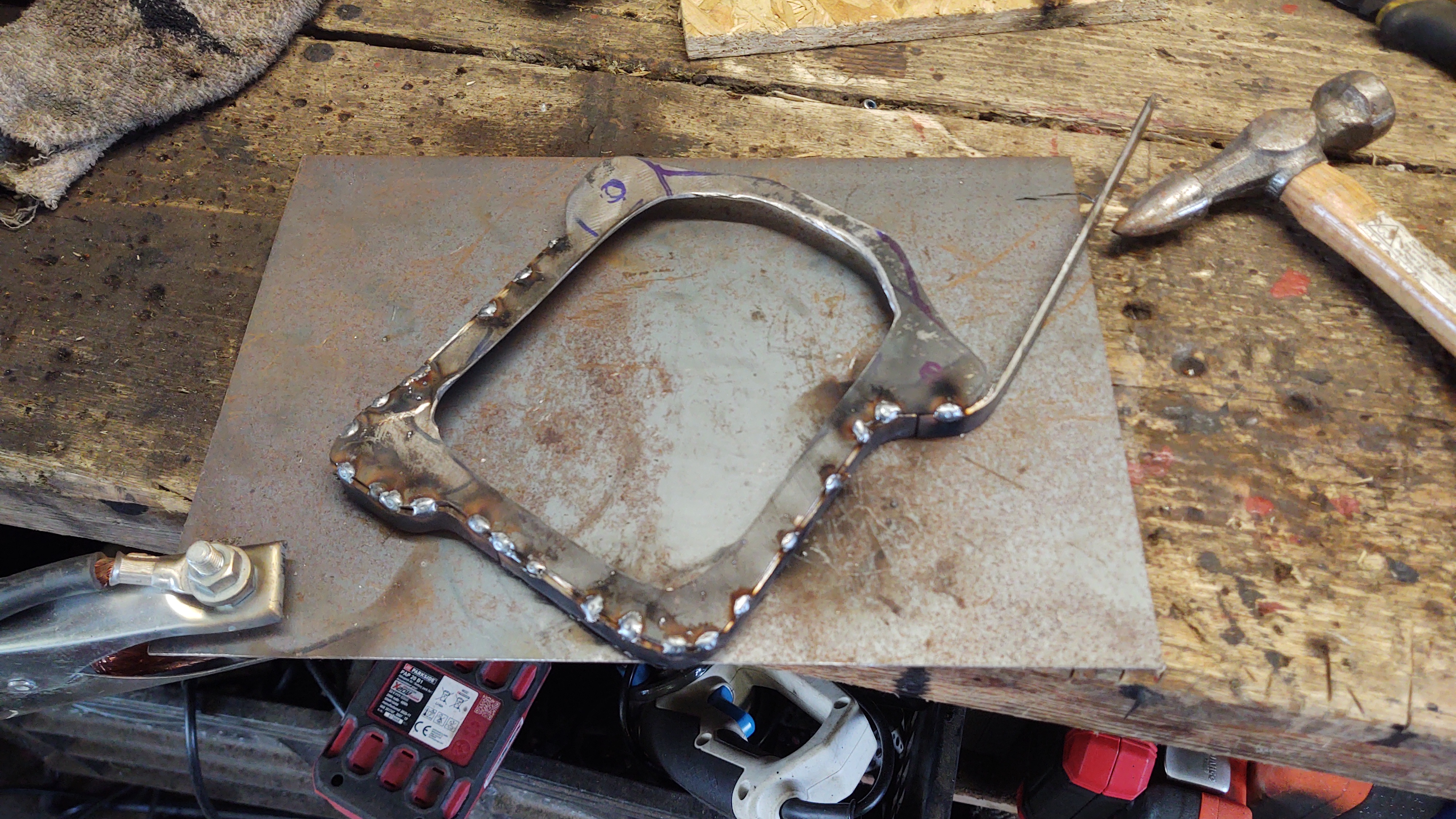

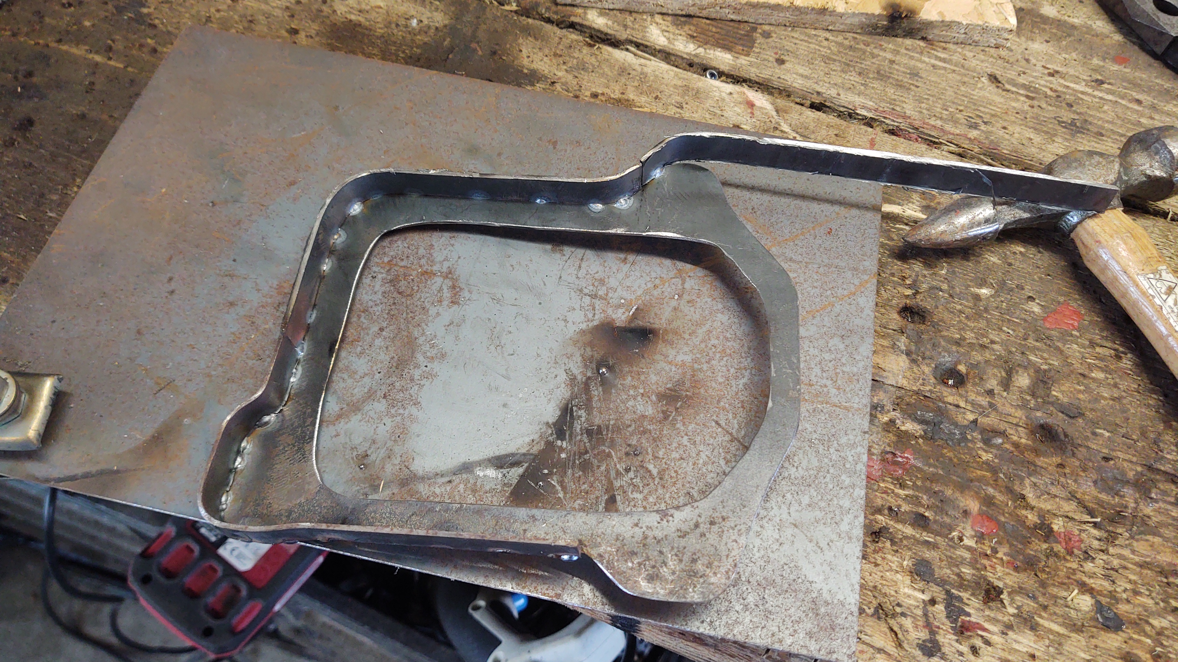

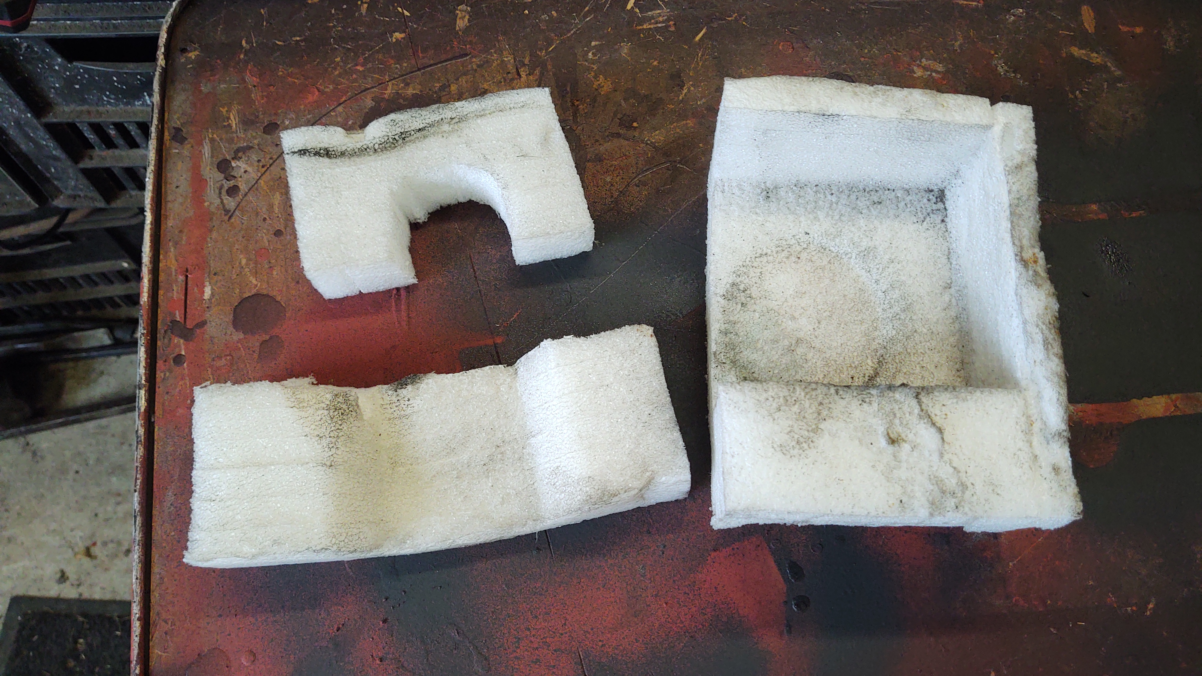

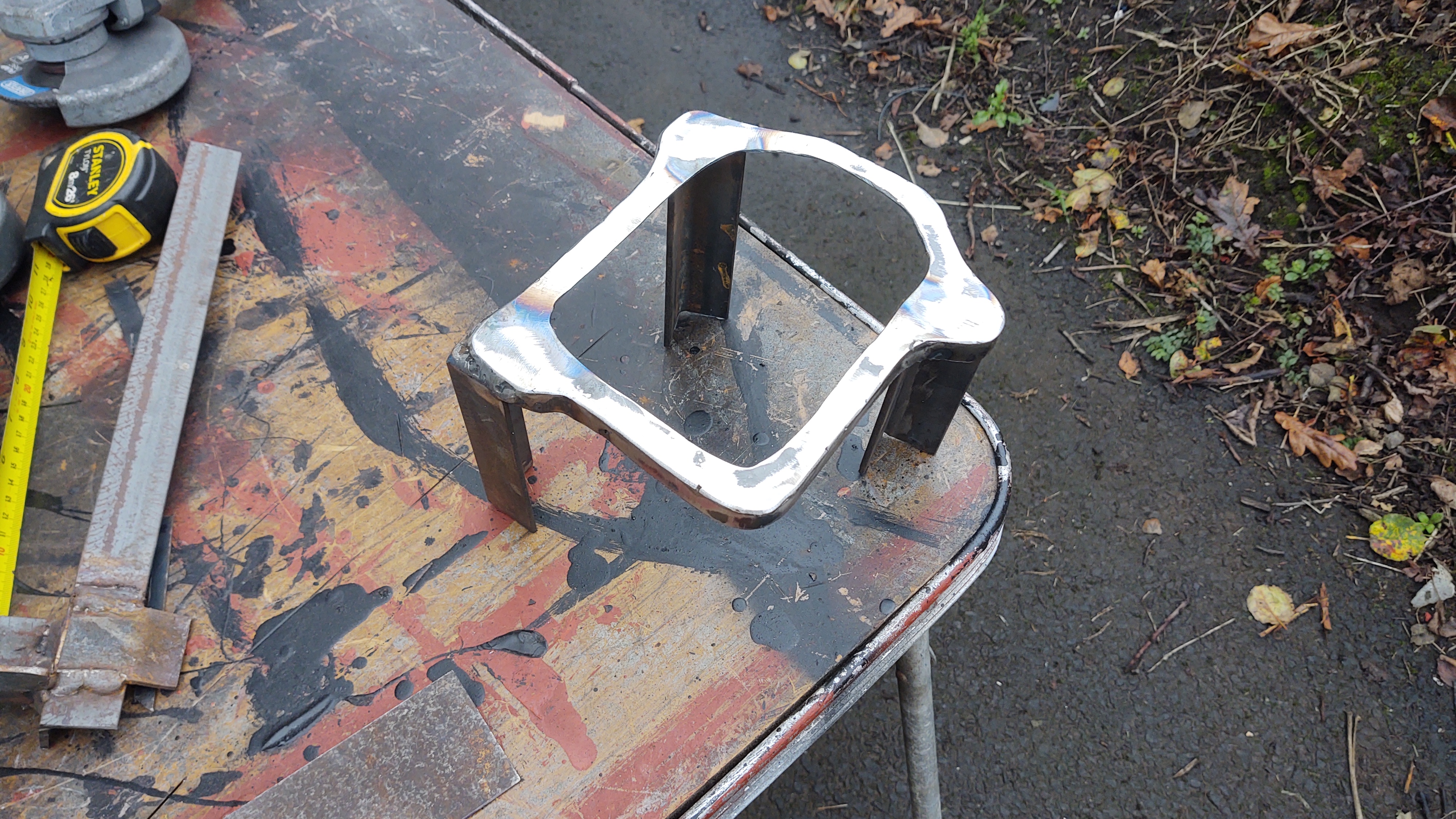

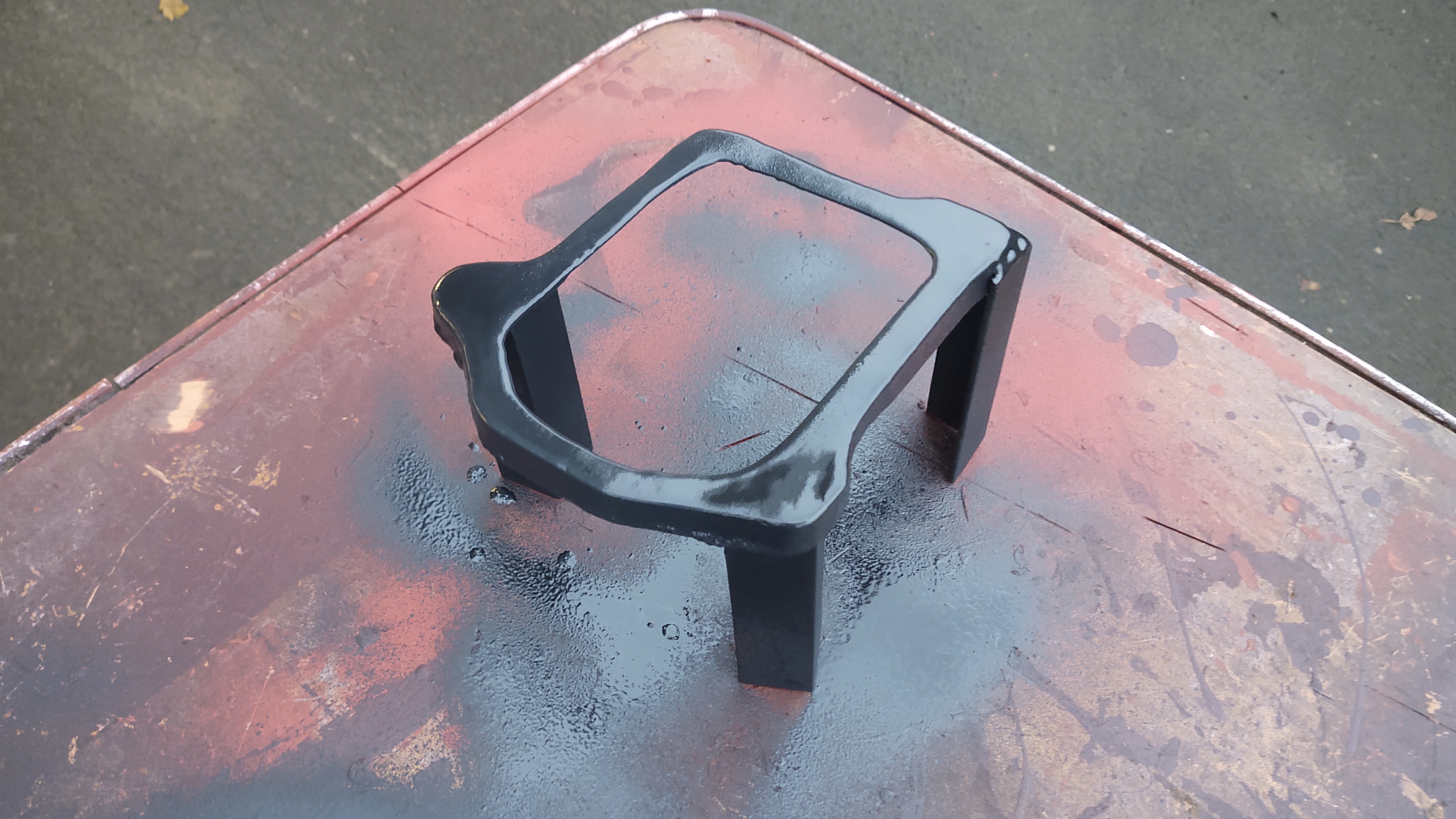

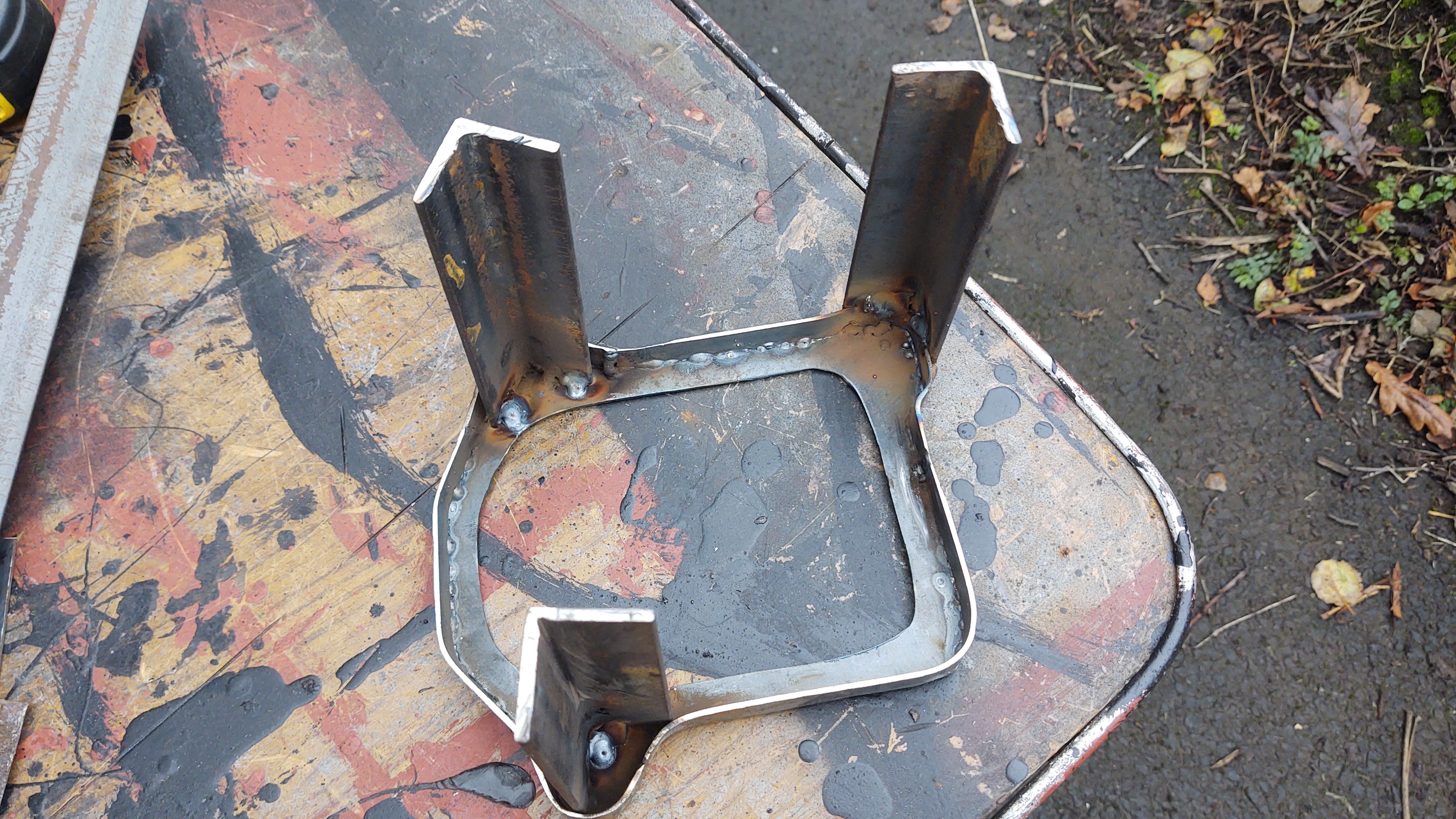

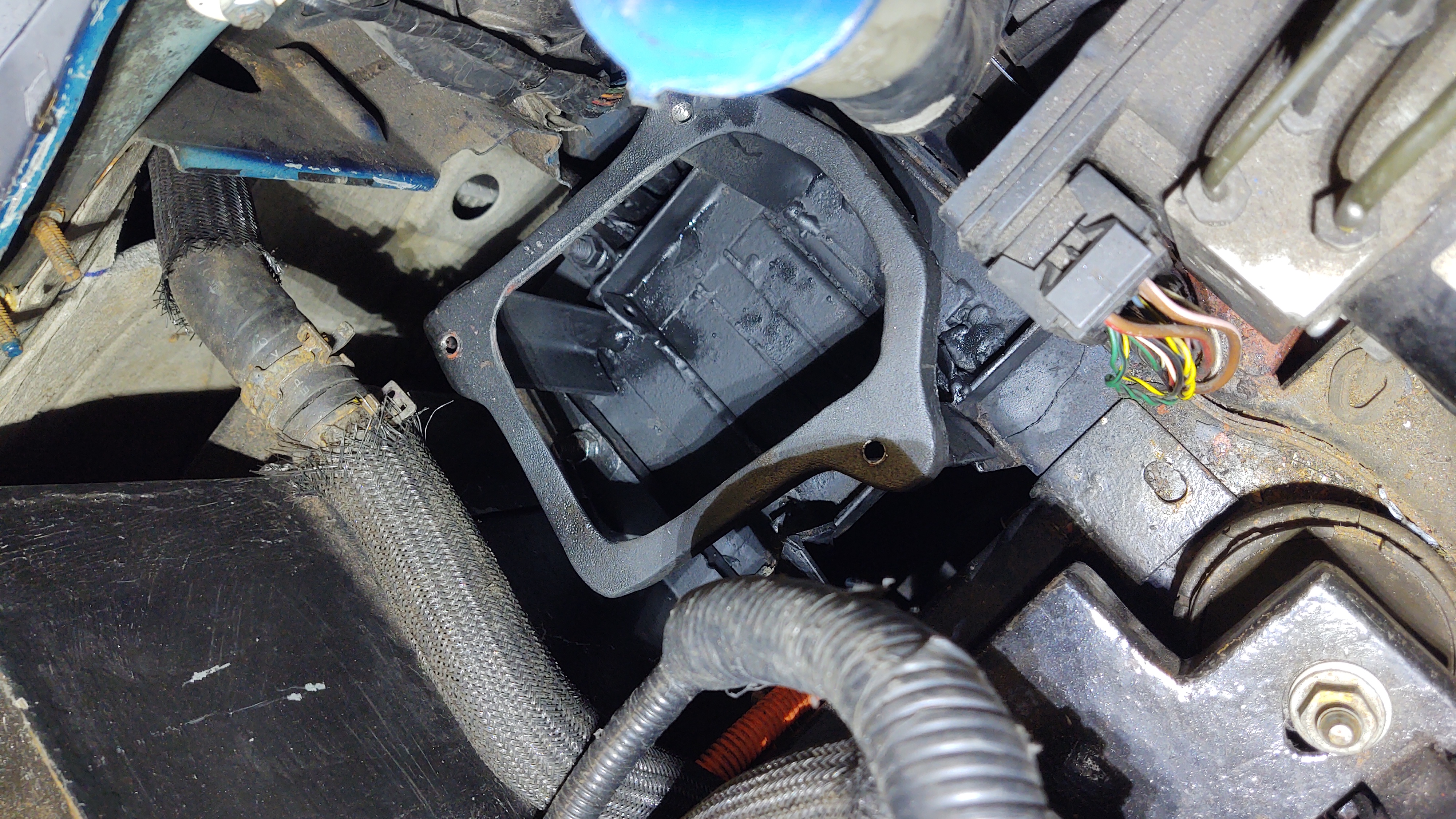

So this week I decided it was time to secure my power steering pump properly instead of just jamming it in with foam packing.
I never got a photo of it installed like this but this is the foam I was using. It worked surprisingly well for a couple thousand miles.
So I started by cutting a hydraulic pump shaped hole in a bit of 1.5mm steel then welded a lip onto it.
Before grinding my Fugly welds.
Then I welded on some angle supports.
Before final grind and paint
I then drilled and tapped holes to secure the pump and welded it into position. It is welded to my battery bracket, not to the car so no issue with DVLA
Nice and solid now.
I'm really pleased with how it turned out but I currently don't have any rubber mounts holding it. I just used M8 bolts and washers so I find it much louder then it was before. Hopefully with rubber bushings it will be a bit quieter but I need to figure out a way to make them as they didn't come with the pump.

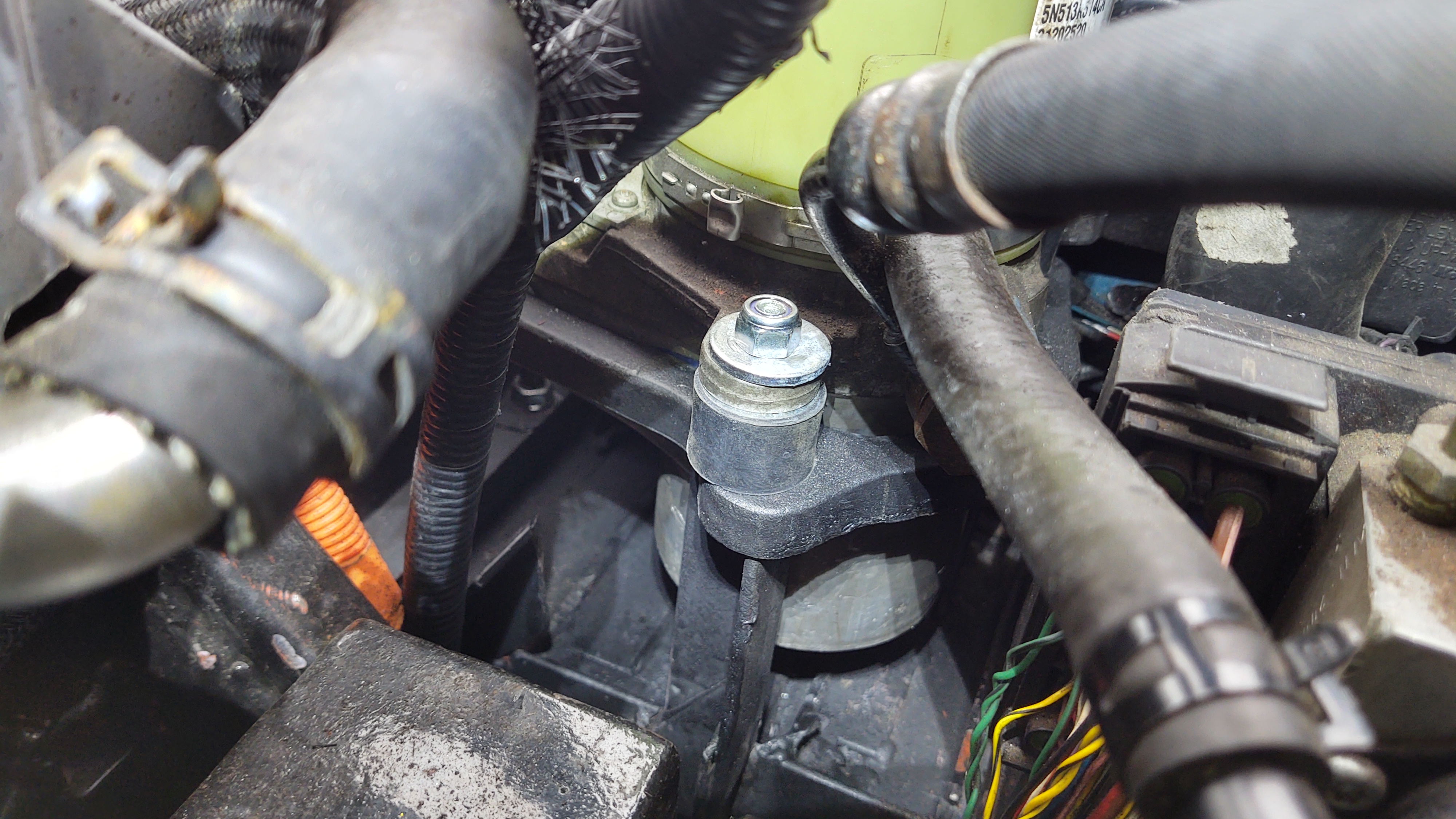

The PAS pump is much quieter now with these, I think they're called bobbins but they make a big difference.
https://ebay.us/IgouJS
Not quite as quiet as the foam but not as bad as bolting in directly.

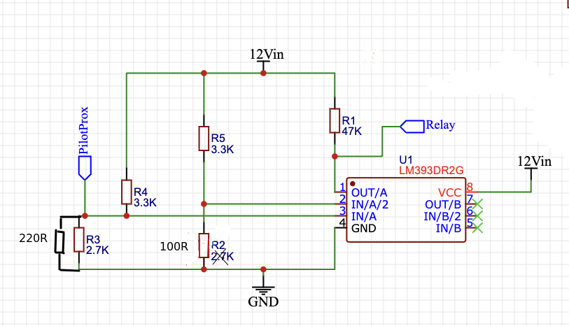

The first thing I did was build a circuit to detect when the charging plug was shoved in.
This is from a post in another thread.
viewtopic.php?p=79533#p79533
Now the charger will turn off when the Charge Control Arduino Due sees the pack reach a preset voltage from the shunt.
And if it fails to stop charging for any reason the VCU uses the Inverter voltage to turn off the charger at a preset voltage
So now I have a circuit that detects when the charger plug is in I needed to figure out how to implement it. I wrote a list of everything required for charging and spent a few nights wiring in a 6 way relay module I intend to use.

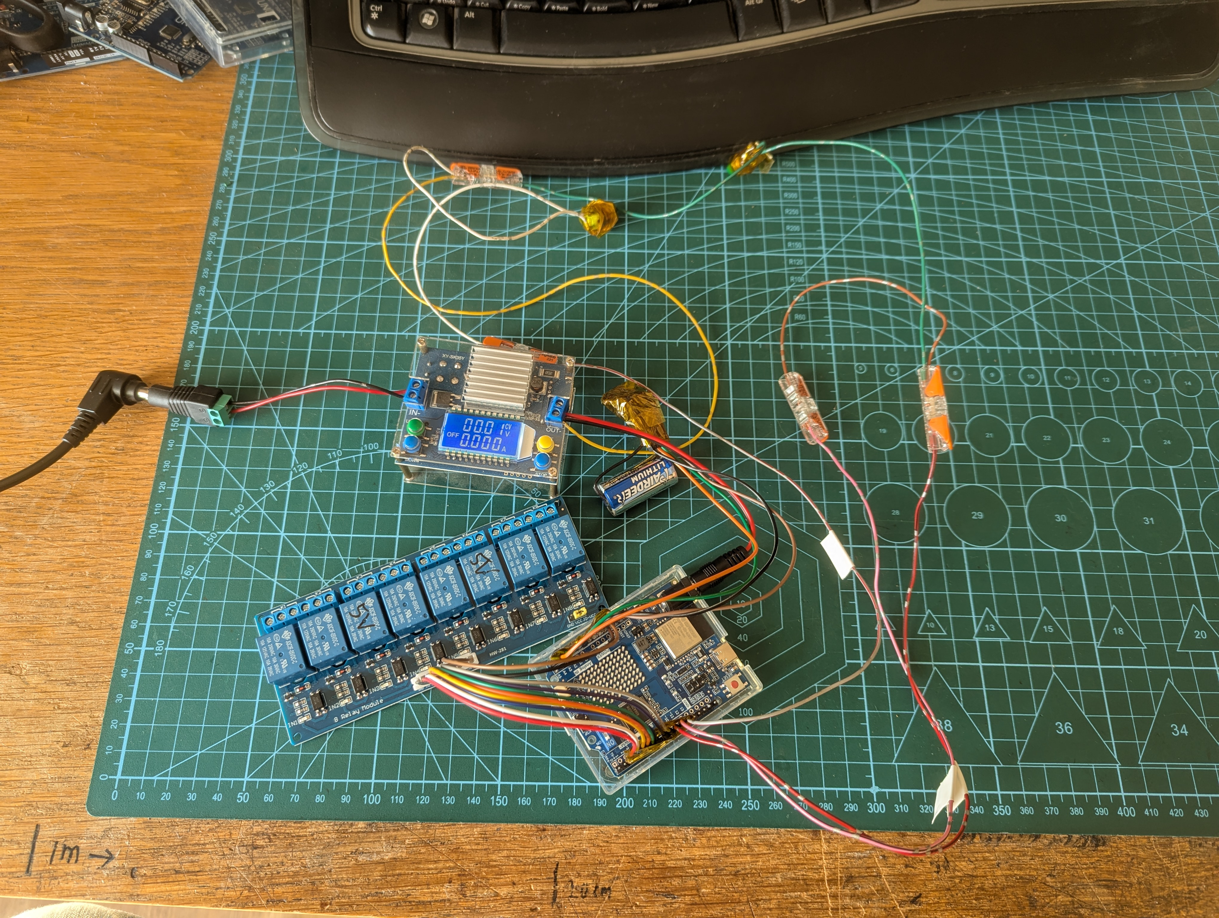

Next step was to ensure I had a backup or failsafe to prevent over charging so I made some changes to the VCU code. I never used O/P 3 to power up the inverter as it was originally intended so it's now providing GND to the charger. If the pack exceeds a preset voltage which is 2 volts higher than it the default max it will power off the charger which basically crashes out of the over charge situation, in fairness I should have done this earlier and my only excuse is it was less of an issue as I always set an alarm.Alibro wrote: ↑Mon Feb 03, 2025 2:39 pm So after a bit of messing about I came up with a circuit that works well enough to turn on the relays when the charger plug is inserted and turn off the relays when the catch is pressed on the J1772 handle so that I can't pull the handle out with the current still flowing.
In my case the J1772 socket already has a 2.7k resistor going to ground built into it so I took that out of the circuit.
I also found that with 3.3k resistor in the voltage divider circuit from 12V to pin 2 the relays were on all the time even without the cable plugged in. I tried changing the 2.7k resistor but couldn't get the circuit to trigger when the catch was pressed so changed the 3.3k resistor instead. I used a POT fo figure out what the ideal resistance was and it ended up being 255R. I didn't have a 255R resistor have so used a 240R and 13R in series which was close enough.
The relay module I'm using is a 12V 8 way block that can be set to trigger on a neg or pos signal.
https://amzn.to/4hroiOX
This is it on some strip board and so far it's working so now I need to work out how to implement it.

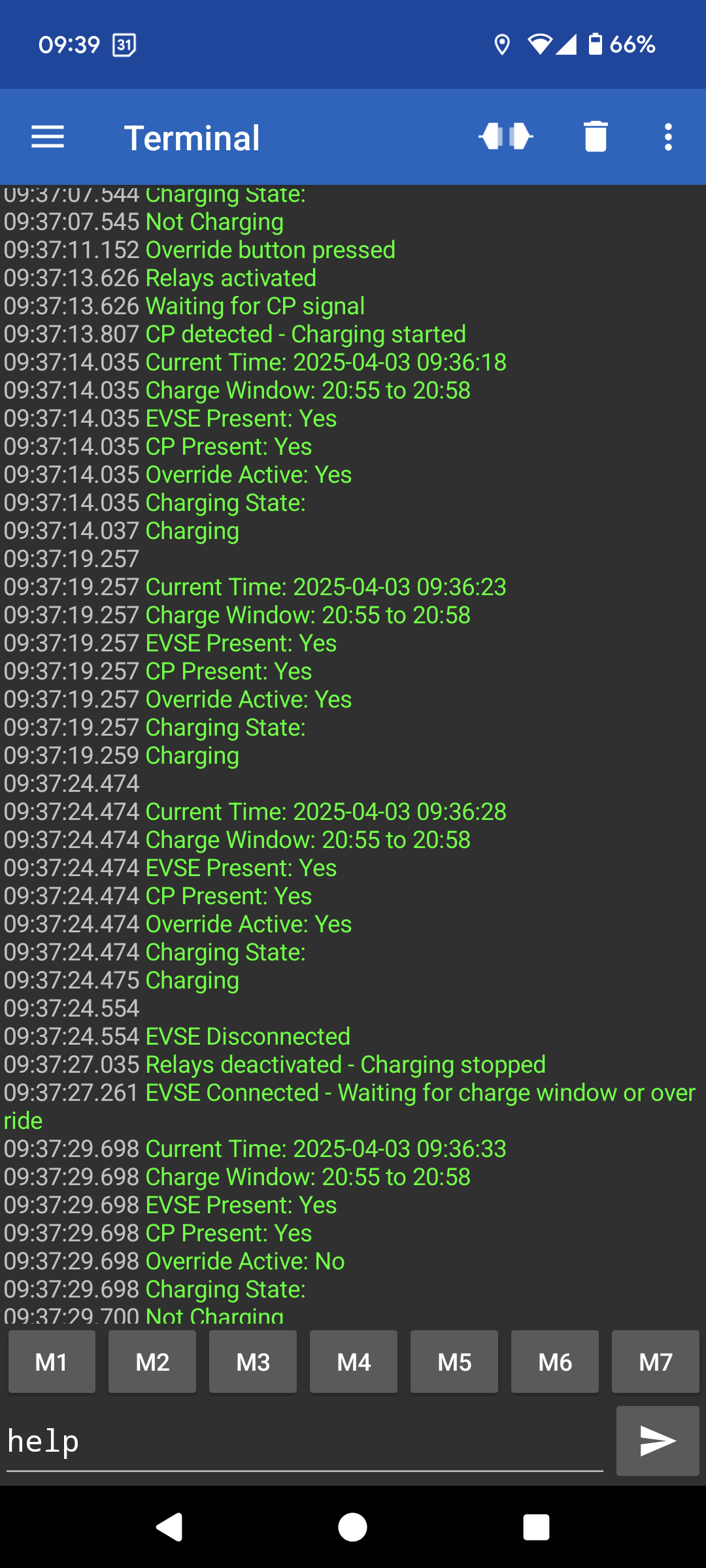

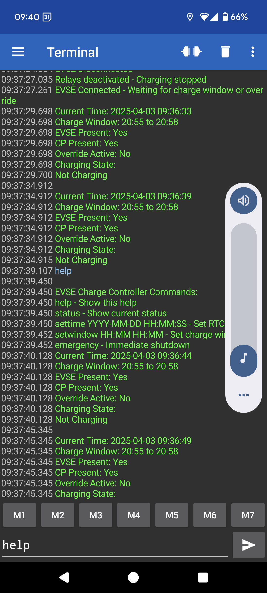

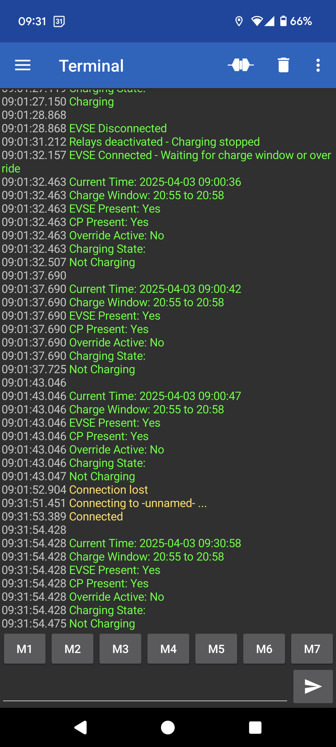

The last part of the puzzle was to write the code for an Arduino Nano to control the charging process.
After many not fun hours fighting with ChatGPT and Deepseek, I finally have a working software solution, if anybody is mad enough to have a look the code is below.
Basically I gave up on using a MOSFET module as neither ChatGPT nor Deepseek could figure out the logic required to turn it on when the Nano boots, and keep it on until the relays are all turned off, so I switched to using a two way relay module instead. I figured we were already using a relay module enabled by the Arduino pins going low so this would simplify things.
ChatGPT still couldn't make it work correctly and often messed up the bits of code that were working so I gave up on it and tried Deepseek which was much better. It seemed more able to make the changes I wanted without screwing up the rest of the code and eventually gave me a working program.
I only understand the basics of Arduino code but essentially this is what happens.
When I plug in the charger cable the Arduino Nano is turned on by the LM393.
The Nano turns on relays 7 and 8 when it boots turning on the Arduino Due.
It then sits waiting for grounds to come from PP and CP,
If both are present and I don't push the charge now button it will do nothing until 2am, then turn on relays 1 to 6 starting the charging.
If the pack voltage reaches a preset level the Arduino Due releases CP and the Nano turns off all relays stopping charging.
If the car is still charging at 8am all relays are turned off stopping charging.
If I had pushed the charge now button the Nano would have turned on relays 1 to 6 starting charging and should continue until complete or 8am.
I don't expect anyone to check this for me and I will be keeping an eye on it for a while but if it's helpful to anyone else out there then that's great.
If anyone has any suggestions I'll be happy to hear them.

I've spent a bit more time on this and now have a working setup but instead of a Nano I'm using an Arduino Uno R4 Wifi.
This sends the serial monitor output via Bluetooth to my phone so I can monitor and control it remotely.
I've had to change the sequencing as I had got it wrong in the previous post but by simplifying a bit everything is working as planned.
I'll do more testing to ensure the charging stops correctly but so far so good.
Here is a photo of the bench testing and some screenshots from my phone.
In this photo I was using a DS3231 RTC module as I was using the same setup that was previously on the Uno R3 but I later took it away and am now using the onboard RTC.

Finally after weeks of procrastinating and quite a few hours testing I managed to get this working at a public charger.
I had to change a couple of things but this is the circuit I came up with.
It's basically the same as Jamies original except R2 is replaced with a 100 ohm resistor and a 220 ohm resistor is connecting PP to chassis ground.
The voltage divider now triggers when the J1772 plug is pushed all the way home and the handle switch closes.
The resistor R3 is already in my J1772 socket so I didn't need to solder it in.
I've tested the timer by setting it to charge overnight and all is working well.
The Arduino code is here
https://github.com/Alibro53/Uno-R4-Charge-Controller
I also wrote out a detailed description of the sequence required to start charging

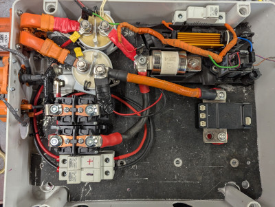

Re: [Driving] Freelander EV With Gen1 Leaf electrics and Original EVBMW VCU

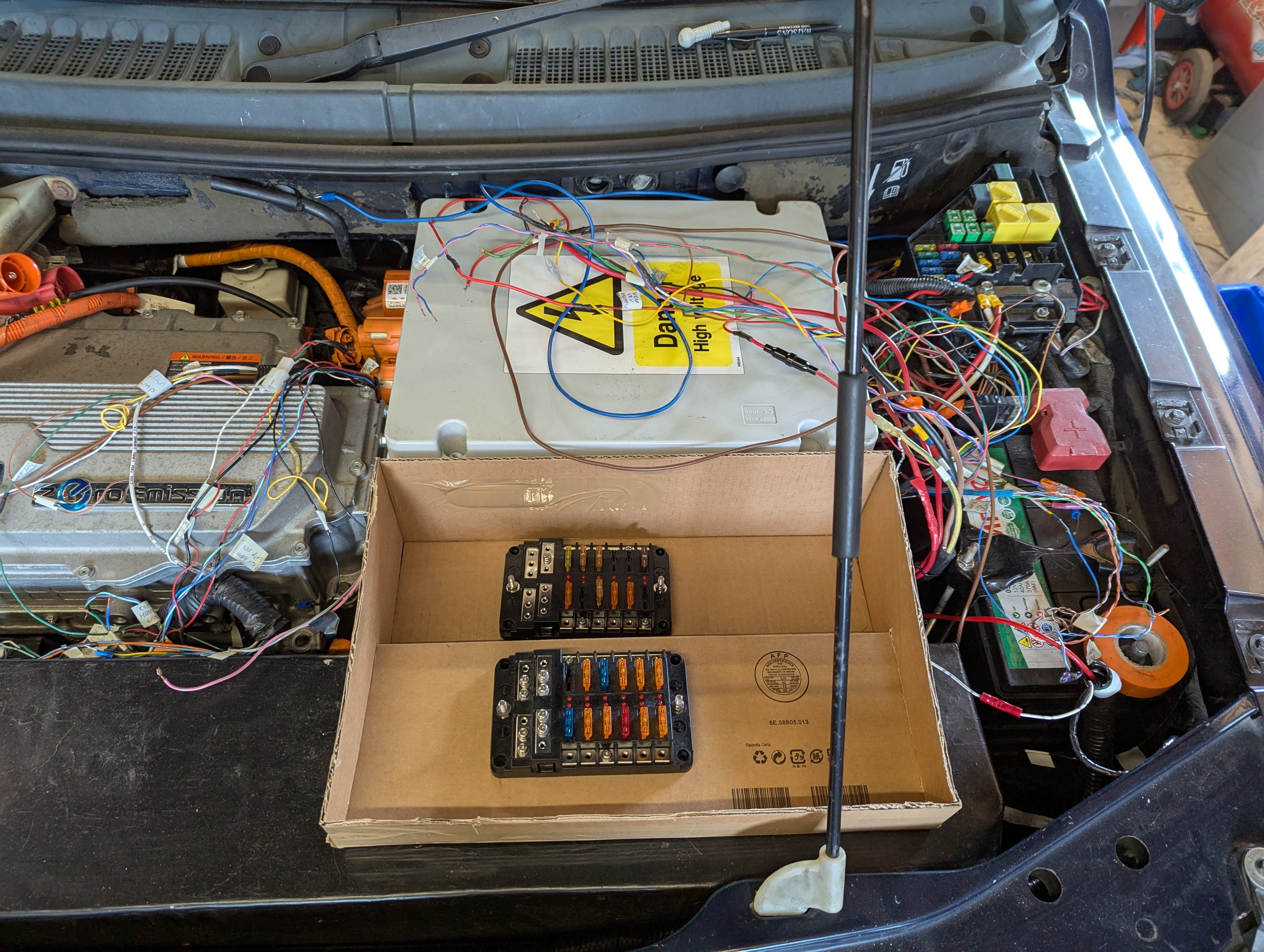

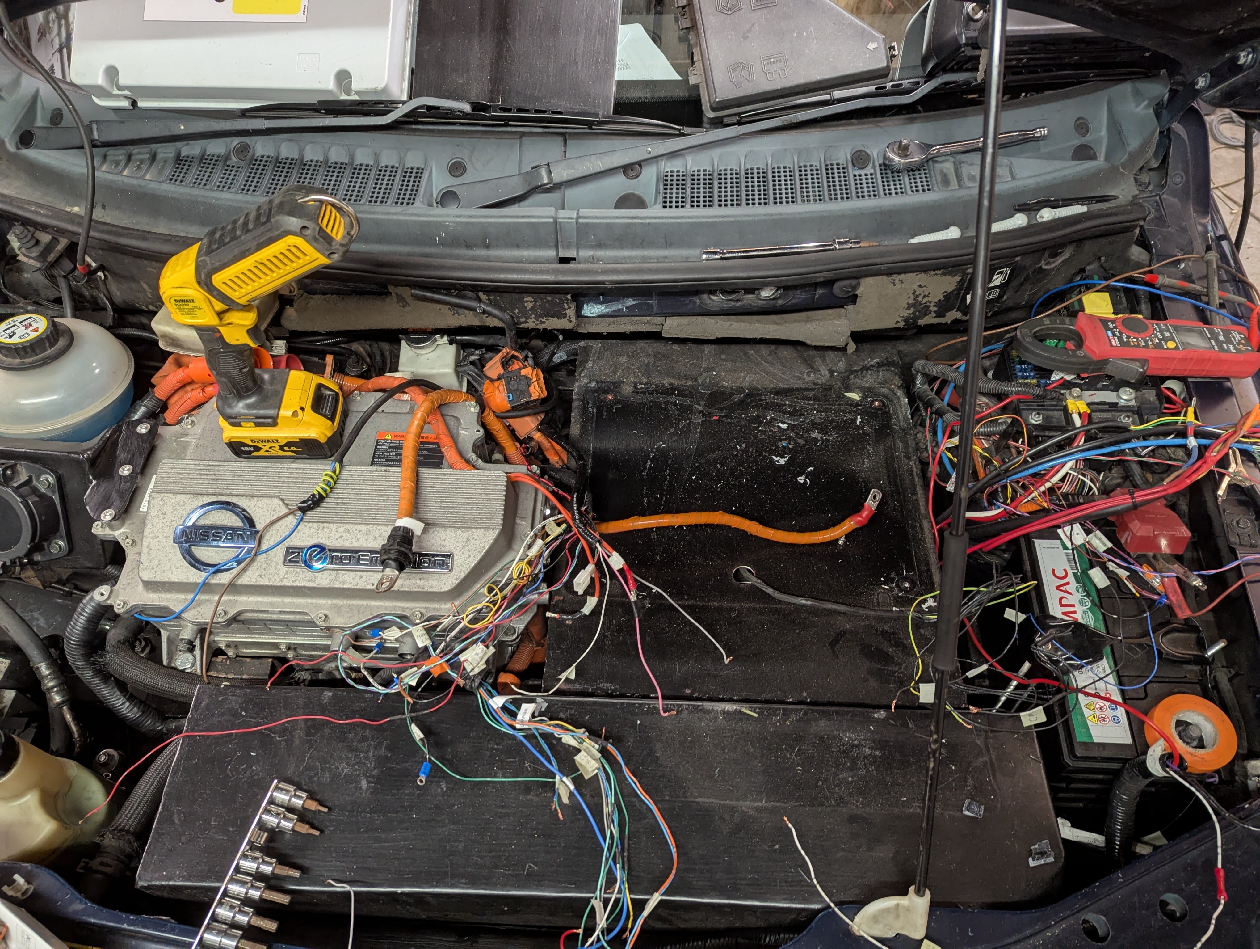

It had to happen sooner or later.
I'm replacing the Mk1 Leaf VCU with a Zombieverter so most of the work I've done recently is now redundant!
Even worse I've ripped out the old HV and LV junction boxes to try and sort out the unholy mess that the old ones were.

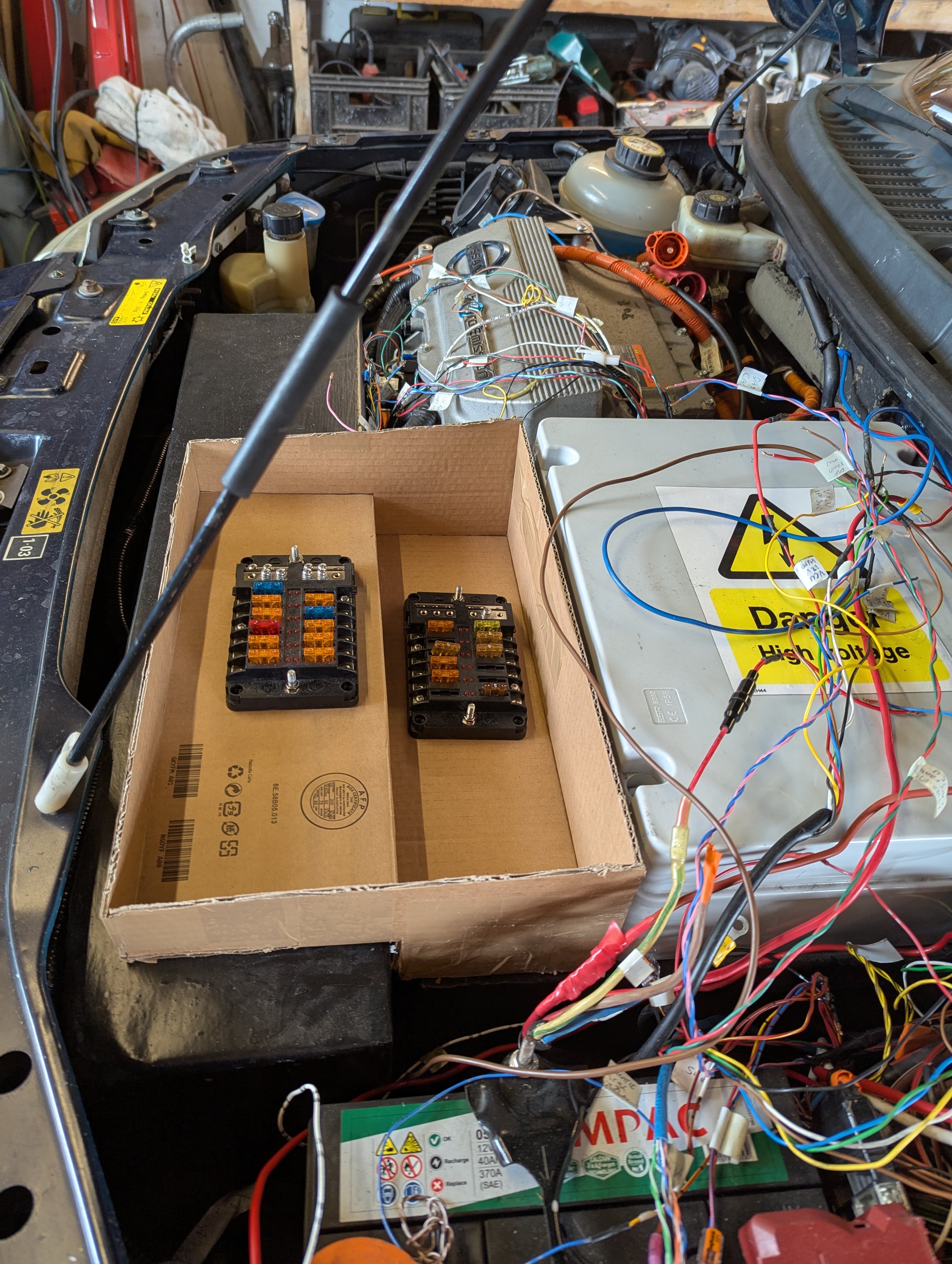

This is the new layout for the HV JB and not a 12V relay module in site.
I needed another two contactors in the HV JB for Chademo charging so it made sense to take the opportunity to remove all the 12V stuff that shouldn't have been there in the first place. I won't pretend it's pretty or optimal but I tried as best I could to follow the HV JB design in the Wiki so it should be better than before.
Hopefully I will need fewer Arduino's now I have a Zombie so there should be more room in the LV JB but I took the opportunity to redesign it as well.

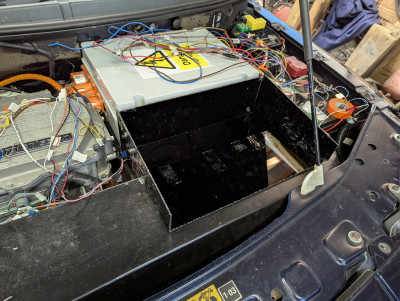

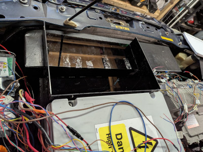

CAD prototype I'll probably regret the decision to build it from the most brittle material known to man.... acrylic
The box base is now finished so I'm busy extending dozens of 12V wires so that they all enter from the right. This is to make it possible to move it out of the way should I ever need to get into the front battery box.
