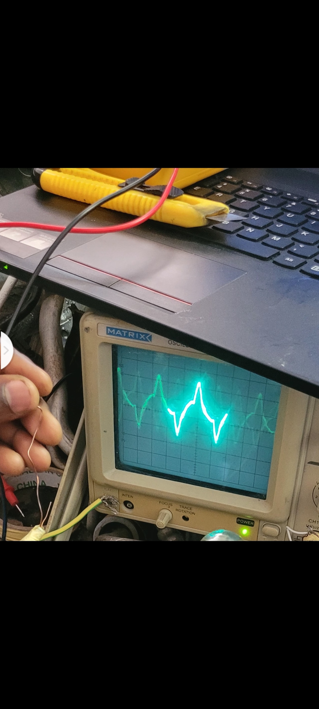

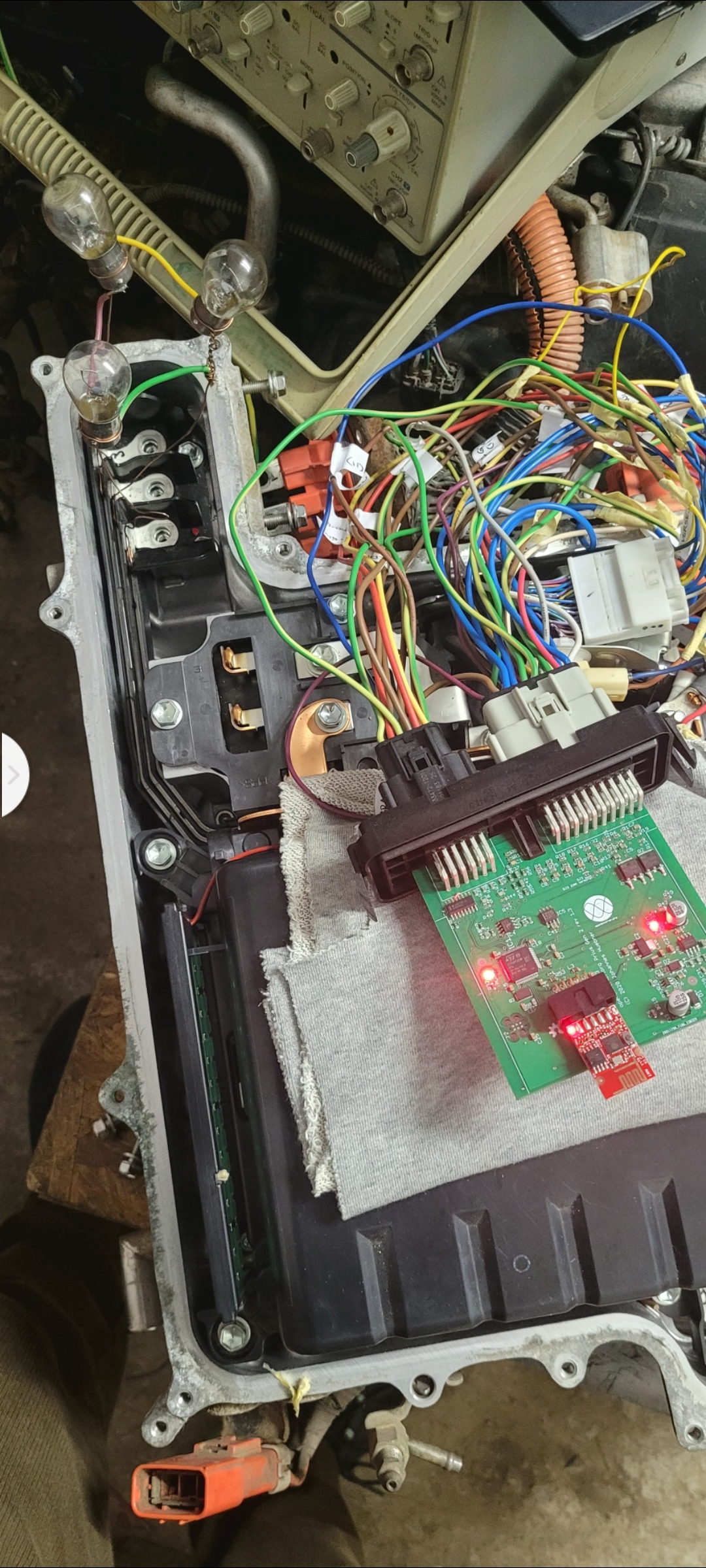

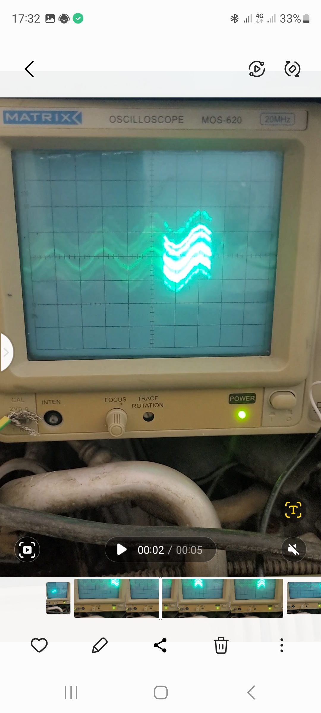

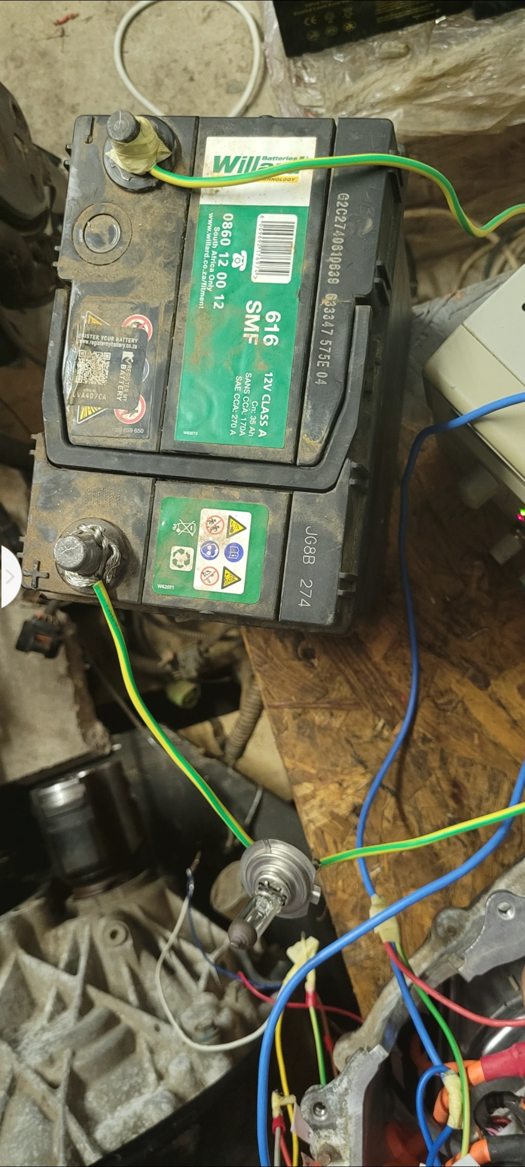

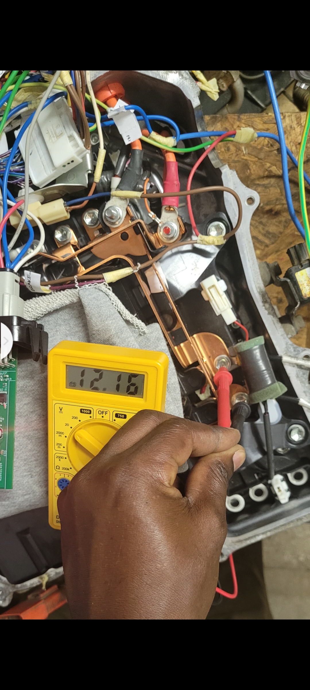

Re: EV Conversion using prius gen 2 inverter/transaxle
It saddens me to tell you guys I tested today with a car battery but still nothing happened. I even replaced the cables to the i10 connector but the bulbs still wouldn't light up.
I really wish I knew what is wrong with my setup.
Below I attached pictures of the setup during testing.
- Posts: 596
- Has thanked: 213 times
- Been thanked: 173 times
Can you find something better to connect the wires to your battery? The wrap / twist method can glitch and drive you in maddening circles of reboots, brownouts, etc. I'd suggest starting there then retest. Some terminals can unbolt from the cable and use a ring terminal. Or if you are really short on parts / availability you can put the wire under a normal battery terminal as crude wire to post clamp.

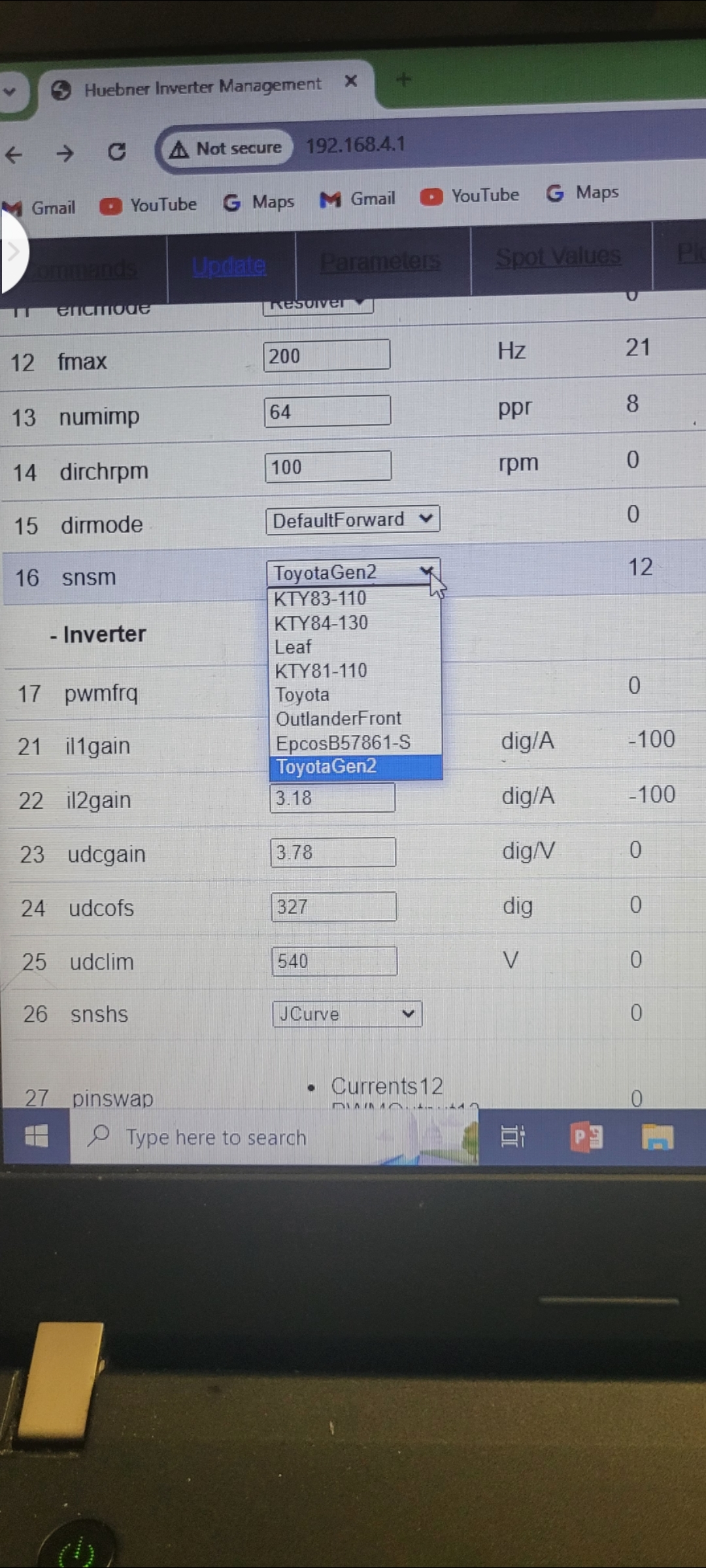

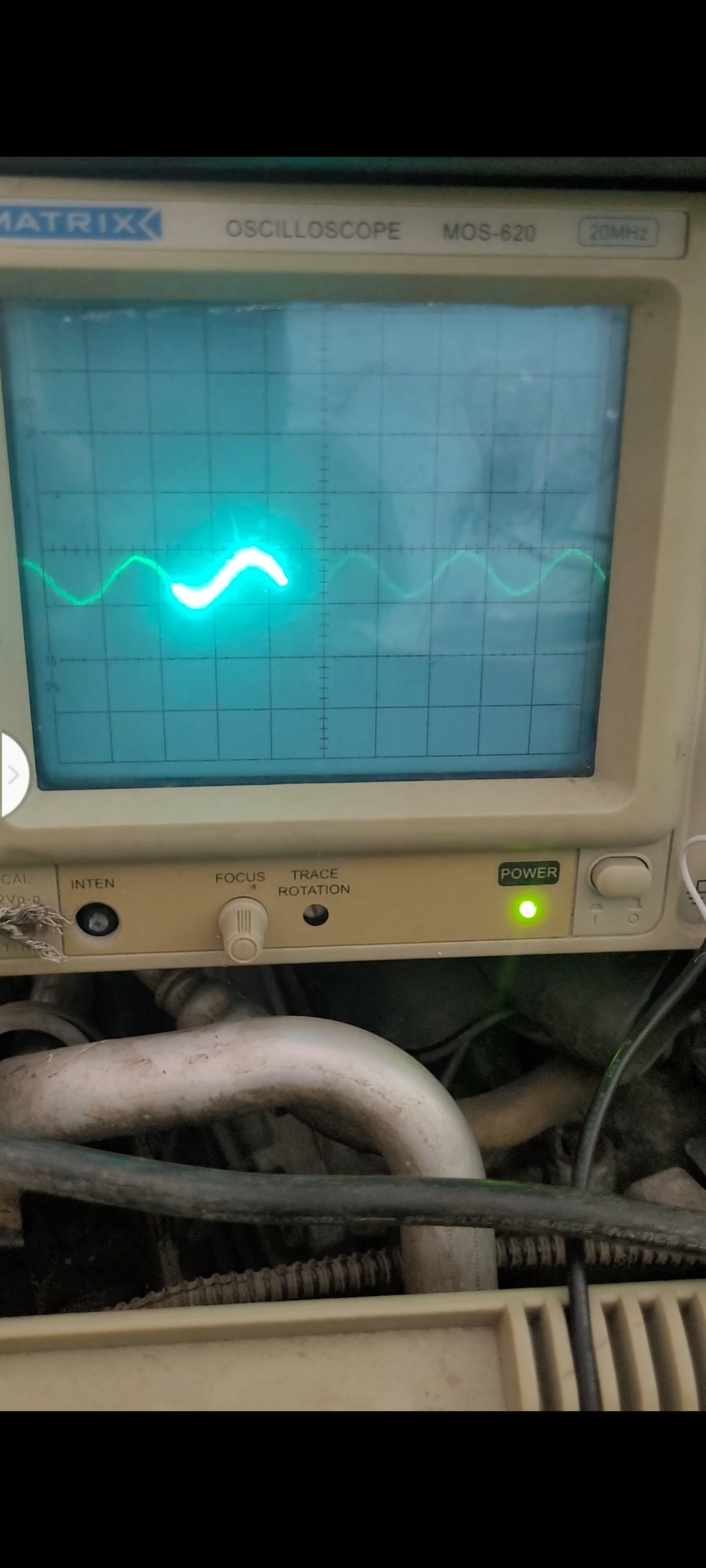

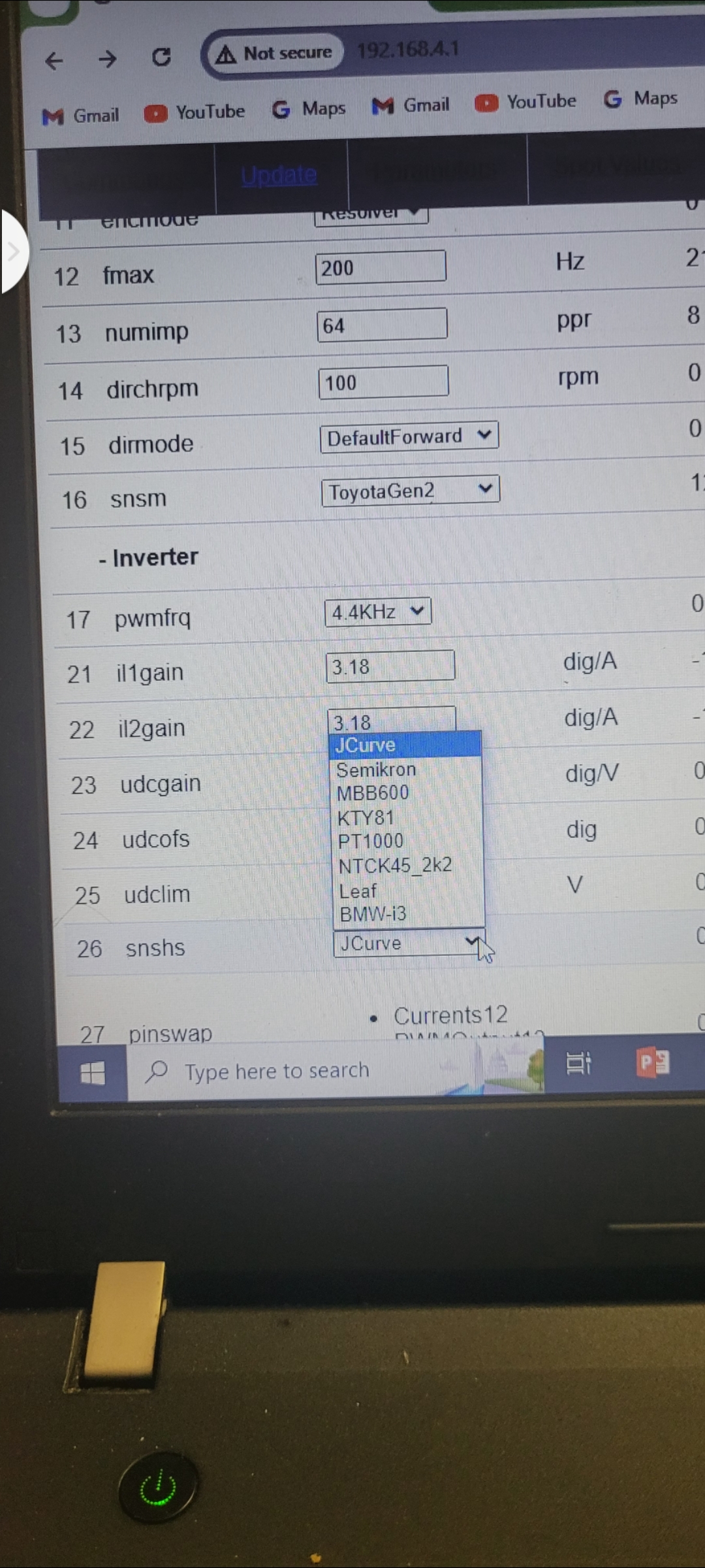

Hang in there. If I could get mine working with everyone's help, we'll get yours working too.
What we did with my troubleshooting was dig deeper and deeper into the "What's not happening" to find out exactly where it's not happening.
You gotta be more detailed though, for this to work. You gotta be more descriptive, and if we ask questions to clarify something you should try to answer all of them.
What exactly did you try? And what does "nothing happened" mean?
- Did you try my parameters? Did you dry Johu's?
- Did you try my suggestion of measuring the output voltage or scoping it instead of relying on bulbs as a purely visual indicator? If so what did the voltage and scope pattern say?
- Did you swap out your 55w bulbs for 21w or smaller ones?
- Do you know how to use a scope? Earlier when you didn't have a ground on it, that was a pretty basic mistake. I can't imagine how someone would own an oscilliscope but not actually know to hook up a ground when measuring voltage, so, just trying to get a feel for your knowledge level here. No shame, I own and barely know how to use one myself.

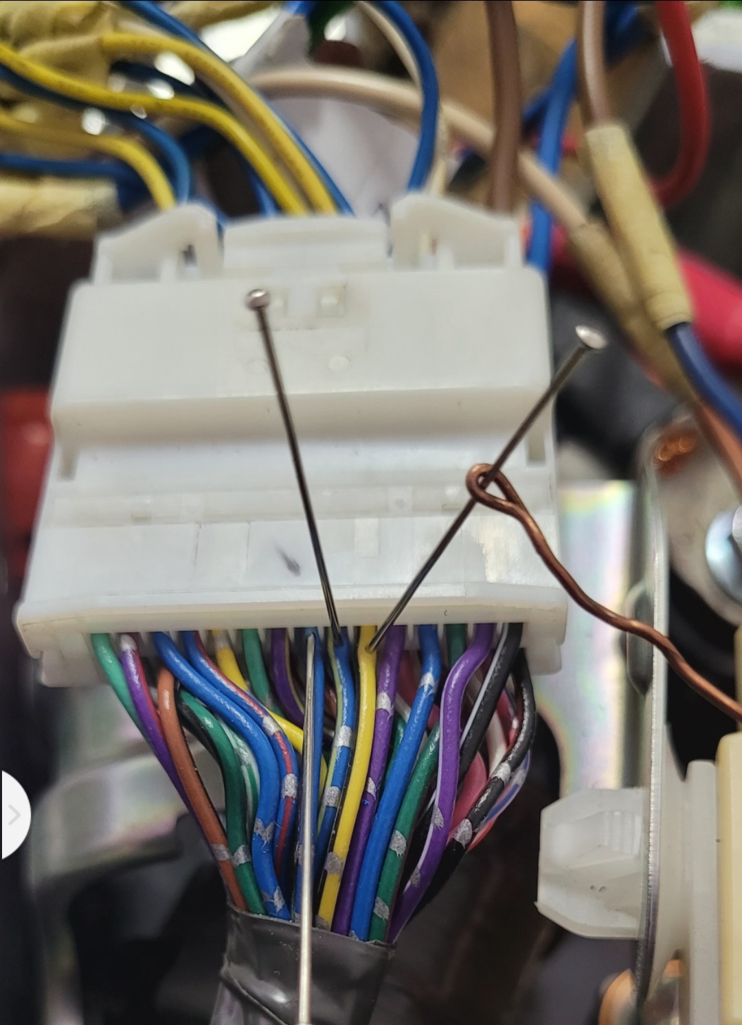

Probably the easiest thing would be to backprobe a wire into the inverter side of the i10 connector's pins 9, 10, and/or 11, and scope that output when you're telling the inverter to start. You'll have to be a bit tricky about it, to make sure the measuring wire is actually making contact when wedged in there.
To be precisely clear, I've labelled them here. Your wire colors should match.
And here's a rough tutorial on how to back-probe. Yours shouldn't be sealed and should be easy to just jab a wire or needle in there:
You should see a waveform. It should change when you change FSLIPSPNT.
If you do see it, then the fault is somewhere inside the inverter. If you don't, the fault is somewhere in the OpenInverter board or software.
We'll keep doing stuff like this, kinda chopping the task in half, until we figure out what's not doing what it should.

I found the 12v 21w light bulbs and connected them in delta configuration, I then connected them to the three phase output. The reason why I had to find the bulbs was because I'm not well versed with using the scope plus I don't have the connecting probes to use with it. The wire I was using is not able to make a ground connection because the connection input on the scope have ground on their outer diameter and the inner female connector on the inside of it.
I also changed the wires on the i10 connector because I was suspecting false connection on them. I also tried your parameters aswell as Johannes' . After all this updates the light bulbs still didn't light up.
I have a question- are the any other parameters that I'm suppose to put in the web Interface ?. e.g under motor section there is "snsm" I found a list of different cars to choose from and also on the inverter section there is "snshs" I found a list of other option there and I didn't know which one to choose. Please also help me with that.
I've attached pictures to show this parameters that I'm talking about

I'm not even certain the bulbs will light up. I had bulbs but I aborted that part of the procedure and just measured voltage when I actually got it to work. Someone else could help you figure that out but, no need to. Use your multimeter and test the voltage when it turns on.I also changed the wires on the i10 connector because I was suspecting false connection on them. I also tried your parameters aswell as Johannes' . After all this updates the light bulbs still didn't light up.
I either haven't made it that far, or that's different than mine.I have a question- are the any other parameters that I'm suppose to put in the web Interface ?. e.g under motor section there is "snsm" I found a list of different cars to choose from and also on the inverter section there is "snshs" I found a list of other option there and I didn't know which one to choose. Please also help me with that.
Have you looked up what those parameters are in the parameter list? Did you know that there is a parameters list?

Okay, the Index has the parameters list, as does at the bottom of the main page in the "additional reading":
https://openinverter.org/wiki/Parameters
And it says:
"snsm" - "Motor temperature sensor."
So, no, we don't need a motor temperature sensor yet. We just want to bypass all the BS and see if we can even do PWM motor control correctly.
"snshs" - "Heatsink temperature sensor."
Also no, we don't need a heatsink temp sensor, yet, or maybe ever.

I found a wire to use as my probe for the oscilloscope, I put in your parameters as is and started the inverter in manual mode. The scope showed no difference in readings.
I think I might have connected probing wire for the oscilloscope correctly because when I tested it with my hand it showed a waveform. I've linked pictures below. Not the best way to test it I know.
When I connected the probing wire to the inverter, to my suprise it showed a waveform even before I turned on the VCU. When I turned on the VCU the waveform was distorted and showed noise signs and i thinks its because of the wire I was using i dont know.thats not a problem because at the center of the distortion I was still able to see the waveform.
I went on the put your parameters that you sent me and started the inverter in manual mode. The waveform didn't change.i used my multimeter to test phase to phase but I got no readings aswell. I had the light bulbs connected but they didn't light up also.
Please see pictures below.

Okay, that's what we expected, because if it was getting the correct waveform it would be spinning a motor or lighting lightbulbs.
Mmm... without testing a known-good signal, and you not giving any measurements for frequency or voltage, it's hard to conclude whether this is like, noise from fluorescent lights in the room next to you and almost zero amplitude, or whether it's something from the inverter, or leakage from the power grid, or who knows.When I connected the probing wire to the inverter, to my suprise it showed a waveform even before I turned on the VCU.
If it's the actual inverter signal it shouldn't be on before you turn the controller on.
Okay. Presuming you did that correctly (I'm skeptical, but that's another thing we'll narrow down), that's also expected otherwise it would be working.I went on the put your parameters that you sent me and started the inverter in manual mode. The waveform didn't change.i used my multimeter to test phase to phase but I got no readings aswell.

Just did the back probe procedure on the front and at the back of the i10 connector.MattsAwesomeStuff wrote: ↑Sun Feb 16, 2025 1:20 am Probably the easiest thing would be to backprobe a wire into the inverter side of the i10 connector's pins 9, 10, and/or 11, and scope that output when you're telling the inverter to start. You'll have to be a bit tricky about it, to make sure the measuring wire is actually making contact when wedged in there.
The oscilloscope showed no change in waveform.
First I put your parameters and tested, then i changed the parameters, I change both fslipspnt and ampnom to try and see what will happen but still no change.

OH NO! No no no.
You don't pierce the insulation and stab into the wires themselves when you backprobe. You put a wire alongside the wire you want to probe, to butt it up against the metal pin inside! I even sent you a video tutorial how to do it without damaging the wires.
Now you've got wires side-by-side with pierced insulation. Hopefully you can later de-pin them and heatshrink them so they don't short against each other.

Did you test voltage (both AC and DC) on those pins as well? Again, I'm not confident you know how to use your scope, we should be measuring the voltage as a second backup.

I watched the video you sent me on hoe to backprobe but i decided to pierce the wires because when I stuck the pins next to the wires I wasn't sure if I was making contact on the inside so to avoid any mistakes I pierced the wires.

You could've just done a continuity test with the other end of the wire. Don't go damaging things just to test.
