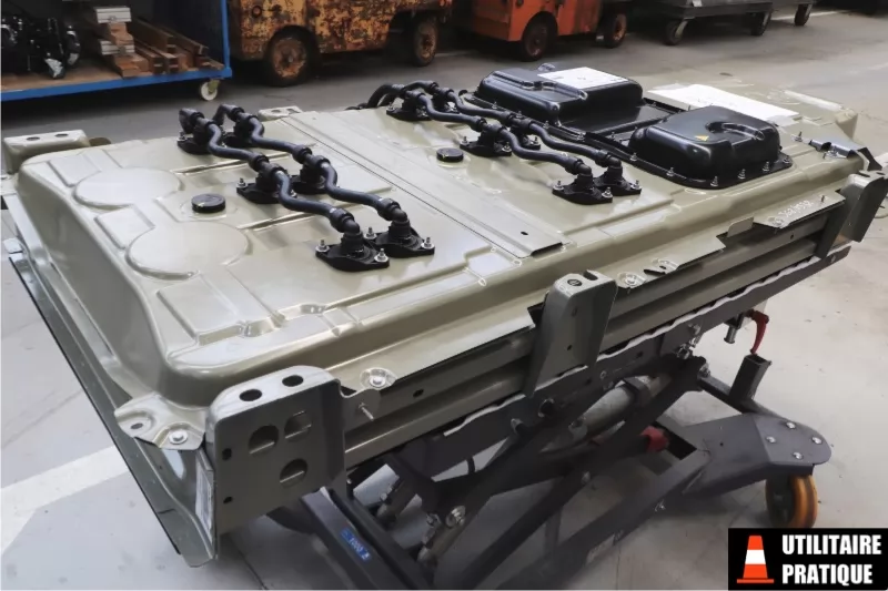

Has anyone ever taken one of these batteries apart? They are the common PSA/Vauxhall/Toyota van line batteries. Their prices have started to come down rapidly.
They exist in 50kWh and 75kWh versions and prices seem to be good here in the UK

Hi Tom,
I've taken apart a 75kWh battery. It is made of 27 modules with a 4S3P configuration for 108S. The cells are from CATL. I've attached some pictures.
The BMS is based on MAX17823B, with nine BMS PSCB in a 12S configuration.
Despite the 50kWh battery, where each module has a BMS with a 75kWh battery, only nine modules have a BMS PCB. Other modules are connected to these with BMS.
The blue module is with BMS, and two grey modules are connected to the blue one.
The gray module inside
The 12S BMS PCB.
The 12S BMS PCB.

I have not personally taken apart a 50kWh battery, but I'm familiar with the modules inside.
I've been using them for energy storage projects. They are 6S2P configuration, CATL cells, 2.74kWh, each with BMS PCB based on MAX17823B. Some of the latest batteries use the newer MAX17854.
Here are some info on these batteries:
viewtopic.php?t=2465
viewtopic.php?t=2675
A lot of pictures:
viewtopic.php?t=2627
About the BMS chip inside:
viewtopic.php?t=1179
AFAIK these batteries are glued, which makes opening them a bit hard.

Friendly warning.
Do not mix up order of master-slave modules as you going to burn down master (blue) module bms resistors or even max IC. I've Done that.
