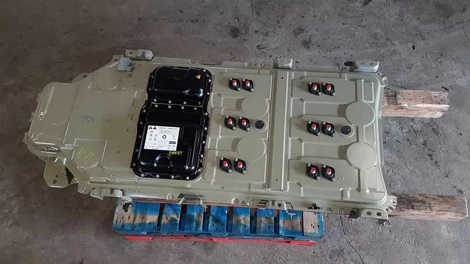

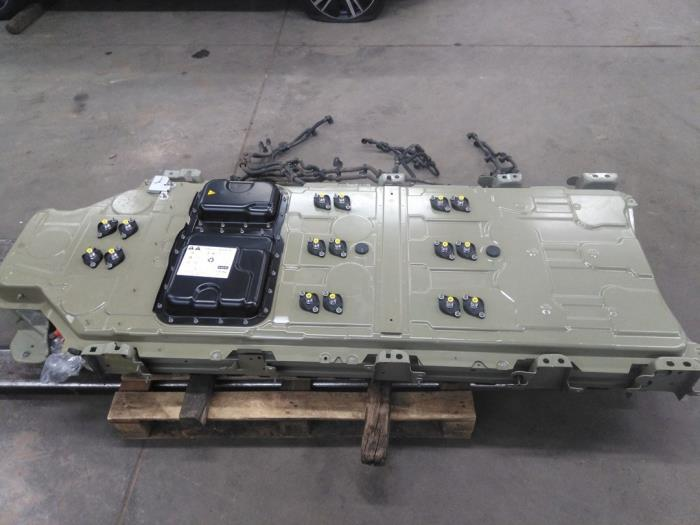

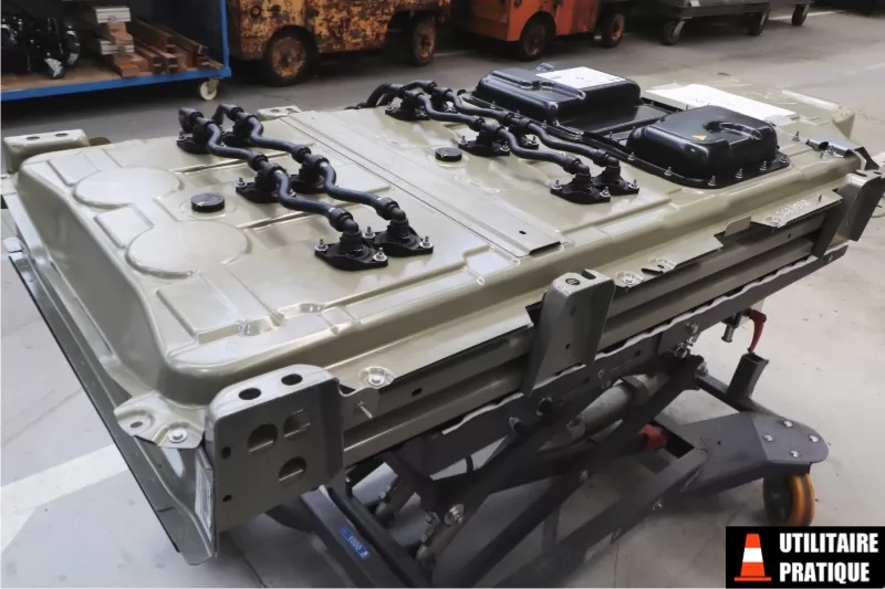

Has anyone ever taken one of these batteries apart? They are the common PSA/Vauxhall/Toyota van line batteries. Their prices have started to come down rapidly.
They exist in 50kWh and 75kWh versions and prices seem to be good here in the UK

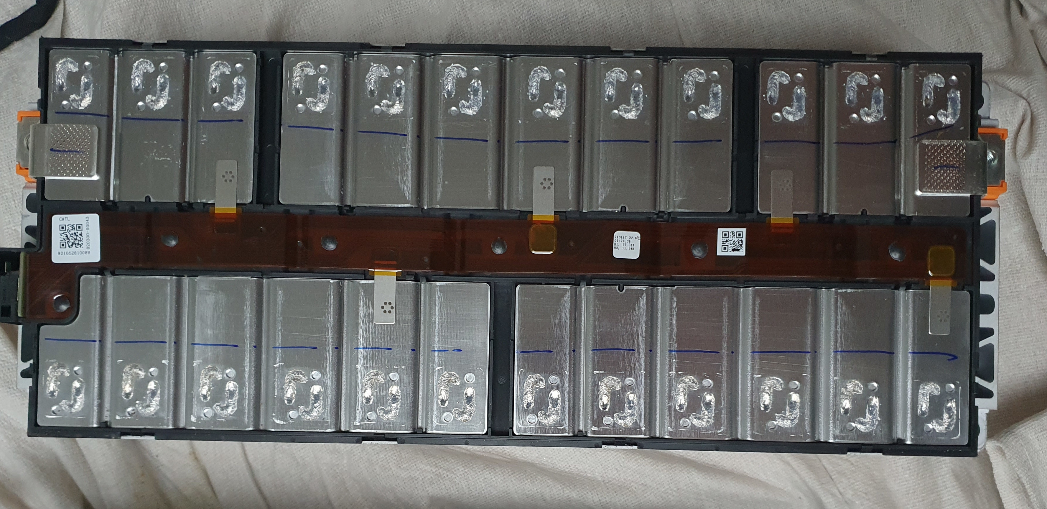

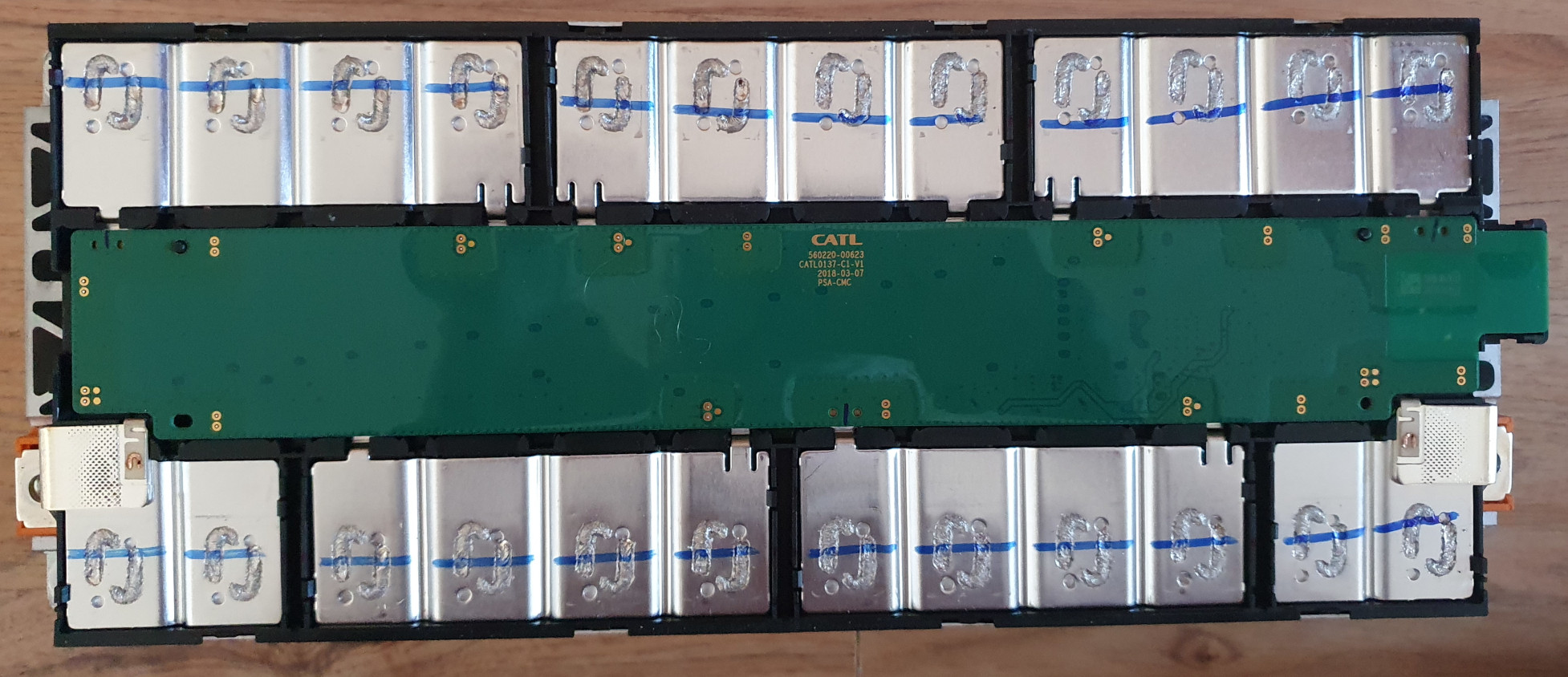

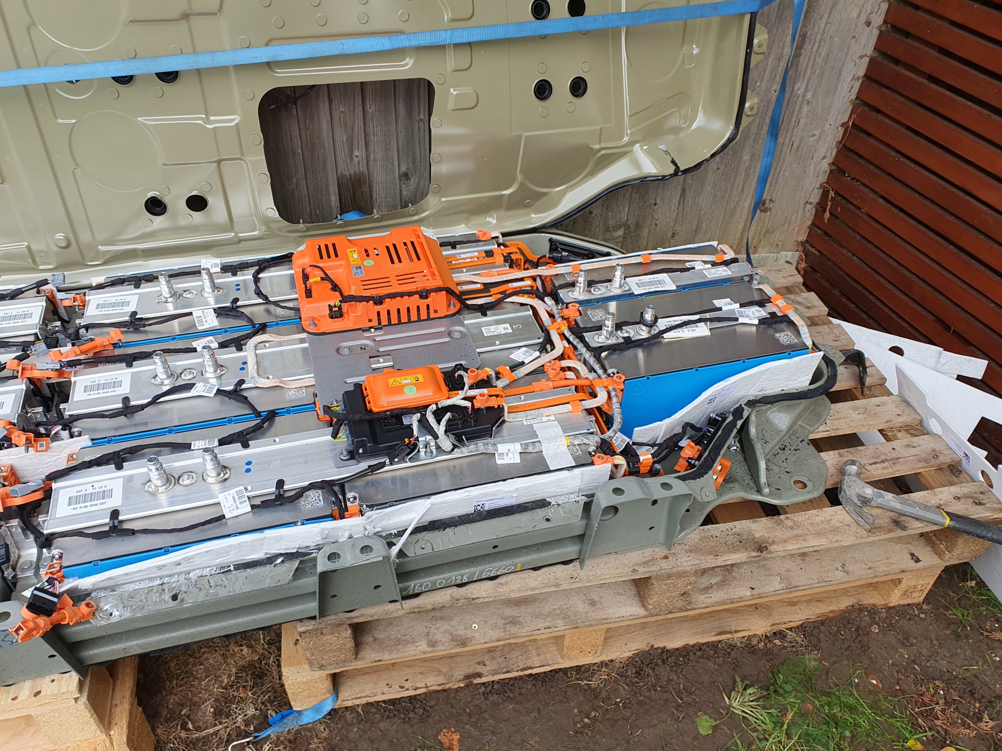

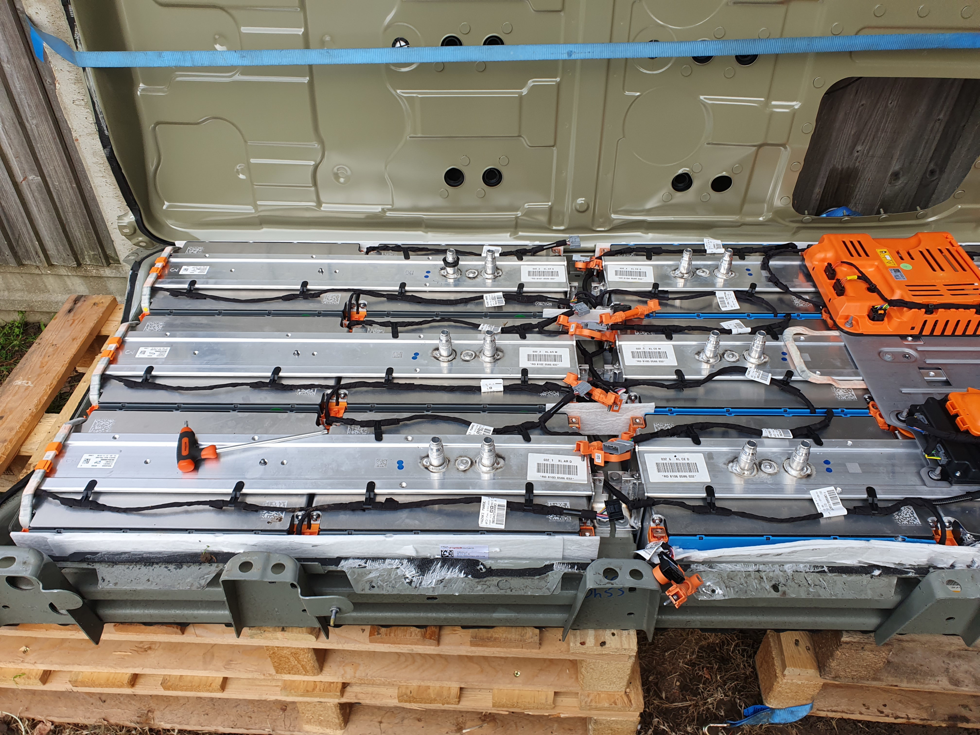

I've taken apart a 75kWh battery. It is made of 27 modules with a 4S3P configuration for 108S. The cells are from CATL. I've attached some pictures.

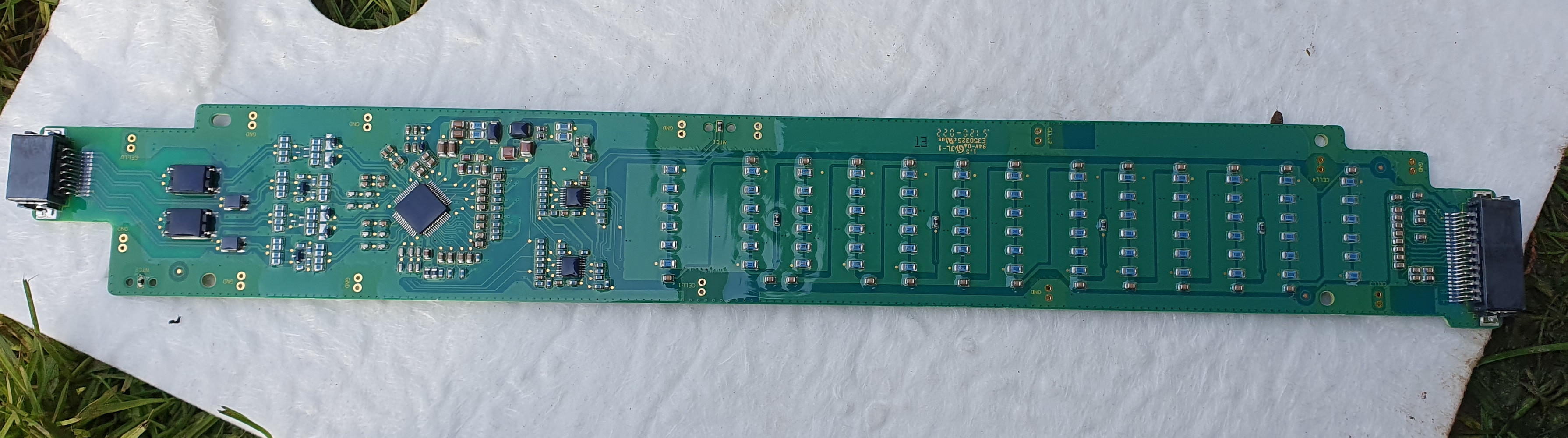

The BMS is based on MAX17823B, with nine BMS PSCB in a 12S configuration.
Despite the 50kWh battery, where each module has a BMS with a 75kWh battery, only nine modules have a BMS PCB. Other modules are connected to these with BMS.
The blue module is with BMS, and two grey modules are connected to the blue one.
The gray module inside
The 12S BMS PCB.

yasko wrote: Sat Feb 15, 2025 5:22 pm nly nine modules have a BMS PCB. Other modules are connected to these with BMS.
Ah cool just like the Egolf approach
Thank you for the pictures, you ever have a 50kWh apart?
