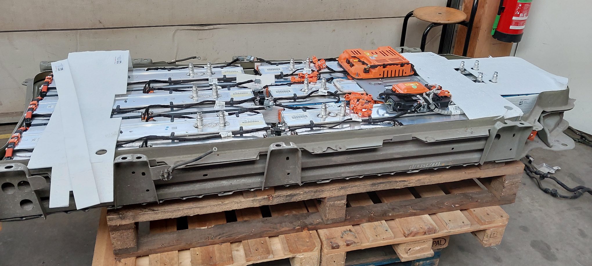

used in lots of vans: 75 kWh battery pack, 33k km
still unopened, might be usable to upgrade a 50 kWh car? (not sure about tools needed)
Price: as is (closed battery), in NL (Zaandam), €5000,- ex tax

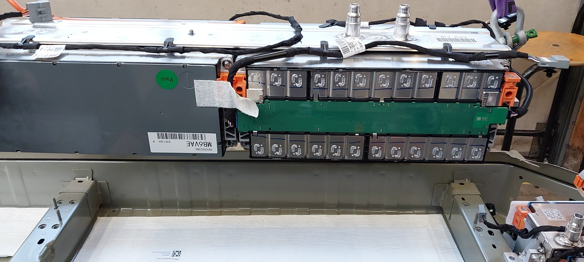

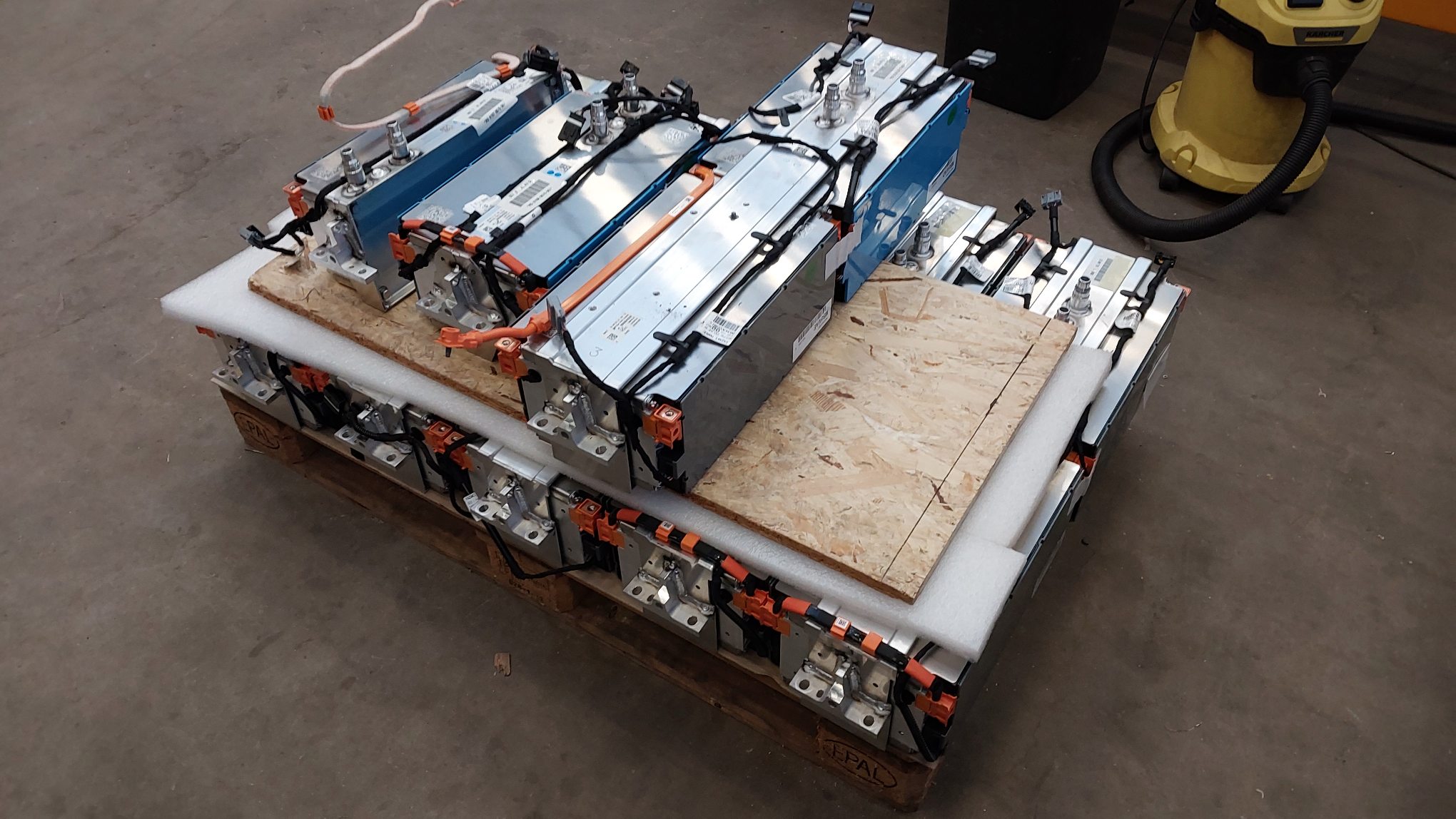

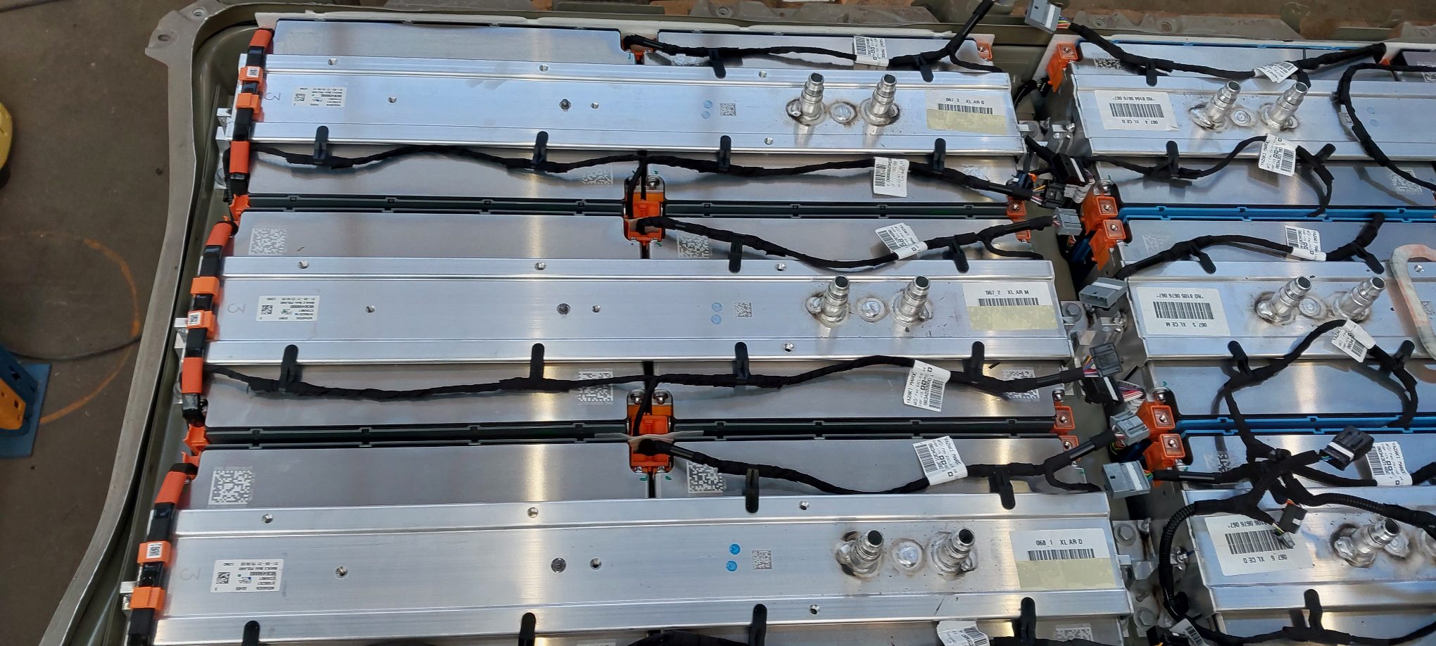

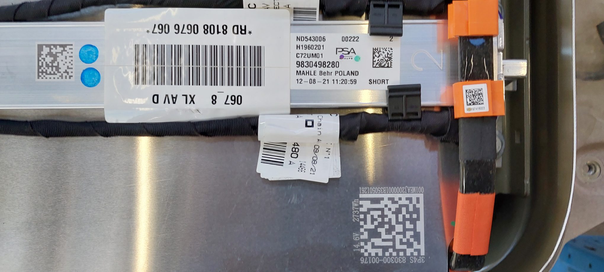

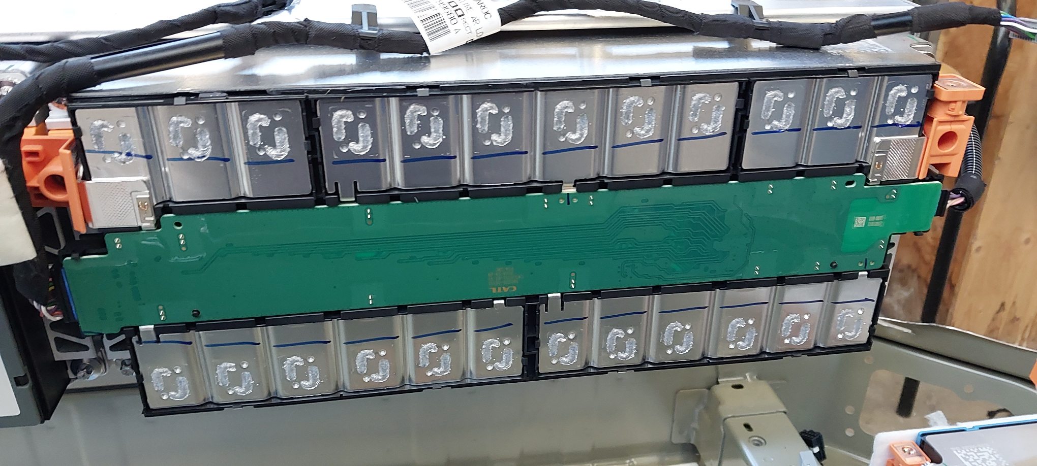

So I opened the pack...
CATL modules and BMS
seems like every other module has a CMU that also reads the next module
nice watercooled blocks with 4 modules (plus one with 2 and one with 1 module)
4s / 2.73 kWh / module

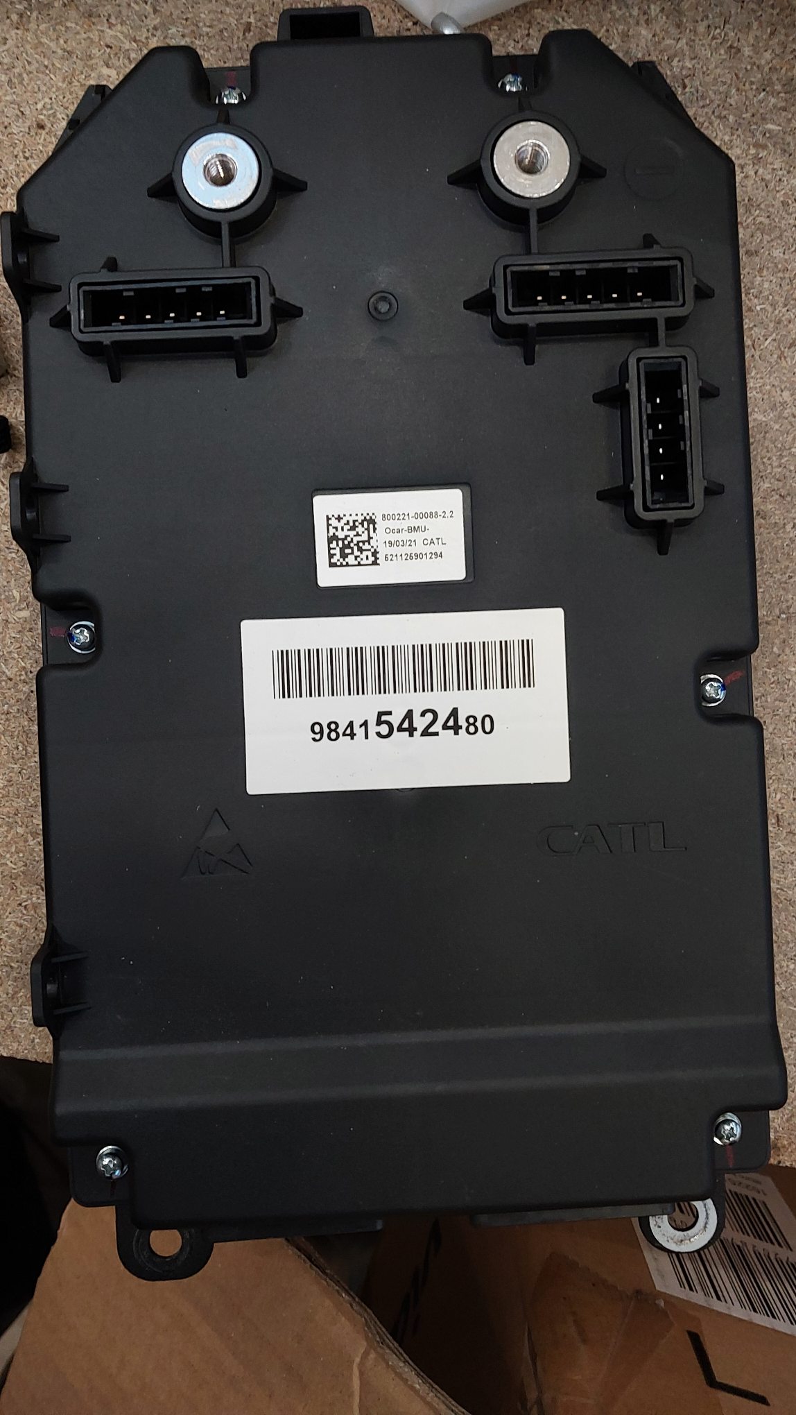

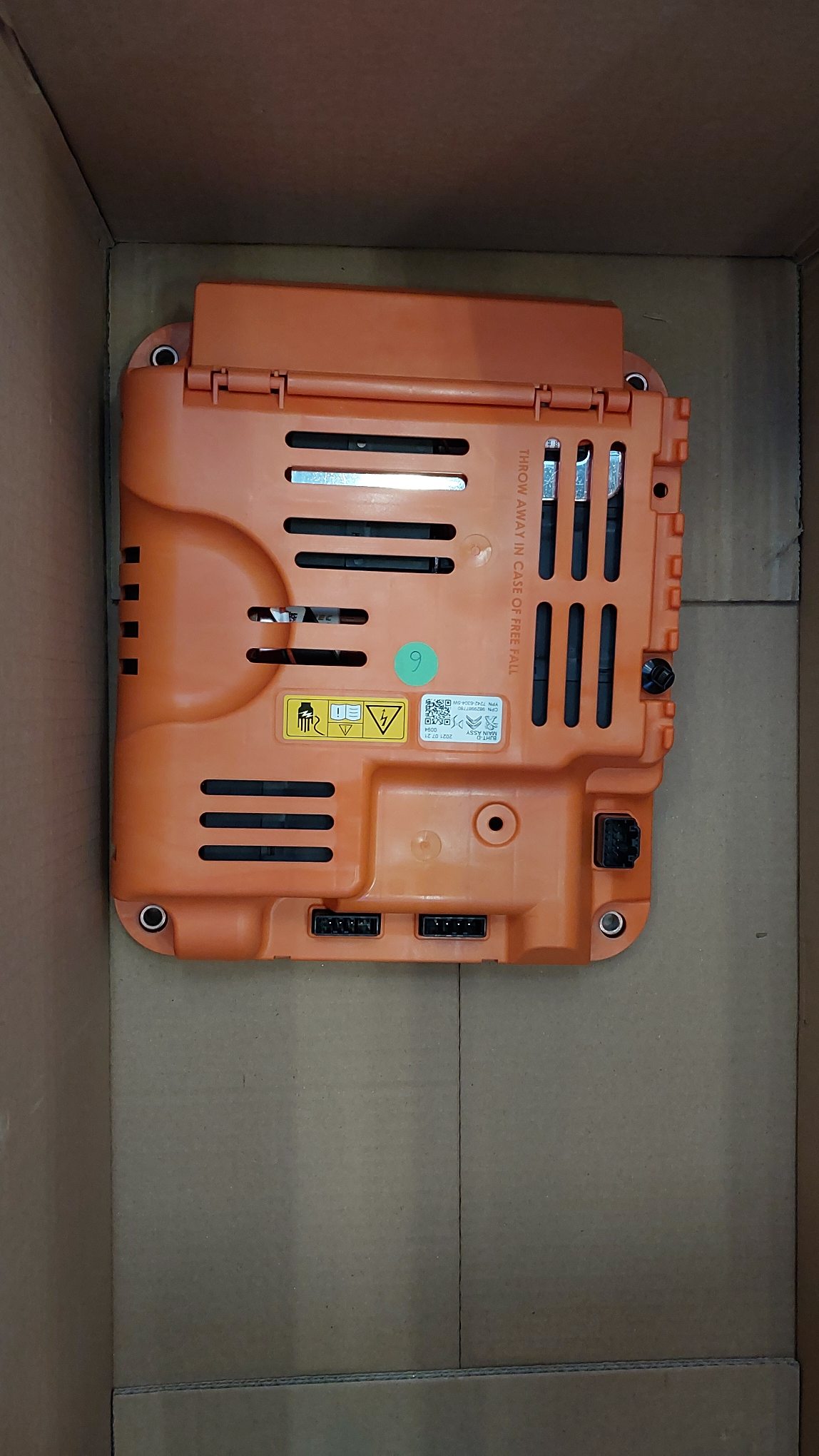

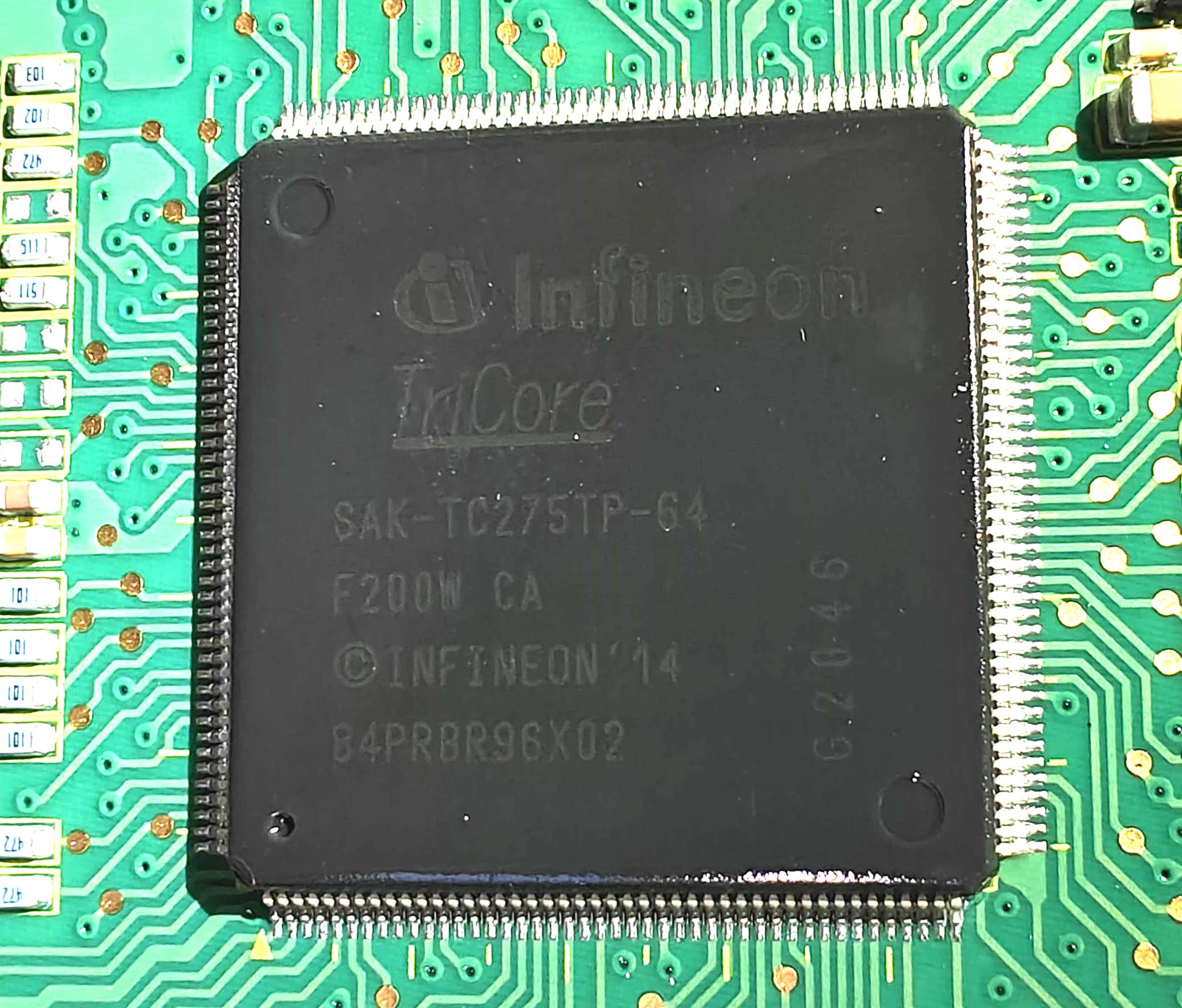

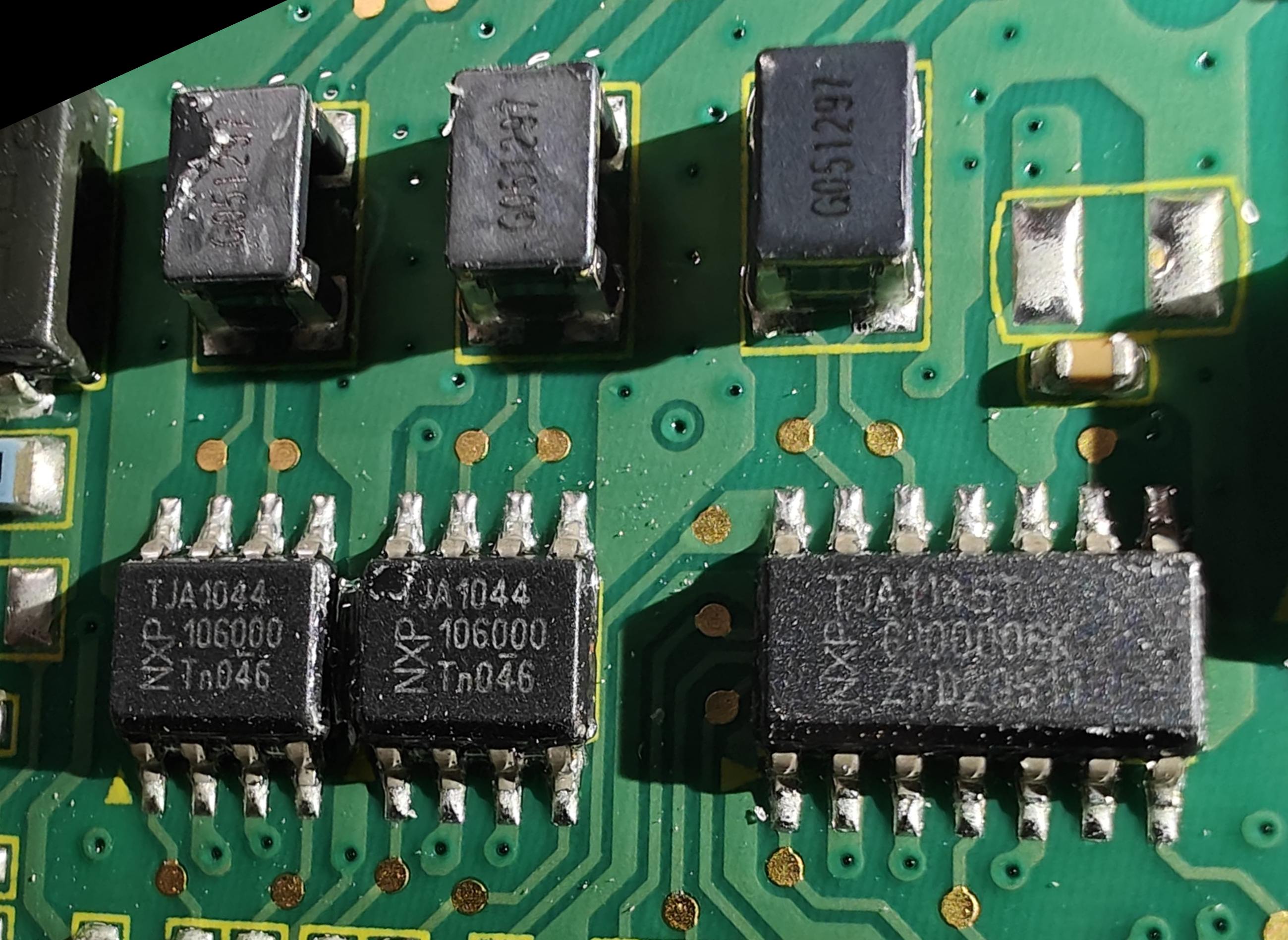

BMS master:

Those are are really good looking modules. All that lovely aluminum, hardly any plastic in sight.

asavage wrote: Sun Jan 21, 2024 9:16 pm Those are are really good looking modules. All that lovely aluminum, hardly any plastic in sight.
don't forget the integrated cooling ;)

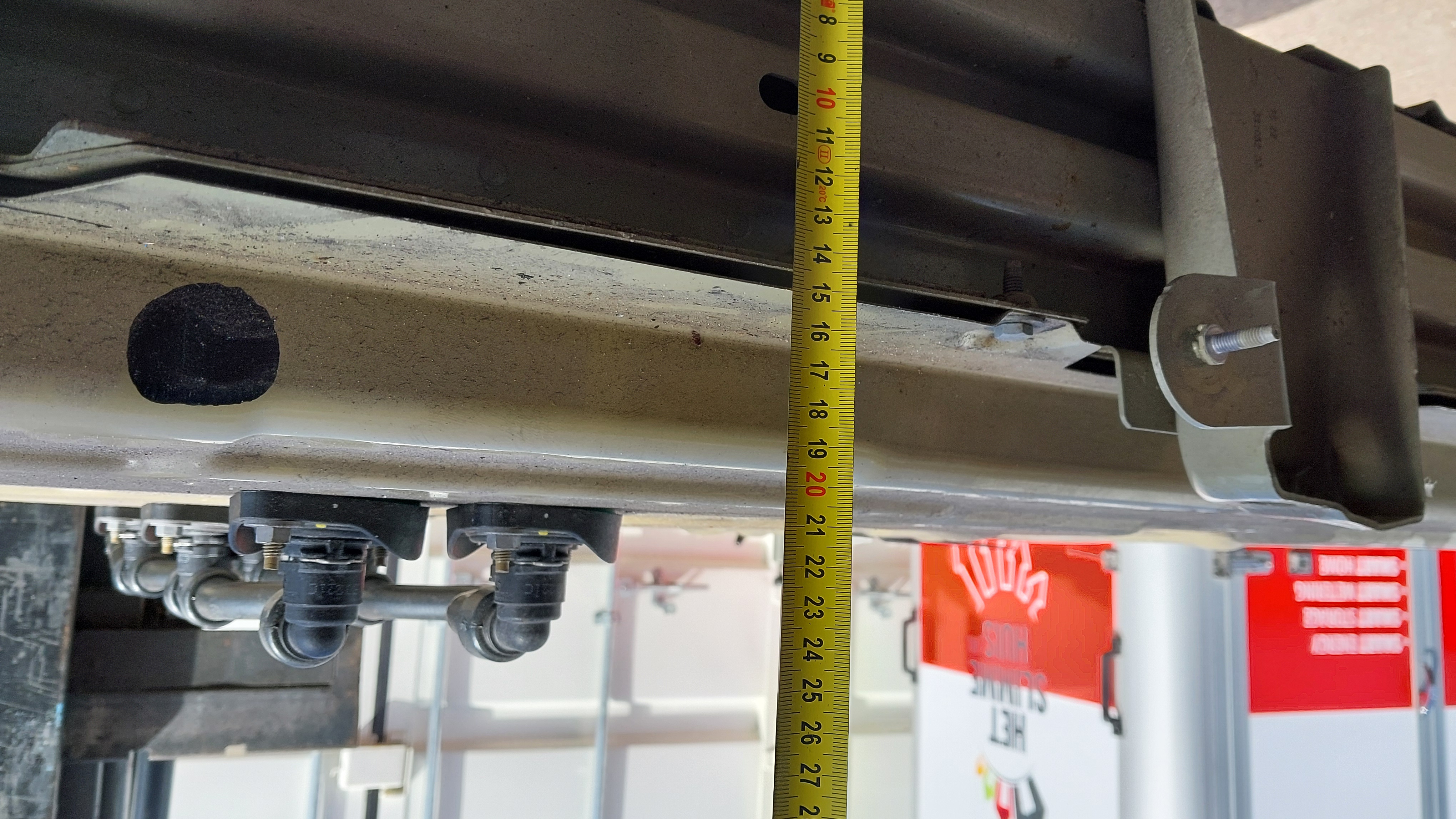

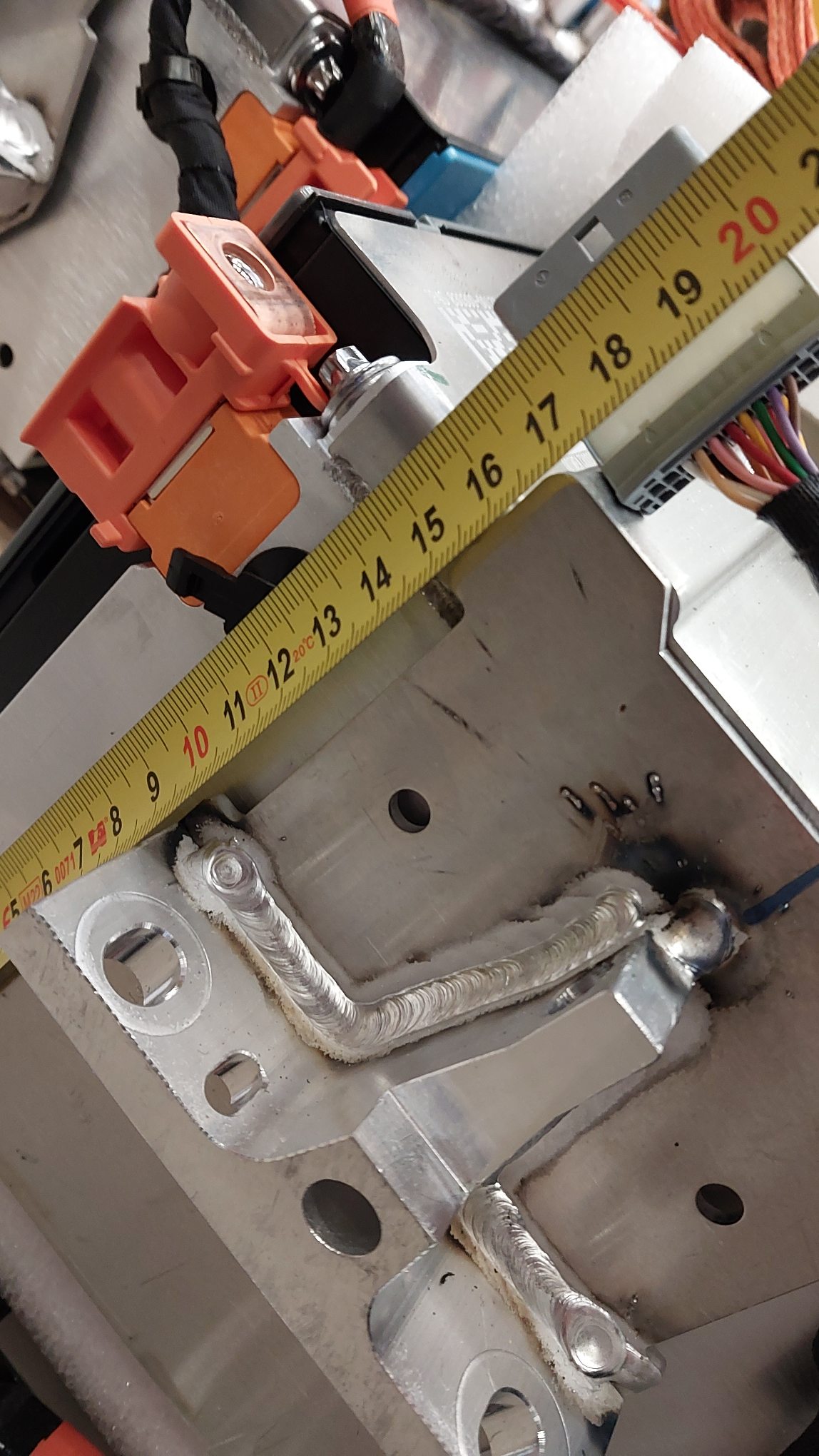

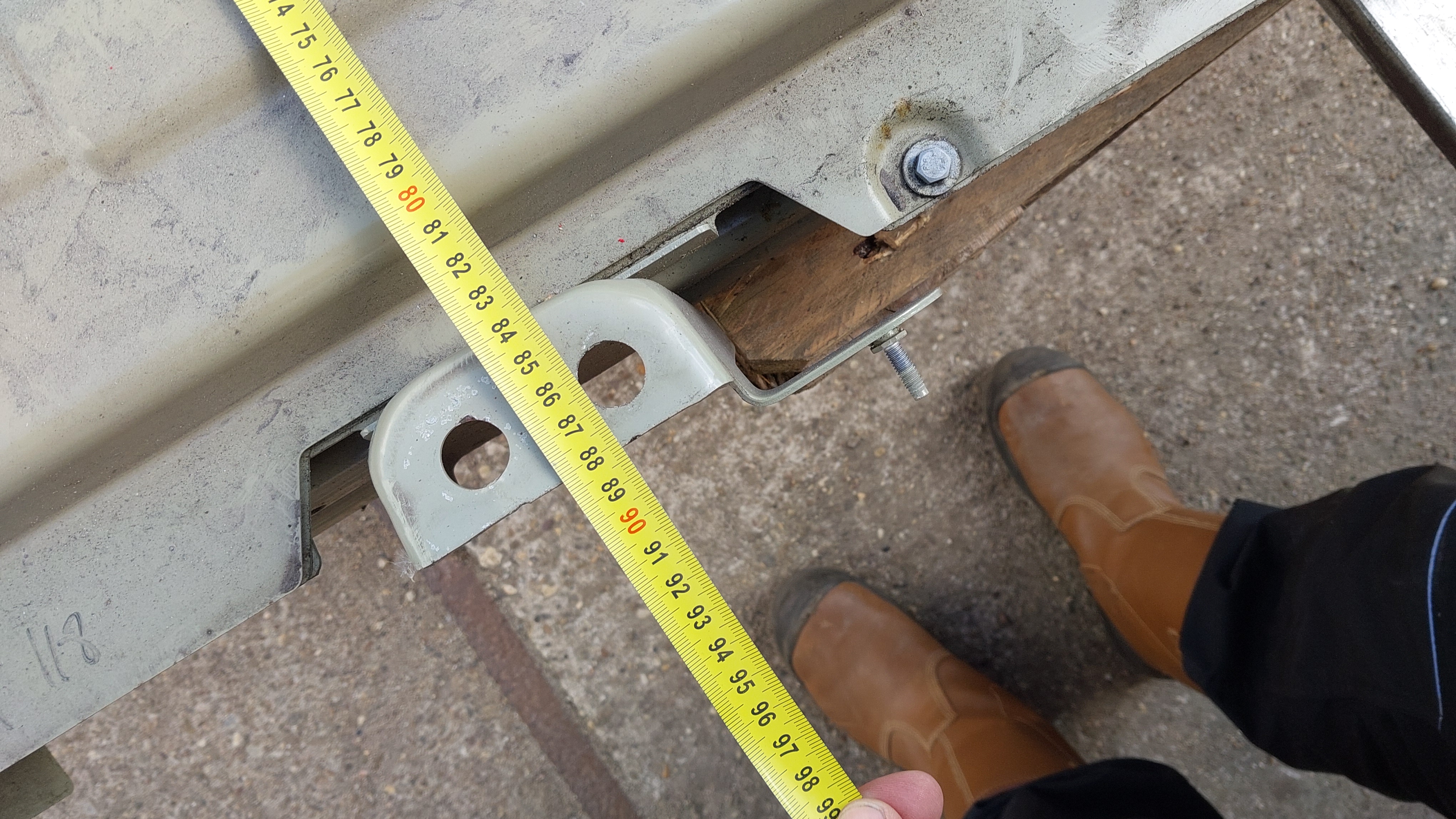

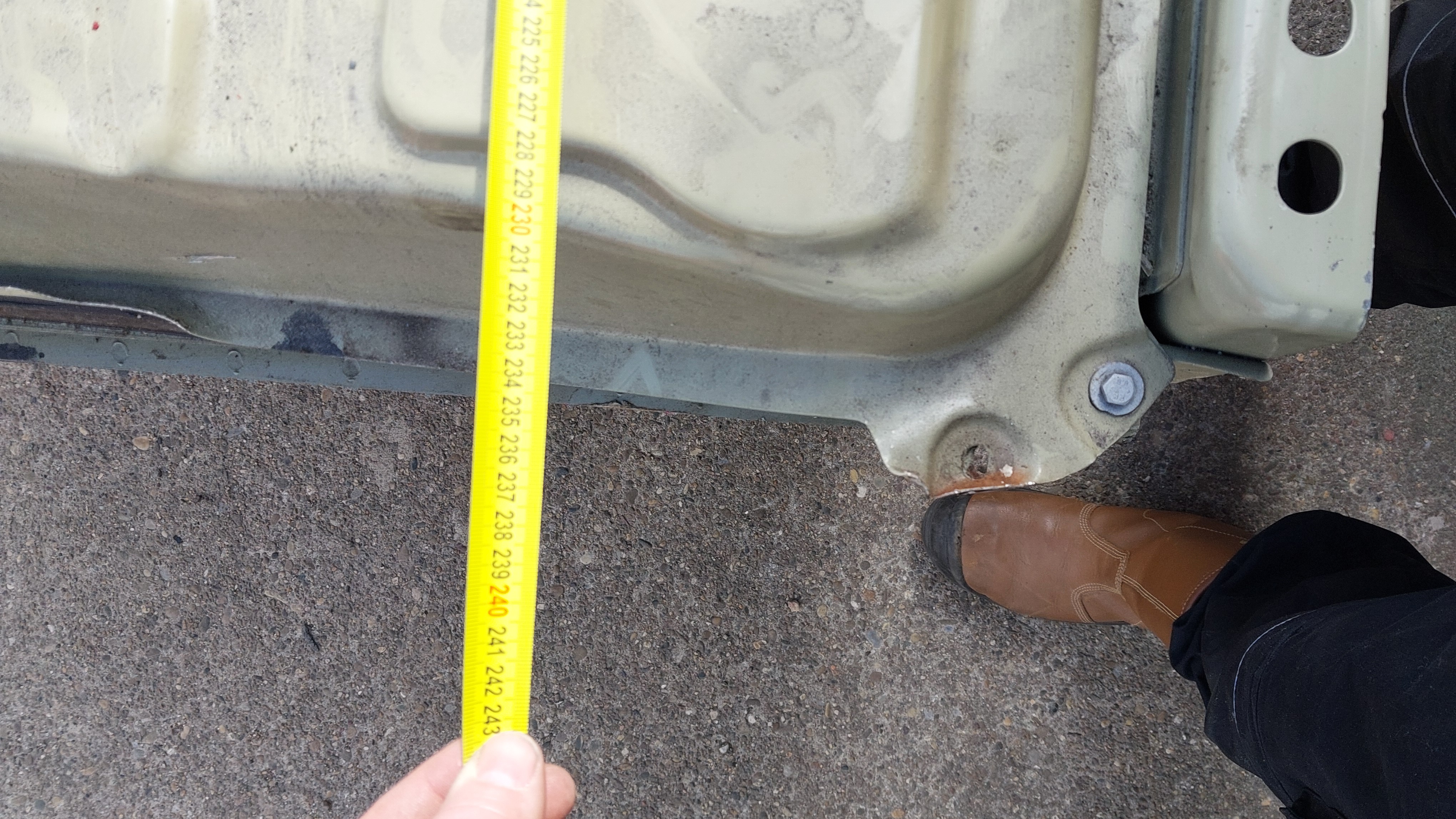

@Boekel; what are the dimensions of the complete battery pack?
boekel
Posts: 135
Been thanked: 24 times
Re: Opel Vivaro-E 75 kWh battery (PSA)
Post by boekel »
PaulHeystee wrote: Thu Apr 10, 2025 10:47 am @Boekel; what are the dimensions of the complete battery pack?

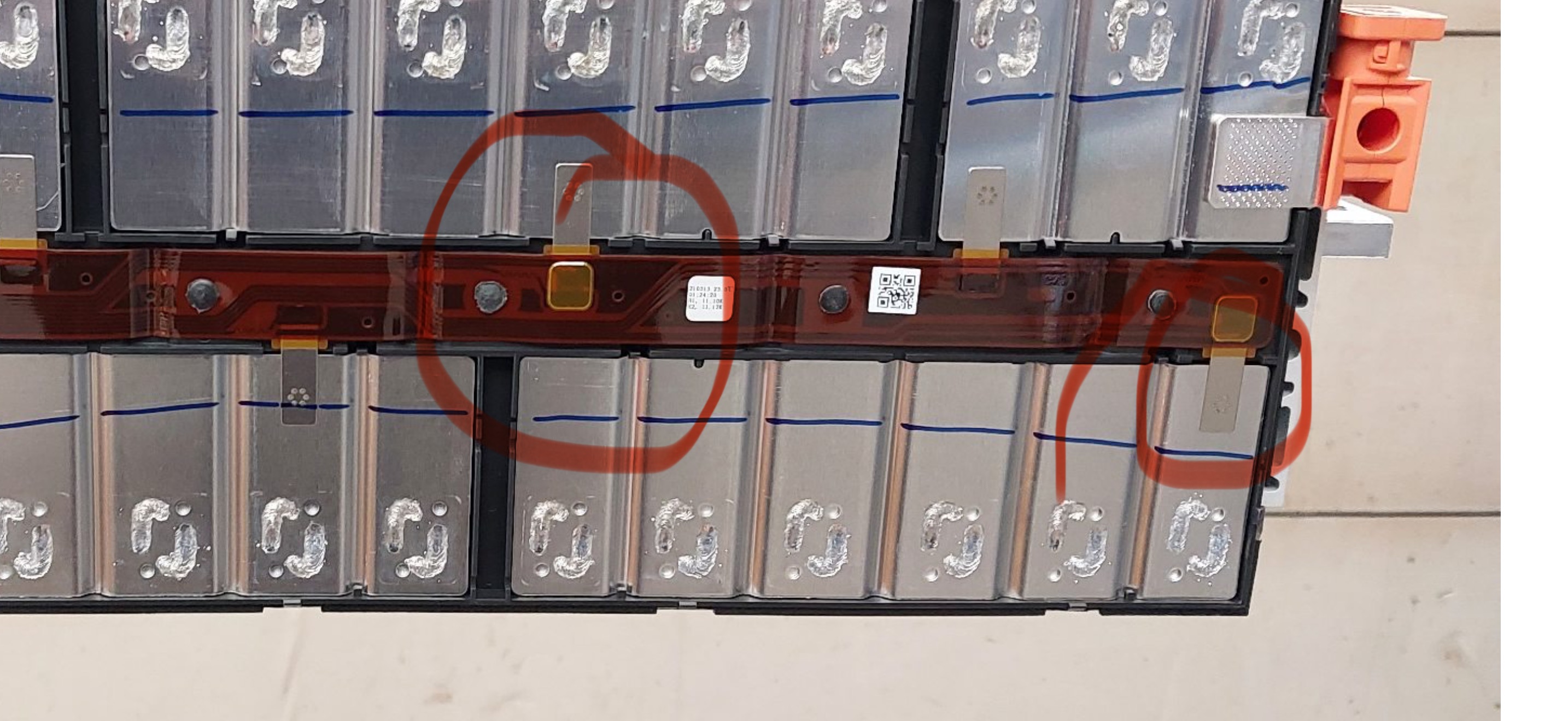

Do you know where the module temperate sensors are
Or a picture or one
I keep getting a traction error and live data shows sensor 52 erratic
Thank you

I don't know.

boekel wrote: Thu Apr 10, 2025 9:20 pmI don't know.
Think it maybe these just carnt see them close enough

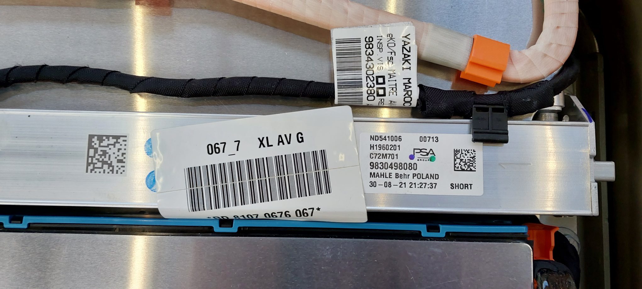

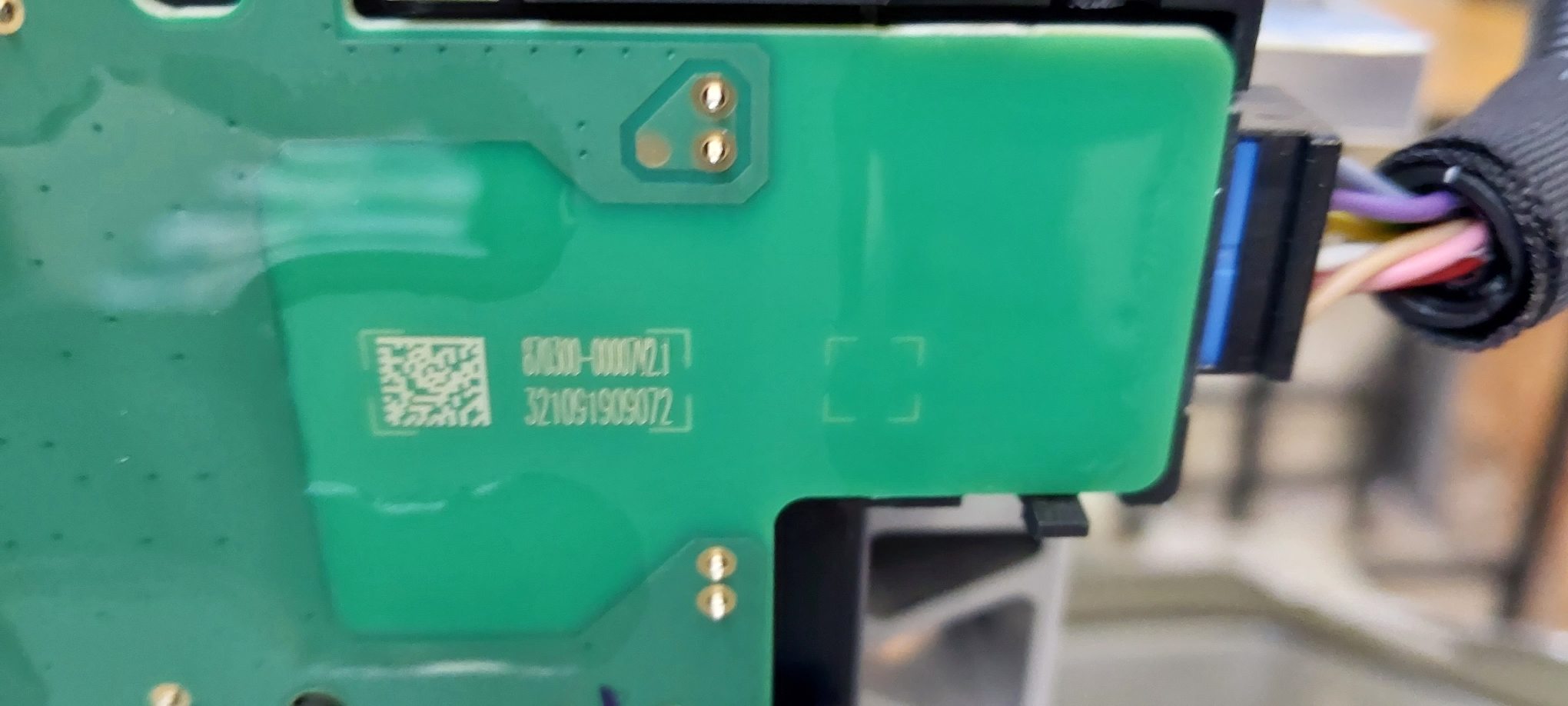

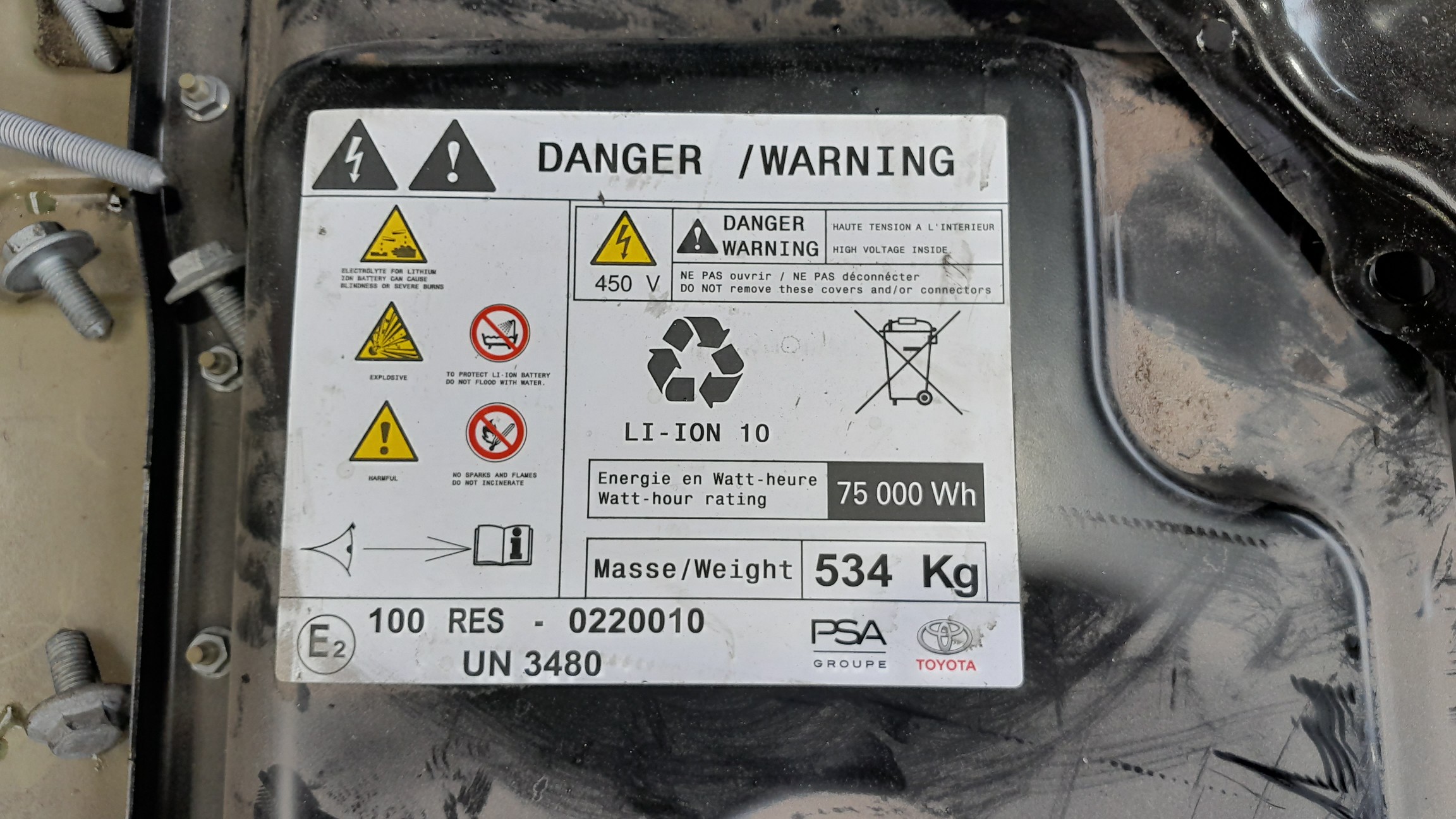

Do you know the part number for this battery
Or a pic of the sticker on the side in the casing please
