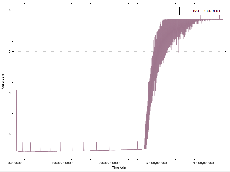

I think I found some sort of a bug...
During a long charging session, the charging power stops following the request intermittently, for a very long time and then at some point it starts following the request again. As this was a very long charging session, I was only able to catch the start of the issue and not the moment when it starts following the request again.
Here is the log file
20250209_Low_Charging.zip
(16.52 MiB) Downloaded 506 times

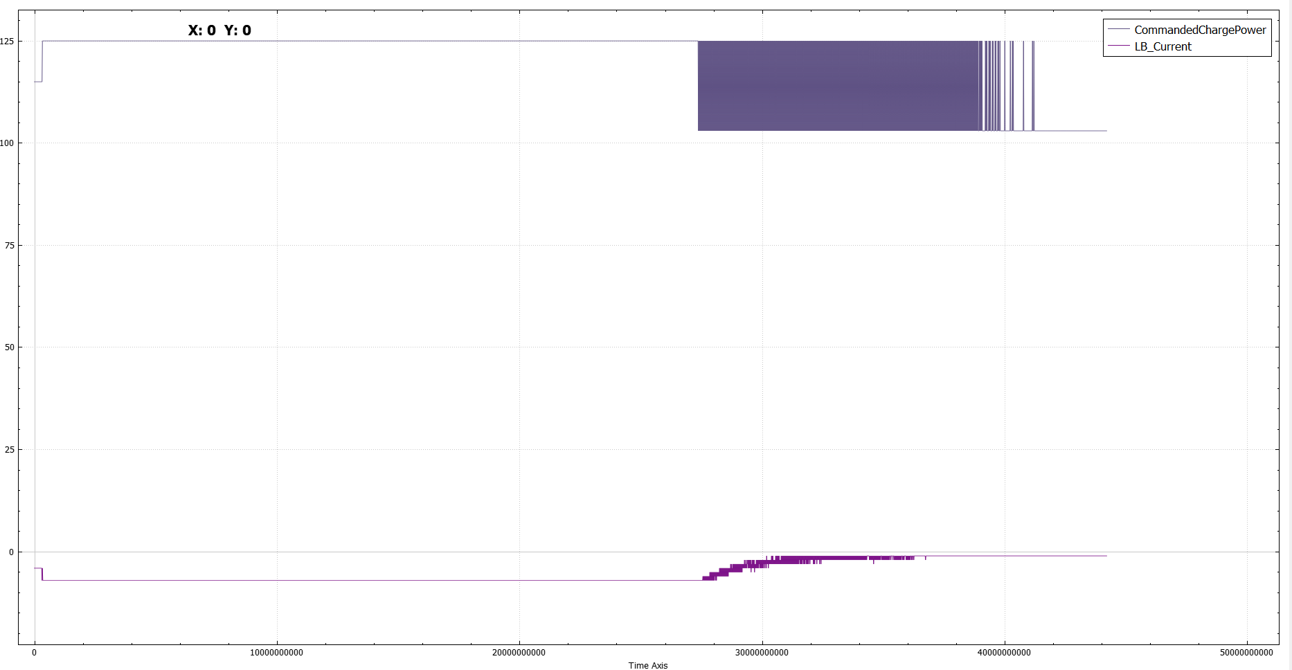

So it shows the drop in current when the commanded "charge power" in 0x1F2 changes. Which does not seem to corrolate as you would hope.
What were your params for the charge mainly your voltagespnt?
