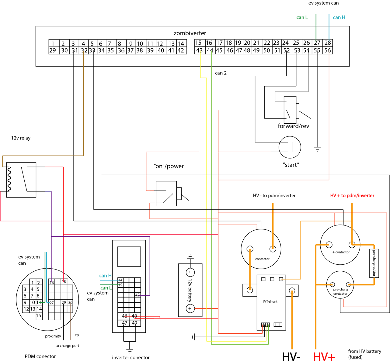

I have the Leaf drive unit working well and can read the Orion BMS but can't get the Zombiverter board to sense a Type 2 plug in the charge port.
The resistors are correct and I'm seeing the PPVal ADC counts change and have set the ppthresh between the no plug and plug in receptacle but opmode doesn't change.
Is there something I haven't set. What is required for opmode and chgtyp to register PPVal is below ppthresh?
Cell voltages are read correctly and between BMS_Vmin and Vmax but are these required to indicate the charge plug is inserted as the BMS is only powered when the ignition is turned on.
Does the BMS need to be running before the plug is inserted and when ign is on, does that stop the plug being sensed but tried it with BMS powered as well.
Can I assume the HV contactors close to allow charging to commence when the plug is detected.

Why is the charge port not fully connected to the PDM? The PDM will tell the Zombie via CAN that a plug is inserted and its ready to charge.
Have you wired the PDM with a permanent power and a switched ignition via the Zombie controlled relay?
Try setting charge interface to Chademo, there is a known bug that needs resolving when using PP detect.

As per the instructions, PP is connected to term 29 and CP term 30 of the PDM connector and in the Zombie notes, an analogue input is used to detect the plug using two resistors, one from PP to ground (4.7K) and a 330R from 12v to the Analogue input.
Are you saying this isn't required using the Leaf PDM?

So yes the chargeport is ONLY to the PDM.

What version of the PDM do you have?
Also what information have you used the wire up the PDM 12V supplies?
The parameter that the Nissan PDM should update is : PlugDet - Based on it seeing the right signals at the the port with plug inserted.
These two need to be set like this, So interface to none/unused and chargemodes needs to be nissan leaf pdm.

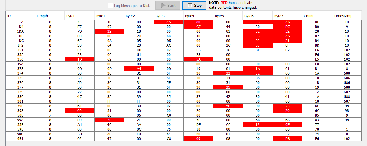

Re logging the CAN bus. I just looked at the bus using the Orion software.
Plug out frame 0x390 0 = 44 1 = 00 2 = 00 3 = 02 4 = 00 5 = 8C 6 = 00 7 = 0A
Plug in frame 0x390 0 = 44 1 = 00 2 = 00 3 = B2 4 = 00 5 = 84 6 = 00 7 = 2F
This was with the ignition on.
Okay so there is a difference between what I seen on other leaf logs.
Code from zombie, so it looks for this, which is different from your findings.
With zombie on does the PlugDet value change?
What socket have you wired up to your PDM?
PlugStat = bytes[5] & 0x0F;
if(PlugStat == 0x08) PPStat = true; //plug inserted
if(PlugStat == 0x00) PPStat = false; //plug not inserted

With Zombie on parameter PlugDet does not update with plug inserted.
I have a Type 2 socket
Possibly blown the PP sense by connecting 12v via the resistors to it!
Are you saying the Plug detect is on CAN ID 0x0F as I do not see this ID.
The only change is byte 5 on 0x790 when plug is in or out
I attach a screen grab of all CAN messages using Orion as they helpfully highlight data changes.

Plug detection and other charging related info comes from 0x390 from the PDM. Byte 5 first 4 bits are used to check if Plug detect is being sent.
Re: Zombiverter not switching to charge mode with Leaf PDM
No resistance in the socket PP to ground.
All grounds are heavy flexible cable to the 12v controls and the Leaf drive unit has a heavy copper braid.
Have now tried every combination of Ign off, Ign on, start keyed, power to PDM pin 16 and Inverter pin 42 with and without ign on or keyed.
No change just 0x390 byte 5 changing from 8C to 84 plug out/in but requires Ign on but not started as no 0x390 data if ign is off.
I noticed that the inverter runs without ign on relay supply to PDM 16 and Inv 42 pins.
It works with just the constant supply to PDM pin 18 and Inf 46, 48. Odd that as what is the relay power for otherwise?
- Posts: 2962
- Has thanked: 330 times
- Been thanked: 848 times
You are describing functionality that does not seem correct. There is something going on.
I have yet to see a log with 0x390 showing 0x8C or 0x84 as byte 5.
I am guessing there are mistakes in that wiring diagram. No idea where the info came from.

Maybe it is time to post some clear pictures of how you've connected things.
- Posts: 2962
Just had a dive and it seems the wiring diagrams are correct for the inverter stack with the square connectors. You must have done something weird along the way with wiring.
I checked the wiring and the constant supplies are on the correct pins and switched from the relay are also on the correct pins.
I had changed it slightly to try to reduce the constant drain on the battery as the constant supply to the inverter is around 500mA and PDM around 250mA.
These were connected to the ignition on switch but are now back on the 12v battery supply for now with a maintenance charger permanently connected.
Checked again and the inverter still runs under Zombie command without the 12v ignition on relay supply to terminal 42.
The PDM is sensing the plug inserted as the mA rises slightly on the PDM constant 12v and drops when removed but still no indication on PlugDet but PilotLim does flicker slightly and I assume that displays the amps limit detected when operating correctly.
- Posts: 2962
Not sure how as I have checked wire to pin on both the Inverter and PDM plug. With only two supply wires on the PDM plug and three plus two ground on the inverter its hard to get them wrong as the CAN wires must be correct.
