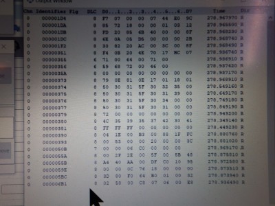

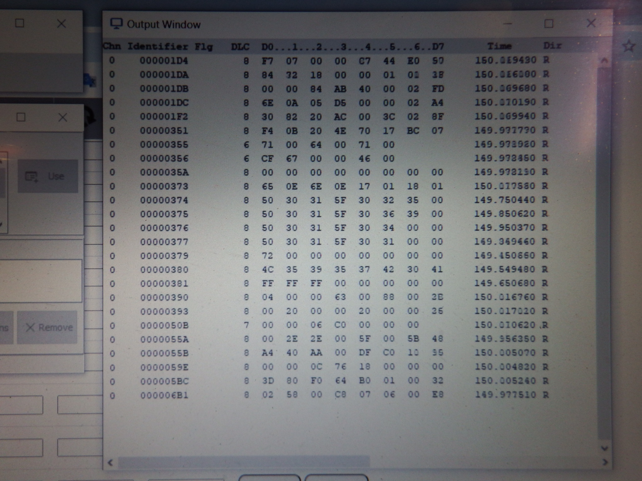

Attached are log files when the plug has been re-inserted after charging and doesn't re-start along with log files after the Zombie has been power cycled and charging initiates correctly.
My install has the ISA shunt so doesn't require the ignition relay to be enabled.
Also attached some stills of the messages with fixed positions which is sometimes easier to read than a log.
Plug in No charge.txt
(353.63 KiB) Downloaded 480 times
Plug in charging.txt
(459.83 KiB) Downloaded 438 times
Plugged in and charging after Zombi power cycle
Plugged in but not charging
Before plugging in
Before plugging in

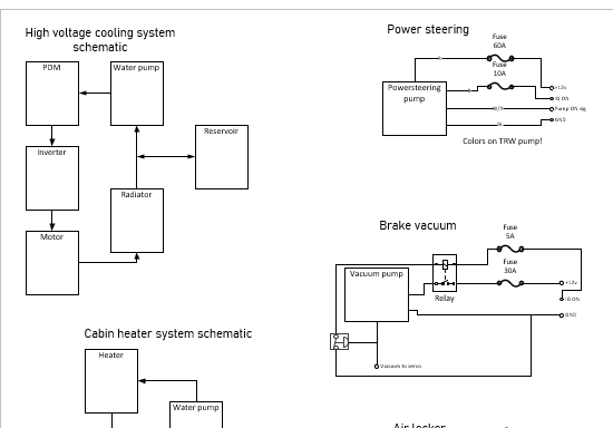

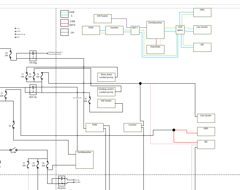

The way I have this powered up (should) be as it is on wiki with the exception that I have also Leaf battery on same CAN.
Once zombieverter cuts the Inverter on relay, a random value is left for example on inverter UDC, how this relates to starting up next time seems to matter as inverter wakes up at a different rate to the precharge sequence and I got a feeling that after charging for example, precharge fails as Inverter doesn't power up quick enough to update the garbage UDC value left in INVudc after charging. Or something like that.
I've been also drafting a schematic for myself and one idea was to share this once I get it "right" meaning all the indicators, relays, etc work as intended. Also started to do a system level diagram, but that is more unfinished than the full blown wiring diagram. Snips intentionally blurry as these may not be correct NOR represent the reality that I currently have wired up in my setup. For this reason they should not be used for any reference at this point in time :twisted:
To sum it up, I can't say that I have a problem free setup, but chasing the issues are something that is on my list.
Posts: 2962
Has thanked: 328 times
Been thanked: 847 times
Re: Leaf PDM with Zombie charge not restarting unless Zombie is power cycled
Yea logs would be needed for each issues, along with params and can logs.
Then I can dive into each situation and review the unexpected behaviours.
Nice diagram, once you are happy we can add it to the Wiki as a proven example wiring diagram.
