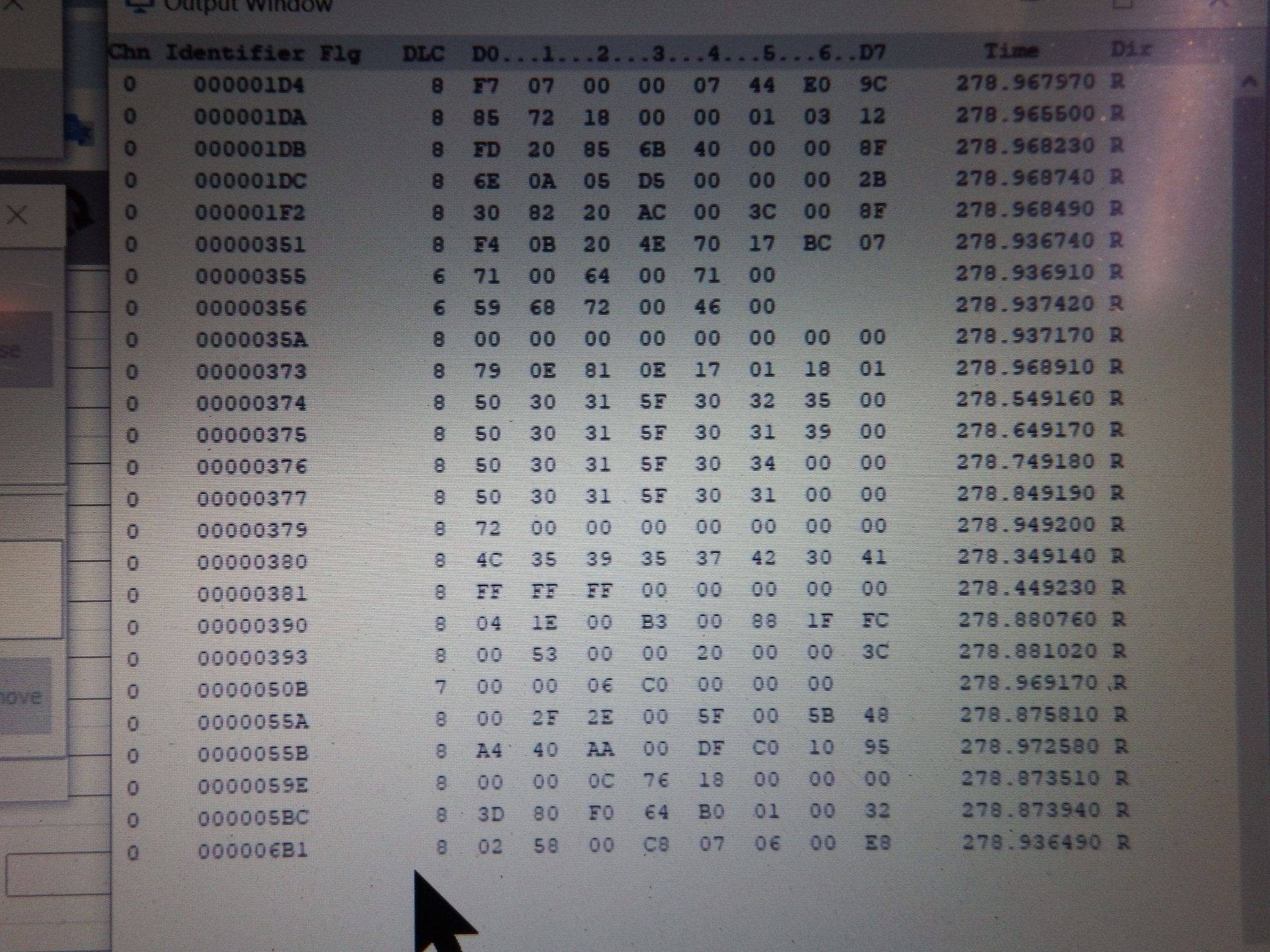

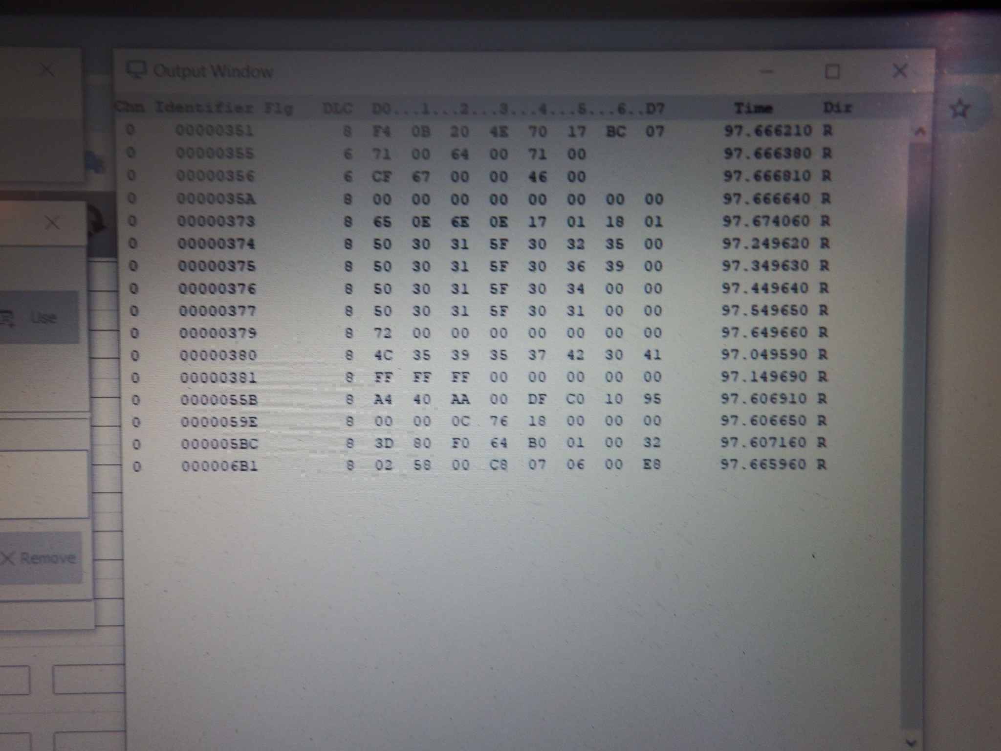

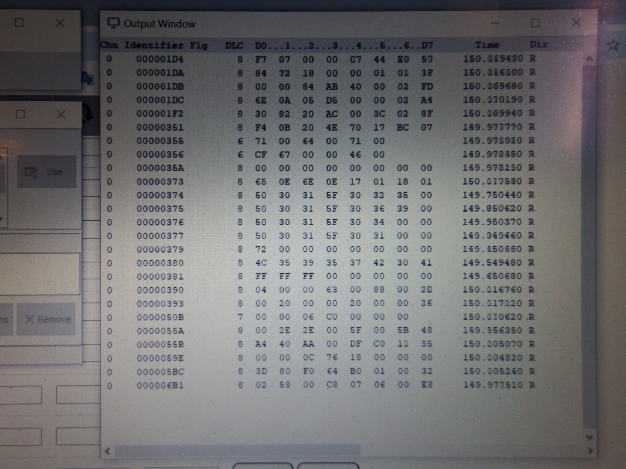

Attached are log files when the plug has been re-inserted after charging and doesn't re-start along with log files after the Zombie has been power cycled and charging initiates correctly.
My install has the ISA shunt so doesn't require the ignition relay to be enabled.
Also attached some stills of the messages with fixed positions which is sometimes easier to read than a log.

Plugged in and charging after Zombi power cycle
Plugged in but not charging
Before plugging in
Before plugging in

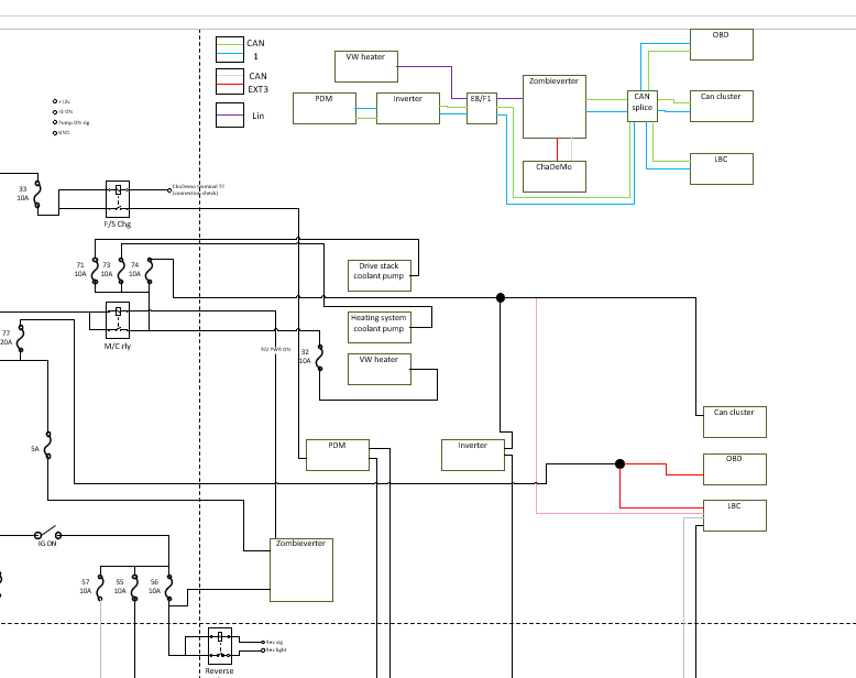

I don't understand.
The wiring diagram doesn't mention a HV active relay is required when using an ISA shunt and Leaf PDM.
Charging works correctly as long as the Zombie is power cycled after a charge has been initiated then stopped.
Posts: 2754
Location: Bristol
Has thanked: 264 times
Been thanked: 717 times
Re: Leaf PDM with Zombie charge not restarting unless Zombie is power cycled
Rustybkts wrote: Mon Jan 27, 2025 6:02 pm The wiring diagram doesn't mention a HV active relay is required when using an ISA shunt and Leaf PDM.
Is not matched to the latest release V2.20. You can now do Leaf Inverter and PDM without a shunt.
You need to switch power to the inverter and PDM, to put them to sleep properly.
However currently release does not do the CAN bus correctly, hence you needing to cycle the Zombie also to stop the CAN traffic fully.
Once the new release is done, I will assist someone in drawing up diagrams that match the firmware version.

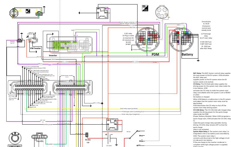

Posts: 1080
Has thanked: 222 times
Been thanked: 413 times
tom91 wrote: Mon Jan 27, 2025 6:13 pm Is not matched to the latest release V2.20. You can now do Leaf Inverter and PDM without a shunt.
https://openinverter.org/wiki/Leaf_stac ... ombiverter
Is this not correct?
I’m confused on which part needs changing/ updating

Posts: 2754
Location: Bristol
Bratitude wrote: Thu May 15, 2025 3:16 am Is this not correct?
At this point who knows, there have been so many people claiming there were issues. But they all have gone quiet and there are now a few examples of people using Nissan Leaf stacks who have stopped reporting issues.

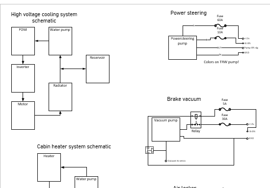

I've been also drafting a schematic for myself and one idea was to share this once I get it "right" meaning all the indicators, relays, etc work as intended. Also started to do a system level diagram, but that is more unfinished than the full blown wiring diagram. Snips intentionally blurry as these may not be correct NOR represent the reality that I currently have wired up in my setup. For this reason they should not be used for any reference at this point in time :twisted:
To sum it up, I can't say that I have a problem free setup, but chasing the issues are something that is on my list.
Posts: 2754
Location: Bristol
Yea logs would be needed for each issues, along with params and can logs.
Then I can dive into each situation and review the unexpected behaviours.
Nice diagram, once you are happy we can add it to the Wiki as a proven example wiring diagram.
