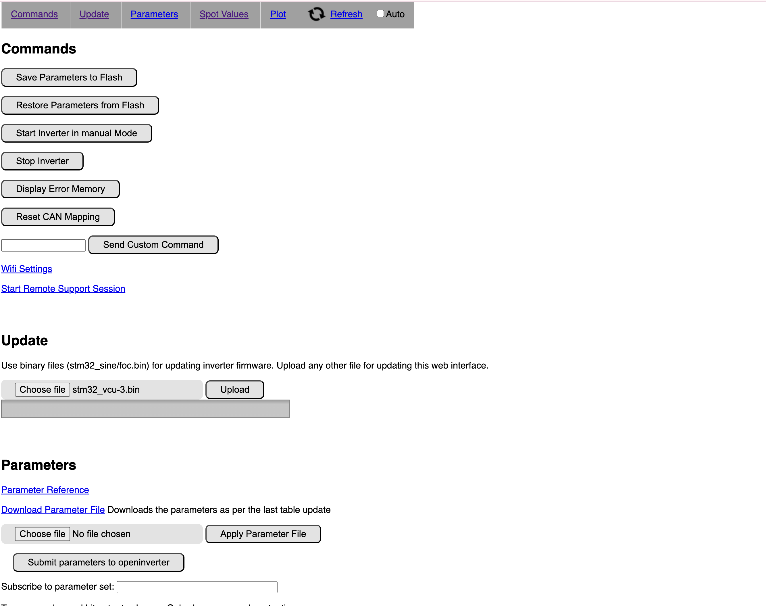

Hello,
I am running a really old version of the ESP8266 web UI (see screenshot attached). When updating my Zombieverter from 2.17 to 2.20 I am losing all spot values, so I thought updating the ESP8266 UI might help.
I went to the GitHub README for instructions (see https://github.com/jsphuebner/esp8266-web-interface) and it says that I can use pre compiled software from the openinverter forum (see https://github.com/jsphuebner/esp8266-w ... e#firmware), but, when I searched here, I cannot find any stickies or posts that host binaries.
Does anybody have a recent working build they would be willing to share with me? It will save me having to set up Arduino etc etc.

Re: ESP8266 Binaries
For what it's worth, the parameters section renders on ZombieVerter v 2.17, but does not render on ZombieVerter 2.20 on my (old) web interface.
Could it be that the update simply didn't go through? Can you try again? I loaded 2.20 while using this old web interface and it worked fine.Scrappyjoe wrote: ↑Mon Jan 27, 2025 3:06 pm For what it's worth, the parameters section renders on ZombieVerter v 2.17, but does not render on ZombieVerter 2.20 on my (old) web interface.
I don't know of any prebuilt binaries, so I guess that dead end should be deleted from the readme.
Easiest way to upgrade is to install platform IO, which takes care of compiling and flashing.
As marty says, the old web interface should run just fine with recent stm32 firmwares, that must be caused by a failed upgrade or something
Thanks marty, that’s good to know. I downgraded and upgraded several times to avail, but I am also using quite an old 12v battery so I’ll switch to a bench power supply and see if that helps.
