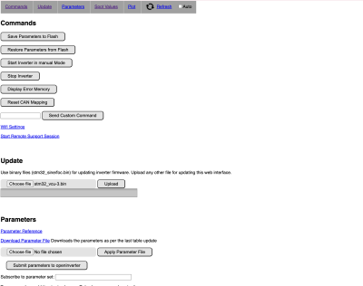

Hello,
I am running a really old version of the ESP8266 web UI (see screenshot attached). When updating my Zombieverter from 2.17 to 2.20 I am losing all spot values, so I thought updating the ESP8266 UI might help.
I went to the GitHub README for instructions (see https://github.com/jsphuebner/esp8266-web-interface) and it says that I can use pre compiled software from the openinverter forum (see https://github.com/jsphuebner/esp8266-w ... e#firmware), but, when I searched here, I cannot find any stickies or posts that host binaries.
Does anybody have a recent working build they would be willing to share with me? It will save me having to set up Arduino etc etc.

For what it's worth, the parameters section renders on ZombieVerter v 2.17, but does not render on ZombieVerter 2.20 on my (old) web interface.

Could it be that the update simply didn't go through? Can you try again? I loaded 2.20 while using this old web interface and it worked fine.Scrappyjoe wrote: ↑Mon Jan 27, 2025 3:06 pm For what it's worth, the parameters section renders on ZombieVerter v 2.17, but does not render on ZombieVerter 2.20 on my (old) web interface.

Thanks marty, that’s good to know. I downgraded and upgraded several times to avail, but I am also using quite an old 12v battery so I’ll switch to a bench power supply and see if that helps.

Upgraded while on bench power, problem persists. Looking at developer tools in chrome it's all 200 codes except for a 404 for subscription.js, but I think that was there before anyway. I can't tell if the problem is with the web ui or with the underlying zombie. I'll try upgrade the UI first, just to eliminate it.

Just to update on this. I dropped down to Zombie version 2.17 and managed to progress to the point where my pedal, ignition and start switches and recharge sequence are all working. I am struggling to get the inverter to come up, so I thought I'd attempt to upgrade once again to 2.20.
Same problem, no spot parameters showing.
BUT BUT BUT I still had my gauges (http://192.168.4.1/gauges.html) window open. And those work fine. They respond to me turning the ignition on etc.
What I mean is, on 2.20, the wifi module is clearly communicating with the zombie because I can see my voltages etc on the gauges, it's just the parameters and spot values that don't seem to load.

Hmm, what comes up when you call http://192.168.4.1/cmd?cmd=json ?

Ok, I have managed to update my web interface. Managed it mere seconds before I got pulled away for kids bedtime, so will have to post my solution later.
