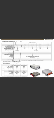

I am building a unique project, hoping someone could please help. I am building a STOL drag airplane
First type to be electric.
I acquired a duel axial motor setup .2 MAGELEC PROPULSION M24P4-D-19 AXIAL FLUX With matching motor controller's, I don't have a compatible vcu. I was hoping someone could help me get these motors operational. Any help would deeply be appreciated. Thanks William

If you compare the speed, drag and weight i think your selection of airframe is about on par with the power requirements for cruise, albeit at slower speed with more drag.
If i understood from the photo your choice of airframe is Zenair 701? Or are you planning on using Wittman Buttercup?
Do you have an idea about the battery?
I see the motor data shows 90kW cont. is that for the pair or individual motors?
Do you have a CAN bus control document for those inverters?

Could you send me the photo of product plates of inverters so i can get the type and P/N? I can search for the protocol from my end.
Meanwhile as a product owner you can try and contact the company and tell them you are designing your integration and you require CAN protocol to drive their inverter. If you have to buy that document from them as proprietary... so be it.

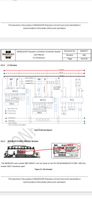

I purchased the motors for the advertised specs.
They are actually rated at 200kw apiece at 600volts.
I have all the data, including CAN protocol.
You will not find any outside support. I contacted manufacturer and supplier directly, they will not provide any information or support. We are kind of on your own. I would be willing to help.
I am not using the inverters purchased. Because at the time I couldn't find CAN data and wanted to proceed with my project. So if you do purchased motors, I would be willing to sell inverters at a discount price and provide all CAN data.

Hi, what would be the cost of your inverters and do you supply the schematic diagram with them.Aerobat wrote: ↑Sun May 05, 2024 7:26 pm I purchased the motors for the advertised specs.
Re: Vcu help
I would take $1,000.00 for two inverters and provide wiring schematics and all necessary CAN data. You pay shipping, the inverters are in original factory packaging.

Howdy, hope it's not too late, I can get you pinouts and CAN protocol if you want. Only issue I'm having is that the inverter has two sets of CAN wires, one labeled Vehicle CAN, and one labeled Debugging CAN. The Vehicle CAN doesn't give a nice looking signal over an oscilloscope but the Debugging CAN does. However, I only have CAN protocol for the vehicle CAN, not for debugging. So I'm a little lost on getting it setup.
