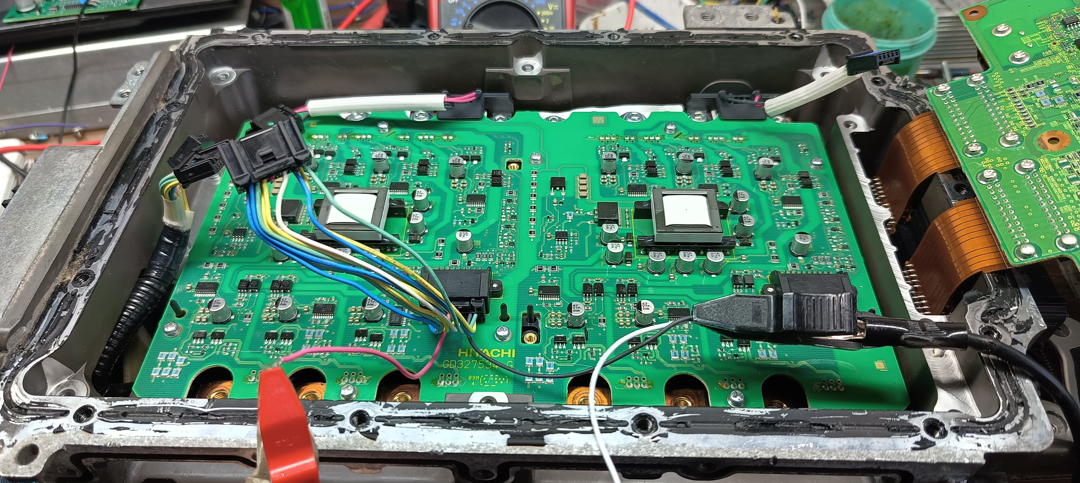

It has been some time and i was developing a controler for both power stages of Ampera/Volt inverter.
Both sides are used to get 1000Arms to the motor.
25mm2 cables can be used out of the current sensors and when they come together Leaf motor uses 50mm2 phase cables. Perfect!
Brain is Johannes controler. It works with resolver interface to sense rotor position. Speeds up to 10000rpm are achievable.
Out of experience i use inverter chip SN74LS06 that inverts positive signals from Olimex STM32 chip and makes them active low.
This chip requires 10K pulldown resistors on each input pin. Otherwise all inputs could be turned on together due to initial Olimex pulse at reset. Version 3.1 has this built in and field test shows it is ok to use.
I also designed a control for third power stage that would be driving aux oil pump inside Ampera transmission. Now it will drive AC compressor for my car. I use Lebowski drive since it can run PM mpotors sensorless. I have one Prius gen2 ACcompressor incoming and will open new thread about this.
For first run i used single side, but later i intend to couple them both. It could easily work from either side. The only caveat is you have to adjust current sensor inline resistors. 3K3 for single control and 6K8 for dual control.
Since i was sucessful in running various motors with this PCB iteration i am publishing it in Design spark format. Some files on connectors and chips also. https://github.com/arber333/Johannes...UAL-IGBT-board

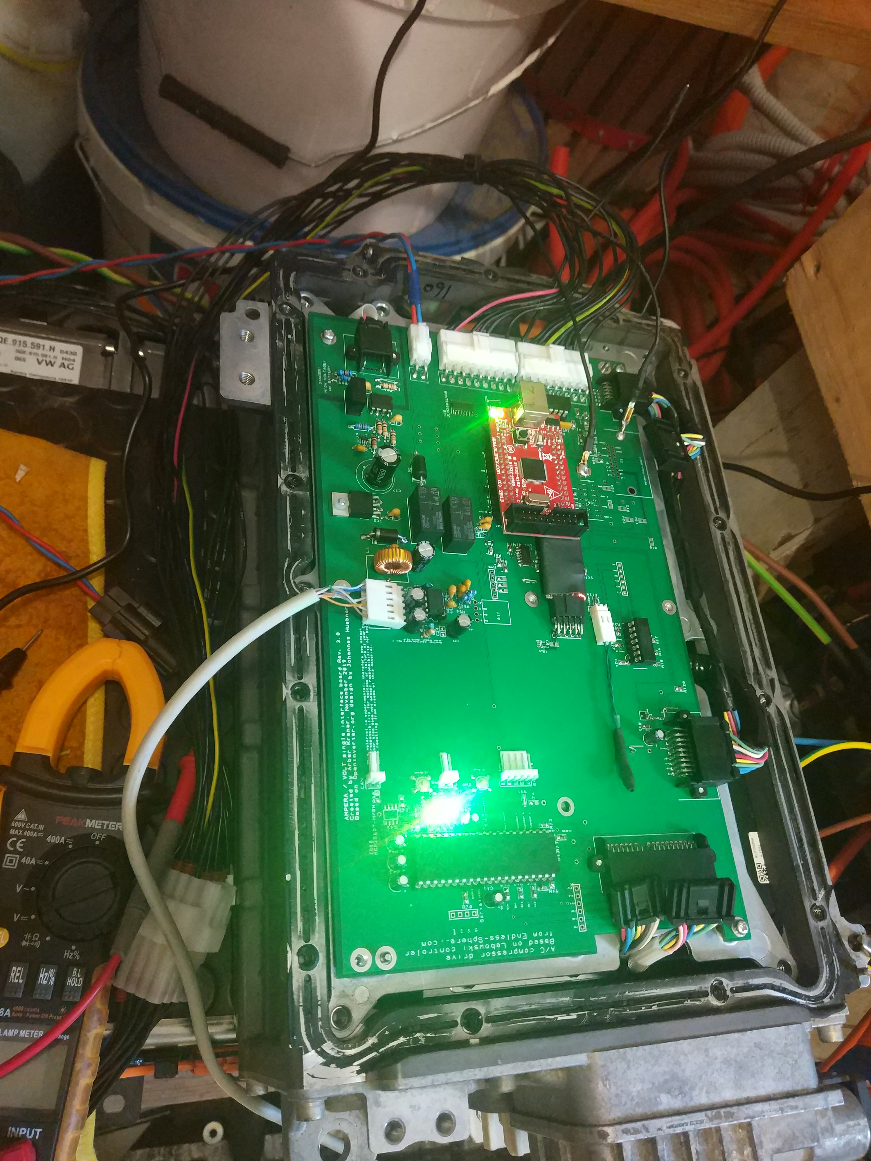

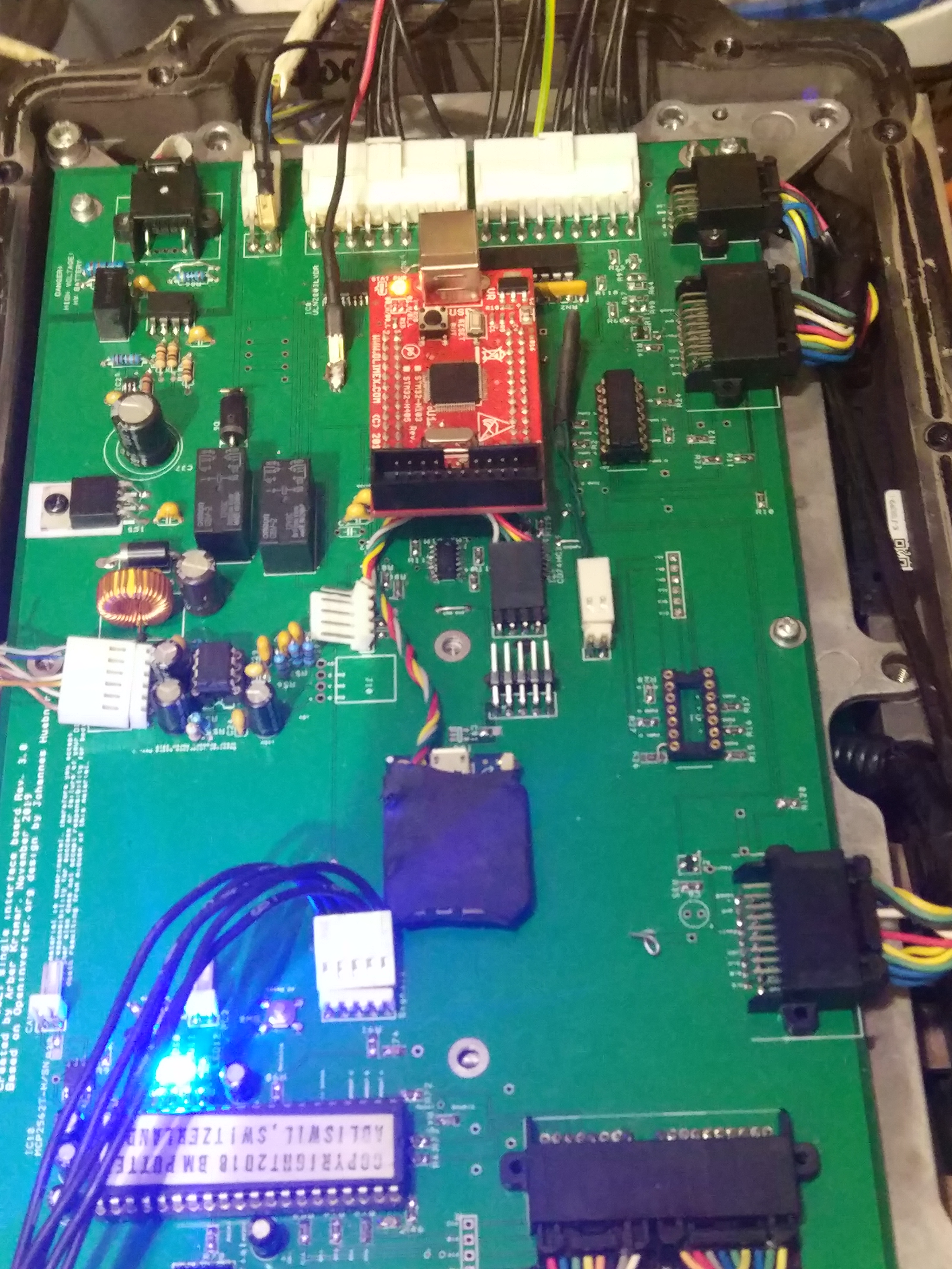

Re: VOLT/AMPERA inverter single controler dual IGBT drive
This is how it looks with right side populated...
And this one has left side populated...
Next is boths sides!Re: VOLT/AMPERA inverter single controler dual IGBT drive

However i have a set of several new revision 2.3 interface boards here that include resolver interface. I didnt publish it yet because it is not tested.
Board is a little larger and it incorporates both connectors which are used for driver and sensor board on Rev2 controler. That way you dont need to split cables or anything with sensor board. I recommend this board if you decide to go Volt inverter route.
Additionally i included the inverter chip connected to BOTH driver connectors sou you can drive both IGBT bridges if you want to experiment.
Personally i think it would be awsome to test dual sides with ACIM, since you are not burdoned with FOC code requirements. You can set the OClimit low and observe how the current avaraging goes...
I updated my Github now to include the new files...
https://github.com/arber333/Ampera-inve ... -interface
Another way to go forward would be to use one of my new boards that are tested and proven to work. They still run on Olimex chip and are for troubleshooting purposes the same as Rev2 boards. I show them in the beginning of this thread.
Also they are on my Github
https://github.com/arber333/Johannes-co ... IGBT-board
You can still PM me if you want me to send one board to you.
