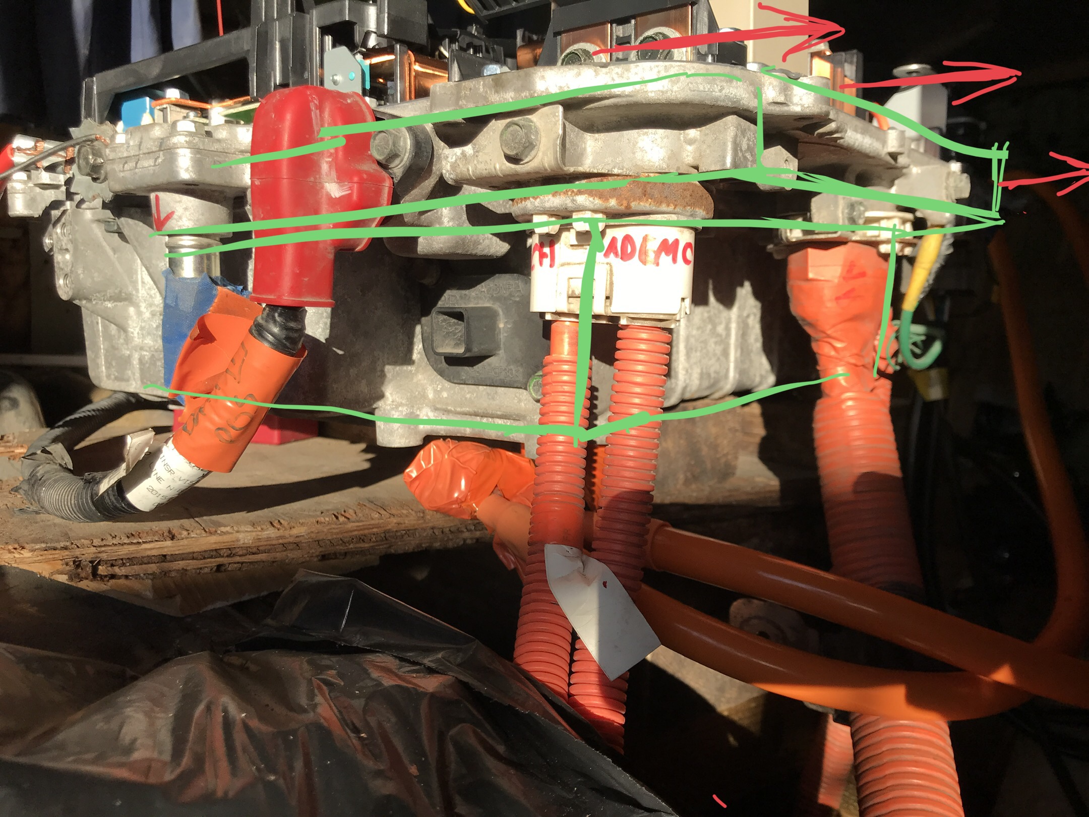

I’ve been thinking…
I think I need to revisit my Plan A for placing the PDM on the petrol tank shelf. I reckon it will work. The problem is not the PDM shape or available space, it’s that the HV cables are all routed downwards from the overhanging section. It is not the PDM itself that stops it fitting, it’s the cables.
If the cables came out horizontally from the upper half of the PDM, where the cables connect to the internal copper bus bars, there would be no problem (I think). The upside L shape of the PDM should slot over the shape of the inverter if the cables weren’t there. I kind of knew all this, but my brain has been slow to process what is obvious.
If I was to create my own lid (which would also probably save me a bit of vertical height which would be useful), I could add in my own connection points or exit points (to be defined in detail). Or even if I cut holes in the original lid, I could achieve the same.
The benefits
- I’m back to a central position, which pleases me aesthetically.
- I can use existing bolt holes around the petrol tank space for a mounting frame, which will please the DVLA.
- I avoid the various other thoughts I’ve had for mounting in many other sub-optimal places.
I’d have to route cables for Chademo, main HV battery, AC charge, and HV battery comms with my new approach.
A little thought needed on the water cooling routing, but think it will be ok.
If anyone think this is a horrendous idea let me know. But I like it and have a good feeling about it.
I don’t intend to pull the Leaf motor out just to test this right now. I’ll probably wait until I’m ready to do my blue van. That way I can continue to impress visitors with wheel spins on my driveway in the disaster-bus. This is very important.
Romale
Posts: 550
Location: Romania
Has thanked: 346 times
Been thanked: 101 times
Re: [WIP] Leaf to VW Type 2 Campervan
Post by Romale »
why are you subjugating yourself with this huge, clumsy PDM?
take a small compact dc/dc from the pdm leaf gen1, and anything else as a charger. you can use a Tesla 3, you can use an outlander, or you can simply charge the battery through a power inverter in conjunction with the motor, if it is controlled by a replacement johu board v3, you will save a lot of space and simplify your work very much.
evil neodymium :twisted:
As Roman said, if the pdm dosnt fit, don’t bother. It’s an ugly u it to implement in any other fashion than stock.
The outlander OBC is an excellent alternative. It’s a simple box with a charger and dcdc. Runs from the zombie as is. Small and would mount in the engine bay no problem, likely would fit on top of the inverter. A price of L channel aluminum is all you need to bolt it on top.
This is what I have running in my Datsun.
The pdm s are worth a lot because the fast charge contactors often blow in the leafs, so they are sought after for repairs. You’ll be able to get a good chunk of change back for it.
