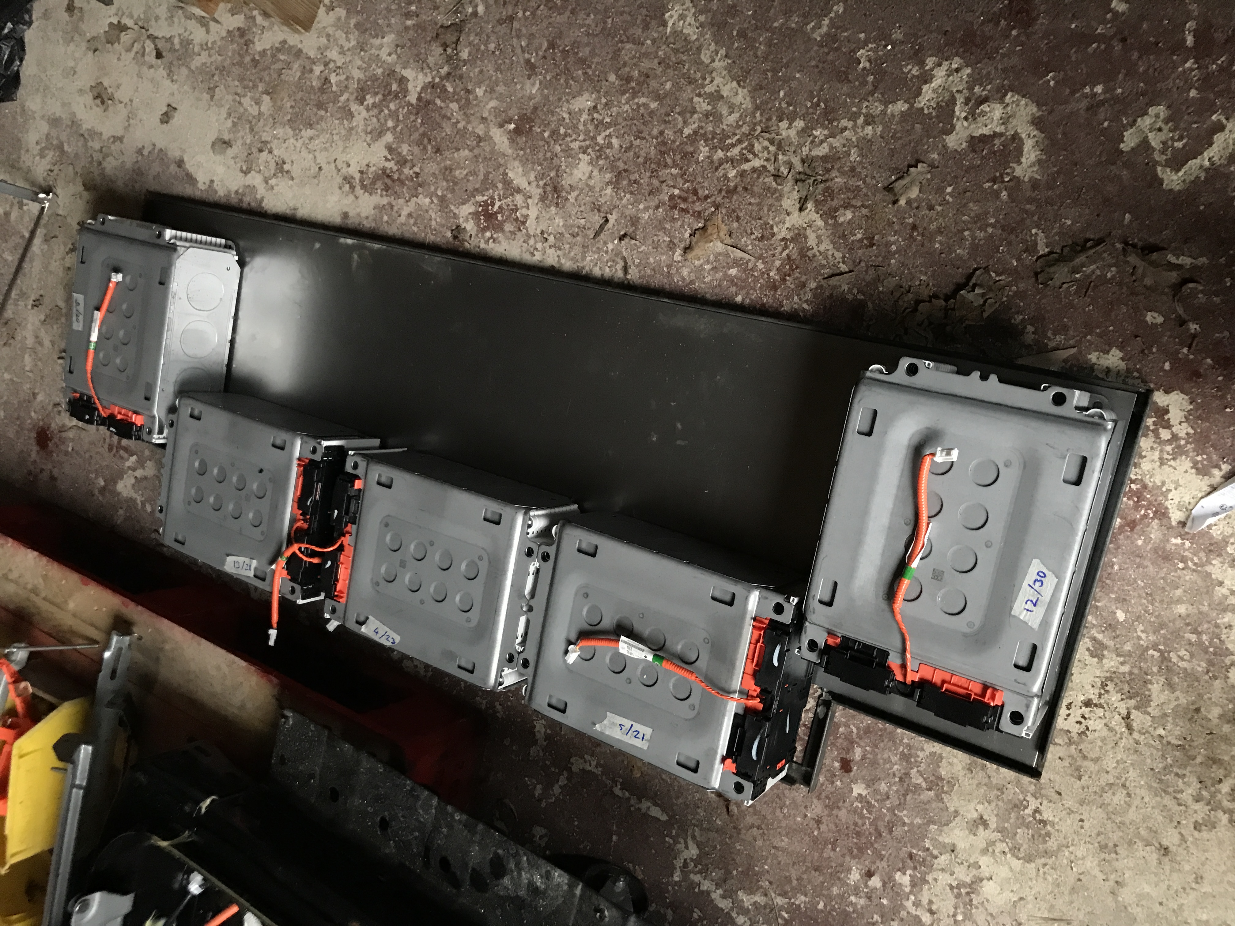

I’ve started a thread in the Nissan section to cover the 60kWh battery I’m dissecting for this project.
Will show photos, dimensions, weights plus a handful of other useful links I’ve found around the internet.

I now know the modules, not including bus bars and other odds and ends will weigh (edit, cocked up number I showed here before) 335kg. I will need to add the box to that, so rounding up to 400 kg for now.
VW T2 has payload of 800kg, so not a problem.

So exploring my batt box Plan B further, I would be keen to place 3 of the short modules vertically, sat on their rear end, as shown.
Does anyone know of any reason why this should not be done?

why not just start with a simple box.. just 2 rows of modules. reuse the stock busbars and what not. simple steel frame. make it a bench seat for now and then tackle everything else. getting to lost in trying to stuff modules in weird places , multiple boxes with a master bms is a recipe for disaster.
KISS for now. you shouldnt have to modify the bms leads, or anything.

Got ‘it’ going in October already, if the trial diasaster-bus counts - go back a page
That was the point of that beta version. So this is the proper job version. Motivation isn’t the issue, just the odd knowledge gap.
But appreciate yours, and Bratitude’s advice. Im always willing to bend ideas or chuck out and improve, but I really intend to get this constructed well enough to pass dvla, and although other things could change, I don’t want to muck about with refactoring batteries and the bus interior once I’ve firmed up the plan.
Plan B is progressing…!
