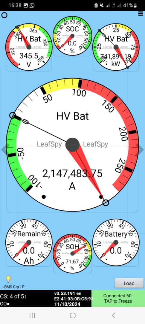

I'm building a 62 kWh battery pack using CATL modules, each with a capacity of 180 Ah, a voltage of 14.8V, a weight of 11.9 kg, and configured in a 4S arrangement. I'm currently using a Nissan Leaf BMS, which I believe is rated for around 40 kWh; it has three temperature sensors, one black high-voltage header, and one grey low-voltage header. To read data from the BMS, I'm using Leaf Spy along with a Bluetooth OBD2 scanner. My plan is to separate the battery pack into two boxes: one with 8 modules in the front and another with 16 modules in the rear.
What have so far achieved
I've successfully connected the BMS to the OBD2 scanner, but Leaf Spy isn’t displaying any data. I suspect this is because l have not yet connected modules
As a newbie, I’ve done most of my research online, and I would greatly appreciate any guidance, suggestions, or advice on how to proceed. Thank you!

I've successfully connected the BMS, and it shows all 96 cells, with the three temperature sensors working. However, I noticed that in all the YouTube videos I've watched, Leaf Spy displays red and blue lines for the cells, but mine only shows blue. Is the BMS functioning correctly, or am I missing something?
Also, for the BMS gray connector, I used the ground, ignition, charge, and sensor wires, but I didn’t connect the two interlock wires. What exactly do the interlock wires do, and will their absence affect the BMS operation?

My understanding is the red lines in leafspy are cells that are balancing. These typically flash / jump from screen refresh to screen refresh. I usually see it when charging.
If you're never seeing it, I wonder if your battery is in a storage mode..
Re: Nissan leaf BMS With CATL 180ah Modules
yes these blue lines also flash / jump from screen refresh to screen refresh and even the mV keeps on changing
