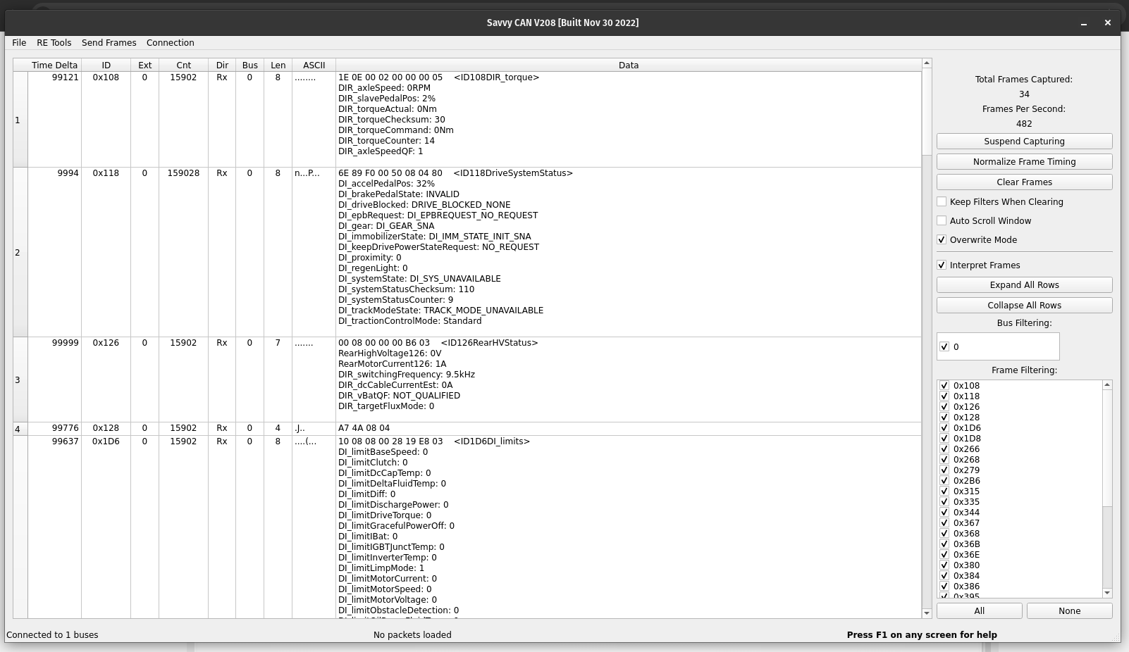

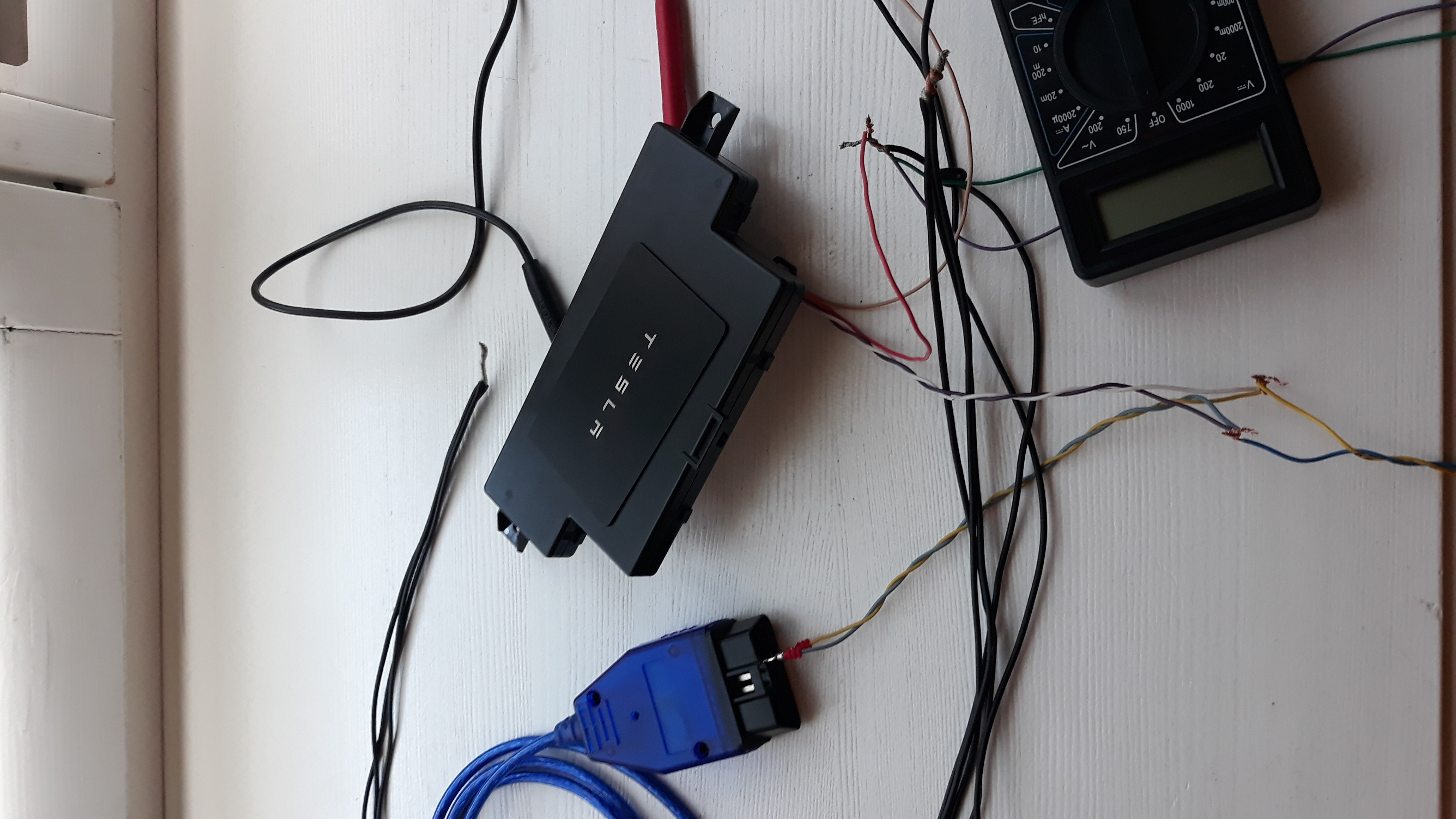

Hey. Now I have a 3D7 drive unit that traveled only 895 km, "go" pedal, keycard and matching VCSEC from the 2023 Tesla MY.
Today I've checked, how the pedal works and it works fine.
Tomorrow I want to connect the VCSEC module to the vehicle can bus of the drive unit and fingers crossed it will appear the message DI_immobilizerState: DI_IMM_STATE_DISARMED.
Unfortunately I have the can logs only from 2019 M3 Perf and very old model 3 can dbc file. It seems to me that my motor has newer software and nothing is going to happen.

I wired the VCSEC with Vehicle can bus of the drive unit and nothing happened like I had guessed before. Need help. Maybe can logs from fresh M3/Y?

Yes, I can make CAN BUS log from my M3 with fresh software.
I would appreciate it.dimonlipko wrote: ↑Sun Apr 14, 2024 1:07 pm Yes, I can make CAN BUS log from my M3 with fresh software.

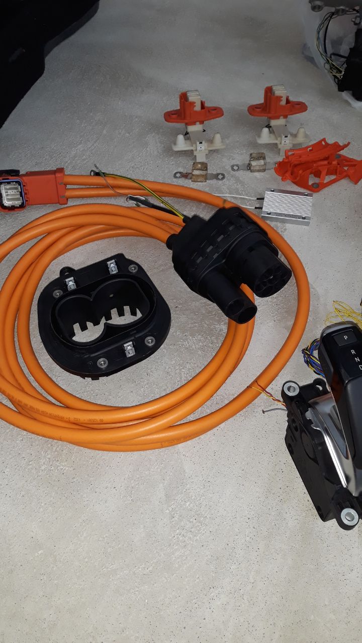

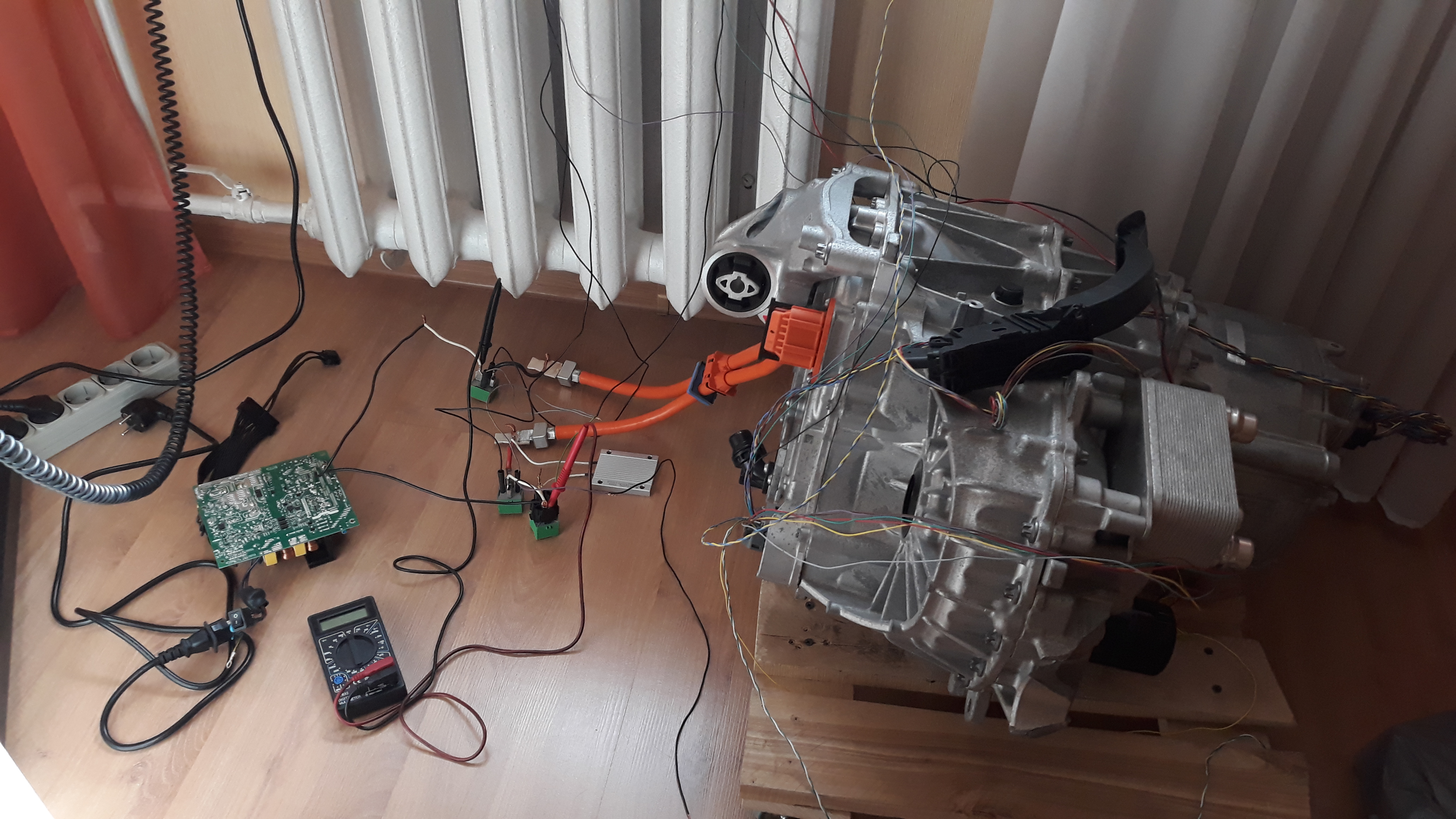

Hello everybody!
Is anyone working on creating their own cortroller to start the engine? I am only at the beginning of this difficult path, so I would like to listen to already experienced users.. However, I have already managed to pair the TM3 rear motor with the TM3 battery using the ingenext controller. I also implemented a cooling and heating system using TMS components, but I would like to control the engine myself.

Great idea! Soon I will review the entire topic to understand what local users have already managed to do. Together we will be able to create a unique ingenext. I would like to attach a photo of my installation, but I don't know how to do it

I've already started the engine. Ingenext has already done everything that was needed with it two months ago, since then I have been developing a thermal controller

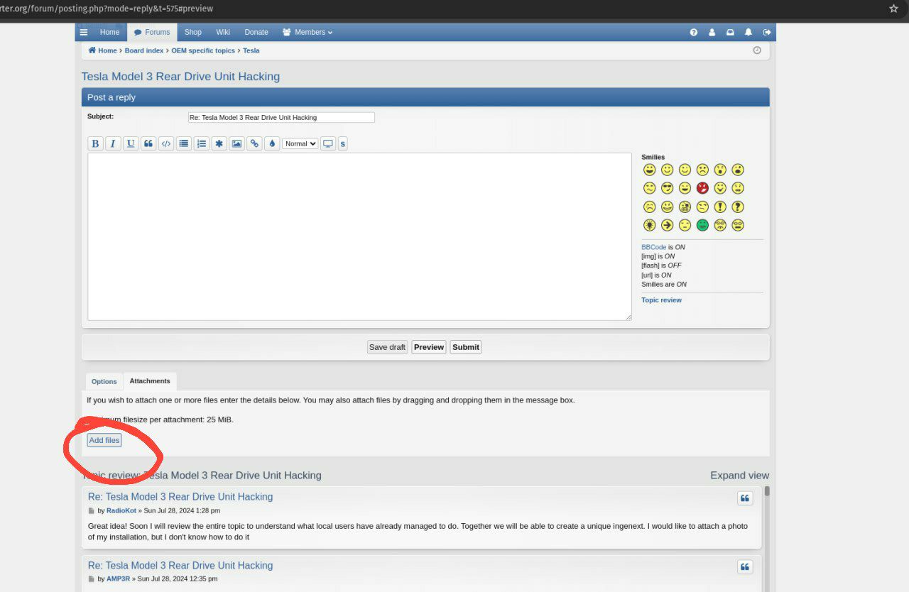

I can't attach it.trc file because it is an invalid file extension. I can send it in other messengers

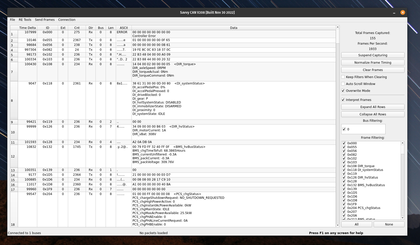

I have this scary setup with an ATX power supply, from which I can take 310V 6A max. It seems to be suitable for testing.
Managed to achieve the inverter states IMMOBILIZER_STATE DISARMED and DI_SYSTEM_STATE IDLE.
I am sure that I am doing something wrong, because the ACTIVE DISCHARGE - ON error is active.

Do you have an intact HVIL loop with a 20mA current running through it? Without that the HV bus discharge circuit on the inverter will not deactivate.
