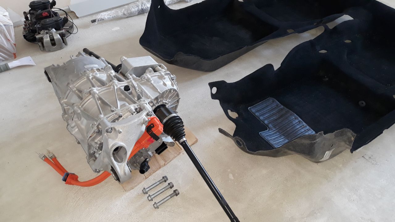

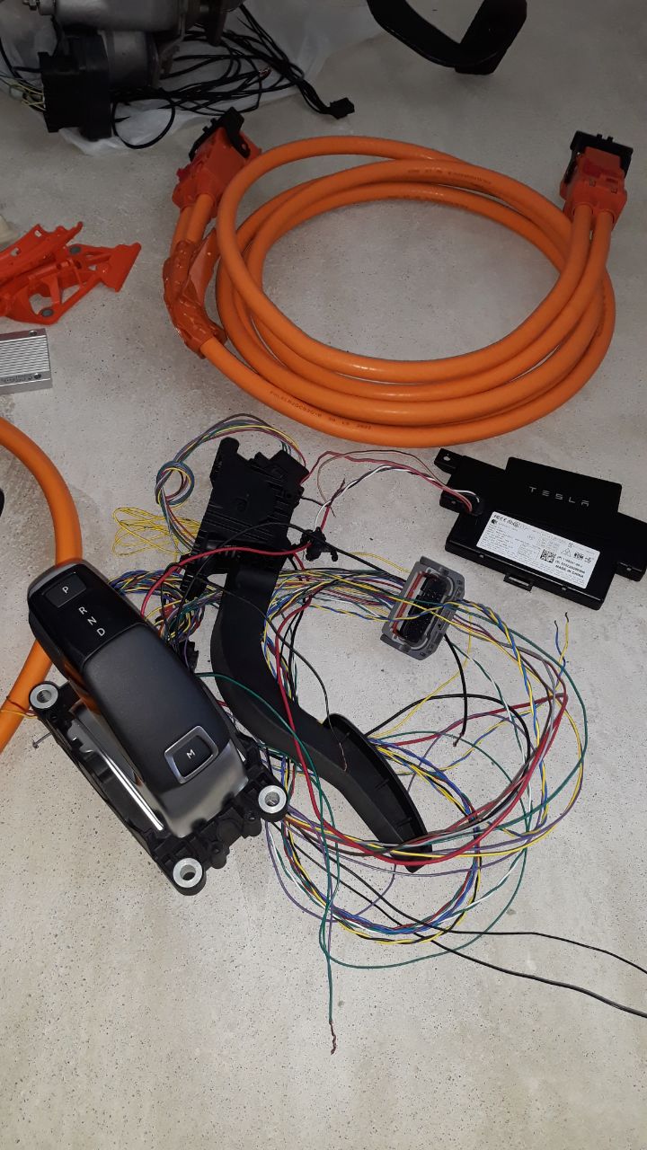

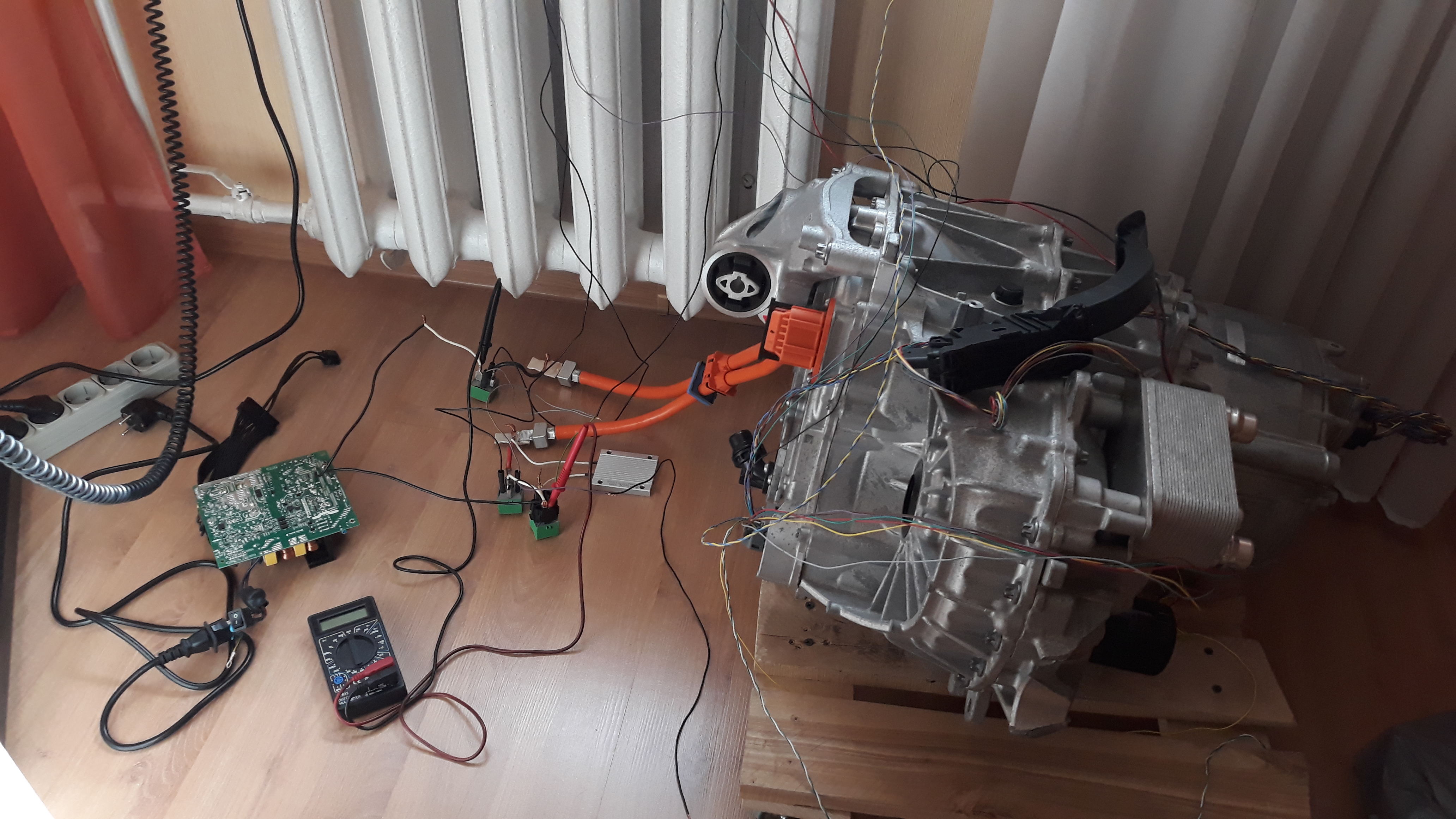

Hey. Now I have a 3D7 drive unit that traveled only 895 km, "go" pedal, keycard and matching VCSEC from the 2023 Tesla MY.
Today I've checked, how the pedal works. And it works fine.

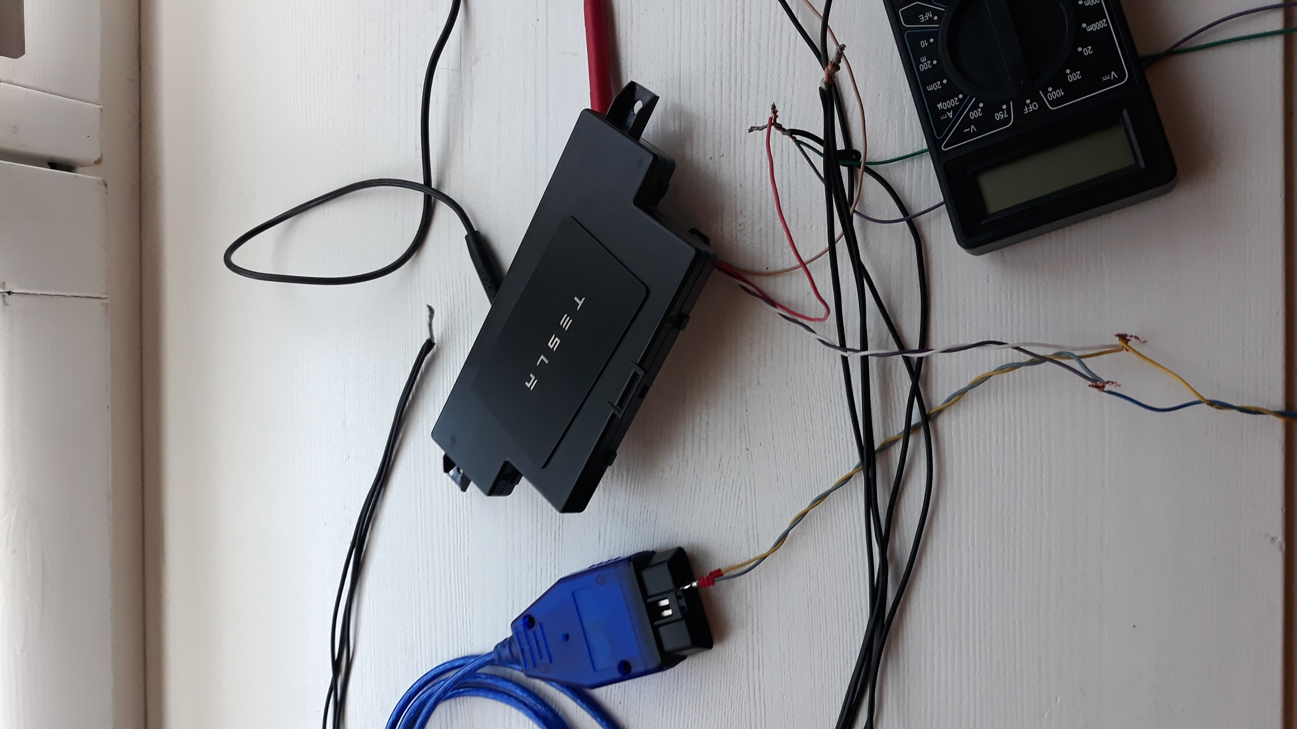

Tomorrow I want to connect the VCSEC module to the vehicle can bus of the drive unit and fingers crossed it will appear the message DI_immbilizerState: DI_IMM_STATE_DISARMED.
Unfortunately I have the can logs only from 2019 M3 Perf and very old model 3 can dbc file. It seems to me that my motor has newer software and nothing is going to happen. :D

I wired the VCSEC with Vehicle can bus of the drive unit and nothing happened like I had guessed before. Need help. Maybe can logs from fresh M3/Y?

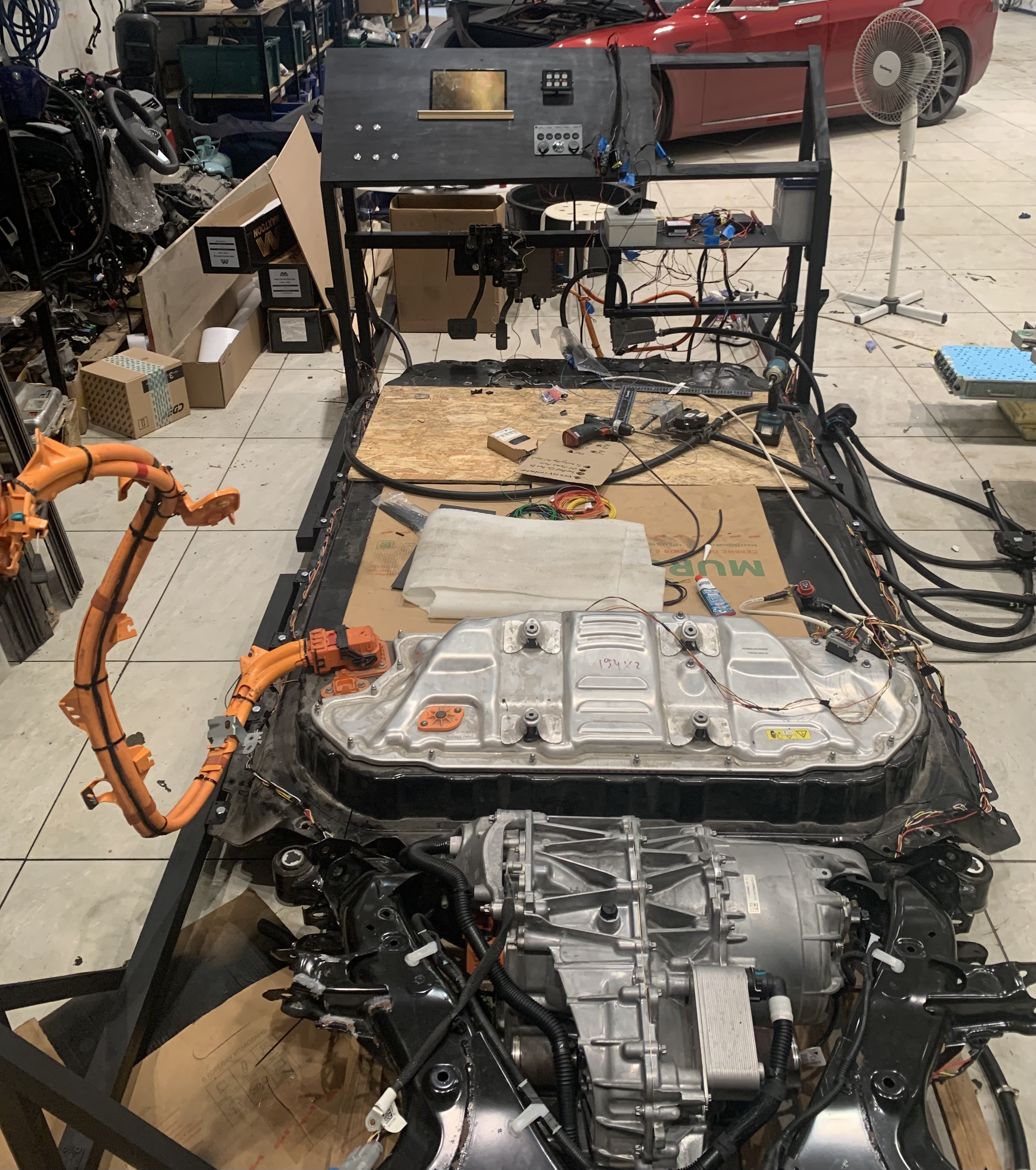

Is anyone working on creating their own cortroller to start the engine? I am only at the beginning of this difficult path, so I would like to listen to already experienced users.. However, I have already managed to pair the TM3 rear motor with the TM3 battery using the ingenext controller. I also implemented a cooling and heating system using TMS components, but I would like to control the engine myself.
Can anyone suggest something about this?

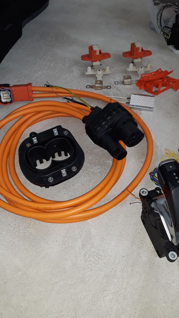

Great idea! Soon I will review the entire topic to understand what local users have already managed to do. Together we will be able to create a unique ingenext. I would like to attach a photo of my installation, but I don't know how to do it
AMP3R
Posts: 125
Been thanked: 53 times
Post by AMP3R »
here
RadioKot
Posts: 9
Joined: Sun Jul 28, 2024 4:02 am
Has thanked: 4 times
Post by RadioKot »
So there is my installation

That's an impressive setup. I'm jealous!

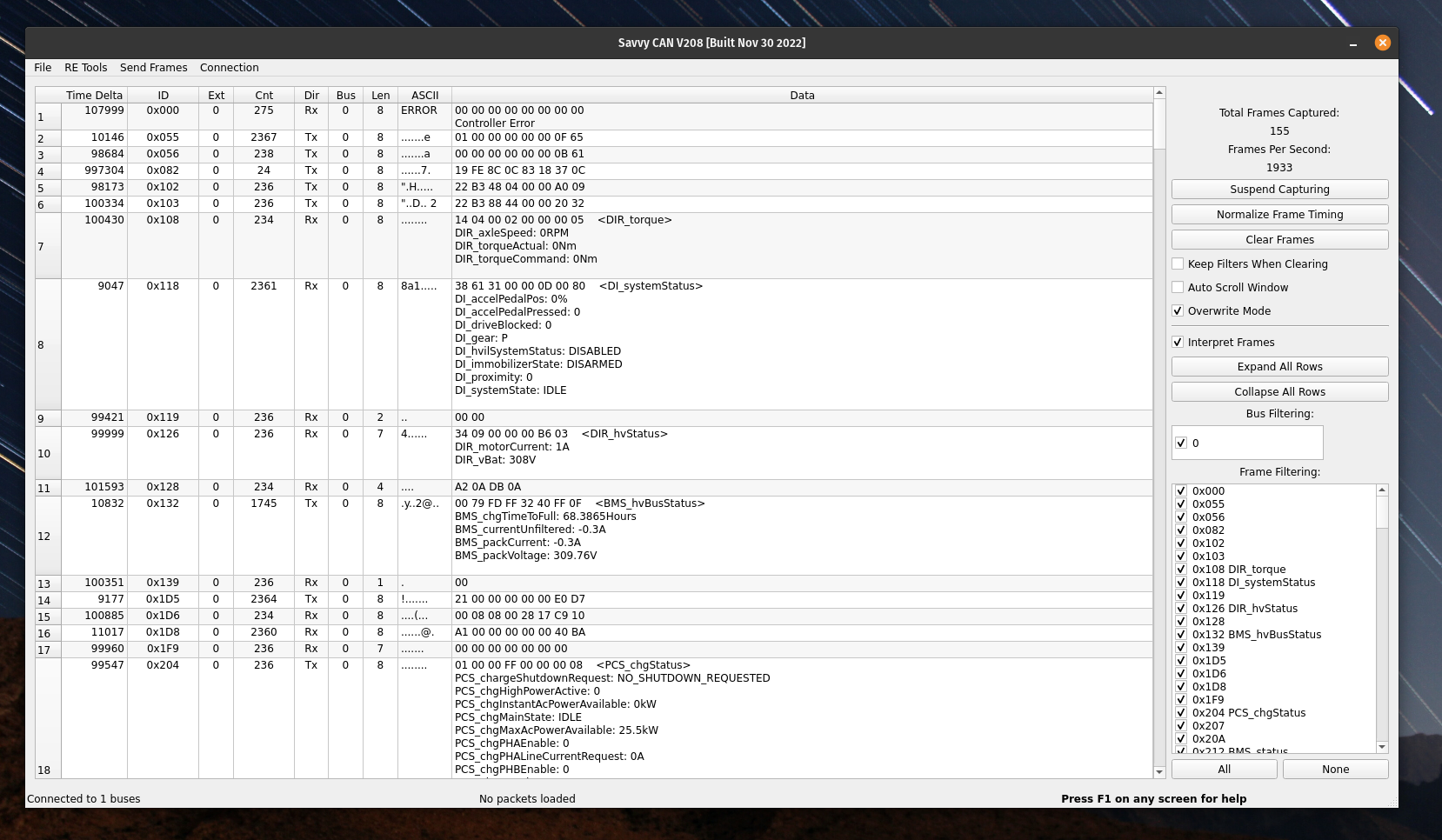

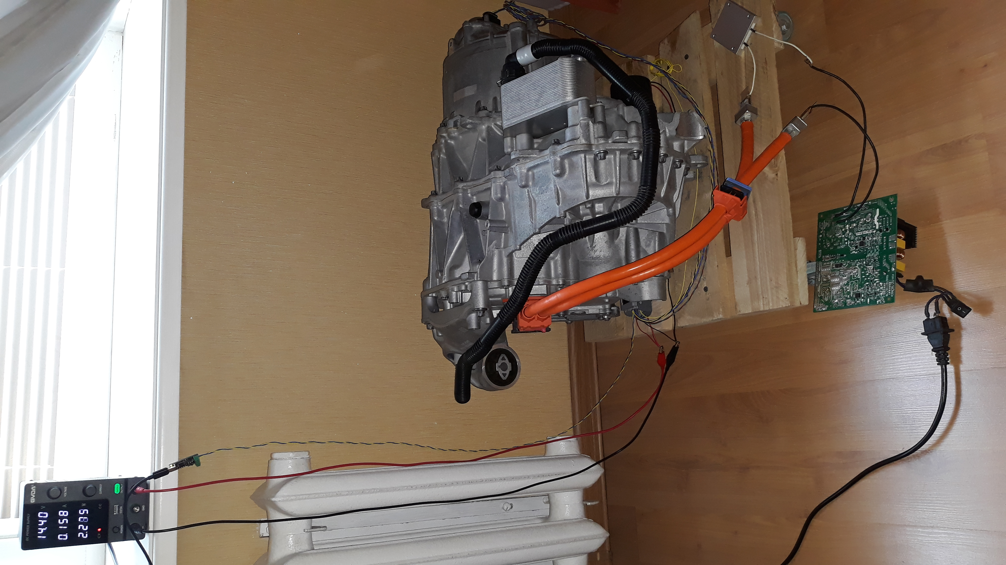

I have this scary setup with a computer power supply, from which I take 310V 6A max. It seems to be suitable for testing.
Using prepared can logs and so far only VEHICLE CAN, I managed to achieve the inverter states IMMOBILIZER_STATE DISARMED and DI_SYSTEM_STATE IDLE.
I am sure that I am doing something wrong, because the ACTIVE DISCHARGE - ON error is active.

Post by davefiddes »
Do you have an intact HVIL loop with a 20mA current running through it? Without that the HV bus discharge circuit on the inverter will not deactivate.
