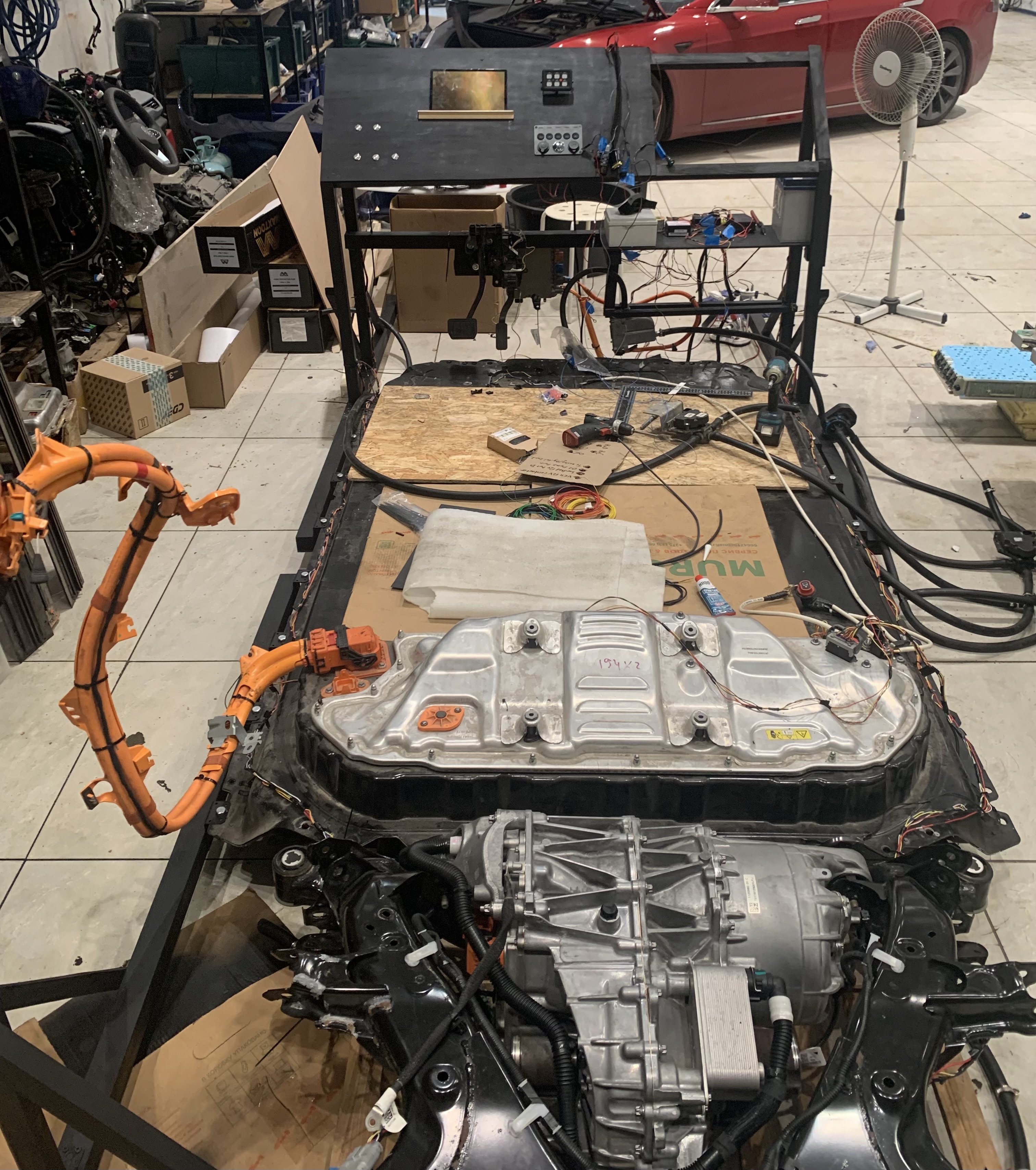

Post by RadioKot »
So there is my installation

Post by davefiddes »
That's an impressive setup. I'm jealous!
A open CAN based solution would be welcomed by many. If you guys can collaborate on it that would be fantastic.

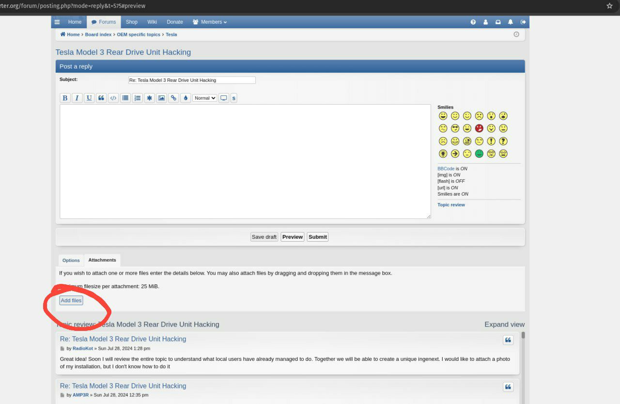

I can't attach it.trc file because it is an invalid file extension. I can send it in other messengers

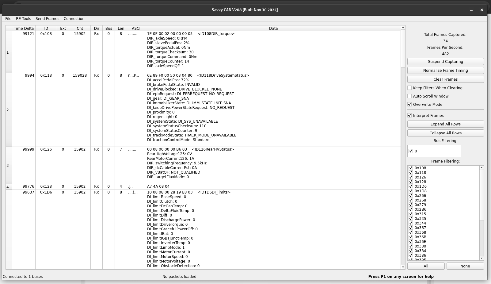

I have this scary setup with a computer power supply, from which I take 310V 6A max. It seems to be suitable for testing.
Using prepared can logs and so far only VEHICLE CAN, I managed to achieve the inverter states IMMOBILIZER_STATE DISARMED and DI_SYSTEM_STATE IDLE.
I am sure that I am doing something wrong, because the ACTIVE DISCHARGE - ON error is active.
Do you have an intact HVIL loop with a 20mA current running through it? Without that the HV bus discharge circuit on the inverter will not deactivate.

davefiddes wrote: Fri Aug 30, 2024 10:05 am Do you have an intact HVIL loop with a 20mA current running through it? Without that the HV bus discharge circuit on the inverter will not deactivate.
I haven't connected HVIL. Can you tell me how to emulate it? What voltage is there? Is PWM used?
It's quite simple to emulate on the bench. It is a simple 20mA current loop and you can use the same 12VDC supply you use for the main inverter (it is optically isolated from the main inverter electronics).
I use the following circuit with an LM317L regulator:
The HV DC connector is part of the loop. I see you have the official cable so you should be good. If anyone wants to jumper it out you need to do this:
The HV discharge circuitry is completely automatic but the HVIL current is monitored by the main inverter MCU.

I found you can see the operation of the discharge circuitry quite clearly with a current clamp on the HVDC input. With an idle inverter the two sources of current draw on the HVDC is the backup gate drive PSU and the HV discharge resistors. Turning on and off the HVIL circuit varied it quite significantly. You need a current clamp that is accurate in the DC mA range. My cheap UNI-T UT210E Pro seems to do the job OK.
Active discharge alert has gone. Thanks!
