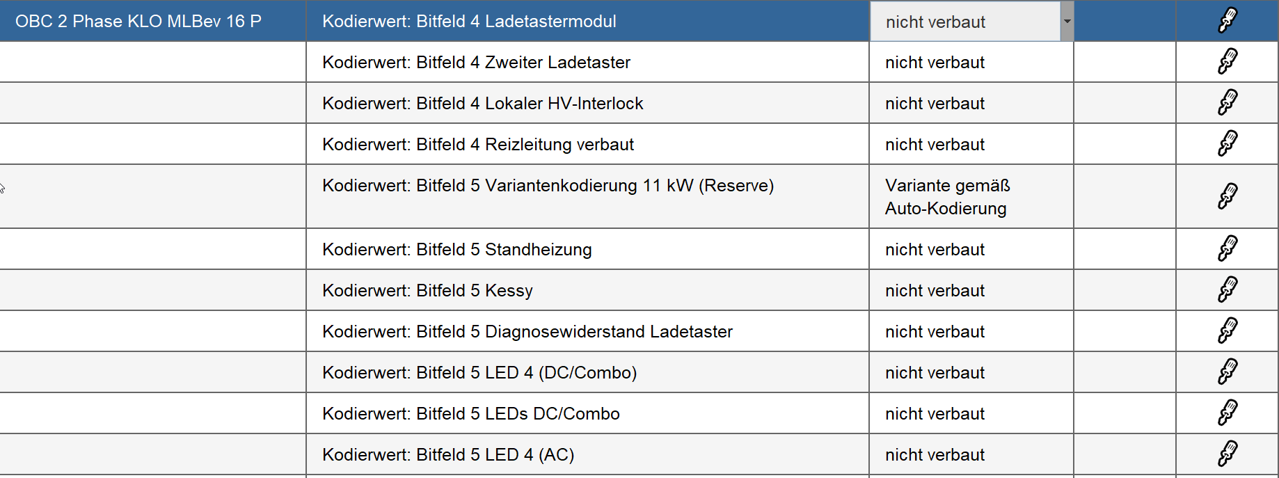

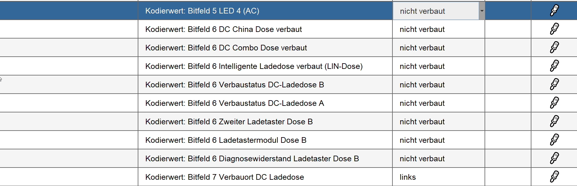

I'm just guessing, but I think it is because those chargers are build to provide also markets with a single phase 32A infrastructure.
You can recode the charger to use one phase with 32A or back to two phases with 16A.
Here is a video about that coding:
Greetinx

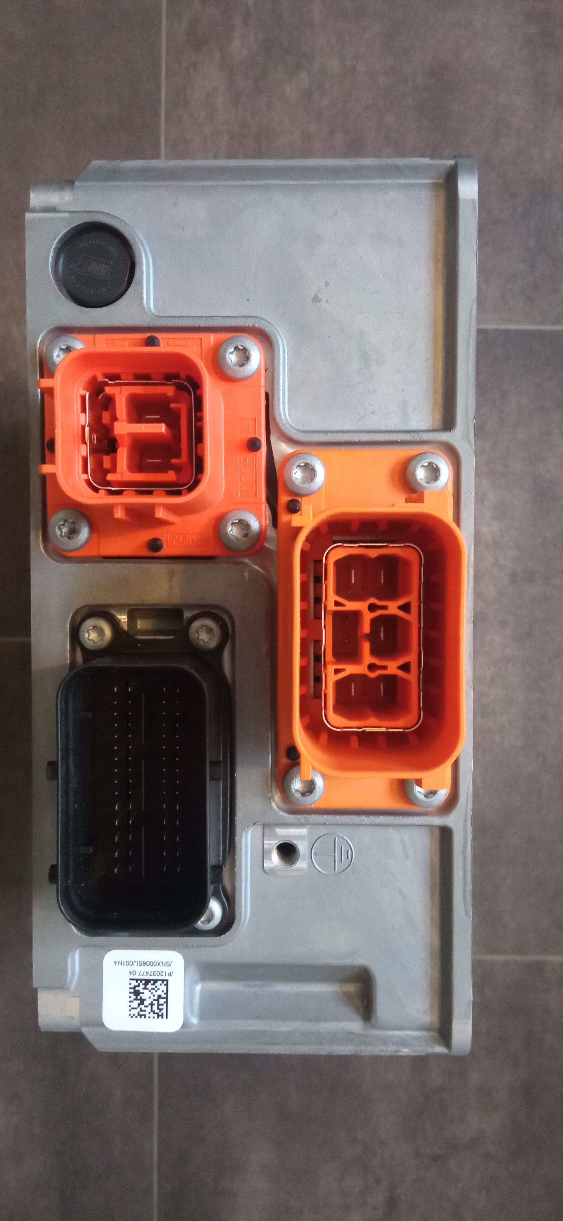

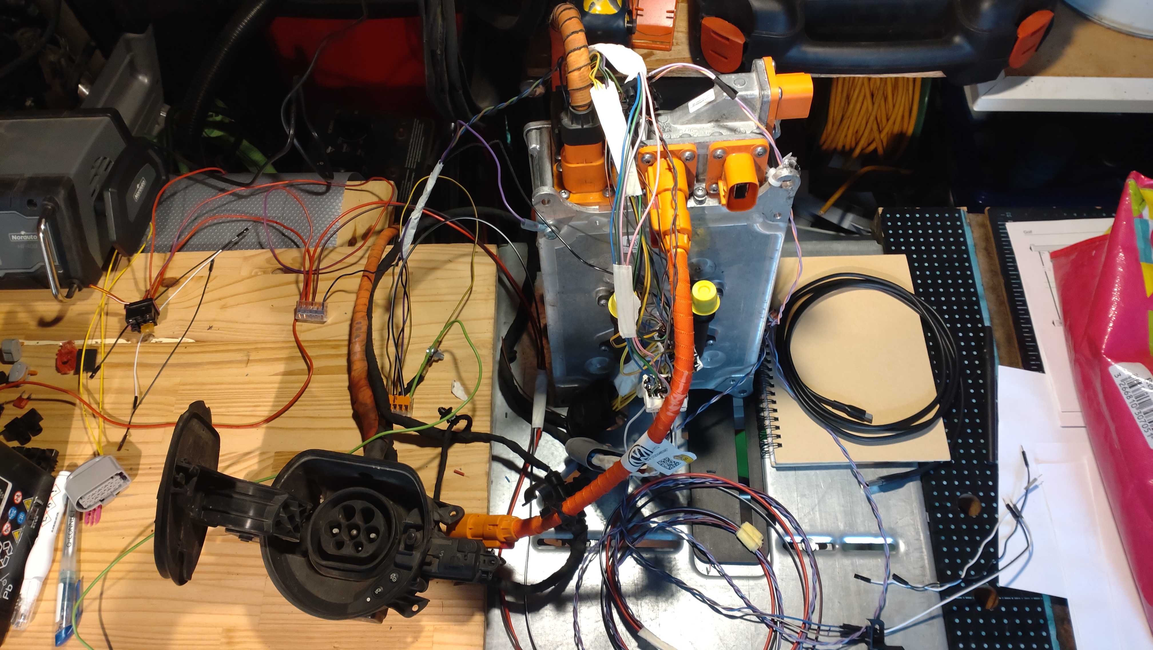

Just picked up a 5QE.915.684.AD charger from a 2021 Audi E-Tron Canadian Model.
Hoping to help out with the Reverse Engineering efforts, or at least prove them on North American variants.
Likely best to document everything here, but I think this thread will fragment into the few various different models, even if they're all 'MEB' type, the implementation seems to differ quite a bit between the MQB and MLBevo models.
The E-Tron chargers have several things which make them a bit different, one major being the LIN LED module and Door actuator, as well as only having a Hybrid CAN connection (No Drive CAN)
The CAN signals appear to be totally different than those for the rest of the charger line.
As per the DBC file I posted, The charger is pretty integrated into the other bus messages, but the messages seem totally different than those found by Damien

Been messing around with my Cayenne charger for the last few months. Tonight I finally got some continuous charge out of it. Uploaded are the coding settings I used in PIWIS.
I think the main settings that did it was disabling power line communications and also enabling plug and charge.
Edit: On further testing these didn't make any difference.
Further edit: It seems what it really cares about is socket temperature, if that's open or too high it wont charge at all. It also doesn't like charging with a target voltage of below 380v or so. Apart from that I have many faults showing on PIWIS but it will charge anyway.
With this set I use Mitchys code that he used with the higher power chargers and could enable and disable charge, also lower or increase charging amps.
Further further edit: On reflection I think this is probably more useful in the MLBevo charger thread, as I think this Porsche charger is part of that family.

EDIT: Got 684J 11kW charger. After testing I 'accidentally' noticed charger data is on the same CAN bus, no need for two busses on this one. Now that I read previous posts this is clear, mee soo stupid
Now I need to code things using ODIS, so there is hope on this.
