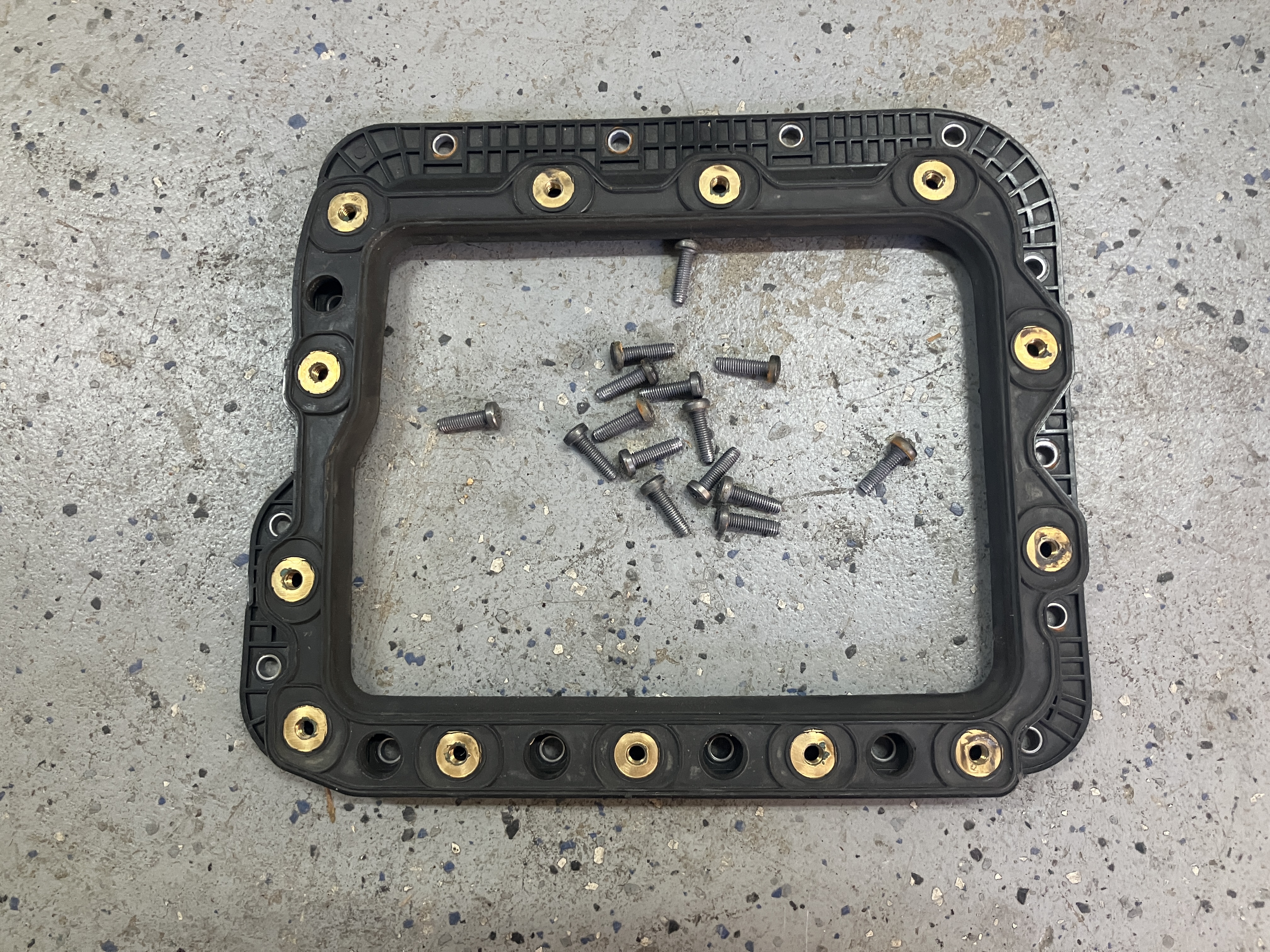

got the BMW 330e OEM battery box back in, but before I done did that I decided to lighten the load a bit and remove some unnecessary appendages
this oblong coolant hole will be perfect access to get the Outlander charger cable to the Safety Box inside this battery pack, of course it will get water tighted sealed [eventually]
this Flux Capacitor had to go
