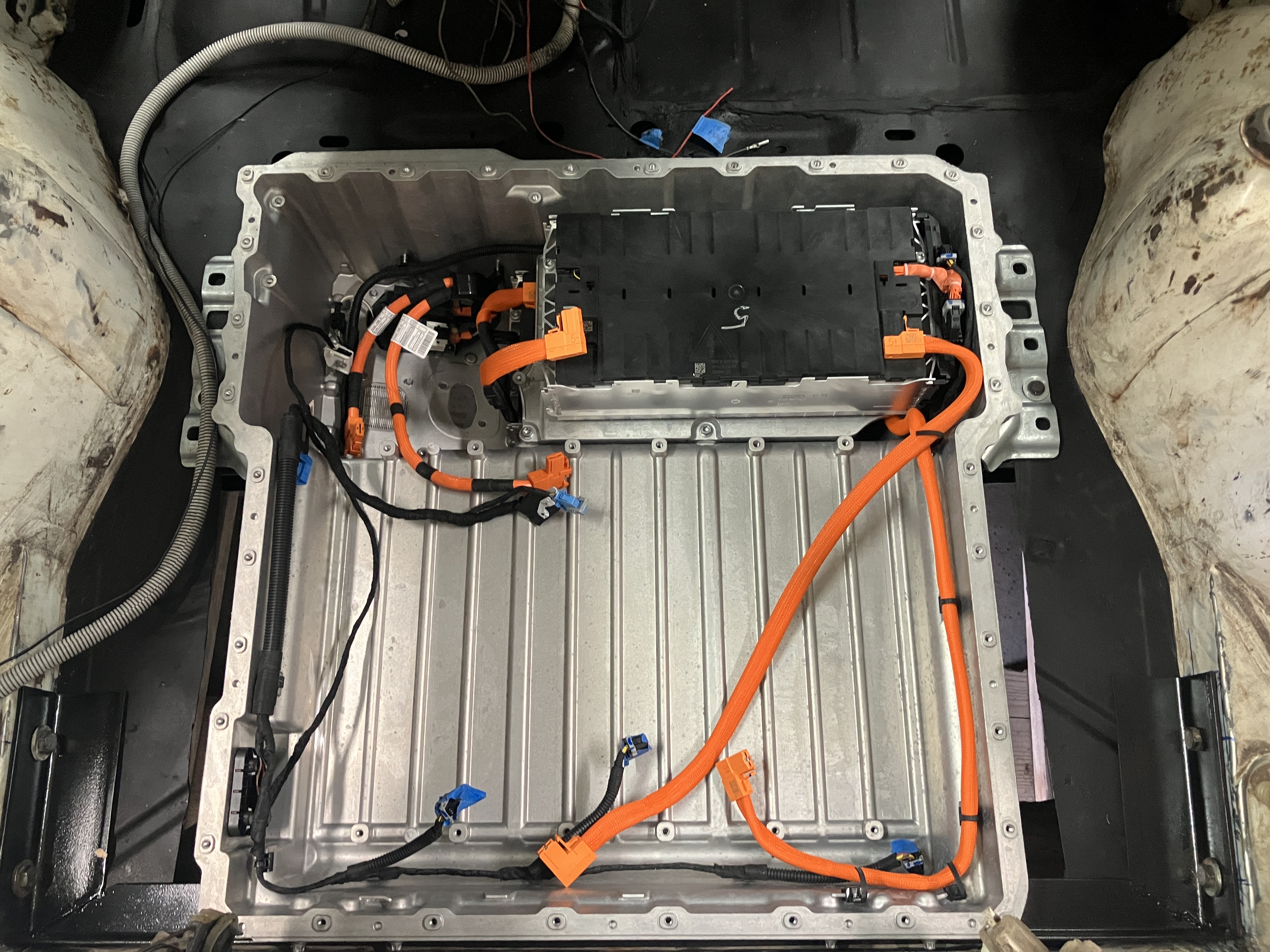

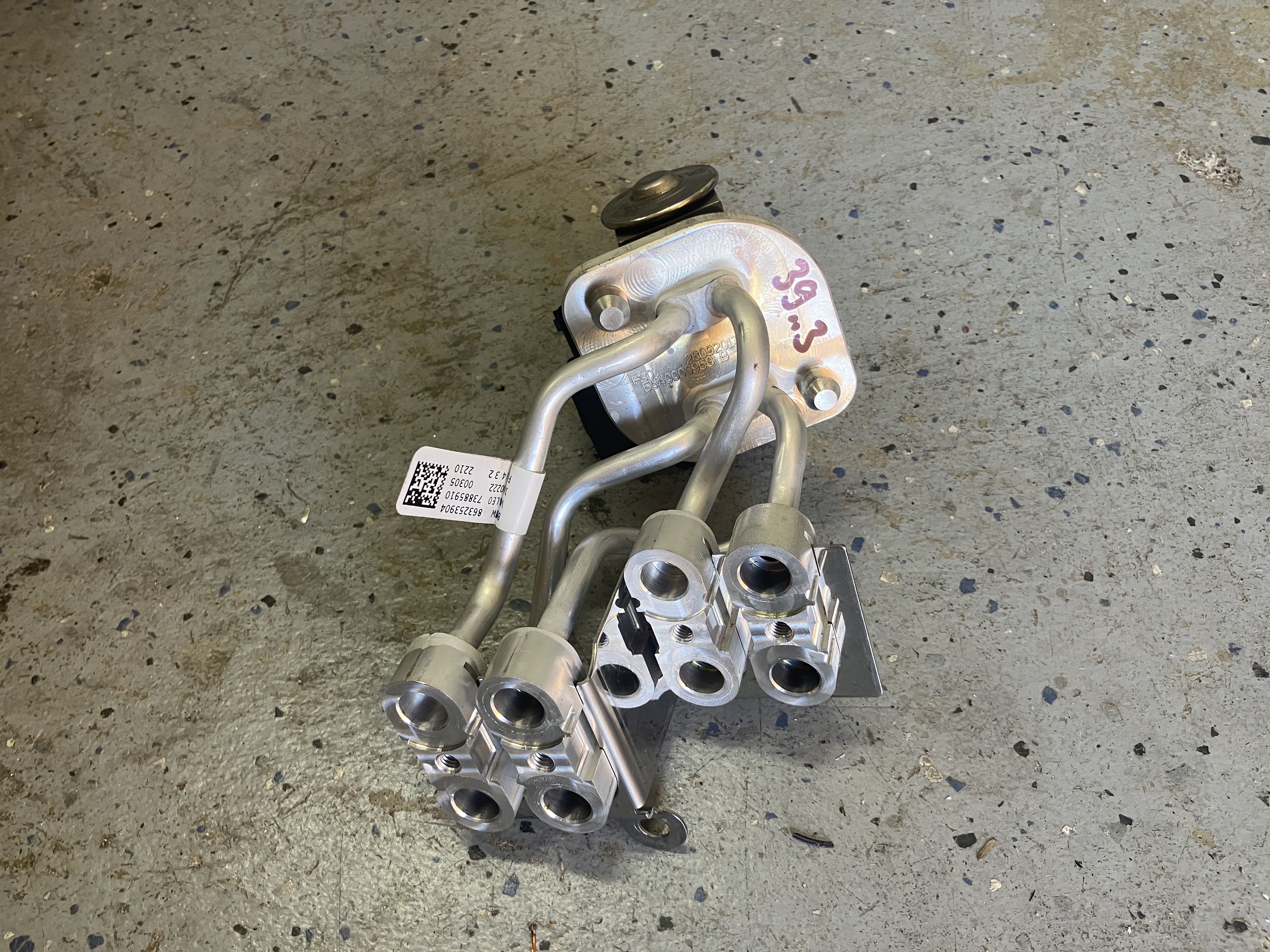

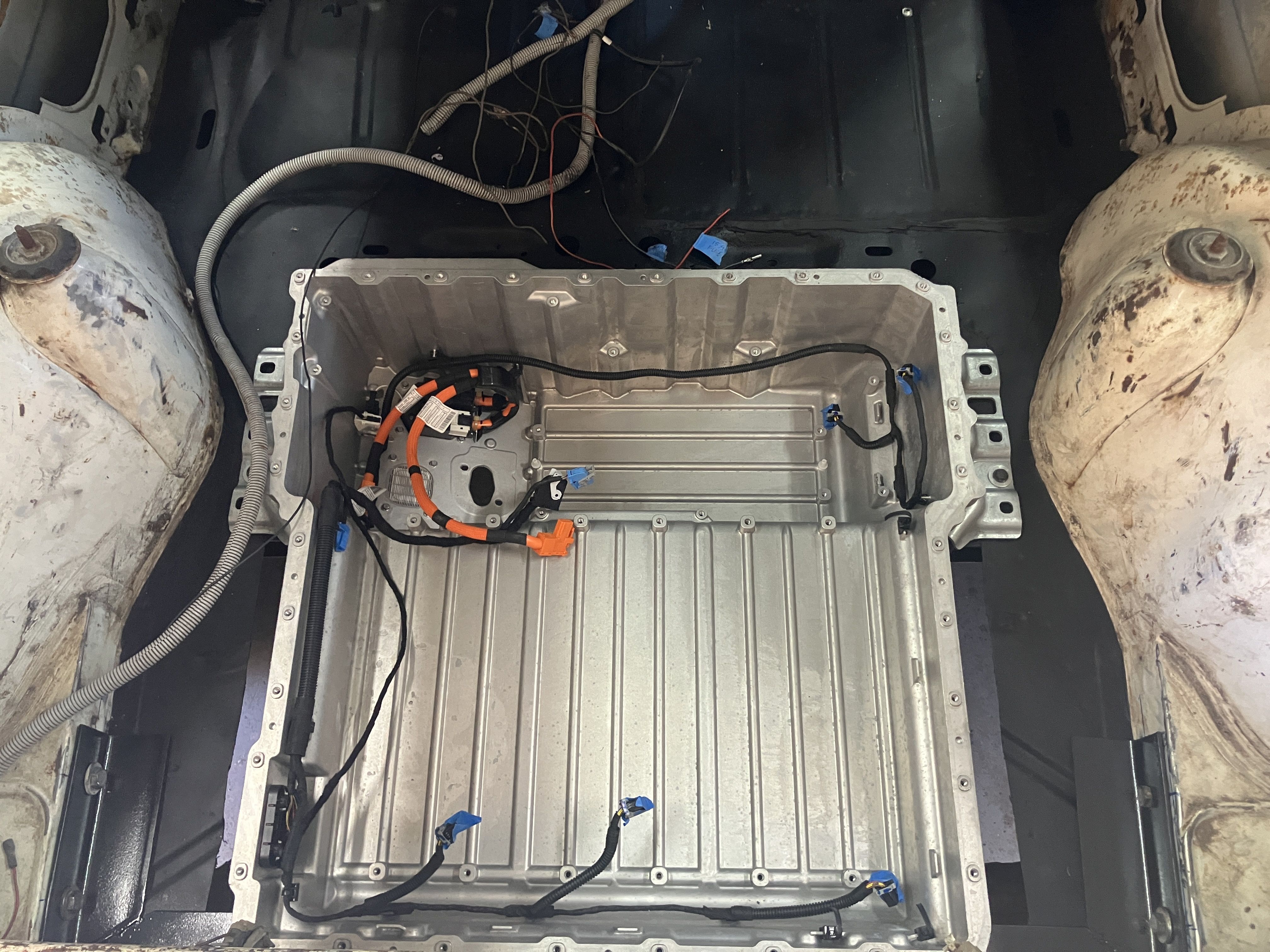

got the BMW 330e OEM battery box back in, but before I done did that I decided to lighten the load a bit and remove some unnecessary appendages
this oblong coolant hole will be perfect access to get the Outlander charger cable to the Safety Box inside this battery pack, of course it will get water tighted sealed [eventually]
this Flux Capacitor had to go

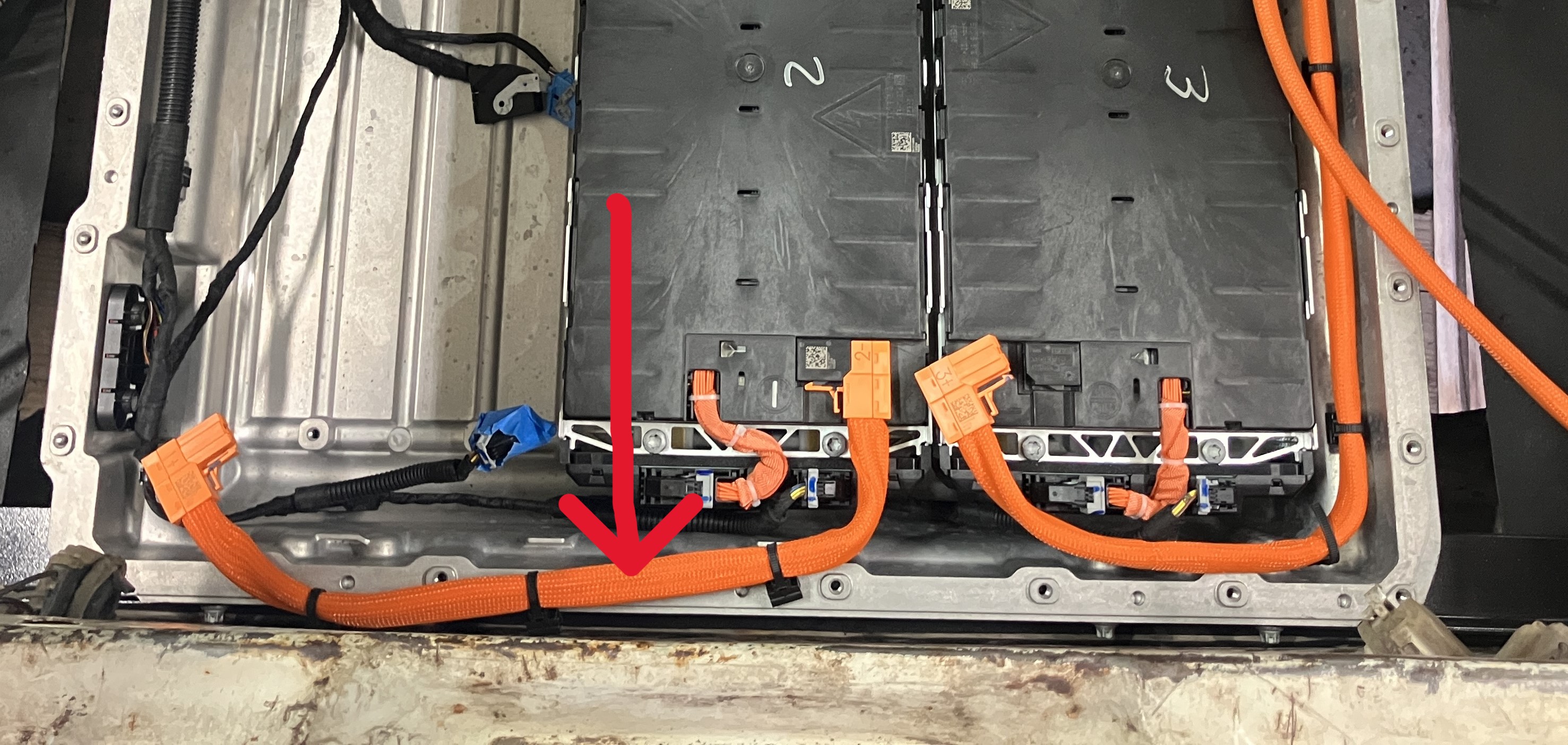

unplastification of the stock OEM BMW 530e battery pack high voltage orange cable to something something was next, I honestly have no idea what this ran to in it's stock configuration but in our case it will run to the Prius inverter
see it pays to always ask if they can throw in some cables or wires
fingers crossed she will reach
and perfection, she made it all the way to the Prius inverter

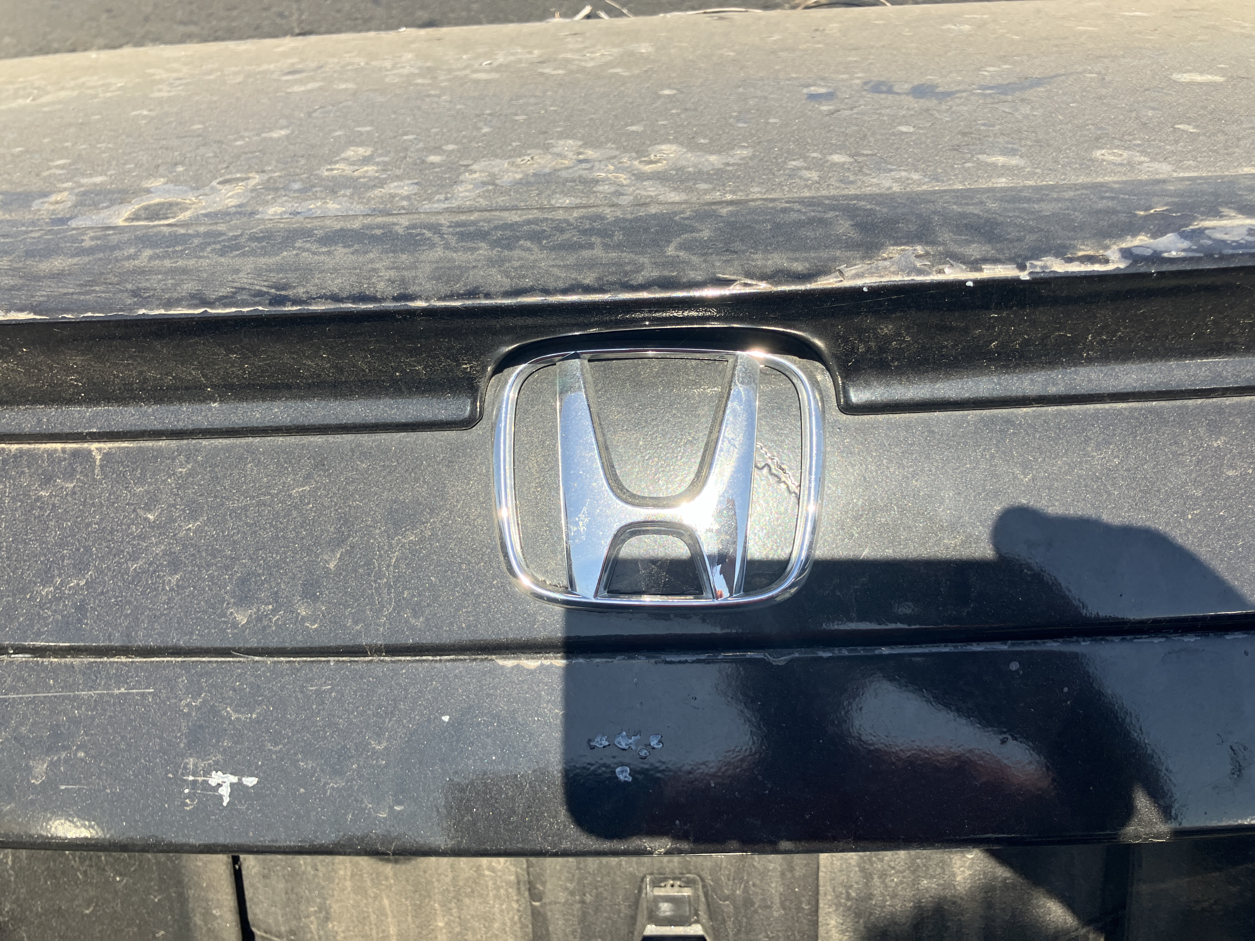

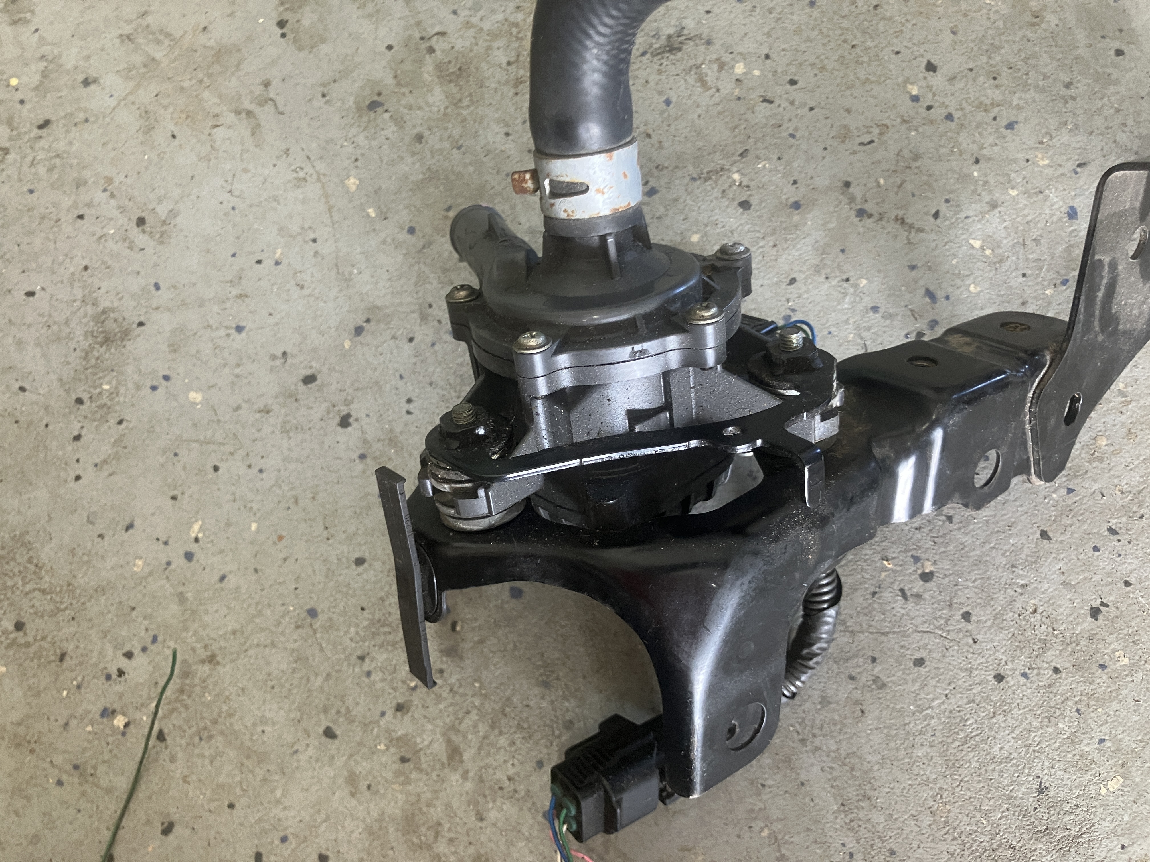

Honda Fit Throttle Pedal for the DIY EV VW Rabbit from Pick-N-Pull
2009 Honda Fit throttle pedal - $9.99

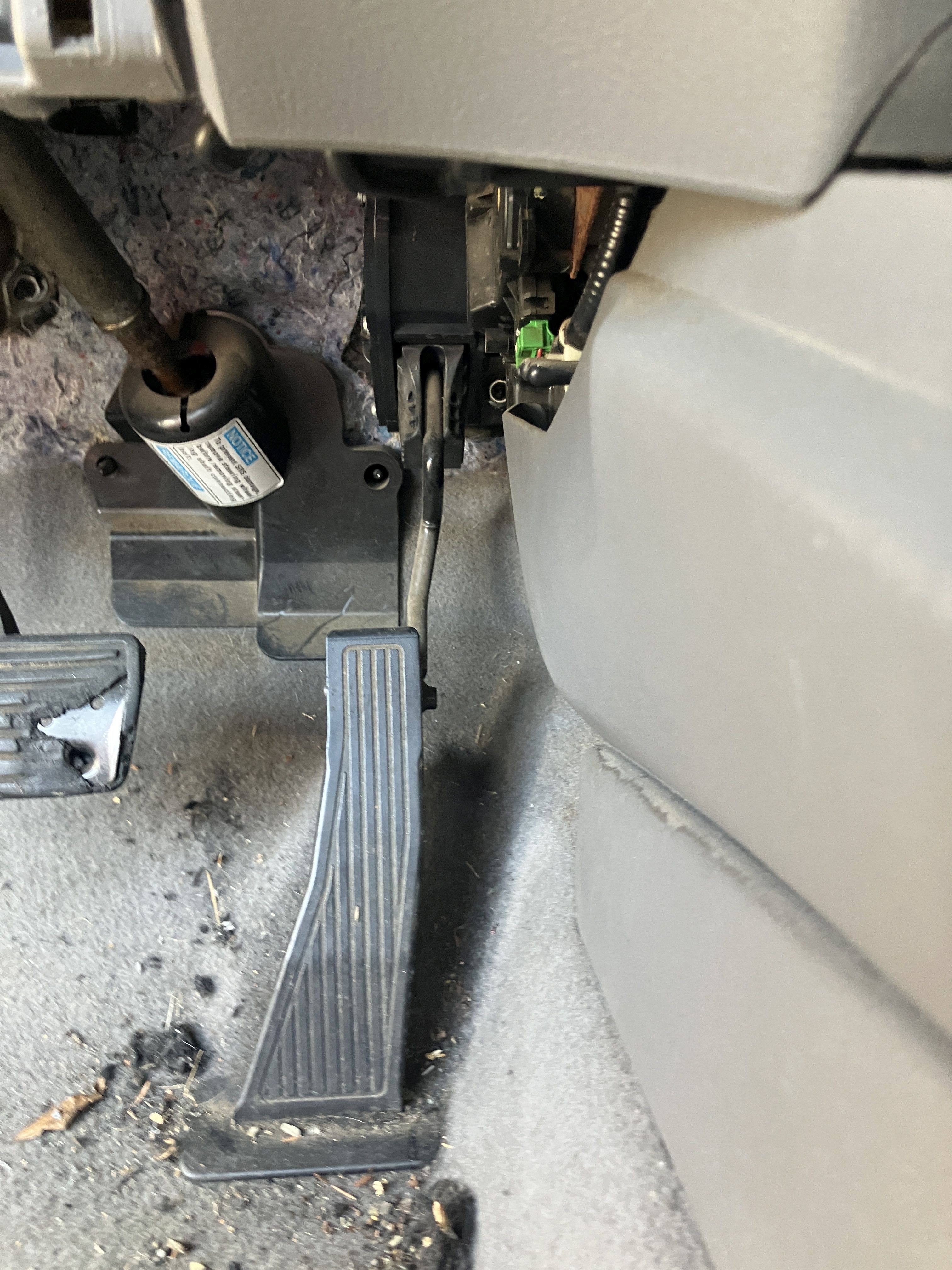

I also spied this rather interesting pedestal floor mounted yet firewall suspended twisty metal rod throttle pedal in a 2007 Honda Cervix, which I thought was worth a share, I was amin' at pullin' it but I left my deep socket at home

the overall thickness including the orange conduit is 11 mil, I will measure the internal copper strands once I cut this one
here's a link to me cutting the same cable for my truck
viewtopic.php?p=58011#p58011

a little progress on the high voltage Mitsubishi Outlander / BMW 330e sBox wirebility

You didn't happen to measure the length of this BMW battery cable?
- Gregski
- Posts: 3171
- Has thanked: 635 times
- Been thanked: 1611 times
11' 7" and you may find this thread interesting: I bought a BMW 530e hybrid battery pack - Now What?

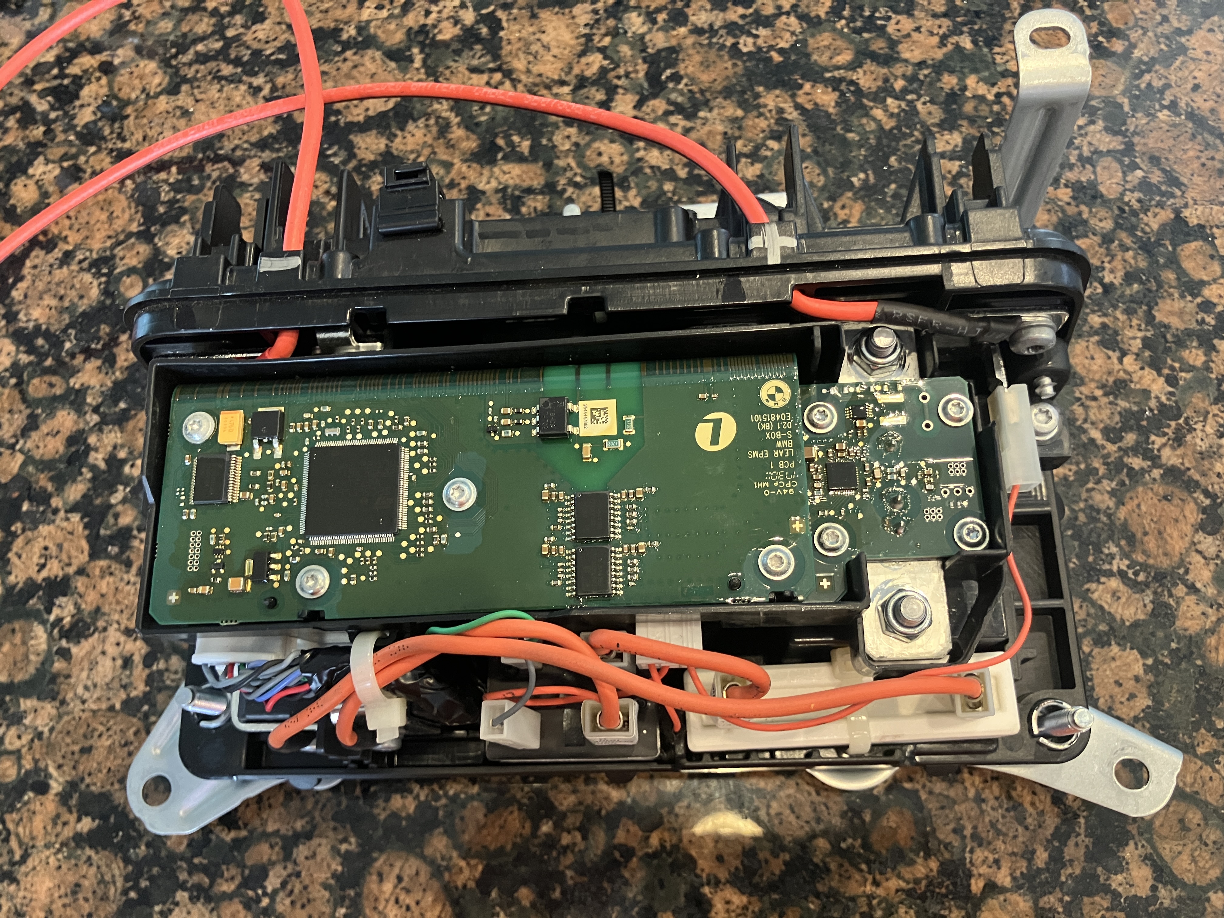

Mitsubishi Outlander Charger BMW 330e Safety Box Marriage
The Outlander charger needs it's capacitor pre charged so we will leverage the OEM BMW 330e Safety Box (contactor box) in the same way it pre charges the cap in the Prius inverter
pay no attention to the + - markings those do not correspond with these skinny orange charger wires

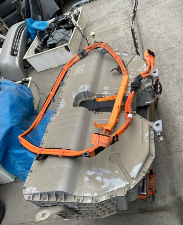

so cut one of the stock ends off of the OEM BMW 530e high voltage battery pack cable and crimped on some ring terminals. this is how we will connect it to the Prius inverter

I think that's the #5 below, so 61277544893 also please check out this post I bought a BMW 530e hybrid battery pack - Now What?
#1 HV battery, B+ cable Part Number: 61278649869 Supersession(s): 61-27-8-649-869
#2 HV battery, negative cable Part Number: 61278649871 Supersession(s): 61-27-8-649-871
#4 HV battery, negative cable Part Number: 61277544892 Supersession(s): 61-27-7-544-892
#5 HV battery, B+ cable Part Number: 61277544893 Supersession(s): 61-27-7-544-893
#6 HV battery, B+ cable Part Number: 61277544894 Supersession(s): 61-27-7-544-894
#7 HV battery, B+ cable Part Number: 61277544895 Supersession(s): 61-27-7-544-895
#8 HV battery, B+ cable Part Number: 61277544896 Supersession(s): 61-27-7-544-896
#10 Cell Module Connector Part Number: 61278618444 Supersession(s): 61-27-8-618-444

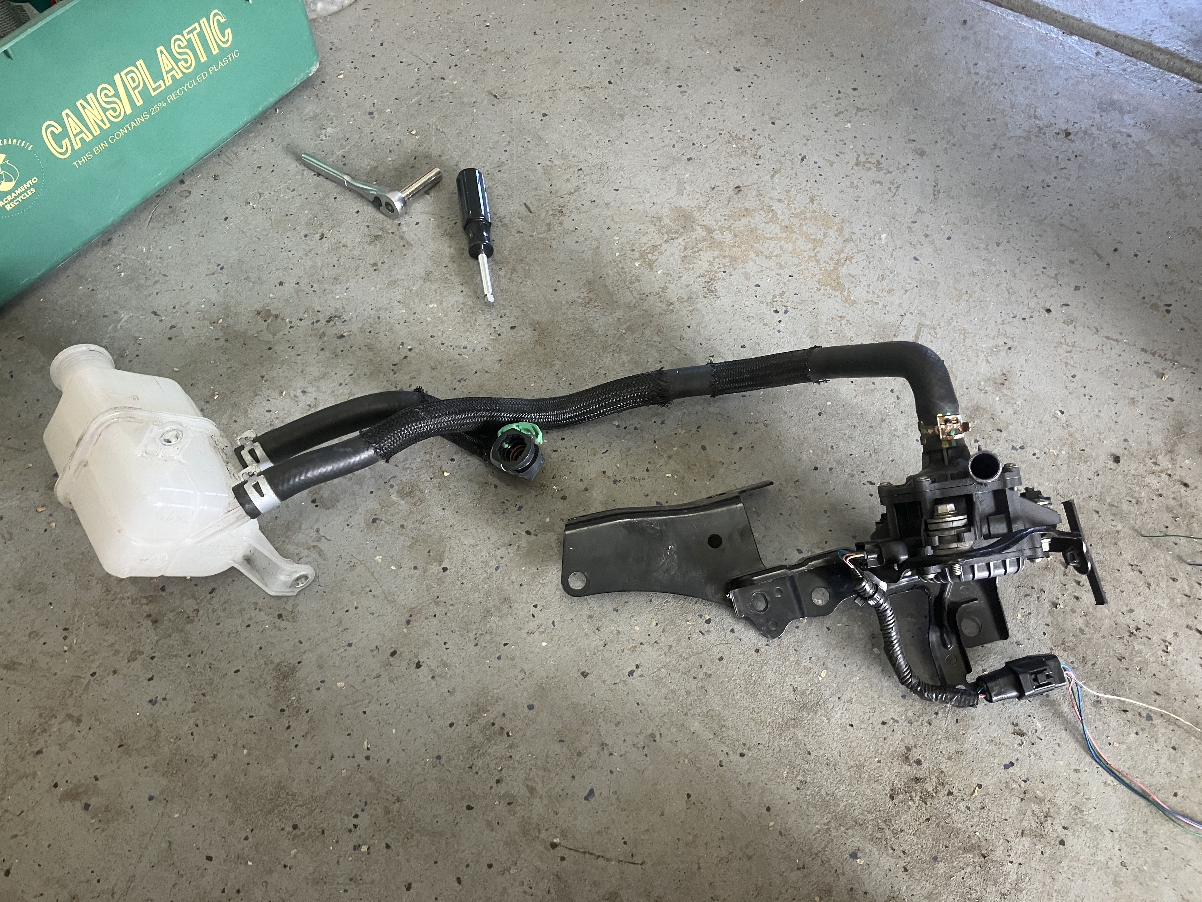

Mima used to say it's always a good sign when liquids are going in! Turns out the leak in the video was from the overflow port at the top of the coolant reservoir and a funnel took care of that issue.
you may also find this thread useful: Prius Gen 3 Inverter Transmission Cooling System Diagram Dumbed Down
trying to use as much OEM stuff as possible, so here is the water pump from the same 3rd gen Prius as my inverter and transaxle, it's a simple 4 wire jobbie with: ground, pwm in, pwm out, and 12v, not necessarily in that order, I hope to get the pwm fingered out but for a test drive I may just run it at full speed, what say you?
side note: I have recently taken up an unpaid internship at the Jamie Jones Institute of Cameratology (via his remote extension online course offering)
