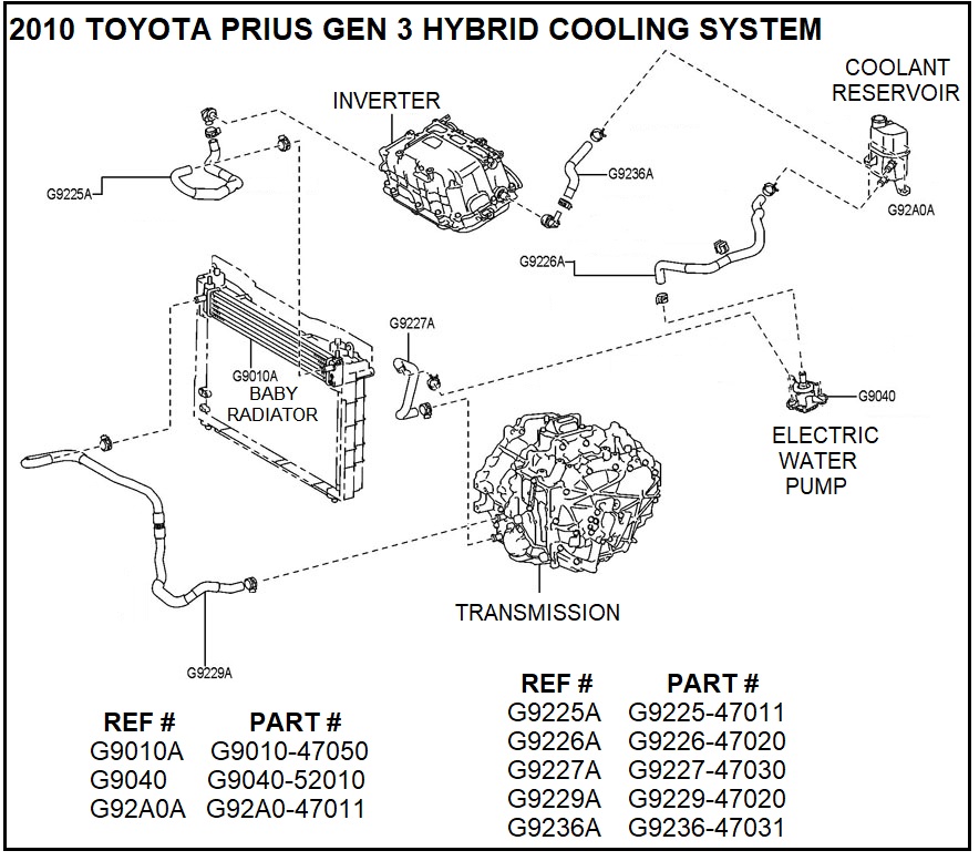

I hope some of you will find this useful if you desire to run the stock Prius Gen 3 hybrid component cooling system in your conversions. I was mostly focusing on the hoses here.
REF # PART # DESCRIPTION
G9010A - G9010-47050 Little Radiator
G9040 - G9040-52010 Electric Water Pump
G92A0A - G92A0-47011 Coolant Reservoir
G9225A - G9225-47011 Inverter/Radiator Hose
G9226A - G9226-47020 Reservoir/Upper Water Pump Hose
G9227A - G9227-47030 Water Pump/Lower Transmission Hose
G9229A - G9229-47020 Radiator/Upper Transmission Hose
G9236A - G9236-47031 Inverter/Reservoir Hose

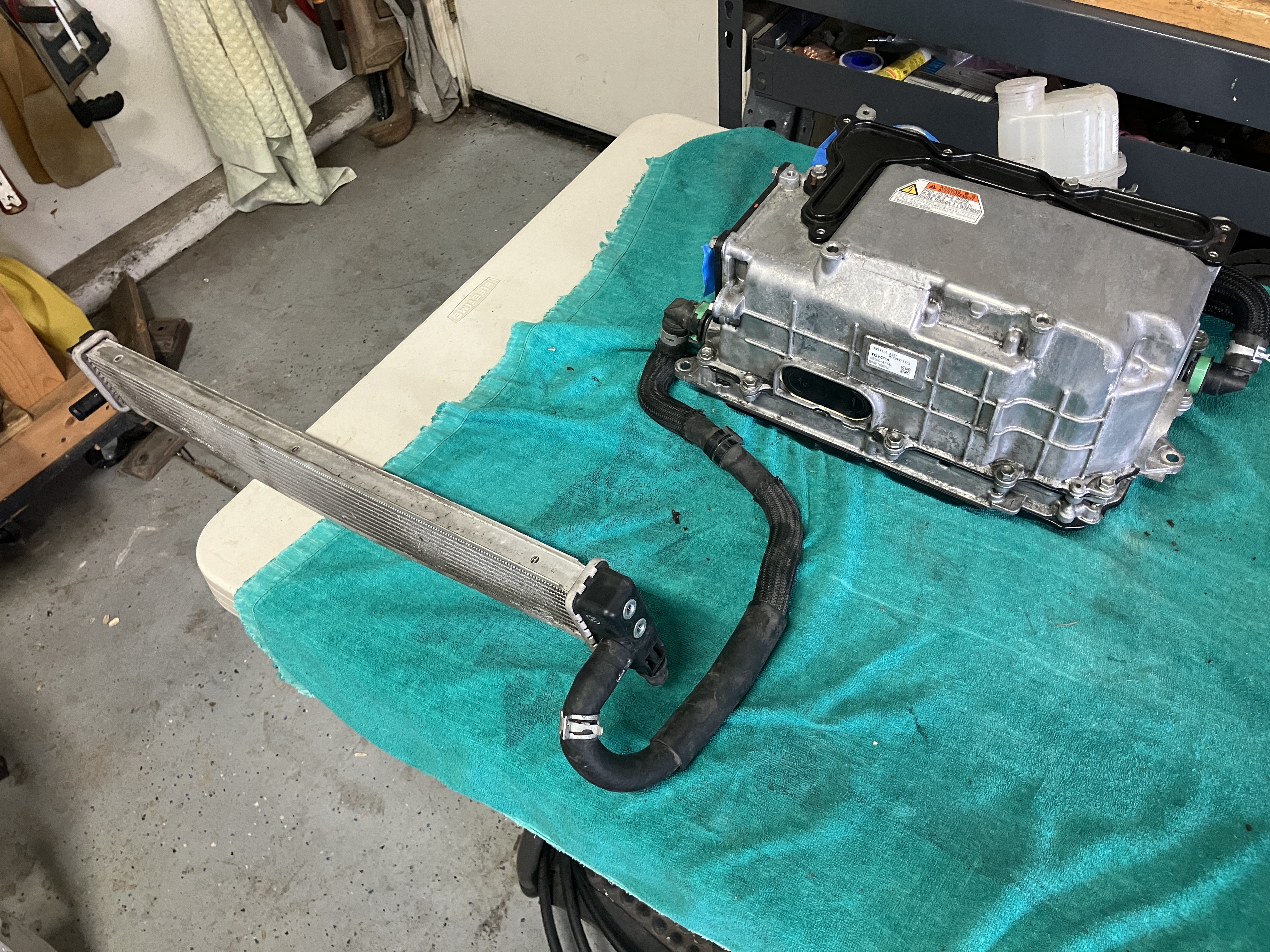

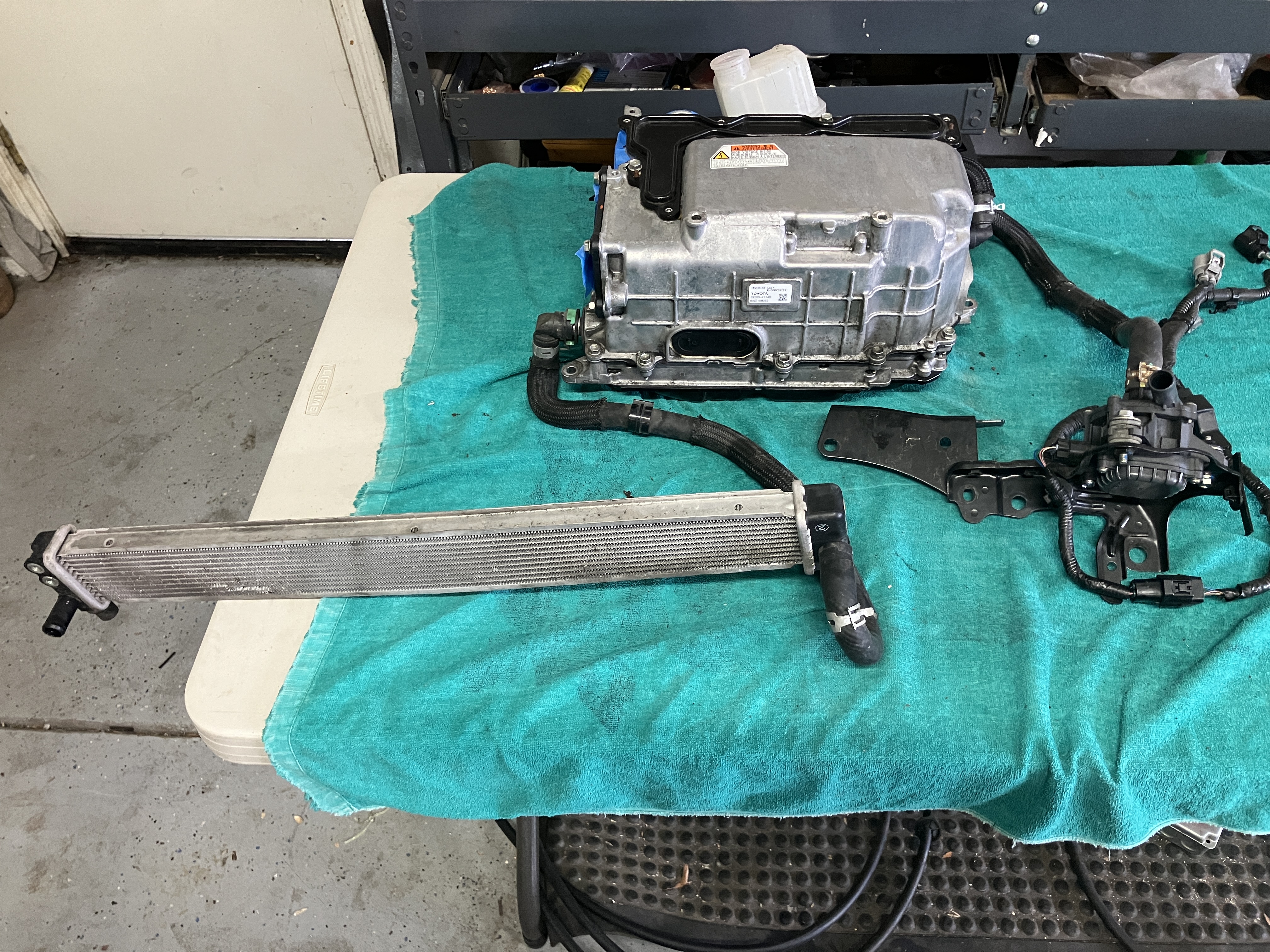

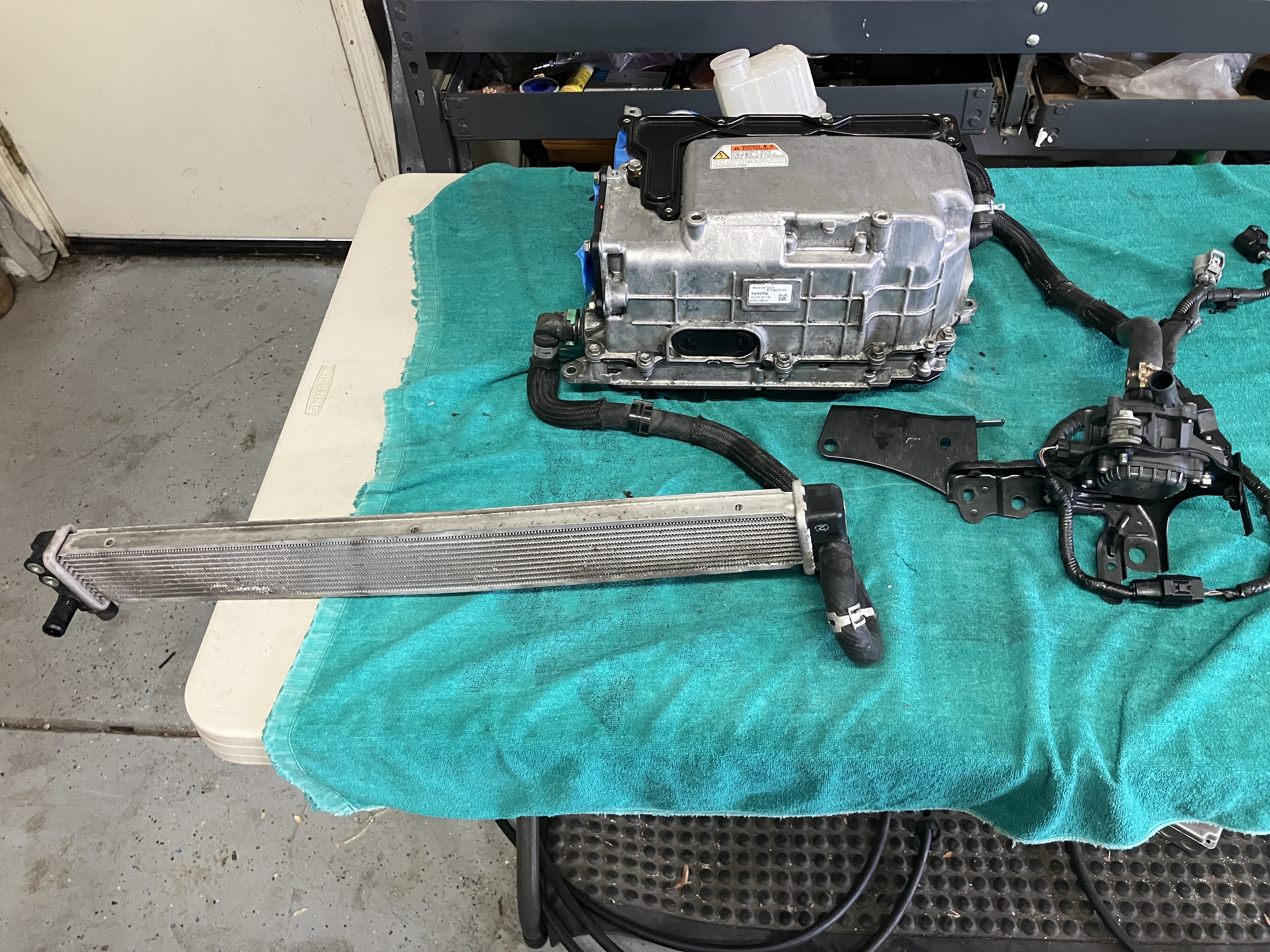

here I am attempting to piece together my Toyota Prius Gen 3 hybrid components cooling system, I believe all I am missing is just the one long radiator hose that runs to the top port on the transmission

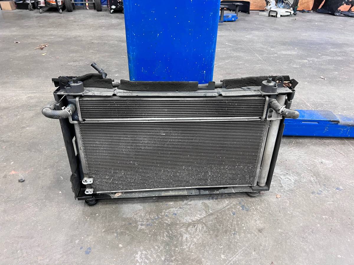

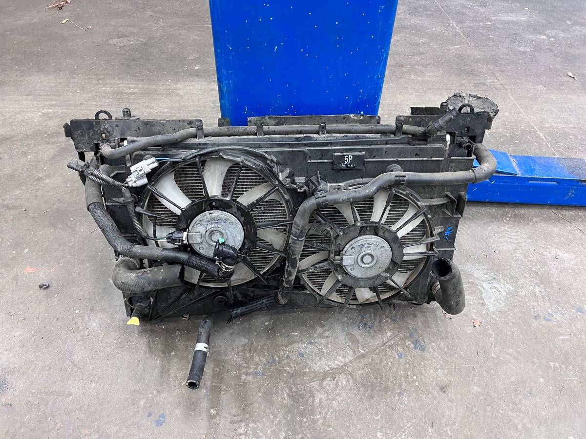

here's what the baby radiator and it's two hoses look like on the car

don't sweat it, what I ended up doin' is flipping the 2x4 skinny radiator around with the hose inlets pointing towards the car rather than away from it, that eliminates the need for the U hose ends, I then used one of the U hose ends on my charger below the rear seat to run a long hose from the water pump to it and then another U end on the front of the transmission to run the hose back from the charger to it, confused? good!

Yes, it's all on one loop. I think it goes coolant reservoir to water pump to charger to transmission to radiator to inverter and back to reservoir, absolutely no logic in that except took that path of least resistance, if I sense some components are running more hotter than others I will fandangle with it then
keep in mind pumps like the PUSH and not PULL fluid, and never, ever, never run them dry
