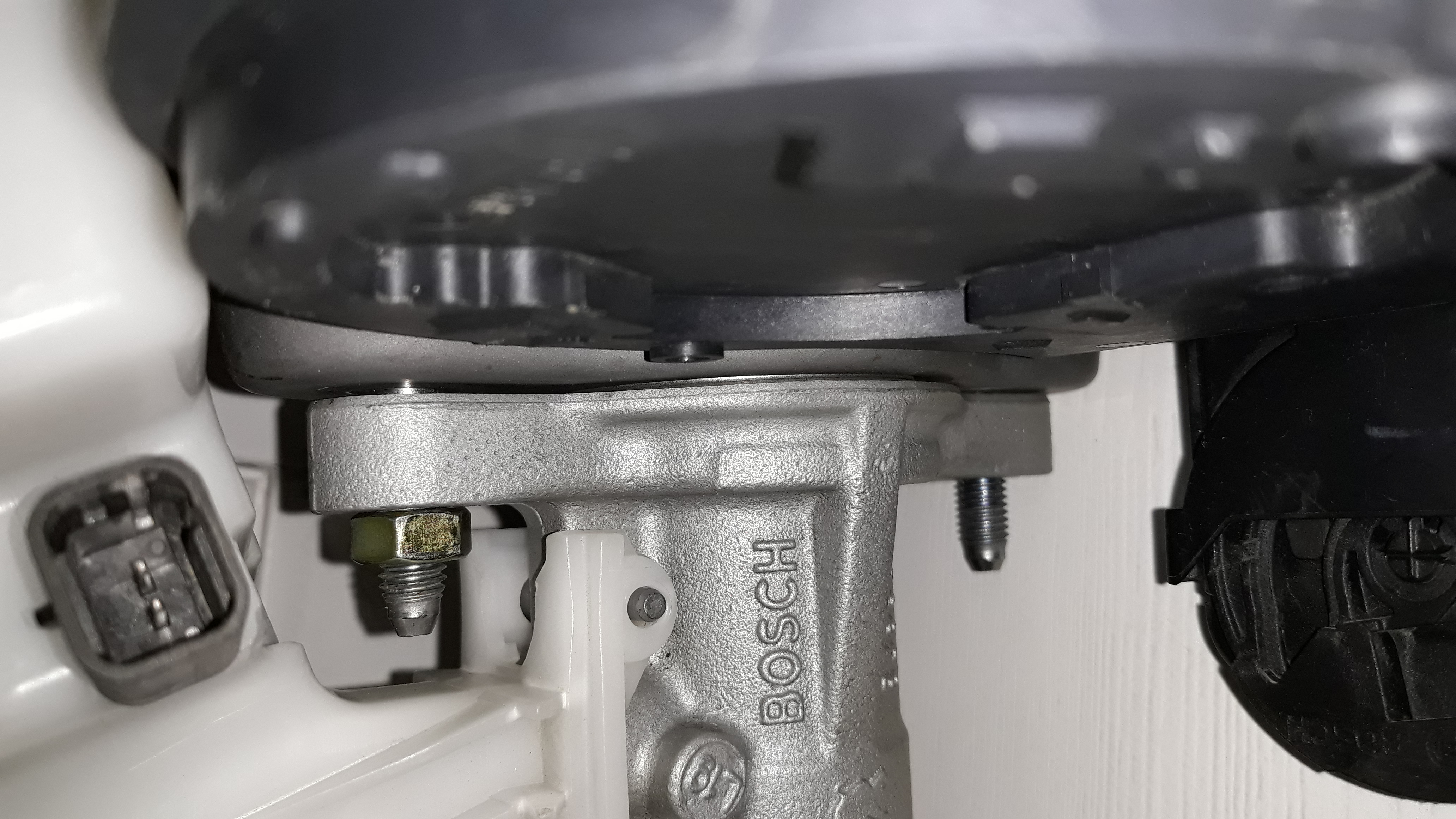

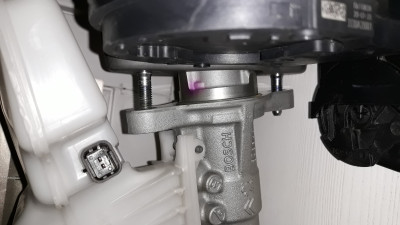

Today I discovered that the master cylinder is preloaded about 1 mm by default without any power being applied to the ibooster. So it means that preloading the push rod isn't a bad idea. It has a little free play which is needed for the calibration of the travel sensor.

AMP3R wrote: Sun Jan 07, 2024 7:59 pmToday I discovered that the master cylinder is preloaded about 1 mm by default without any power being applied to the ibooster. So it means that preloading the push rod isn't a bad idea. It has a little free play which is needed for the calibration of the travel sensor.
That would be excellent info to add to the wiki.

Is this a part of the code in the booster, a recommended mechanical spec, or an error?
You have to be careful preloading a brake master cylinder. At some travel point it blocks the port to the brake fluid reservoir. This means as the brakes / fluid heat up the system builds pressure when there should be none and the brakes drag.
Bosch making the ibooster and the brake master cylinder means they know exactly what their tolerances are and how much they can safely preload the brake master cylinder. Adding more to this might put it past the reservoir port.

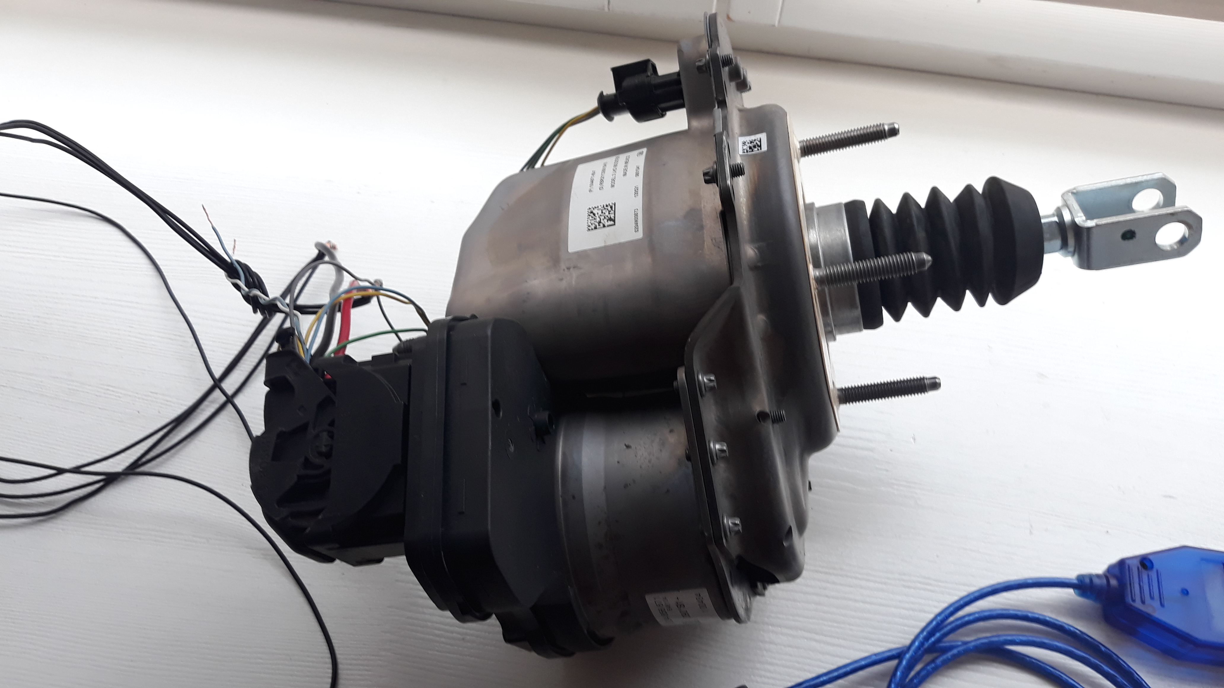

I was tired of struggling with PSA software and, in order not to suffer, I bought another iBooster from the 2022 Tesla M3. I plugged it in and there was complete silence! No clicking every 5 seconds! And as a bonus I got the opportunity to do an adaptive cruise if desired. At PSA this is still done by the ESP.
In short, this topic is no longer relevant to me. I’ll assemble one ibooster from the two and it can be screwed onto the car.

I know the reason. The clicking every 10 sec because the ibooster is trying to set the push rod to the zero position. For some reason it fails and tries again and again. The PSA technical documentation says that ibooster needs to be adapted via a diag tool. I don’t know how to make it without a whole car.
I struggled with PSA CAN for several months, then assembled one ibooster out of two, screwing in a controller from a Tesla.
