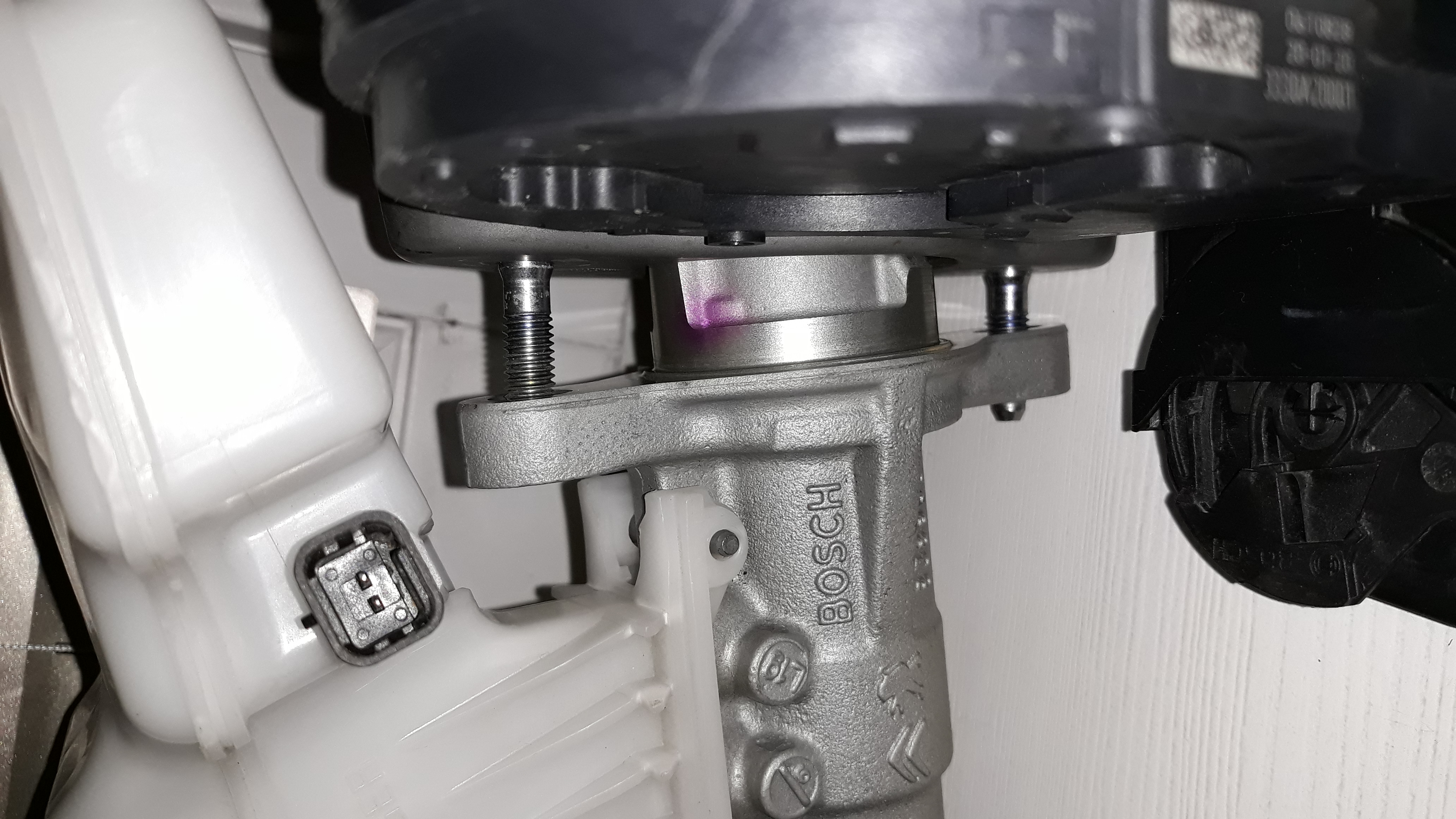

Today I discovered that the master cylinder is preloaded about 1 mm by default without any power being applied to the ibooster. So it means that preloading the push rod isn't a bad idea. It has a little free play which is needed for the calibration of the travel sensor.
Posts: 1017
Has thanked: 403 times
Been thanked: 260 times
Re: I bought a Citroen ibooster GEN2 and have some questions
Post by MattsAwesomeStuff »
AMP3R wrote: Sun Jan 07, 2024 7:59 pmToday I discovered that the master cylinder is preloaded about 1 mm by default without any power being applied to the ibooster. So it means that preloading the push rod isn't a bad idea. It has a little free play which is needed for the calibration of the travel sensor.
That would be excellent info to add to the wiki.

woutvanschaik
Posts: 9
Joined: Sat Jul 22, 2023 6:19 pm
Post by woutvanschaik »
tom91 wrote: Fri Dec 15, 2023 11:43 am What have you wired up, please show us? did you wire the 4 pin position sensor?
eventually got it working. seems that the wiring of the toyota is a bit different. it also has a different connector compared to other gen2 iboosters. the wiring should be the same as other gen2 iboosters, except the sensor. sensor should be wired as follows:
main connector pin 2 --> position sensor pin 3
main connector pin 8 --> position sensor pin 1
main connector pin 22 --> position sensor pin 4
main connector pin 23 --> position sensor pin 2

I was tired of struggling with PSA software and, in order not to suffer, I bought another iBooster from the 2022 Tesla M3. I plugged it in and there was complete silence! No clicking every 5 seconds! And as a bonus I got the opportunity to do an adaptive cruise if desired.
In short, this topic is no longer relevant to me. I’ll assemble one ibooster from the two and it can be screwed onto the car.

got the citroen iBooster working by using the CAN pins 10 and 18. I now get a clicking sound about every ten seconds. does anyone know if there needs to be any message transmitted on CAN to prevent this clicking? also, is anyone quite sure about what the clicking sound is?
Converting a E21 to Tesla SDU
AMP3R
Posts: 120
Been thanked: 53 times
Post by AMP3R »
woutvanschaik wrote: Mon May 27, 2024 6:11 am got the citroen iBooster working by using the CAN pins 10 and 18. I now get a clicking sound about every ten seconds. does anyone know if there needs to be any message transmitted on CAN to prevent this clicking? also, is anyone quite sure about what the clicking sound is?
Read the whole topic and you will understand that there is no point in suffering with a Citroen ibooster.

The clicking every 10 sec because the ibooster is trying to set the push rod to the zero position. For some reason it fails and tries again and again. The PSA technical documentation says that ibooster needs to be adapted via a diag tool.
