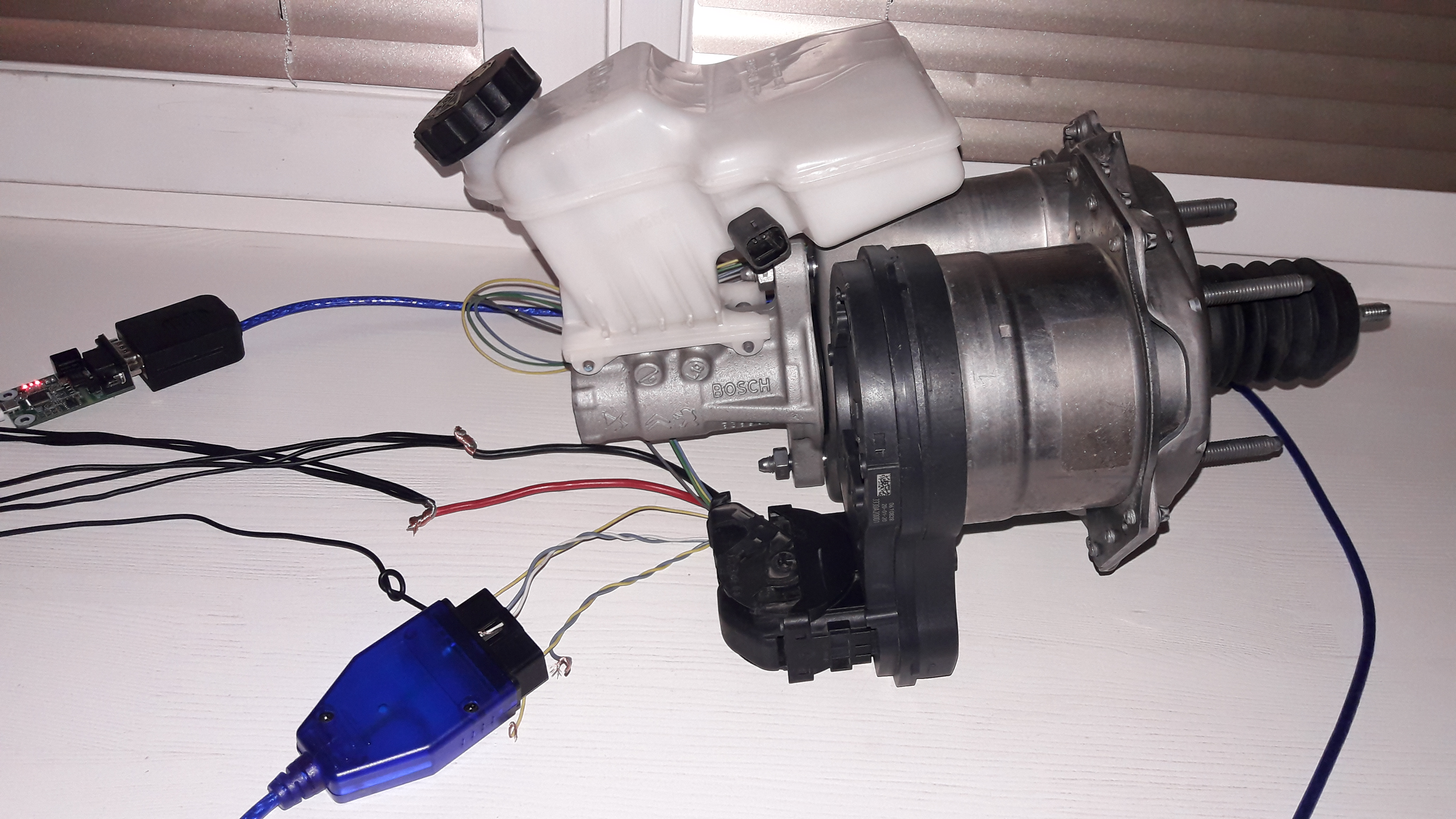

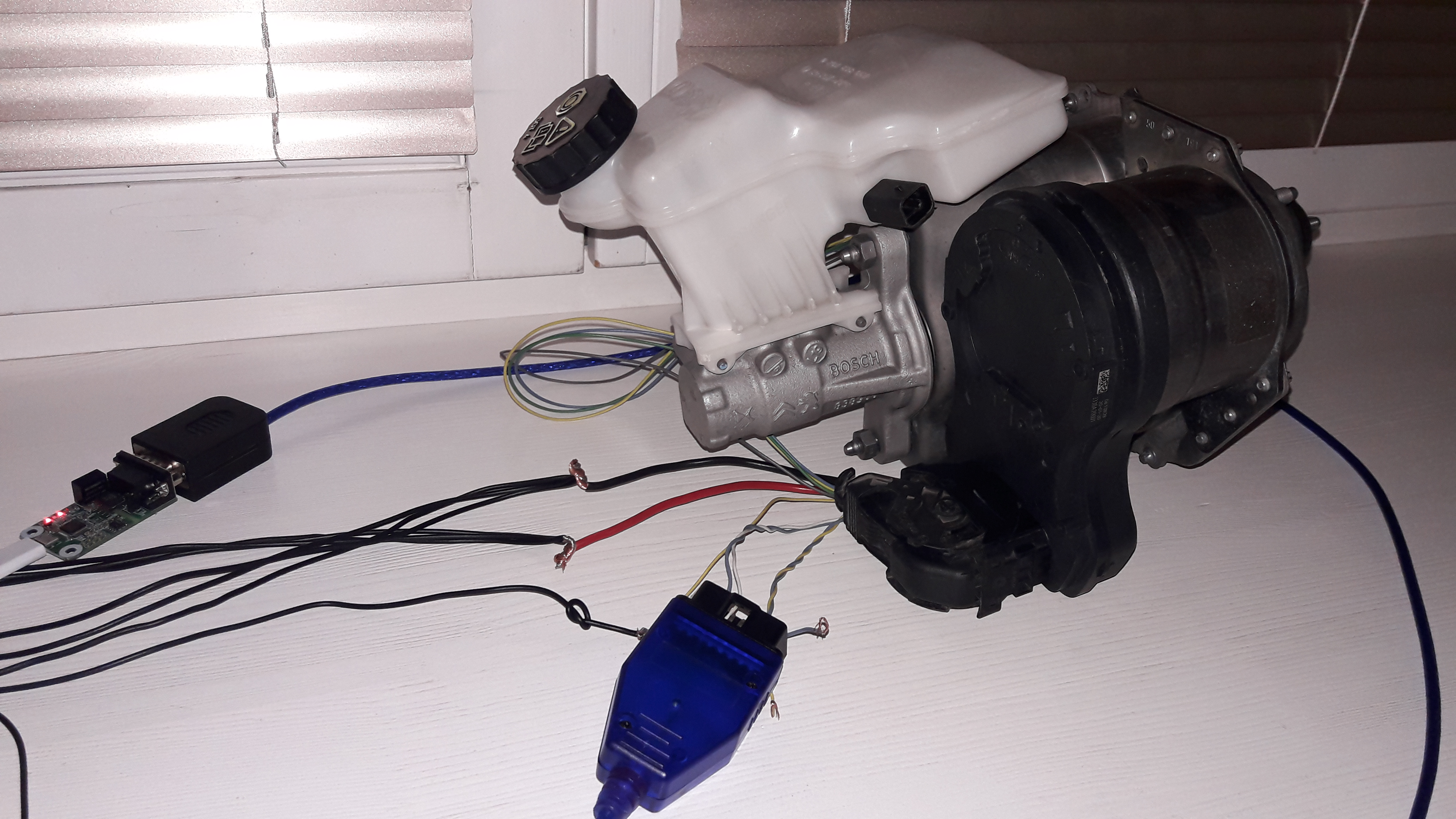

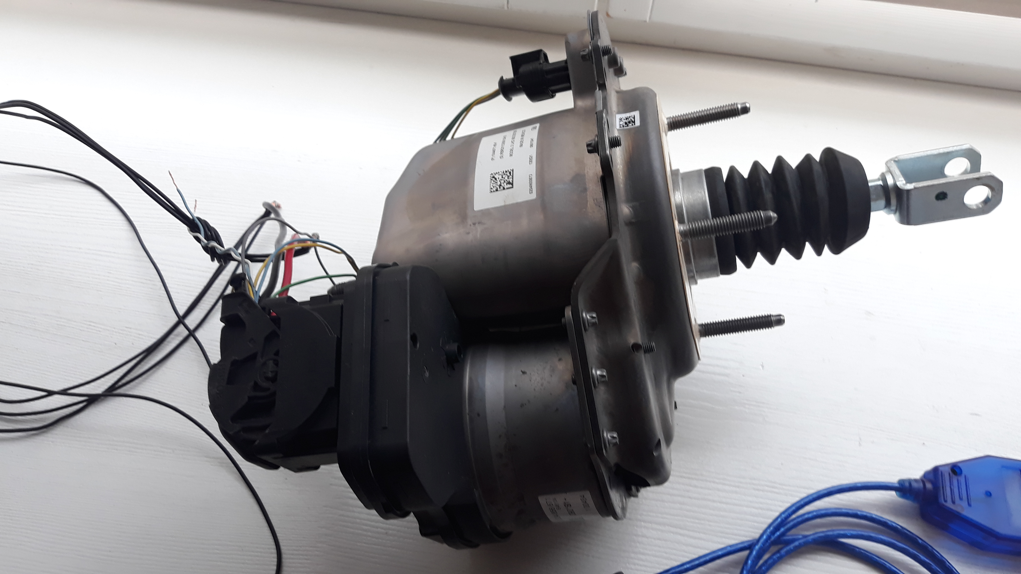

Hello. I have wired ibooster properly without any problems using ev create article https://www.evcreate.com/wiring-the-tesla-ibooster/

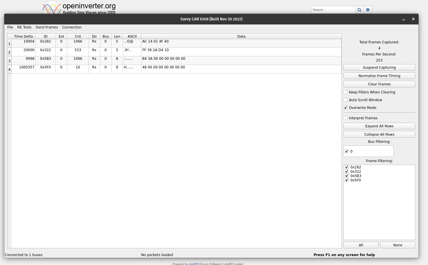

It works fine, makes assist but! When I do nothing motor tries to make a little spin every 10-15 seconds. What is that? Does it need a canbus to operate in fail safe mode?
Here is what ibooster is sending to me.

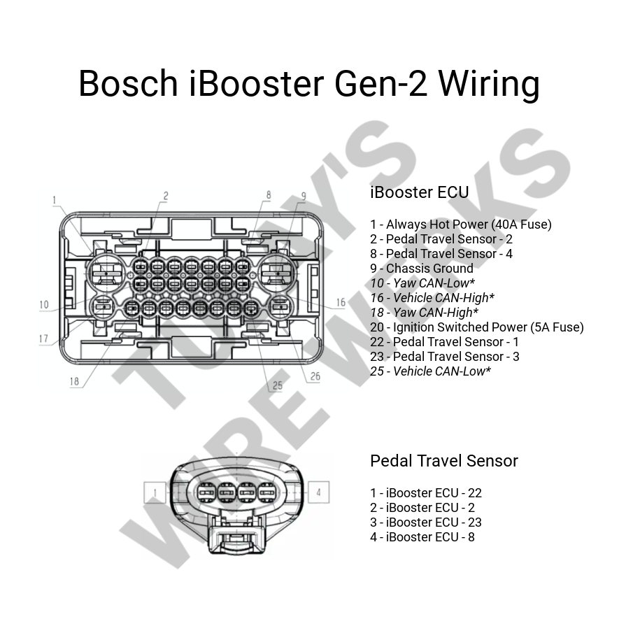

If you provide a pulse to the "ignition 12V in" it should "unlock" the shaft and provide assistance.
viewtopic.php?p=51532#p51532
The Gen2 Iboost I have from a Renault Zoe does the same thing. So I would suspect it looking for a Vehicle Ignition state to be broadcast over the canbus. It would be good to get a log of a Renault/Citroen with a Gen2 iBooster for review.

It would be nice to play with a can log. But where can I get it? Such hybrids are rare.

So I just done a bench test on this.
using the info below, the YAW CAN needs to have a receiver on it and be terminated.
Ignition can be switched on with you CAN receiver device and then switch off ignition and you can receiver to put it back to sleep.

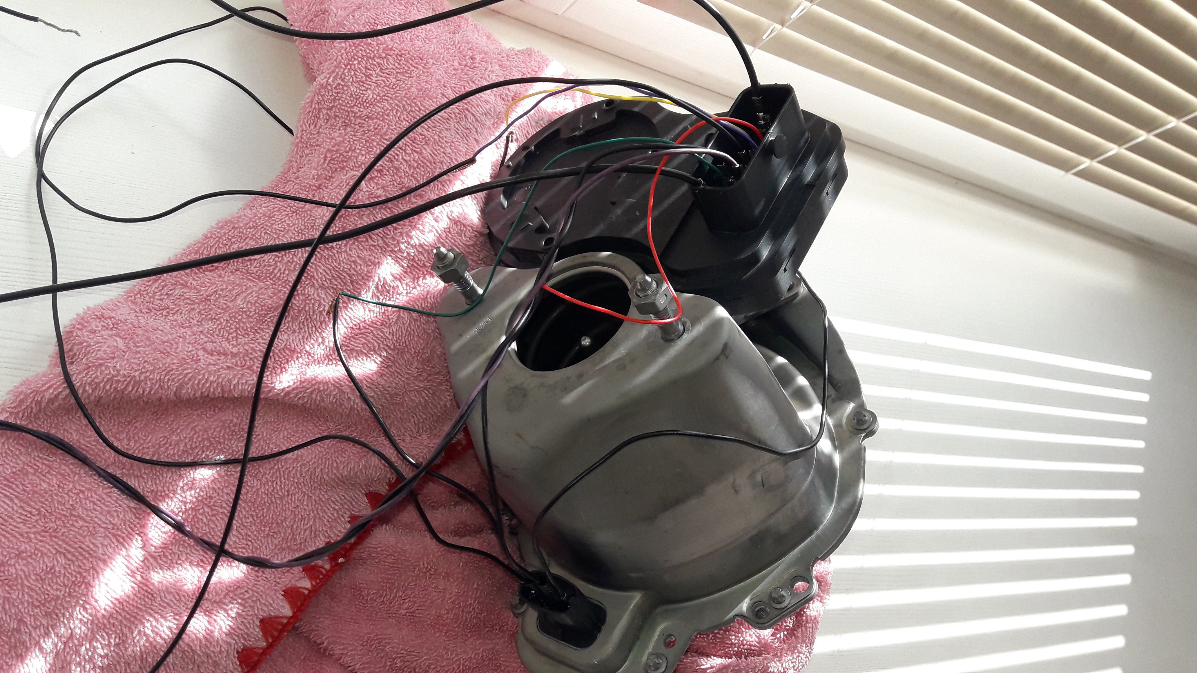

With oem plugs looks better. Still searching for can bus trace of any PSA hybrid :)

AMP3R wrote: Thu Dec 21, 2023 6:19 pm With oem plugs looks better. Still searching for can bus trace of any PSA hybrid :)
Which car is this from an Citroen Hybrid? How is it behaving?
The Renault one just needs a can transceiver on the YAW can, I just used an Arduino Due doing GVRET and savvy CAN for bench testing.

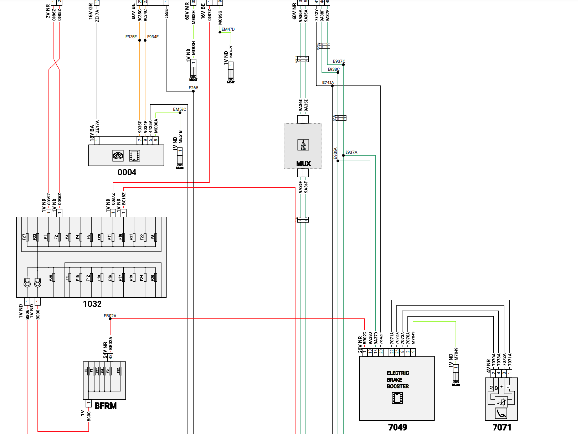

Here is wiring diagram. iboosters for peugeot/citroen does not have dual can.

Re: I bought a Citroen ibooster GEN2 and have some questions
Does the Ibooster "unlock" when you give it 12V ignition Pin 20? As in you hear it move the motor and it draws more current.
Does it transmit any CAN on the CAN bus at 500kbps? Ofcourse with it terminated at 2x120 ohm.

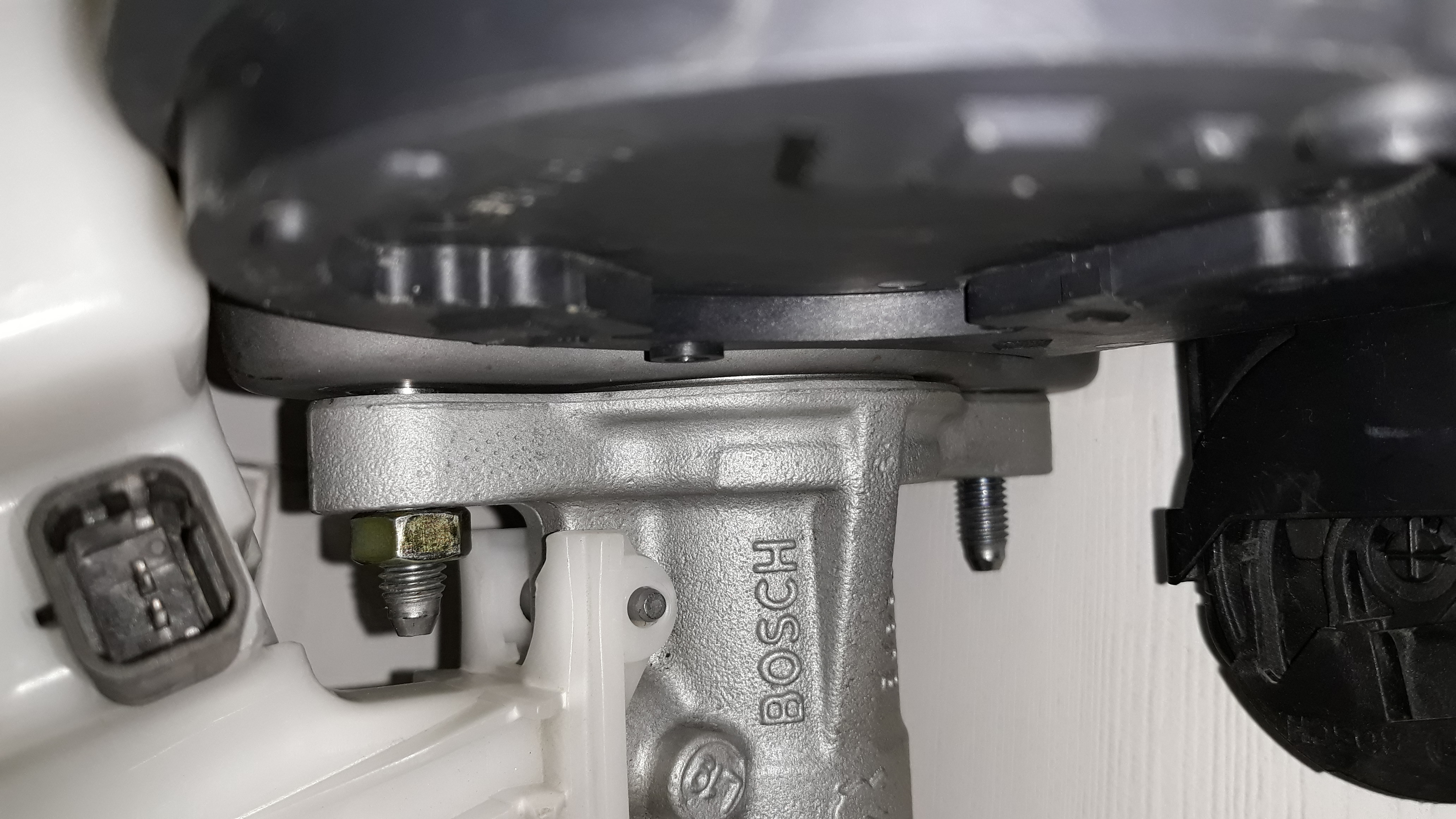

AMP3R wrote: Sun Sep 17, 2023 8:58 am When I do nothing motor tries to make a little spin every 10-15 seconds.
AMP3R wrote: Fri Dec 22, 2023 9:30 pm Makes assist and so on but every 10 sec shaft is moving a little (about 1-2 mm)
If the brake pedal position sensor is wired up it may do a check to see that the position sensor moves to check the position sensor or maybe calibrate itself. If the sensor output doesn't change when it's moving it can't calibrate or verify the sensor is good. So it may be repeatedly trying to calibrate or check the position sensor.

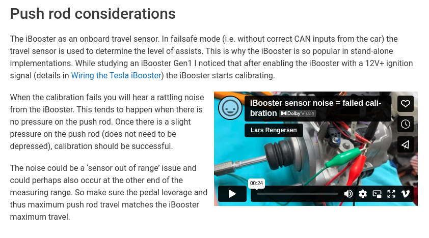

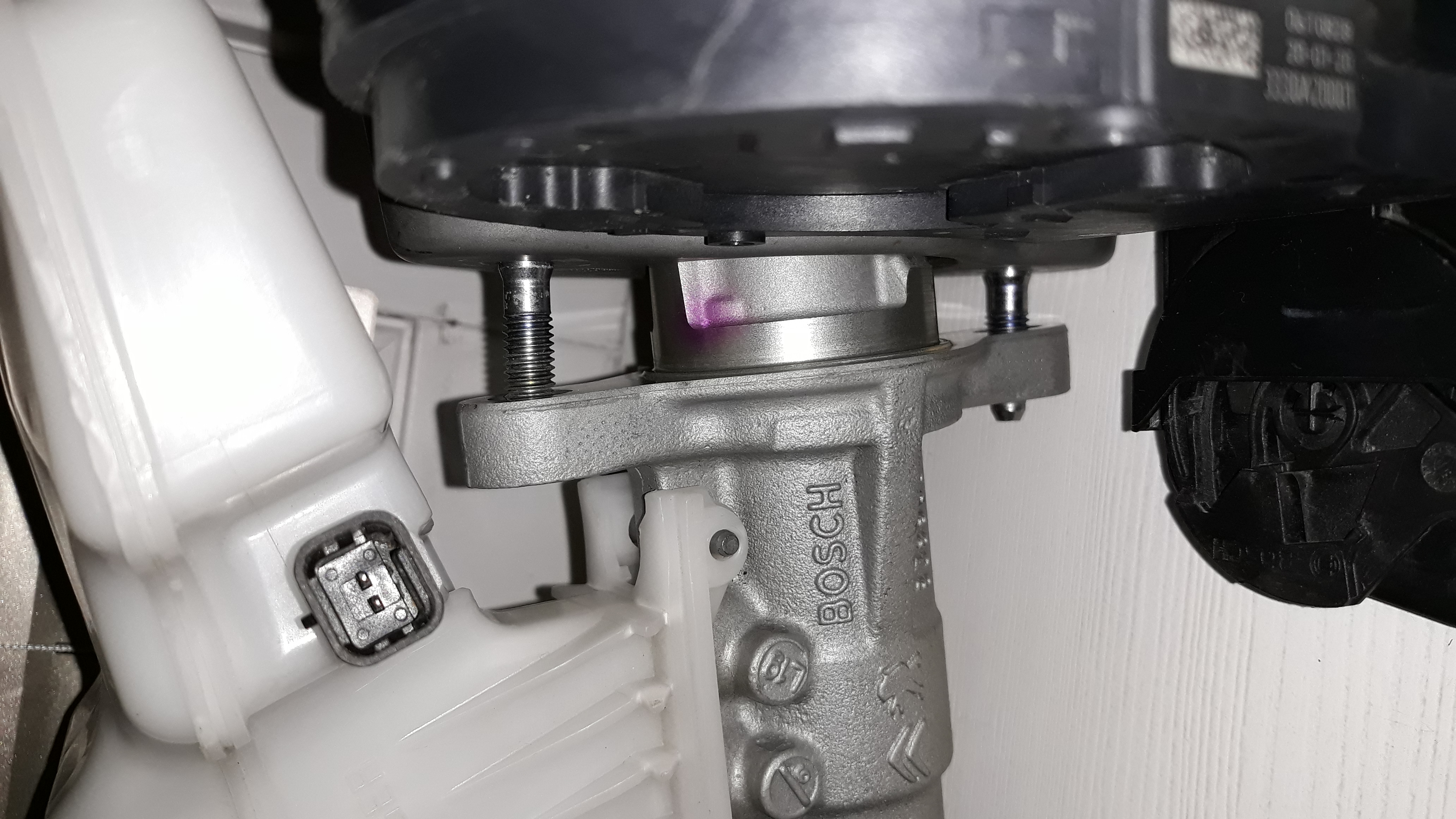

Today I tried to preload the push rod slightly by hand. And guess what? ibooster is not "clicking" now.  I don't know what exact position of rod is needed but I think I'm on the right way. Is it normal when the push rod is preloaded? Idk how it is on the donor vehicle.

AMP3R wrote: Sun Dec 24, 2023 3:00 pmIs it normal when the push rod is preloaded?
Yes!
I forget the amount, but yes. And adding that has fixed the problem for some.
There was some discussion about an "out of range" error, though I forget where that discussion took place. Oudevolvo (Lars, from EvCreates) has postulated this same error and the reason for it.
I recall there being some known amount of default displacement in the original setup (which may vary by vehicle).
Some early tests from me, doing the adjustment, showed that this might not be true. When I'd adjust, and then reset, I was still getting the shuddering at the same amount of pushrod push. Which made me perhaps conclude that on powerup, the iBooster calibrates where "start" is (wherever it currently is) and then from then forward it knows its range.
I also suspect the shuddering is actually just iBooster maxing out, and instead of killing the pump it rapidly turns the pump on and off trying to push that last little bit harder. I won't know if this is a relevant thing until I'm trying to stop my car at speed and notice whether this shuddering occurs well past wheel lockup (i.e. well past full brake pressure anyways).
On a different site of someone else who's reverse engineered the CAN protocol for the Tesla (only) iBoosters, he said when that happens you actually lose all braking pressure and so it's vital to not go out of range. I don't think that's true.
It's Christmas Eve here but bump this or bug me in the next few days and I'll see if I can go thread-hunting for you where this info might be relevant. At least the pushrod pushlength compression from stock is a number I'm sure someone has mentioned before.

MattsAwesomeStuff wrote: Mon Dec 25, 2023 2:51 am I also suspect the shuddering is actually just iBooster maxing out, and instead of killing the pump it rapidly turns the pump on and off trying to push that last little bit harder. I won't know if this is a relevant thing until I'm trying to stop my car at speed and notice whether this shuddering occurs well past wheel lockup (i.e. well past full brake pressure anyways).
If the ibooster is maxed out you can't push the brake pedal any further. If it's limiting brake master cylinder or pedal travel it's an obstruction and dangerous. You don't lose all braking, you lose further braking from the obstruction. Say the obstruction is after a medium braking push of the pedal but the obstruction is right after. When you try to do an emergency stop the obstruction his and you only get the medium braking level.
So 2 things to check, when adding an ibooster, make sure the booster travel and brake master cylinder travel are able to swing through the complete brake pedal travel.
You also need to ensure the stack isn't pushing on the brake master cylinder when the brake pedal is all the way up. Preloading the brake master cylinder means the fluid can't get back to the reservoir and it can build up pressure as the brakes / fluid warn up. This means dragging brakes immediately or after a bit of driving.
If you read Lars' explanation on his website, (scroll to Push Rod Considerations): https://www.evcreate.com/installing-the-ibooster/
"When the calibration fails you will hear a rattling noise from the iBooster. This tends to happen when there is no pressure on the push rod. Once there is a slight pressure on the push rod (does not need to be depressed), calibration should be successful."
So, I'm not sure how he's meaning "depressed". Fully depressed, or, does he mean, the pushrod doesn't even have to move, just have "pressure" on it?
In any case, seems like some pressure is a must:
"The noise could be a ‘sensor out of range’ issue and could perhaps also occur at the other end of the measuring range. So make sure the pedal leverage and thus maximum push rod travel matches the iBooster maximum travel."
Well, either your brake pedal maxes out before the iBooster, or after, so, you'll have to have one of the two cases occurring. Both can cause the iBooster to fail, perhaps.
I'm not sure.
Maybe that's what the vibrating/shuddering is. You plunge too far, the power cuts out and the pushrod retracts, but your foot is still on there, so it pushes back, but is too far again, so it retracts. Back and forth on the edge of the max depth travel, causing vibration.
