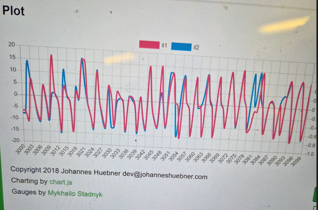

With above settings rotating shaft clockwise (facing the shaft) angle plot goes from low to high. Should it go from high to low, i.e. removing the SINCOS pinswap?
glink
Posts: 30
Joined: Mon Mar 15, 2021 7:02 pm
Re: Nissan Leaf Gen3 Drop-in board
Post by glink »
Tried both removing the SINCOS pinswap as well as negating the current sensor settings
"ocurlim": -100, "il1gain": -1.81, "il2gain": -1.81
No movement with syncofs=0 and manualid up to 12A on any settings, so maybe I have bricked something. Reports overcurrent. Have not tested with other pinswap settings. Also goes into overcurrent error when I manually turn the shaft a couple of turns. Have another inverter but do not risk it before finding out...
glink
Posts: 30
Post by glink »
Plot when in in manual mode with everything set to 0, that amplitude seems high to me, +-15 with no manualid. And il1 and il2 should not be in phase, should they?
