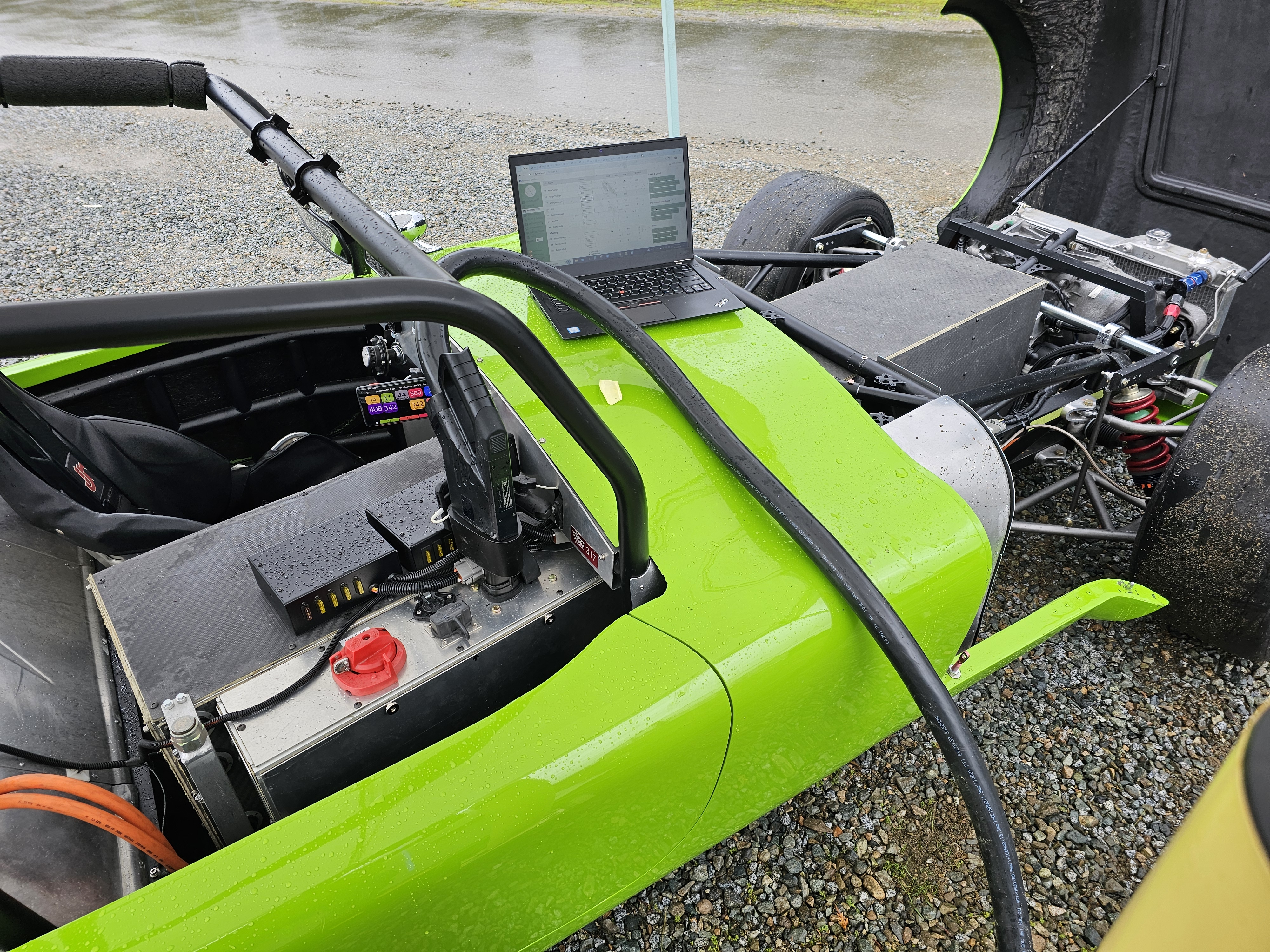

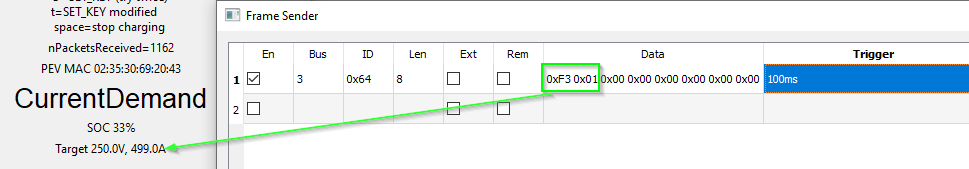

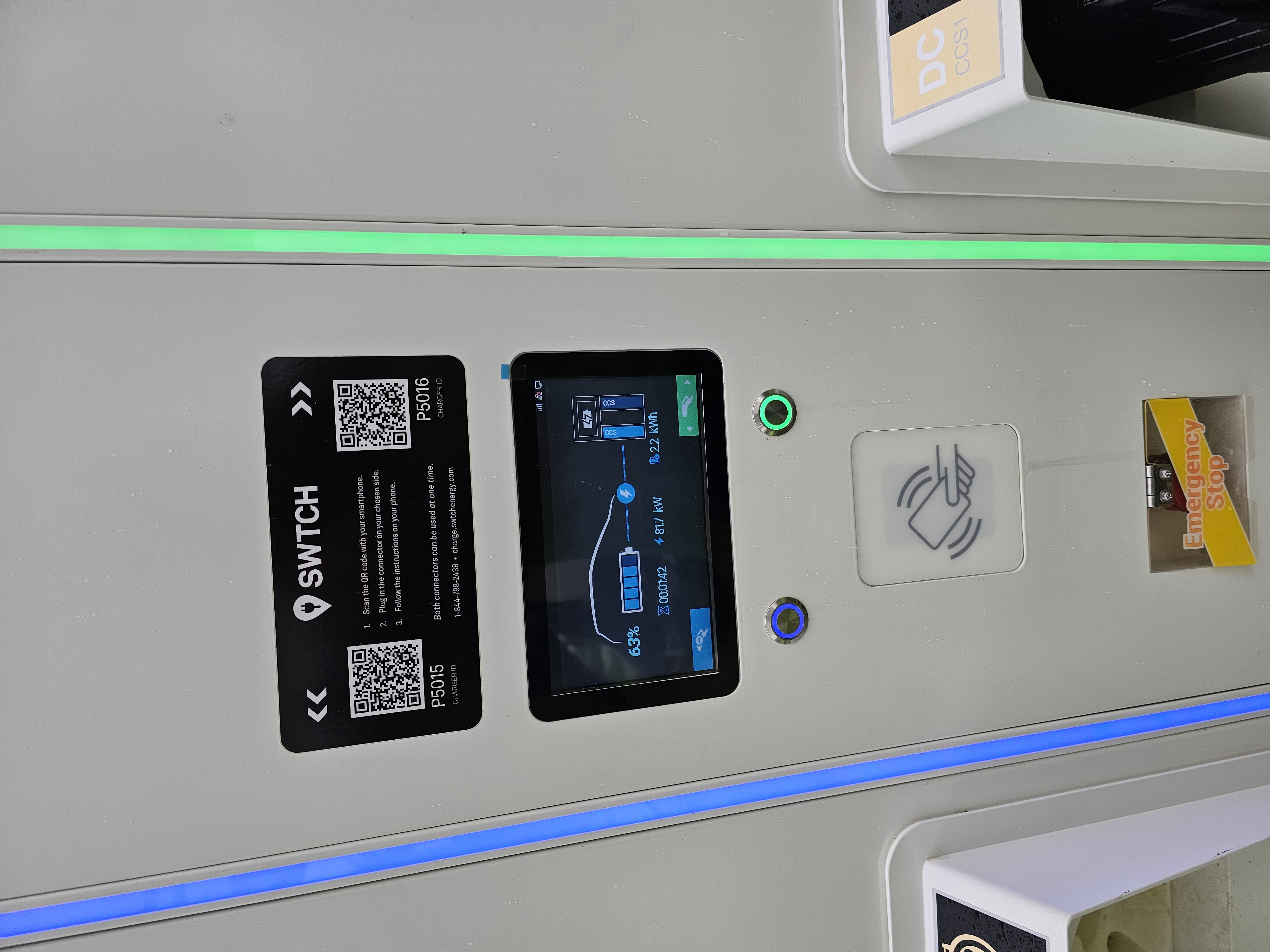

Success! Completed multiple test sessions today at 20, 40, and 80kW. Thanks to all for the help! What was the problem? CP & PP lines mixed up - oops! Interesting that there was still some communications over the CP line despite no direct connection.
1) We would have tried 120kw as well, but CAN variable "Charge Current" is only an 8 bit variable. It appears we can only specify up to 256 amps. I tried changing the CAN map to 16 bits without success.
2) It looks like actual EVSE Current = Commanded Charge Current at any SOC lower than 95% (see point 3 below). This means that most current ramping we see on OEM vehicles starting at 80% SOC is being implemented on the vehicle side.
3) It appears that SOC is not strictly for display (at least on the PhiPhong charger). It does enforce some safety monitoring. The charger faulted out and would not restart when we hit 95% SOC (number was incorrect, we were probably closer to 75%) with 80kW charge power. When the transmitted SOC number was changed to 75%, were able to re-start and continue at 80 kW.
For those of you interested, I will post a project update about the vehicle in the appropriate section once we have our 2024 Upgrades sorted out. As well as the CCS charging upgrades, we have stretched the car 10", and added a 2nd M3 drive unit to make the car AWD....

Regarding the "8 bit" for the ChargeCurrent: Cannot confirm this issue at the moment. Using SavvyCAN to transmit the value 499A (hex 01F3), and this shows up in the web interface:
Using this CAN mapping:
The path in the software from the parameter itself to the CCS structure uses at least int16, so should not limit. The limitation I found is the 500A in the parameter definition. Could you check which value shows up in the web interface, if you have on CAN a value between 256 and 500A?
[Edit] Also pyPLC shows the correct current up to 500A:
