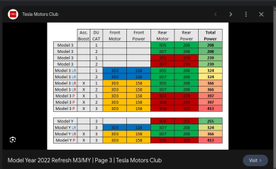

According to this table does it mean that 3D7 has a "full mosfet" inverter? Not like old 3D5 without 3 mosfets?

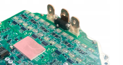

What are the chances that the pyrofuse didn't break 2 phases in the inverter of 3D7 motor whose rear mount was torn off?

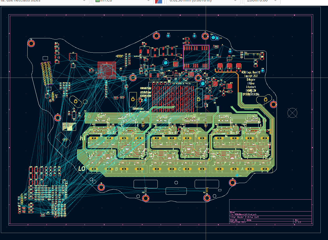

Sooo, some updates on the musk. I must admit I had let the replacement pcb project lag. Thankfully, Artur Kustusch came onboard and reverse engineered the ENTIRE gate driver section :o This has given me a big push to get back on the project and I've since reversed the gate driver psu and other peripherial circuits to the point now that I'm laying out the pcb with a view to ordering some bare boards before year end for fit testing. So yeah its been slow but its a BIG project :)
Attached latest schematic for those interested. Note that like the MG drive unit logic board this design utilised the 100 pin VCT6 variant of the STM32F103.
Also, where is practical, oem component designators and positions are used on the OI board. The OI board will be 4 layer, single sided SMD. And just for fun I get to learn kicad along the way.
Github repo : https://github.com/damienmaguire/Tesla- ... Drive-Unit
