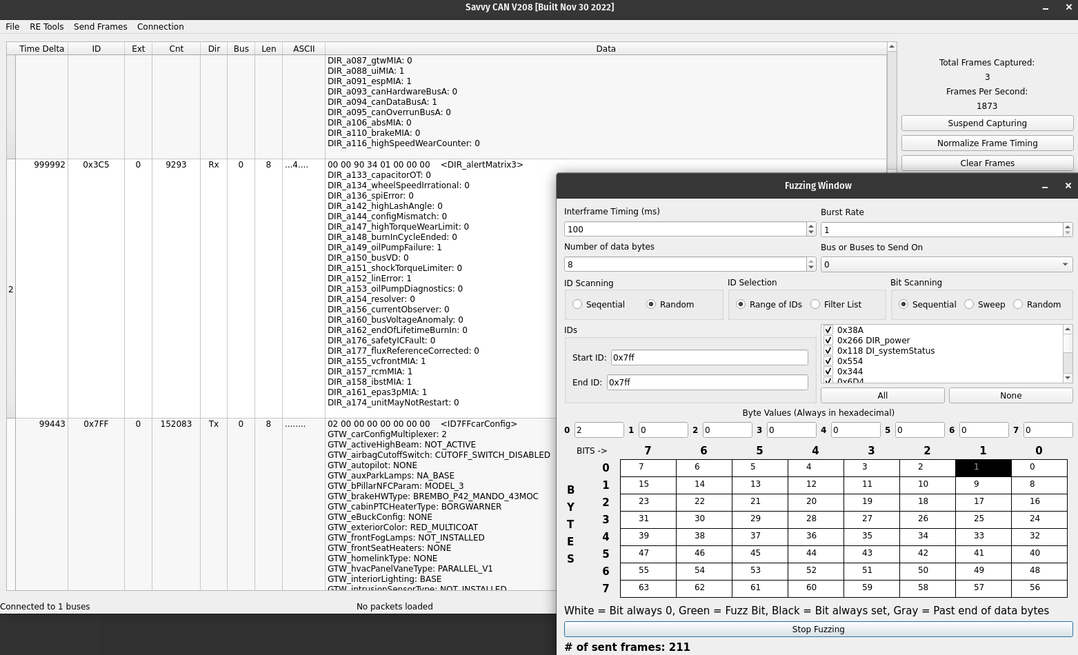

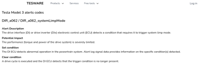

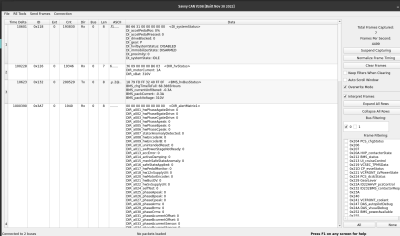

After playing with the motor for a while, I realized why the inverter doesn't switch into STANDBY mode.
Active errors: DIR_a144_configMismatch, DIR_a062_systemLimpMode, DIR_a092_bmsMIA.
Apparently, I will have to go to the junk yard where I bought my motor and record the logs from the MCU and BMS.

I noticed that DIR_a144_configMismatch is triggered by two messages 0×392 (info about battery) and 0×7FF (car config)
We can say that this is a fundamental error and because of it the motor will not spin.

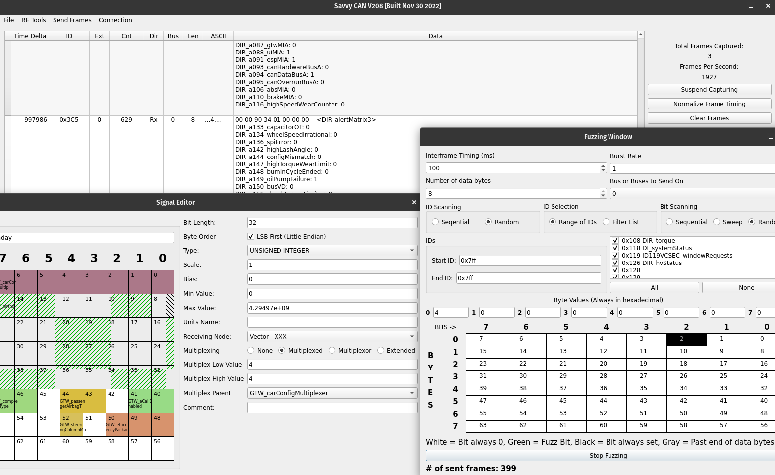

I figured out the 0×392 BMS_packConfig message, which triggers the DIR_a144_configMismatch error.
Just corrected the maximum voltage to 387 and the error disappeared.

The first frame from the multiplexed message 0×7FF about the car config is ready. It turned out that all bits can be empty except bit 56
The second frame can be completely empty.
The third needs information about GTW_perfomancePackage, GTW_chassisType and GTW_packEnergy. Everything else can be zero.
The fourth can be completely empty.
The fifth can be completely empty.
The sixth is also empty.
DIR_a144_configMismatch goodbye

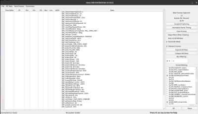

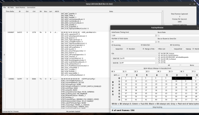

The main system errors have disappeared, but the inverter does not switch to STANDBY mode yet. Any ideas?
davefiddes
Posts: 288
Has thanked: 69 times
Been thanked: 88 times
Post by davefiddes »
You look like you have a lot of happy systems there to my uneducated eyes. Have you got a capture of a working Tesla of a similar vintage to compared against?

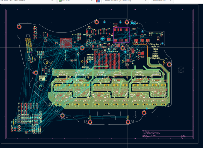

Sooo, some updates on the musk. I must admit I had let the replacement pcb project lag. Thankfully, Artur Kustusch came onboard and reverse engineered the ENTIRE gate driver section :o This has given me a big push to get back on the project and I've since reversed the gate driver psu and other peripherial circuits to the point now that I'm laying out the pcb with a view to ordering some bare boards before year end for fit testing. So yeah its been slow but its a BIG project :)
Attached latest schematic for those interested. Note that like the MG drive unit logic board this design utilised the 100 pin VCT6 variant of the STM32F103.
Also, where is practical, oem component designators and positions are used on the OI board. The OI board will be 4 layer, single sided SMD. And just for fun I get to learn kicad along the way.
Github repo : https://github.com/damienmaguire/Tesla- ... Drive-Unit
Jeez, 5 years has flown:)

All parts placed.
