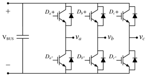

I get desat or overcurrent error before the motor even moves
This can point to a broken power stage. IGBTs usually fail shorted so it is quite easy to check with one measurement if one IGBT might have failed. As you can see in the image on the right the 3-phase bridge consists of 3 pairs of IGBTs. In parallel to each IGBT you see diodes and these are going to help us.
We put a multimeter in diode mode and stick the positive lead on + and the negative lead on -. Now we should see a slowly rising voltage. That is the multimeter charging bus capacitor with its test voltage. Once we reach around 2V the multimeter maxes out. If already here we see 0V it means at least one full pair (or leg) has failed shorted. That is rare.
Ok, now we reverse the test leads. The diodes are usually Schottky types, so each drops about 0.3V. Two in series drop 0.6V. If none of the IGBTs failed shorted we first see a negative voltage because the bus cap is still charged and then it should slowly climb to said 0.6V. Or maybe 1V. If it only climbs to 0.3V we know that at least one IGBT has failed shorted, bridging its parallel diode. Watch this video for a practical demonstration: https://youtu.be/ZvlzGm709zg
