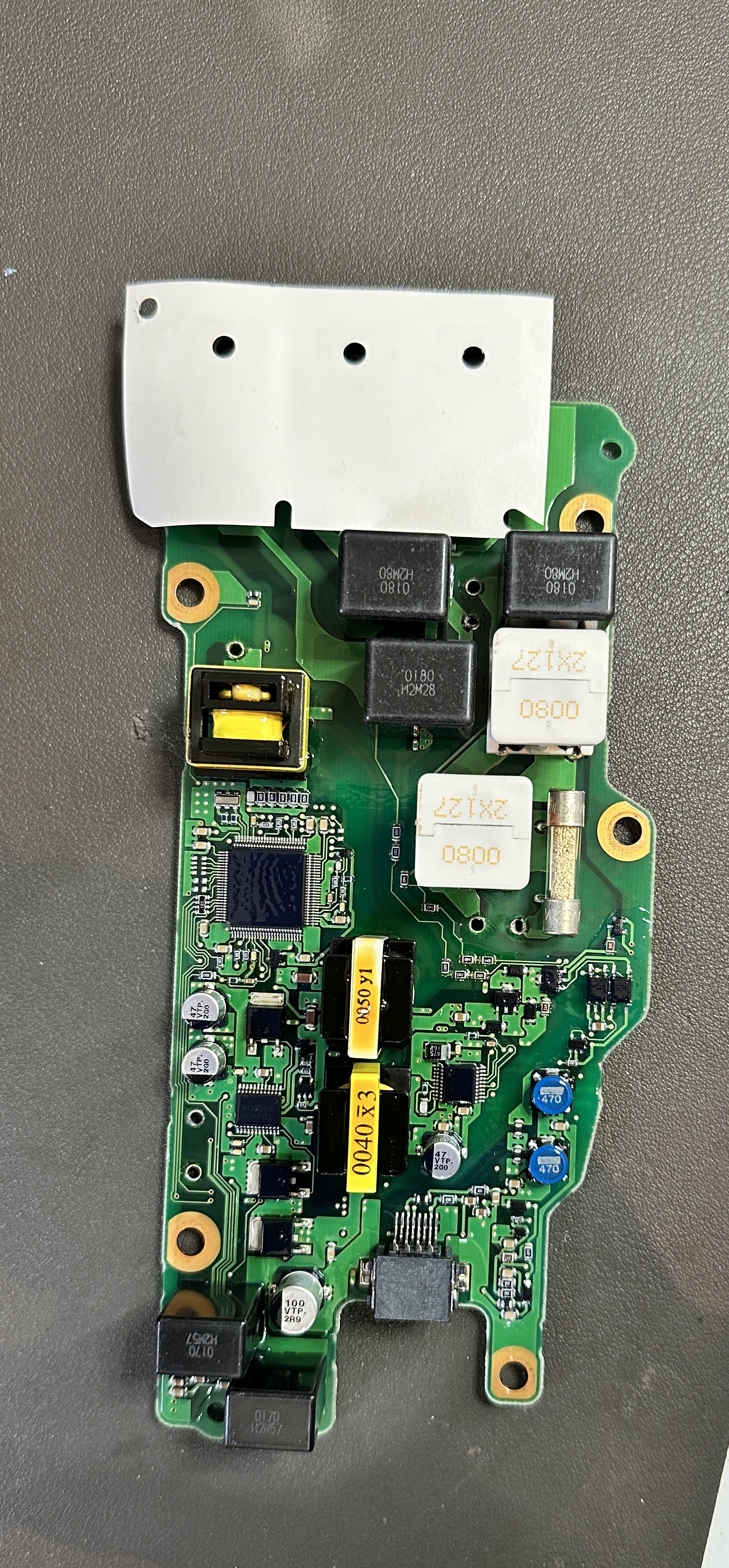

I managed to remove the DCDC converter motherboard from the G9200-33171 inverter
took a few pictures, thought i'd share the here i know nothing about reverse engineering... but i think red and white should be pulled to +12V to enable it
