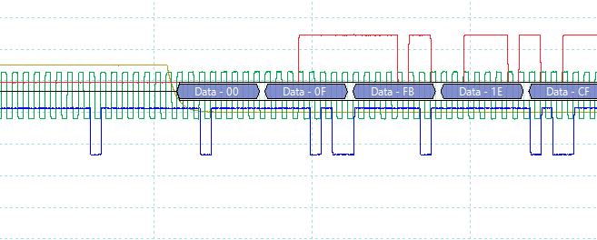

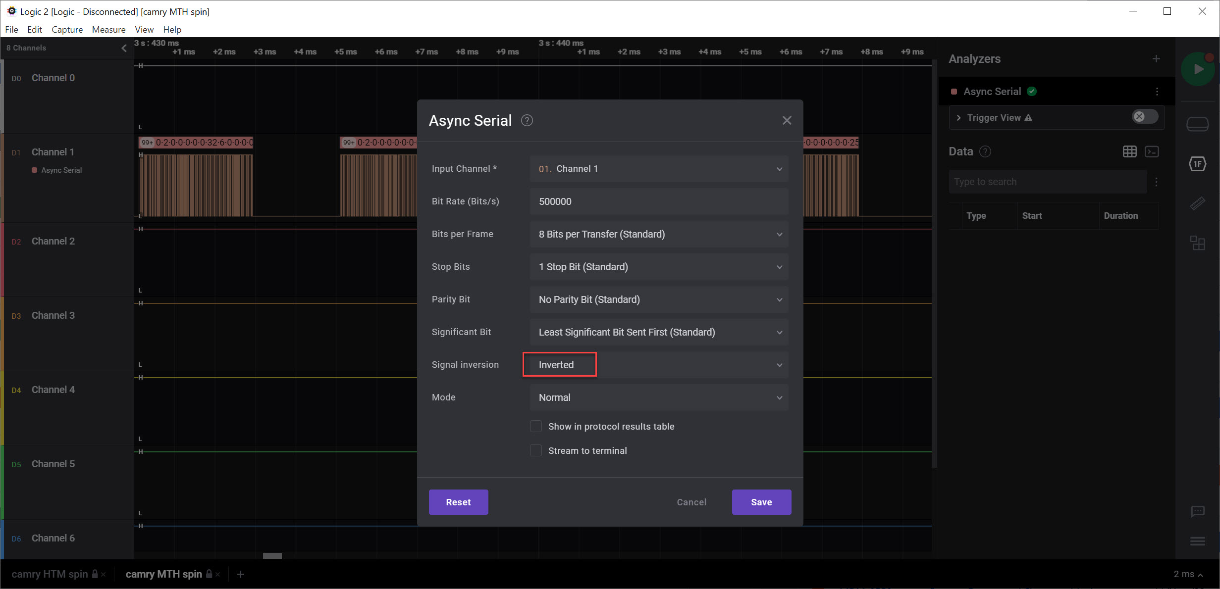

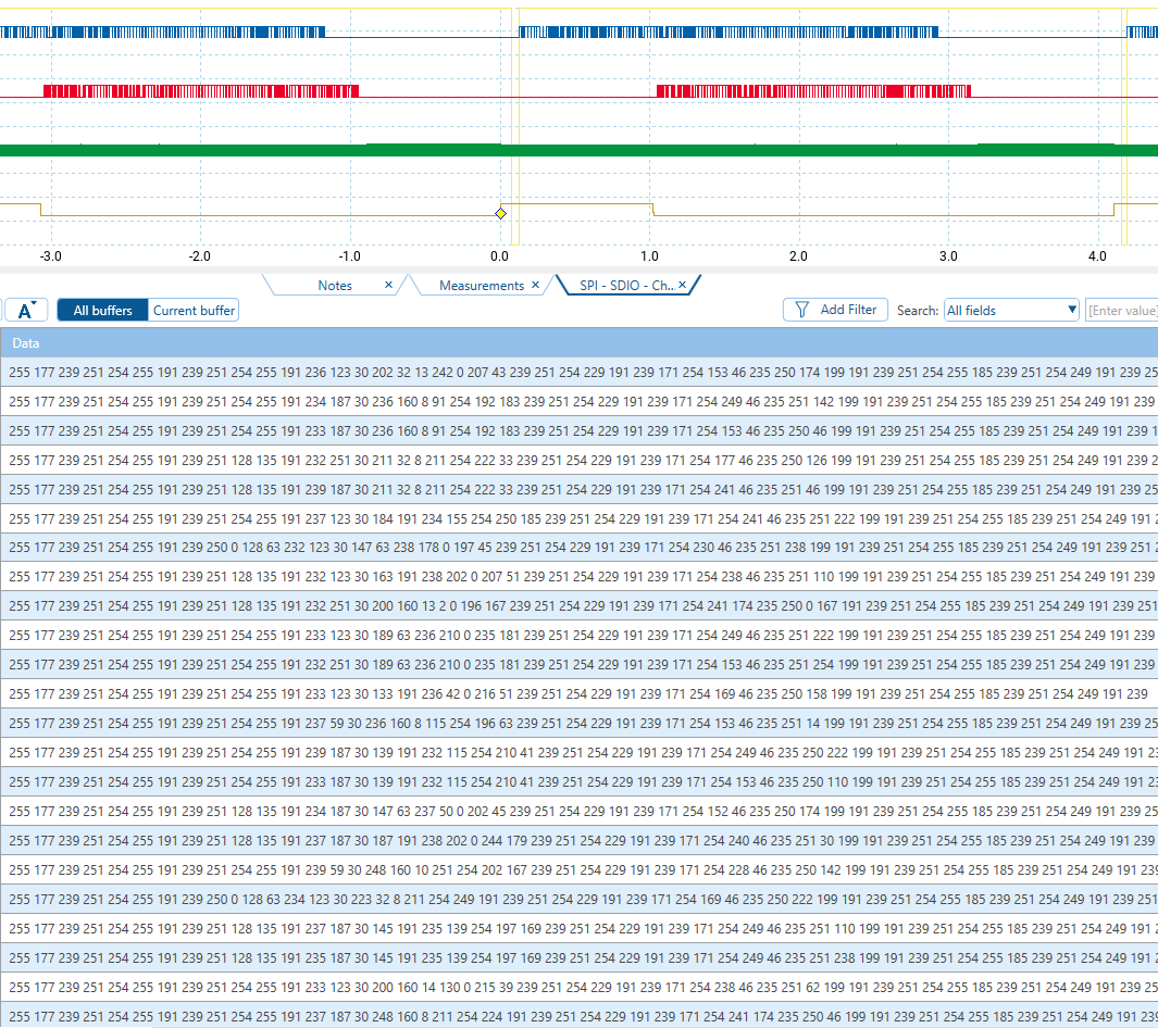

Ok, so here is the first waveform:
So:
green continuous clock pulse is: 499.8kHz; 2 volts peak to peak.
mustard colour chip select looking signal is: 244 Hz; 2 volts peak to peak
red and blue colour data lines are: volts peak to peak.
All signals have good square waveforms, except the chip select type signal which does not have a sharp rise and fall slope.
So I am confident I am measuring the right wires, and equipment used is faithfully reproducing what the car ECUs see.
I am using a PicoScope 4444 with PicoConnect 442 differential probes, so 1 probe is connected to the + and - of each signal, be that MTH, CLK, REQ, or HTM.
My conclusion is: don't need to open cover of inverter and connect to data lines, can use 4 sets of differential probes instead.

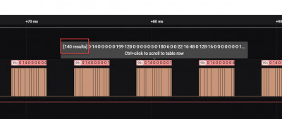

I am starting to get data now. The red serial stream starts at the same time each time, but the blue stream has a bit of jitter in the start signal. So I only have the red stream data to present so far. Not sure if motor serial or generator serial stream at moment. More later as I understand more.
Have taken oscillograms for no generator or motor action; generator action (charging battery) no motor; generator and motor forward (slow); generator and motor reverse (slow). But have to understand the data streams first...
Will eventually get oscillogram with varying inverter temp, voltages etc. And any suggestions.

So here are HTM waveforms for:
7: Generator Running, Forward Very slowly
6: Generator Running, Reverse Very slowly
5: Generator Running, No motor.
Working on getting rid of jitter effect in synchronising SPI data capture for MTH data strings.
Theses are preliminary results. (lots of numbers)

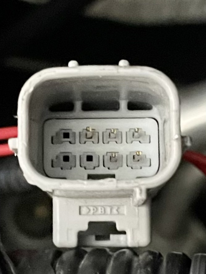

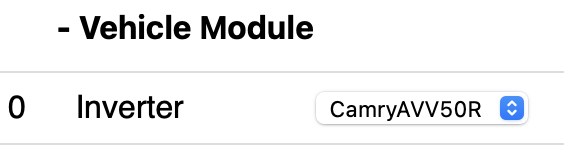

Good news. I made a rookie mistake - bad wiring on serial comms.
I can now spin the motors using the Camry inverter.

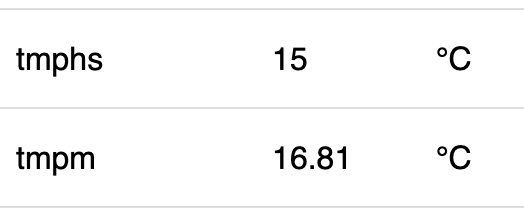

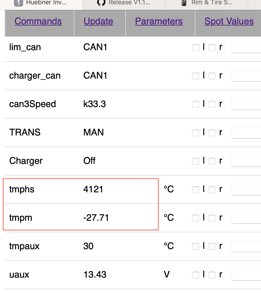

Initially got a HS temperature error as soon as I started the motors. (My motor temperatures are way off. Will have take a look at some point)
I cloned Damien's branch: git clone -b DM_Work https://github.com/damienmaguire/Stm32-vcu.git
From the data I captured it looks like the water temperature is only on column 20 so I changed the code to row 472:
temp_inv_water=mth_data[20];
I modified the GS300h profile to run the Camry inverter in this bin file:

Hi Zechy, I'm curious as to what was the problem with the serial wiring connection prior to finding the problem? (Asking so that I and possibly others can try not to make similar "rookie" errors in our connections). Cheers mateZechy wrote: ↑Fri Dec 30, 2022 6:08 am Good news. I made a rookie mistake - bad wiring on serial comms.
I modified the GS300h profile to run the Camry inverter in this bin file: stm32_vcu_AVV50R.bin

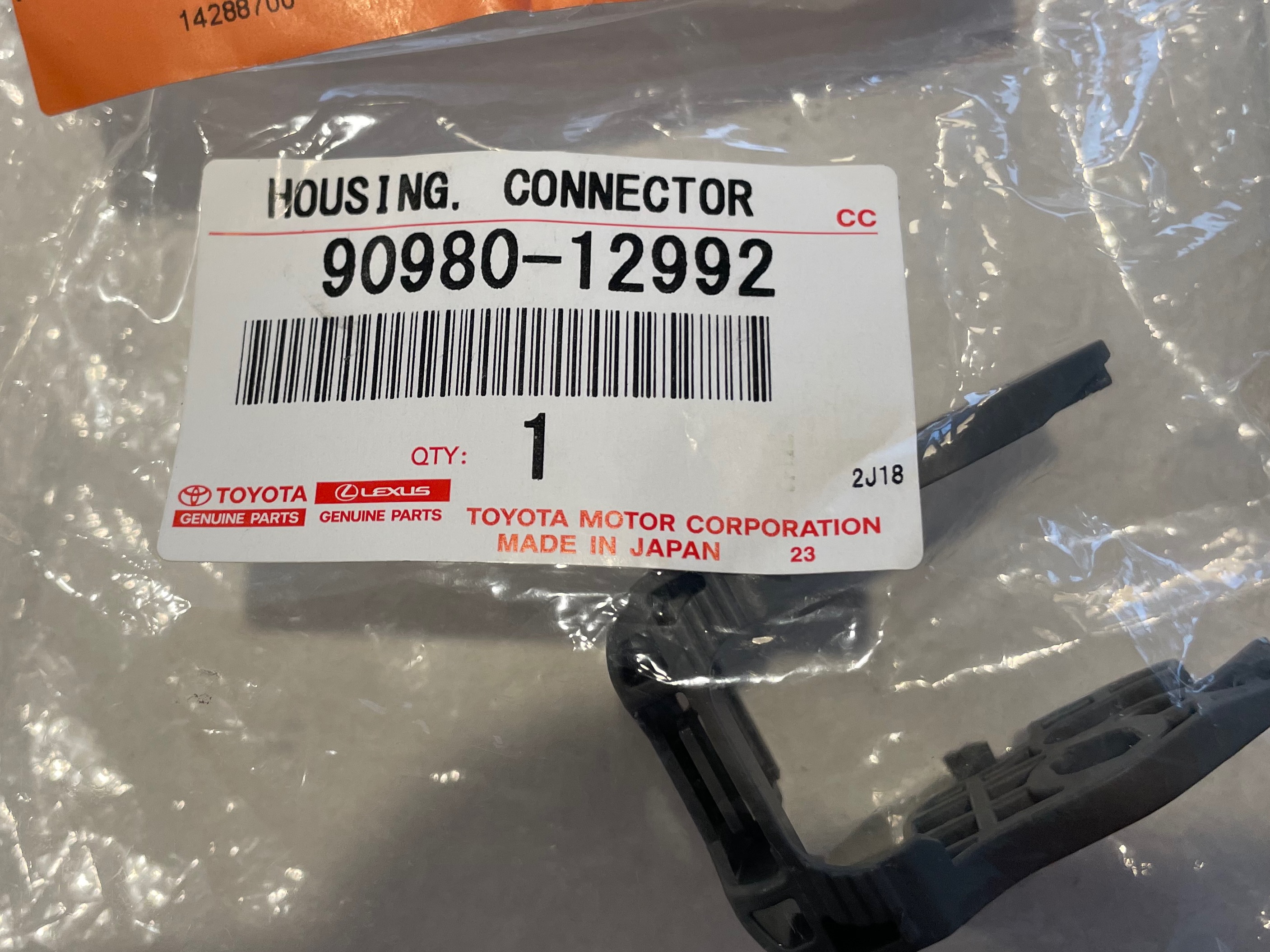

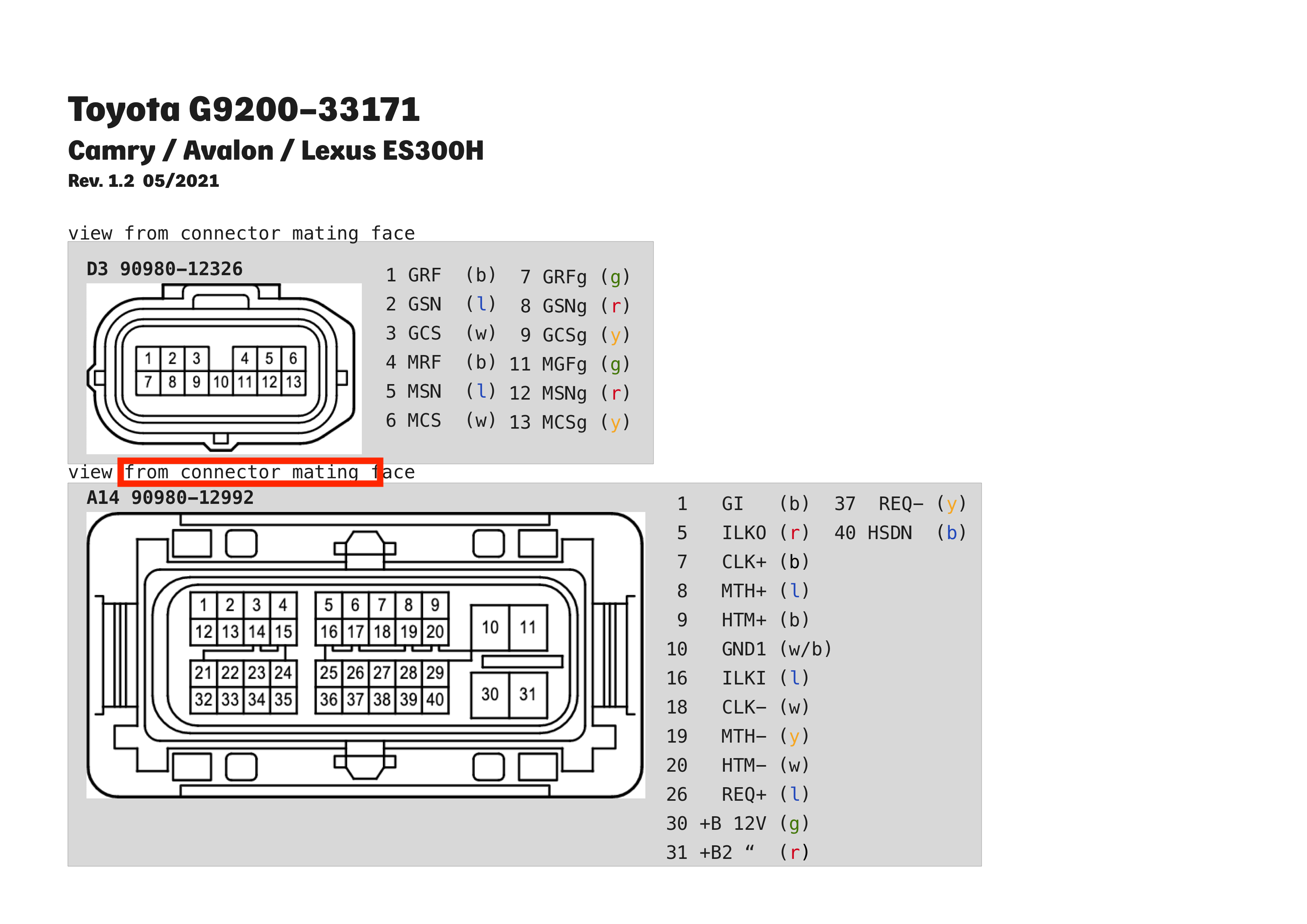

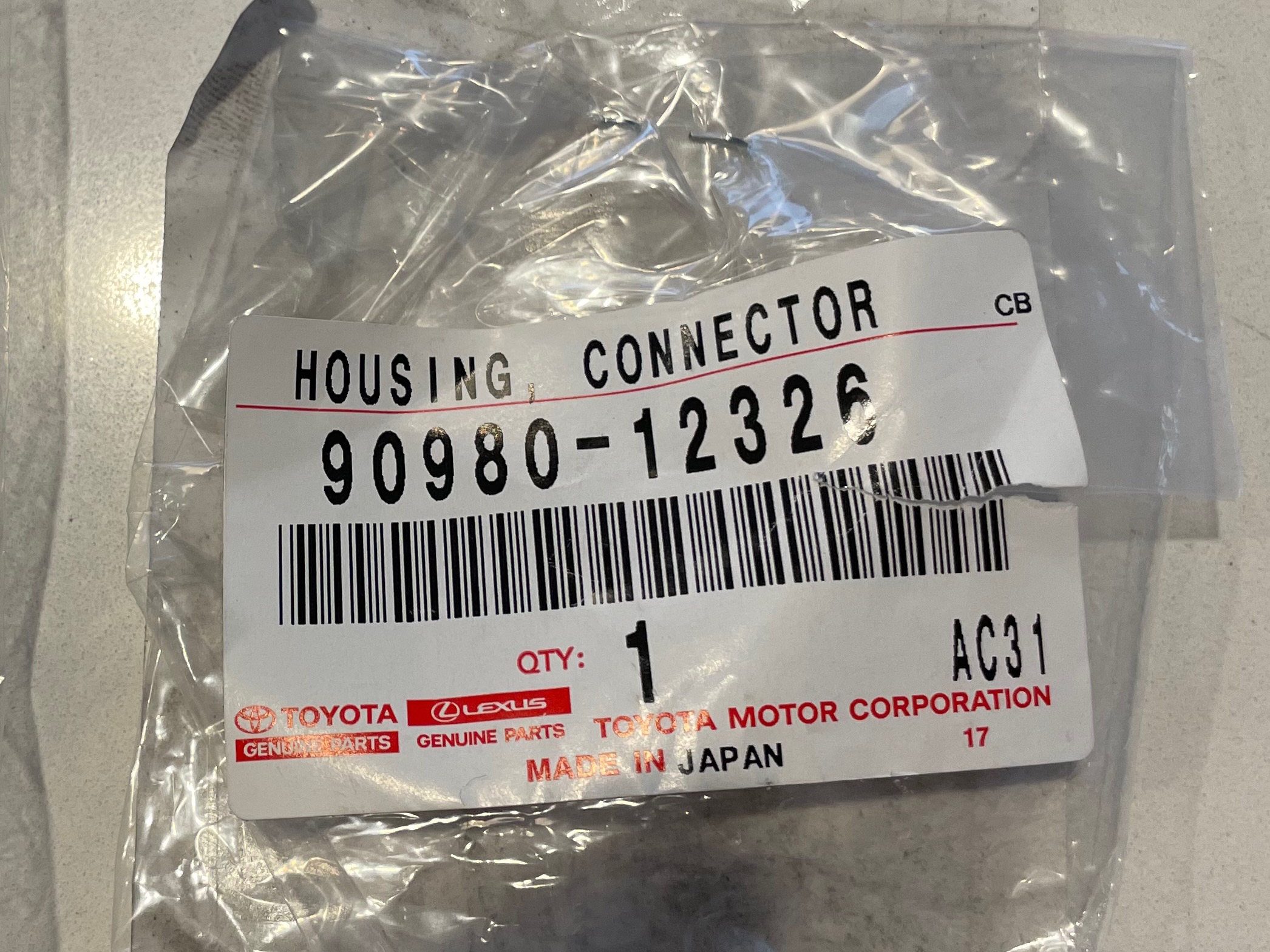

My lesson learned: Take your time and do the wiring and connectors perfectly. It will come back to bite you if you don't.
I didn't have the connectors from the wiring harness, so I had to make up my own.
I ordered the connectors from my local Toyota dealer But then I didn't have the correct pins/terminals and used what I had. The terminals were too tight and didn't fit properly but looked liked it would work. Motors spinning but then stopped after a few seconds. A few days later when I tried again the motors wouldn't spin at all. Then I realised I had a wiring using.
I redid the main connector and resolver connector with terminals from RapidCables.com.au (https://www.rapidcables.com.au/8100-345 ... .22-0.35mm) and paid careful attention to crimp them as well as I can.
Problem solved.

So perhaps it was either a loose / intermittent connection or a short circuit/intermittent short circuit or a combination of both. Cheers for sharing the details with us all.

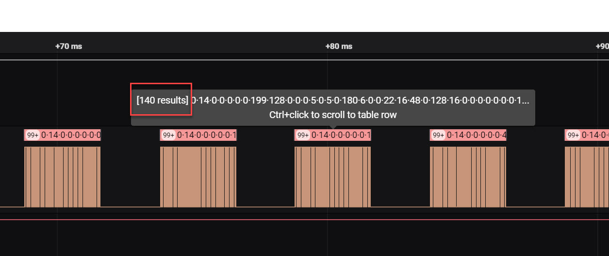

Well here is some data put together. One excel spreadsheet for the MTH signals and one for the HTM signals. So I have correlated signals for:
Generator ON
Motor OFF
Motor ON forward (slow)
Motor ON backward (slow)
There were a few serial packets that got corrupted so I was able to delete them before correlating against other packets.
There are some data packets that show when these different modes are occurring.
MTH packets are longer than HTM packets.
Tomorrow will get some inverter signals with the inverter very hot, (tomorrow is supposed to get to 36C), so will start here and record temp changing as radiator cools the inverter. Perhaps then we can work out which data byte records inverter temperature...?
[[In the future, will also record against battery voltage, and if I can wangle it, Boost voltage as well as when generator cuts in and out. Might be able to record against RMS current too...]]
Perhaps all of this will be helpful.

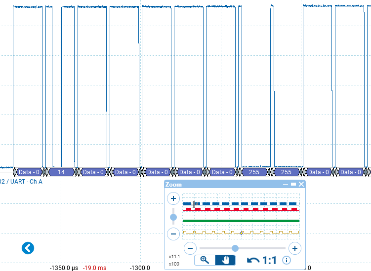

Thank you everyone
. Well I am convinced I have collected good data, but I am questioning the serial decoding. Think there should be way more zeros in the serial streams. Checked out this viewtopic.php?t=2289&hilit=hyper+car&start=25.
They say the serial stream is asynchronous, bit like the old RS232 sort of thing.
Anyway, will try to figure this out...

I captured some MTH data using Saleae Logic. When I use these settings, the data looks correct:
I get 140 columns for MTH

Well this is what I get with my MTH data so far. Have looked at it a fair bit, and looked at Damien's software and remembered about temp_inv_water=mth_data[20] from Zechy (thank you).
I have almost as many questions as what I managed to work out (which was'nt much).
Looking forward to any comments, amendments thank you.
20230107_MTH_Capture1to6.xlsx- (6.69 MiB) Downloaded 455 times

Amazing work!johnspark wrote: ↑Fri Jan 20, 2023 11:24 am Well this is what I get with my MTH data so far. Have looked at it a fair bit, and looked at Damien's software and remembered about temp_inv_water=mth_data[20] from Zechy (thank you).
I'm looking forward to the long weekend to dive into the data.
