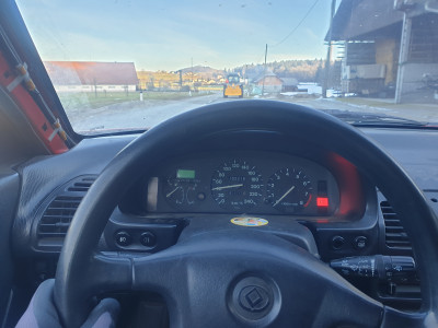

ok now... i managed to go for a roll
. Motor can pull the car just fine. However starting torque is a bit lame.
But the most problematic is constant torque block. It felt like i couldnt get the VCU to accept throttle value more than 50%...
I calinrated throttle so when released it showed 0. I tested variuous torque increments from 10 to 100. This torque block felt worse when in map3!
Another issue i observed is the constance of torque. If i would remove throttle pedal command motor would still feel like steady speed even a bit uphill. It felt kind of having cruise control on... Any thoughts?
Also i havent felt any regen when i lifted my foot off the throttle. Shoiuld i be thinking about putting (-1) to regen values?
My system does not report battery current as i dont use ISA shunt or Outlander shunt yet. In any case i have analog current display and SOC meter which is sufficient for now. Do you think code absolutely needs a current report?

Well i closed up my front box and relay box. I added my watt meter sensor and went for a ride....
Several rides into this showed results...
Inverter at start pulled 115A for acceleration. I consider this rather slow in comparison with my ACIM motor before. That was on NORMAL mode. When motor develops rpm it goes really good, however takeoff from 0 leaves a lot to be desired. I even managed to trip out during takeoff. I guess this would be torque increment protection?
When on SPORT mode acceleration was much better with 180A up to 80km/h and 220A up to 120Km/h. I ran out of straight road to go faster.
Tommorow in daylight i will test 0 to 100kn/h acceleration and report further.
There was NO NOTICABLE regen when i removed throttle or used the brake. No regen effect at all.
@aot93 can you tell me your setting for torqueIncrement please? What would be a sensible value?
Also how would i resolve regen?
tnx
