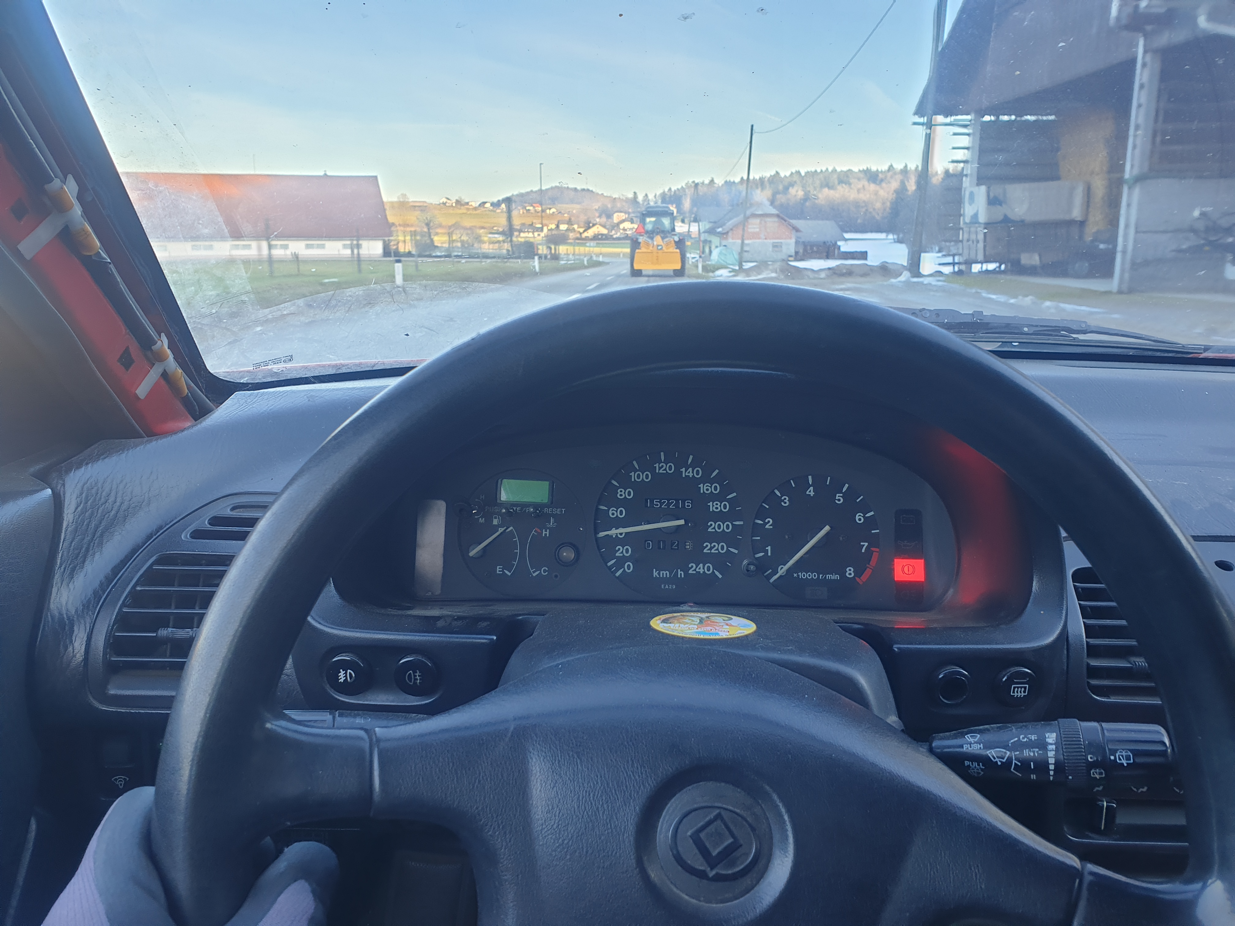

Update because of connecting HV battery
The car moves rather well out and into the garage. No more shutoffs. Tomorrow i will go to drive on the road .

Yes, yes! That is my goal. I still have to connect my wattmeter device - display above the left dial. This will show me how much regen is there at all.
Does the code take into account brake pedal as well? In my experience brake pedal regen is undesirable in snow or icing conditions. I would much rather use throttle pedal regen AND mechanical braking.
- Posts: 3287
- Has thanked: 81 times
- Been thanked: 240 times
Well i closed up my front box and relay box. I added my watt meter sensor and went for a ride....
Several rides into this showed results...
Inverter at start pulled 115A for acceleration. I consider this rather slow in comparison with my ACIM motor before. That was on NORMAL mode. When motor develops rpm it goes really good, however takeoff from 0 leaves a lot to be desired. I even managed to trip out during takeoff. I guess this would be torque increment protection?
When on SPORT mode acceleration was much better with 180A up to 80km/h and 220A up to 120Km/h. I ran out of straight road to go faster.
Tommorow in daylight i will test 0 to 100kn/h acceleration and report further.
There was NO NOTICABLE regen when i removed throttle or used the brake. No regen effect at all.
@aot93 can you tell me your setting for torqueIncrement please? What would be a sensible value?
Also how would i resolve regen?
tnx
