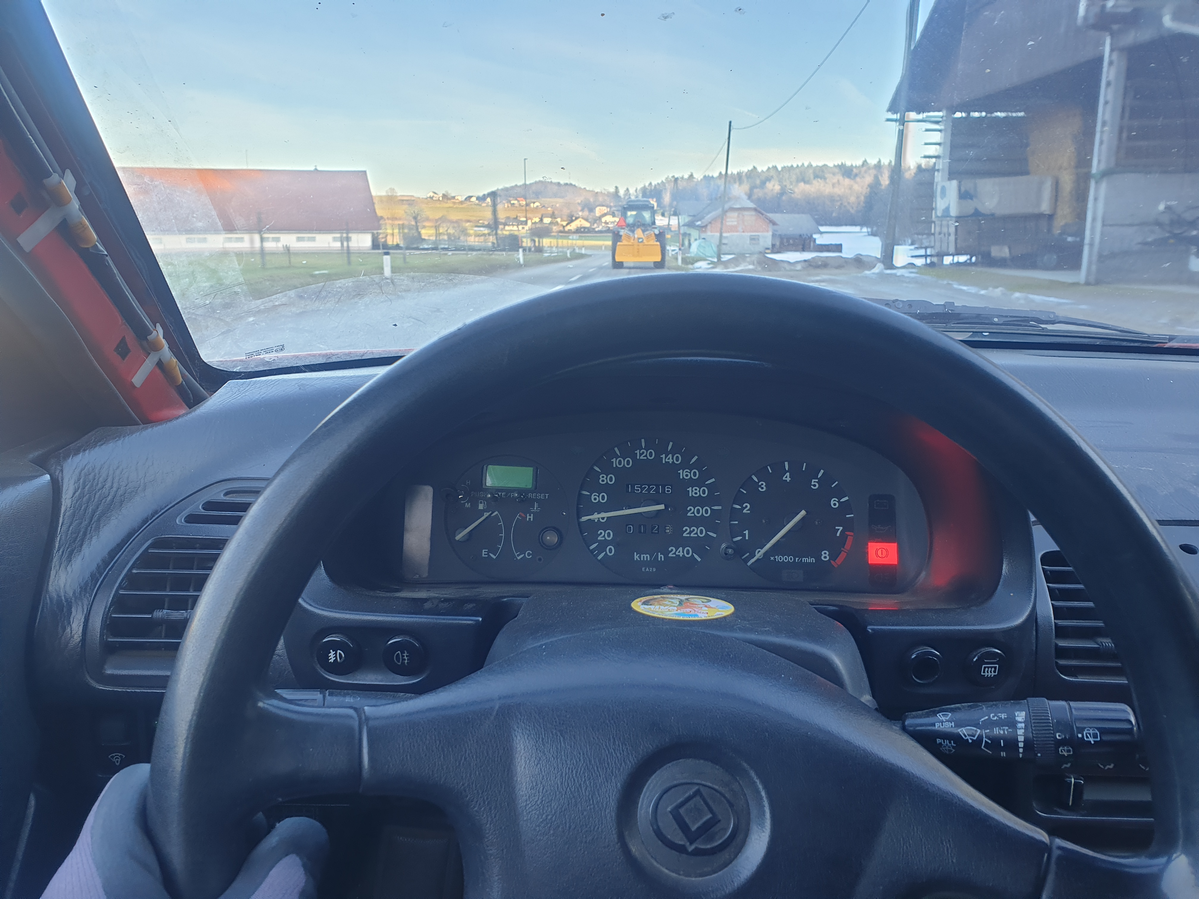

Well i closed up my front box and relay box. I added my watt meter sensor and went for a ride....
Several rides into this showed results...
Inverter at start pulled 115A for acceleration. I consider this rather slow in comparison with my ACIM motor before. That was on NORMAL mode. When motor develops rpm it goes really good, however takeoff from 0 leaves a lot to be desired. I even managed to trip out during takeoff. I guess this would be torque increment protection?
When on SPORT mode acceleration was much better with 180A up to 80km/h and 220A up to 120Km/h. I ran out of straight road to go faster.
Tommorow in daylight i will test 0 to 100kn/h acceleration and report further.
There was NO NOTICABLE regen when i removed throttle or used the brake. No regen effect at all.
@aot93 can you tell me your setting for torqueIncrement please? What would be a sensible value?
Also how would i resolve regen?
tnx
