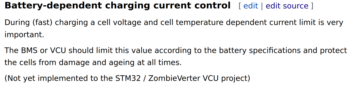

Is there a relationship between the BMS (whatever BMS is in use) and the LIM/ZV? If so, how are the existing users implementing this relationship?
The Wiki currently mentions this only in simple terms:
WIki entry for BMW i3 LIM: BMS

BMS communicates limits...these limits are forwarded/applied to charger.

Please expand on this.
The BMS communicates limits . . . via CAN? To the ZV -> LIM (via CAN) -> DCFC EVSE (via PLC)?
If the BMS is communicating limits to the ZV, does the ZV have preset or user-defined communication profiles for various BMSs?

asavage wrote: Sun Jan 21, 2024 8:46 pm The BMS communicates limits . . . via CAN? To the ZV -> LIM (via CAN) -> DCFC EVSE (via PLC)?
Nope, the Zombie currently follows the limits from the Web Interface for the DC fastcharging. It does not change the current limit or voltage limits on its own.

Tom, that's what I was remembering, but EV_Builder seems to have a different setup, or knows someone how does.
At a minimum, I would want to restrict the charge rate at very low or very high pack temperatures, and this -- as well as other limiting factors -- is best communicated from the BMS, I would think. But I have a very simplistic view of what the BMS does and the factors that limit charge rate, and I'm hoping that others who are already using the LIM/ZV for DCFC can describe what they're doing.
