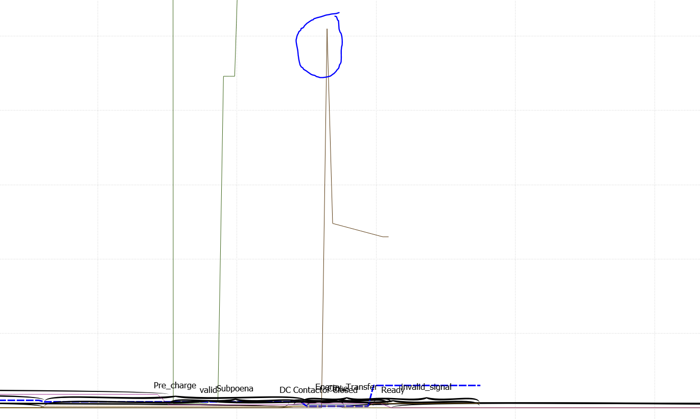

I got the chance to make it back to the charger with the issue.
It worked with my stock BMW i3. Went back with my new CCS1 setup on my Toyota RAV4, and same issue.
Voltage almost matches and than it slowly falls down to zero and fails.
I think I have worked out how to change the code if I knew were to look in the program.
A am already runing program on the USA CCS1 variant that's not out in circulation yet.
I'd like to change the time it waits while within 20 volts. Instead of 2 seconds I wanna try 1 second or half a second if that doesn't work.

Thank you for the edited file.
That got it to advance past state 4.
It went to state 6 for 1 second than failed.
I ended up with a failed weld test.
I cleared weld test fault and tried again several times with the same result.
The only way I have to clear the weld fault is by changing the web interface setting, Interface i3 to interface unused.
It runs the contactor test when I close the charger door.
If I don't change from i3 to unused it will not run the contactor test to clear the fault.
Somehow I believe my problem it that I need to have unused selected to run a weld test.

Long night testing.
I accessed the canbus wires under the foot well, but couldn't get it to work.
Will take more research.
I did go and record a successful charge and we can compare to the one that failed at state 6.
But I did get the problem charger to work.
I changed charge mode to EXT_DIGI on a hunch.
Than drove across town to the problem charger and it worked.
Attached.
Failed at state 6
Successful charge
Photo of settings that worked

Replying to my own previous post.
I was wrong about the heater causing the issue.
The cause of the problem was with the settings in the web interface.
At any other charger it didn't matter if I had Interface set to i3LIM.
But at this charger it needed to be set as unused.
All the other chargers also work with interface set to unused, so I won't need to change it back and forth.
I also tested this "problem charger" with both the 2 second wait and the 1 second wait versions
It only works with the 1 second wait version.
Also only works with interface set to unused, cannot have interface set to i3LIM.
Other chargers were ok with interface set to i3LIM.

This is log of charger that was originally a problem, and using the revised 1 second delay file fixed it.
At the time I believed having the heater turned off was necessary.
BTC Power54059 working heat turned off.csv
(1.4 MiB) Downloaded 761 times
The saga continues.
The problem i thought I had solved, isn't completely solved.
All the chargers in my area worked, accept one. It appeared like the charger was waiting to long for the both voltages to be within 20 volts of each other. With a revised file Version 2.03a it solved the problem. The wait time was changed from 2 seconds to 1 second.
It worked. That charger now works perfectly.
Until today, someone was on the one side of that charger, so I used the other side. It's actually 2 separate chargers.
Guess what? The other charger is behaving the same way. (even though I am running the 1 second delay file, it acts like even 1 second wait is too long)
Btw at the moment the charger goes into fail,I hear the contactors clicking, and the logs say "failed to complete contactor test.
It's at this point I need to close the charge port door, and I'll here the contactors clicking and the weld test fault clears.
I wonder if I now need to try revising the 1 second wait to .5 second wait and try that?
I attached log file here.
54061 failed t15stat on.csv
(2.32 MiB) Downloaded 867 times
Posts: 2392
Location: Bristol
Has thanked: 206 times
Been thanked: 563 times
Shockazulu1 wrote: Wed Dec 20, 2023 2:13 am
The contactors actually close, the request arrives and the LIM responds the contactors are shut.
There is an issue, unsure why the log reads a current request of 255 which does not seem right.
And yes the contactor info changes to weld test cannot be carried out, this is true as we are charging thus cannot influence the voltage at charge port for checking. This may not actually be what is causing the faults.
From your testing and comments it sounds like there might be some wiring issues.
Shockazulu1
Posts: 56
Joined: Mon Jul 03, 2023 2:04 pm
Location: Iowa USA
Has thanked: 91 times
Been thanked: 6 times
Post by Shockazulu1 »
tom91 wrote: Fri Dec 22, 2023 10:42 am The contactors actually close, the request arrives and the LIM responds the contactors are shut.
I think I understand a little better.
Before the issue was waiting too long and it never tried to close the contactors, when it had a close enough voltage match.
This was fixed by changing it to not wait as long.
This issue is different because it is actually closing the contactors soon enough but than it believes something is wrong and wants to do a weld check.
I have tested the original issue charger with and without the faster contactor close and that charger only works with the faster close setting.
I'm gonna have to go to this 2nd issue charger and see if it works with the original slower close timing setting.(the 2 second wait file)
I'll also try a few other options with the web interface.
