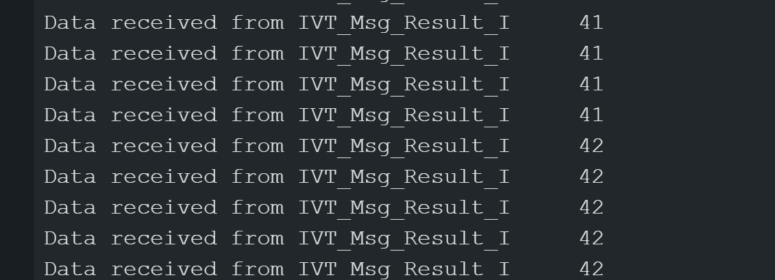

Messaged ISA tech support and they said I should be able to reprogram it, but I don't think the shunt responds to 0x411 ID at the moment. The first data command on 0x411 ID is to put it in STOP. I'd assume it will stop posting messages on the CANbus, yet it still sends the 0x620 and 0x680 ID data.
I used this https://openinverter.org/wiki/Getting_s ... bus_shield to decode the data from 0x620 ID. I had to play with the code 'cause parts of code wouldn't compile for me, here's what worked.

    if (canId == 0x620) {
      Serial.print("Data received from IVT_Msg_Result_I");
      Serial.print("\t");
      // Convert individual big endian byte values to actual reading
      long reading = (buf[2] << 24) | (buf[3] << 16) | (buf[4] << 8) | (buf[5]);
      Serial.println(reading);
  // Refresh every 250ms
  delay(250);
0x620 ID just changes on itself - load or no load.
Data received from IVT_Msg_Result_I	-37
Data received from IVT_Msg_Result_I	25
Data received from IVT_Msg_Result_I	150
Data received from IVT_Msg_Result_I	37
Data received from IVT_Msg_Result_I	12
Data received from IVT_Msg_Result_I	0
Data received from IVT_Msg_Result_I	125
Data received from IVT_Msg_Result_I	-25
Random data on 0x680 too - continuously counting with some delay..... :?

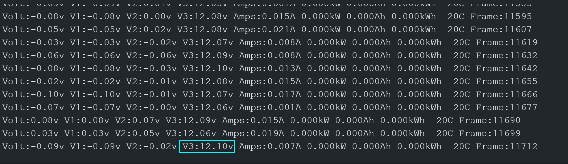

Ok. Some new findings.
Either after running the above factory reset command new IDs came out or after playing with the code I filtered for additional IDs.
0x620 - unknown. but I suspect this is where the current is read. having trouble finding 12VDC load with >1A. I think the sensor cannot read under 1A..
0x630 - V1 input
0x640 - V2 input
0x650 - V3 input
0x680 - unknow, some kind of counter. updates on its own, load or no load. maybe it's the runtime..
Vx inputs report FF FF FF and 00 00 00 when left floating, but always FF FF FF when tied to 0VDC. 12.09VDC reads as 00 00 2E. 12.56 reads as 00 00 30. 13.06 reads as 00 00 32.
example:
Still looking for the current ID...
Sensor doesn't respond to 0x411 ID to reprogram. Can the program ID be changed!? :roll:

royhen99 wrote: Mon Oct 02, 2023 4:03 am According to the data sheet the command ID can be changed. As you have a Ardunio Due it may be better to run Savvycan which allows all messge to be seen. You could also go through all the IDs automatically until you find the correct command ID.
Brilliant! Thanks for your help!
For future somebody who will get in the similar situation and not a programmer just like me....
Setup SavvyCAN using this...https://openinverter.org/wiki/CAN_bus_with_Arduino_Due
Watch the video in the wiki to get yourself familiar with the SavvyCAN interface
Follow this tutorial for fuzzing.
You'll see a live data from sensor when connected.
I decided to "fuzz" with the STOP command over a span of IDs to ensure I do not miss a response.
Turned out that my Command ID was 0x600 and Response ID was 0x610. I essentially ran the fuzzing until the sensor accepted the STOP command and stopped transmitting data and sent back confirmation.
Confirm by requesting data from sensor, e.g. request sensor version
Send Factory reset command to the command ID discovered above - data: 3D 0 0 0 0 0 0
...and voila, sensor transmits data over default IDs, ready to initialise.
After initialisation:
Connected 12.09VDC to V3 input:
Amps are a little jumpy, but rather close. I think it's because my load is much too small (only 0.04A) for a 1000A sensor, cannot find anything larger in the house to test with.

I was trying to use the Arduino UNO version with the shield but I get a lot of errors.
The ISA works but i cannot add the 528 message for energy since I cannot make the sketch work.
If anybody has any suggestions.
